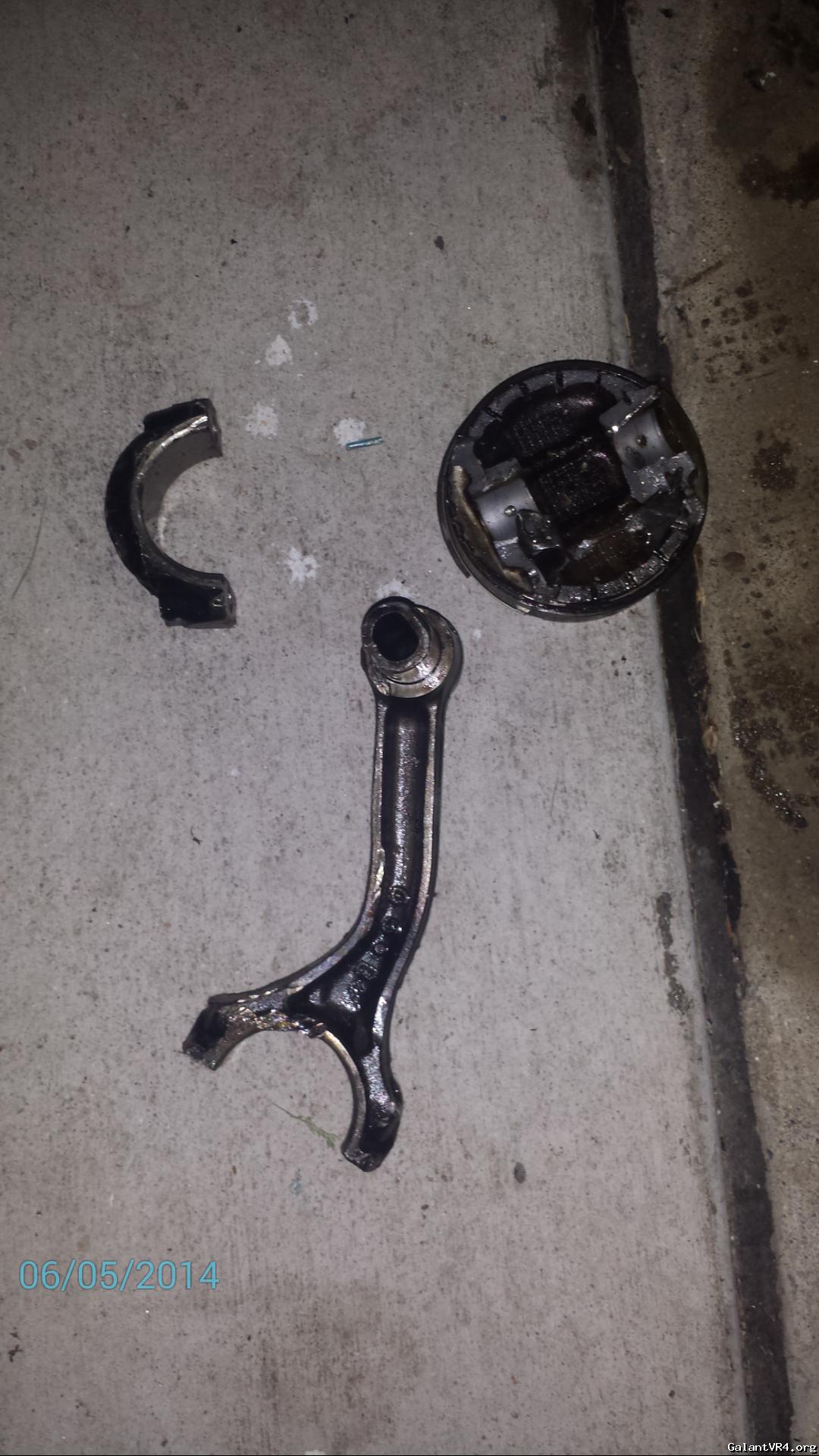

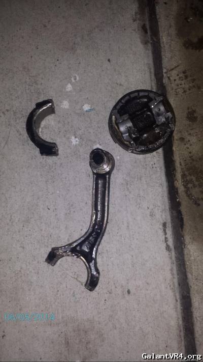

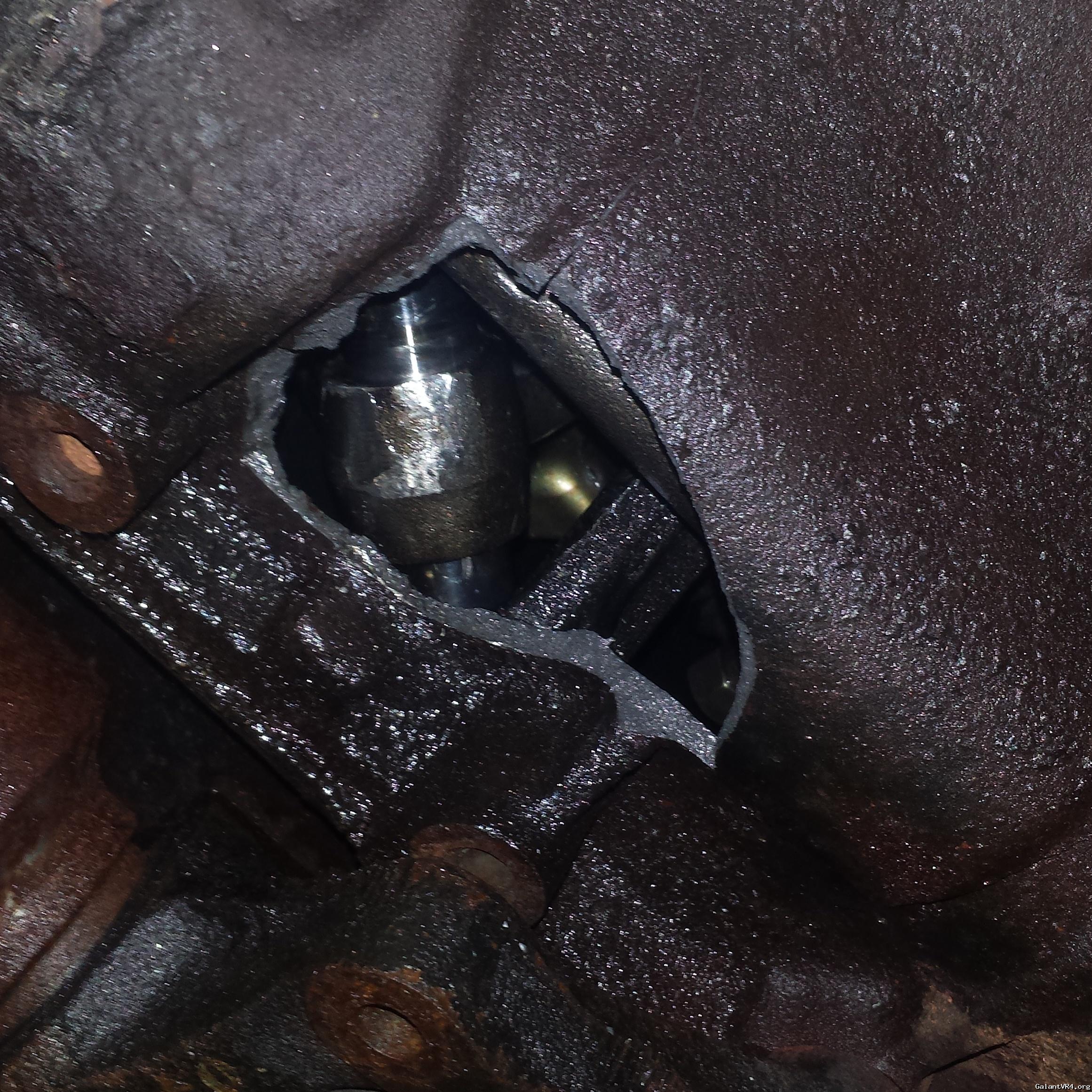

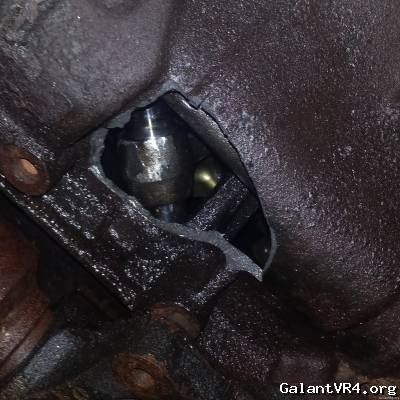

So out of no where today was cruising the vr4. When all of sudden a rod let loose and put a hole in the block. I will be putting in my spare motor from my talon in it when I come back from California in a few weeks. But very frustrated. /ubbthreads/images/graemlins/banghead.gif
Sorry for the crappy cell pics. It's all I have. But back to jack stand racing!

My gst did just about the same thing. I thought I spun a bearing and that's why it all broke. But come to find out the balance shaft belt which was new shredded and I guess somehow the balance shaft hit the number 4 rod and boooommmm
!!! Lol

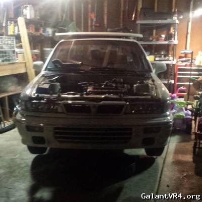

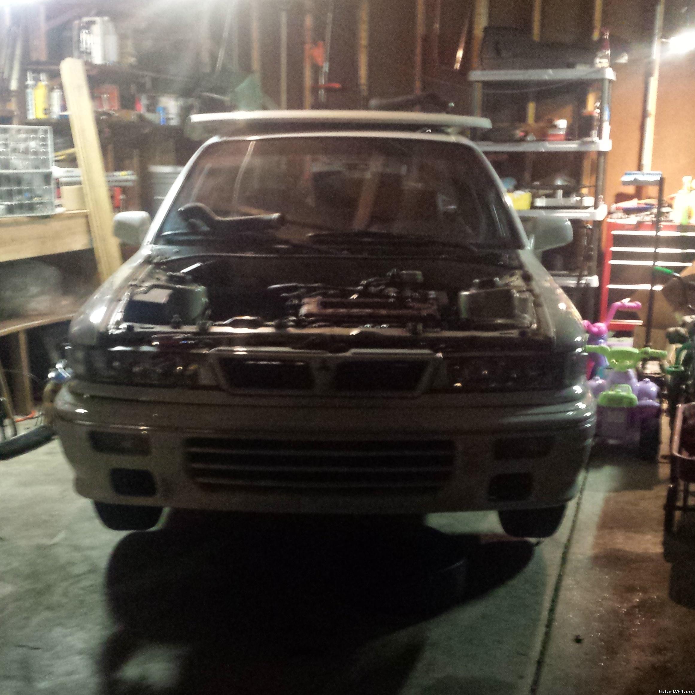

Well I pulled the motor and trans tonight. And found the culprit to this mishap. Oil pump was fully locked up.
I won't be installing the new motor till I come back from California in a few weeks as I want to clean the bay fix some wiring and other neglected problems first.
