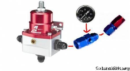

AN6 to NPT, think this will clear?
mikus
Jan 11, 2007
2,763
Aurora IL
For anyone who's tried similar, do you think the gauge would 'clear' in a setup like this? I'm still trying to avoid moving the AFPR, and can't use the front NPT in current location.
beaner
Jun 22, 2005
1,562
b'ham, mi
Consider using a different banjo bolt on top of the fuel filter with a female port for a place to tap for your gauge. Russell #640700 is what i use.
