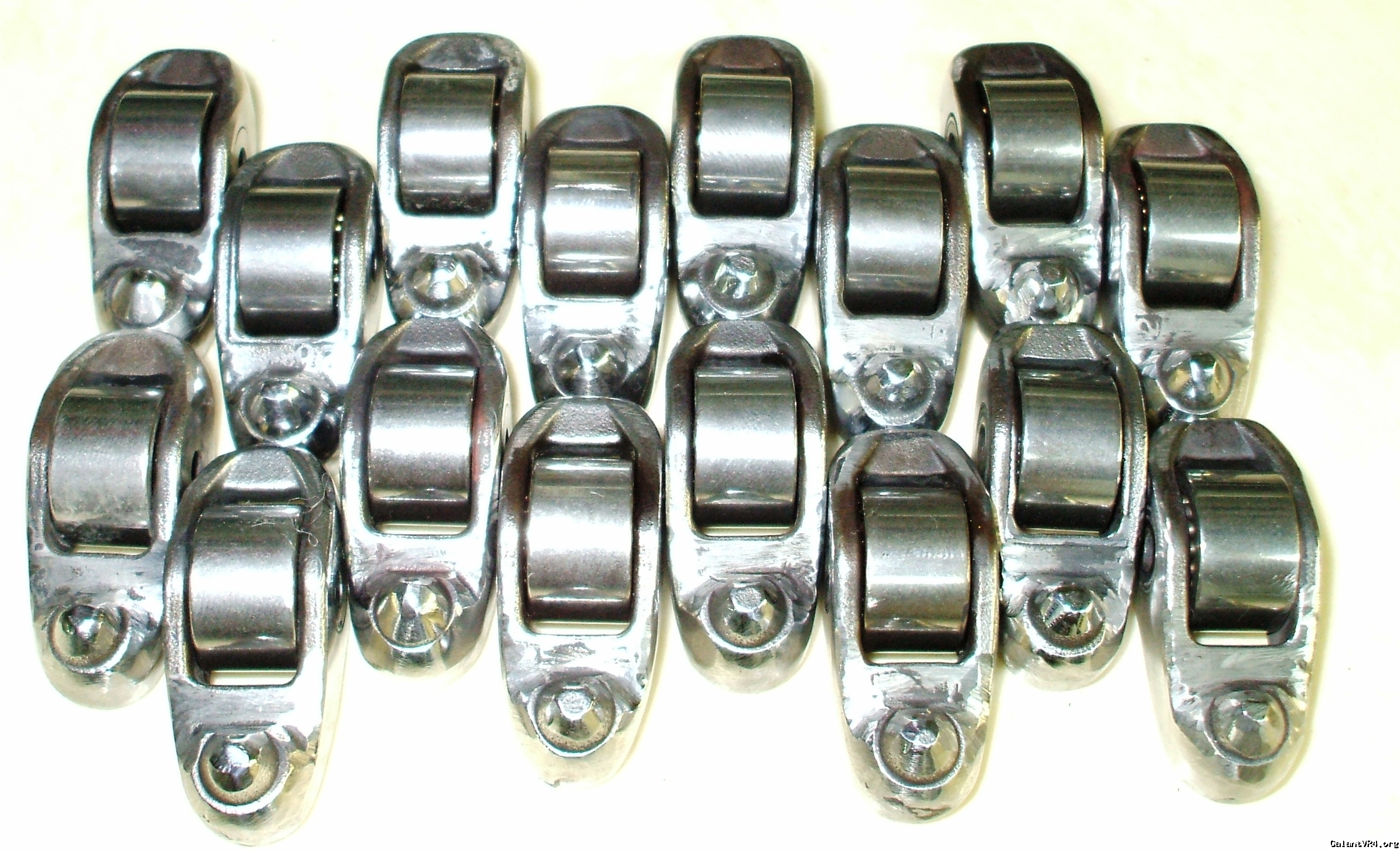

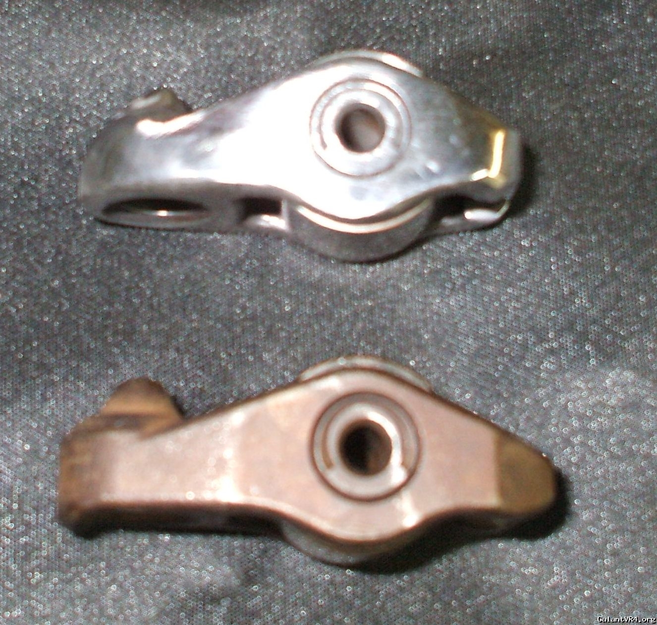

Ok whats the deal on the amg rockers. This is all new and I want a set. I've polished quiet a few sets and sold them on ebay. There's actually alot of extra metal on them thats not needed and by polishing them and weighing each as I do it I can get them all matched at the same weight plus or minus .5 grams but if there's hollow or machined ones I want to at least see a picture.

Pictures would be nice. As for the cams I'm sure there Na with more lift and wouldn't have the overlap needed for a turbo engine. But rockers could be utilized.
Here's pictures of the last set I did.

I think total weight is like 3 rockers less but the biggest gain is the lenght is shorter which deals better with harmonics and also there all the same gram weight when finished which helps on the smoothness of the engine and harmonics valve fluttering. I type up everything and save it so it should be on my list of ebay stuff. I'm thinking its like 5 grams each or something.
