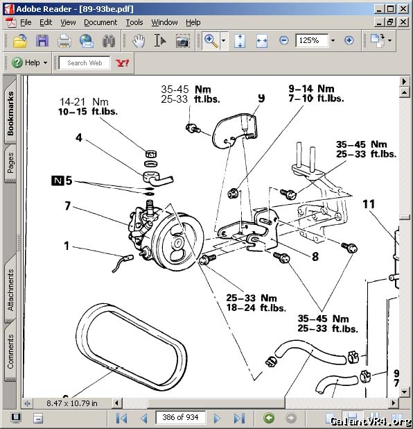

This is where the power steering switch connector goes:
It's labeled as #1 in the picture.

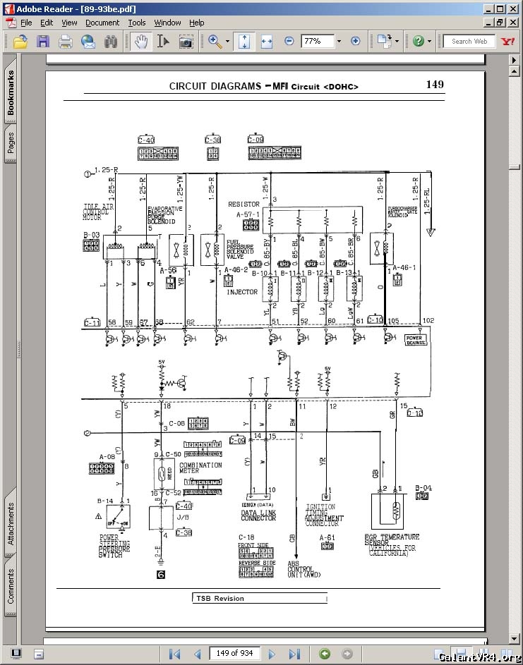

The ps wire is actually an on/off input to the ecu. I believe it's used to maintain a smooth rpm at idle when the power steering is being used. According to the this diagram (lower left corner) it looks to be a yellow wire and I'm pretty sure it comes out of the same bundle of wires as the alternator connectors. On my dsm manuals it shows it as the same bundle, but I couldn't find a good diagram of that in the galant manual (cd).
Looks like its just a switch to ground so even if that wire touches ground it shouldn't be too fatal.

The connector for the power steering pressure switch is one of those bullet connector (it just pushes onto the stud shaped fitting on the ps pump, labeled #1 in the first picture I posted). It doesn't connect to ground normally, ONLY when the pressure switch on the ps pump is activated then the switch connects the terminal/wire to ground.
If you grounded that connector then the ecu will think the switch is always activated. Probably not a big deal, might have a slightly higher idle or idle fluctation when turning the steering wheel.
