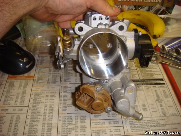

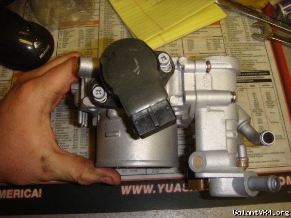

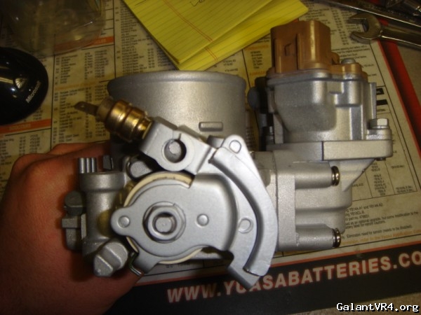

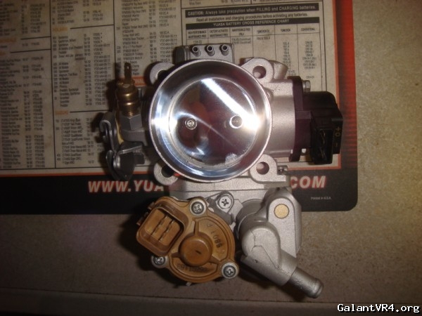

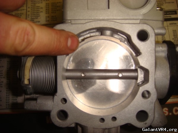

onesickcrx
Jun 3, 2007
1,076
NY
I emailed Steve at throttlebodies.com he had a core in stock so everything was directly purchased from him. I think it looks great. Thank you for all your responses and help with my throttle body purchase. My intake mani comes in this week I can't wait /ubbthreads/images/graemlins/hsugh.gif
This is where it get thin in case anyone was intrested Its 63mm here and the snout of the throttle body is 66mm
