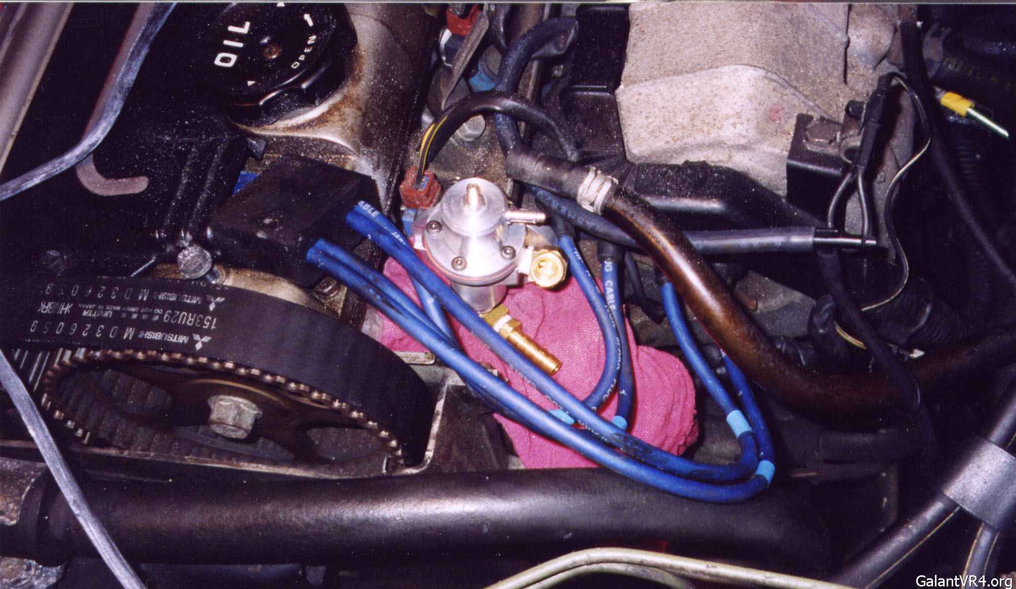

I was looking for Paul Mc's post on his install, but I guess my own is a good place to put these...

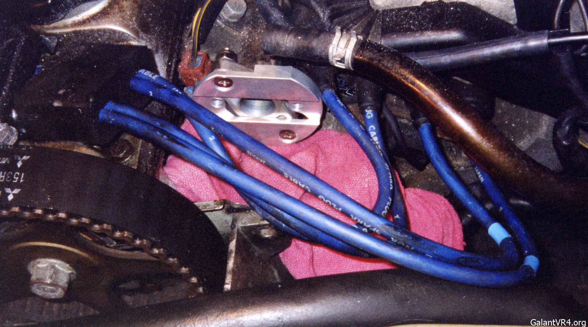

Funky adapter plate installed
after having lost one screw and purchasing a new set. Minor grinding was required for a good fit. The sparking dust is some aluminum particles. The rag is a must if you don't want to lose any more screws. (Duh) Yes, the spark plug boot is a little close.
AFPR installed, no gauge.
I only needed to buy one extra elbow to get a good angle on the gauge. Used PTFE tape... The supplied elbow was used to angle the supply nipple towards the hose. It honestly took me 15 minutes to figure out how this thing should be set up.

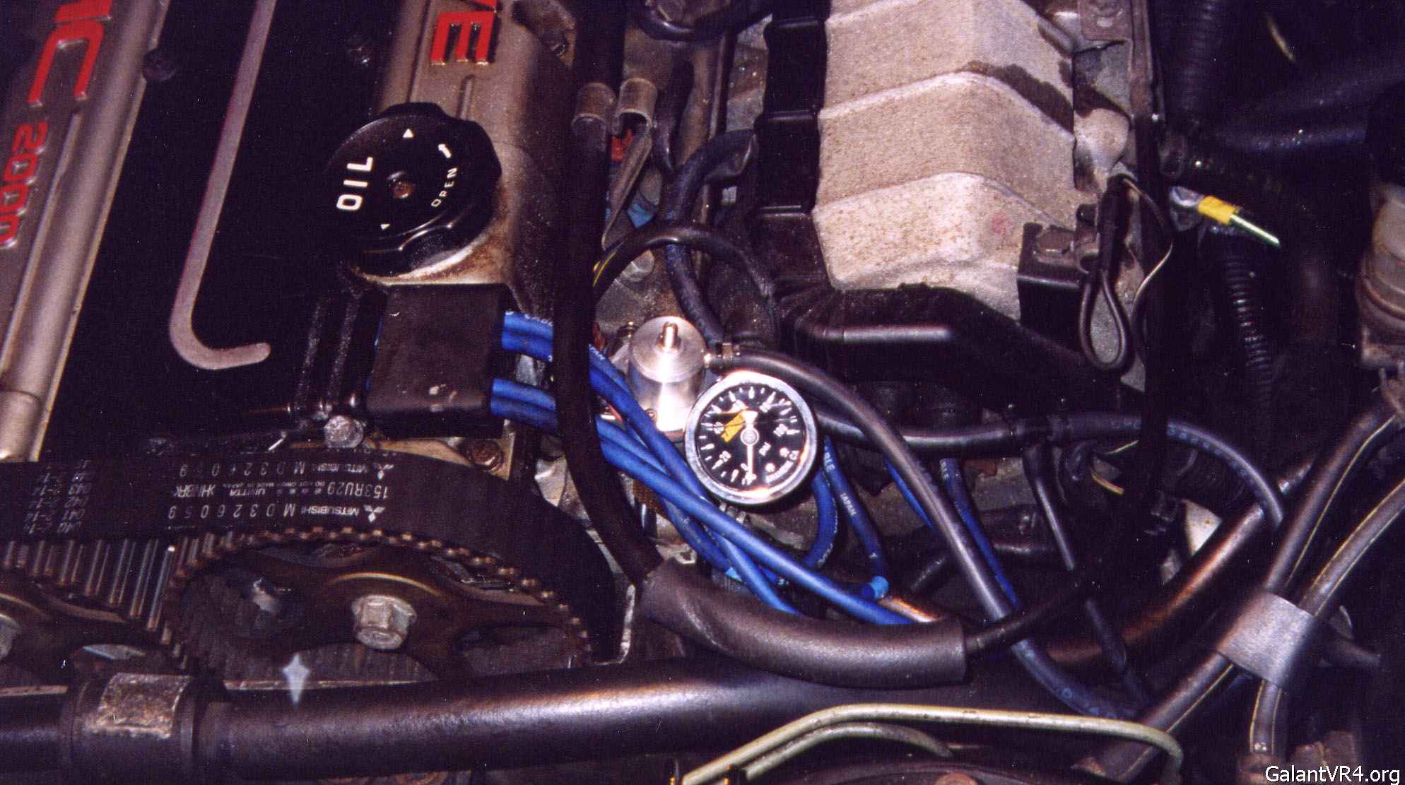

AFPR installed w/ Jeg's gauge
which was $20 plus $10 shipping, for which I now have two Jeg's decals and receive a catalog of parts I can't use every month.

quote:The rag is a must if you don't want to lose any more screws. (Duh) Great idea...wish I thought of it.
I hate that hole.
quote:I only needed to buy one extra elbow to get a good angle on the gauge.Others have done it with one as well. I just couldn't make my gauge clear the regulator without two.
