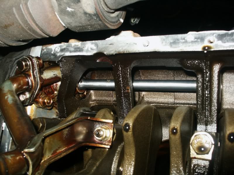

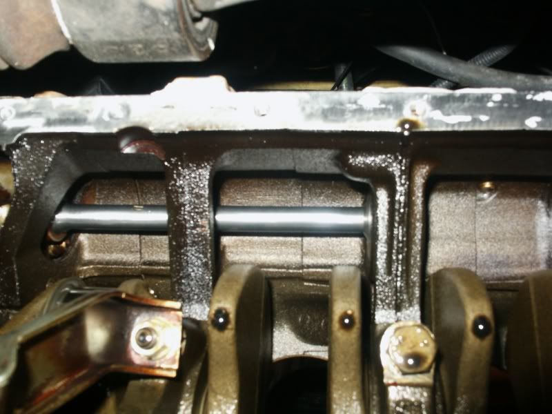

Actually the amount of work it takes to do an elim kit is alot compared to putting a rear shaft in a lathe. The extra work includes porting oil filter housing, installing bearings, etc. Plus running a full rear shaft helps support the oil pump gear better instead of it on a stub shaft.
My motor I had apart last year:
