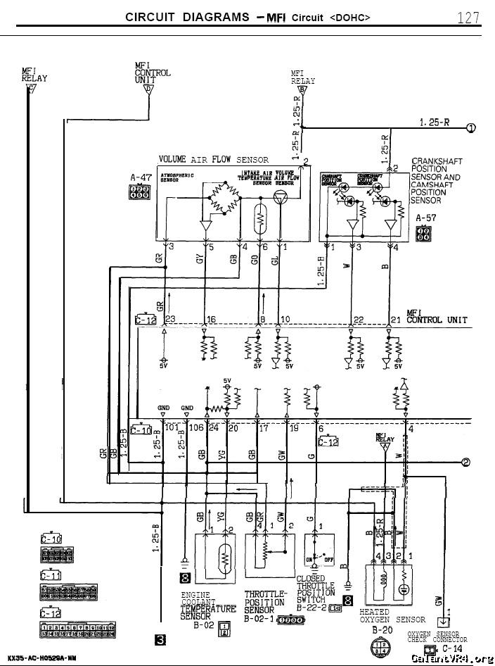

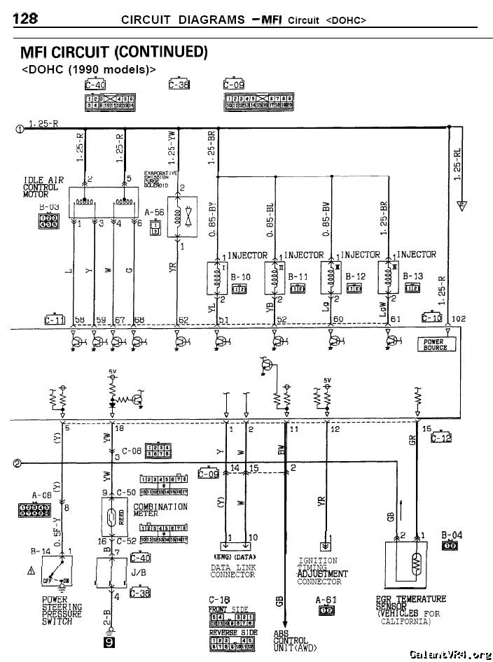

Armitage
Oct 16, 2003
715
Herndon, VA
You're not using the factory engine harness are you? According to the wiring diagram, the coolant temp sensor wire splits off and goes to visit the TPS and EGR. If there's a short in the harness somewhere (like I suspect mine has), you may get some unpredictable readings. I get sporadic CELs and idle hunting even though I've got continuity at the sensor end.
