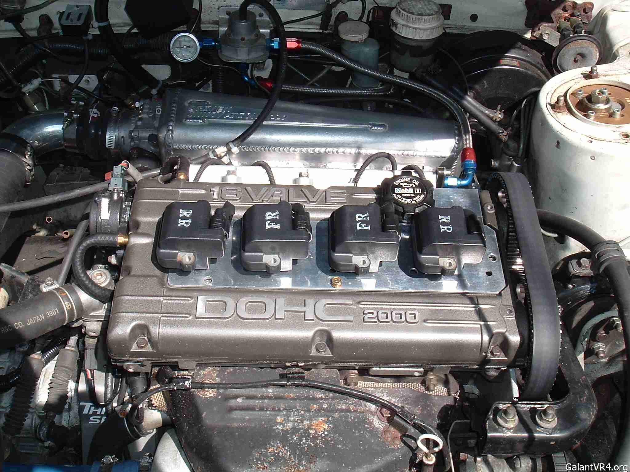

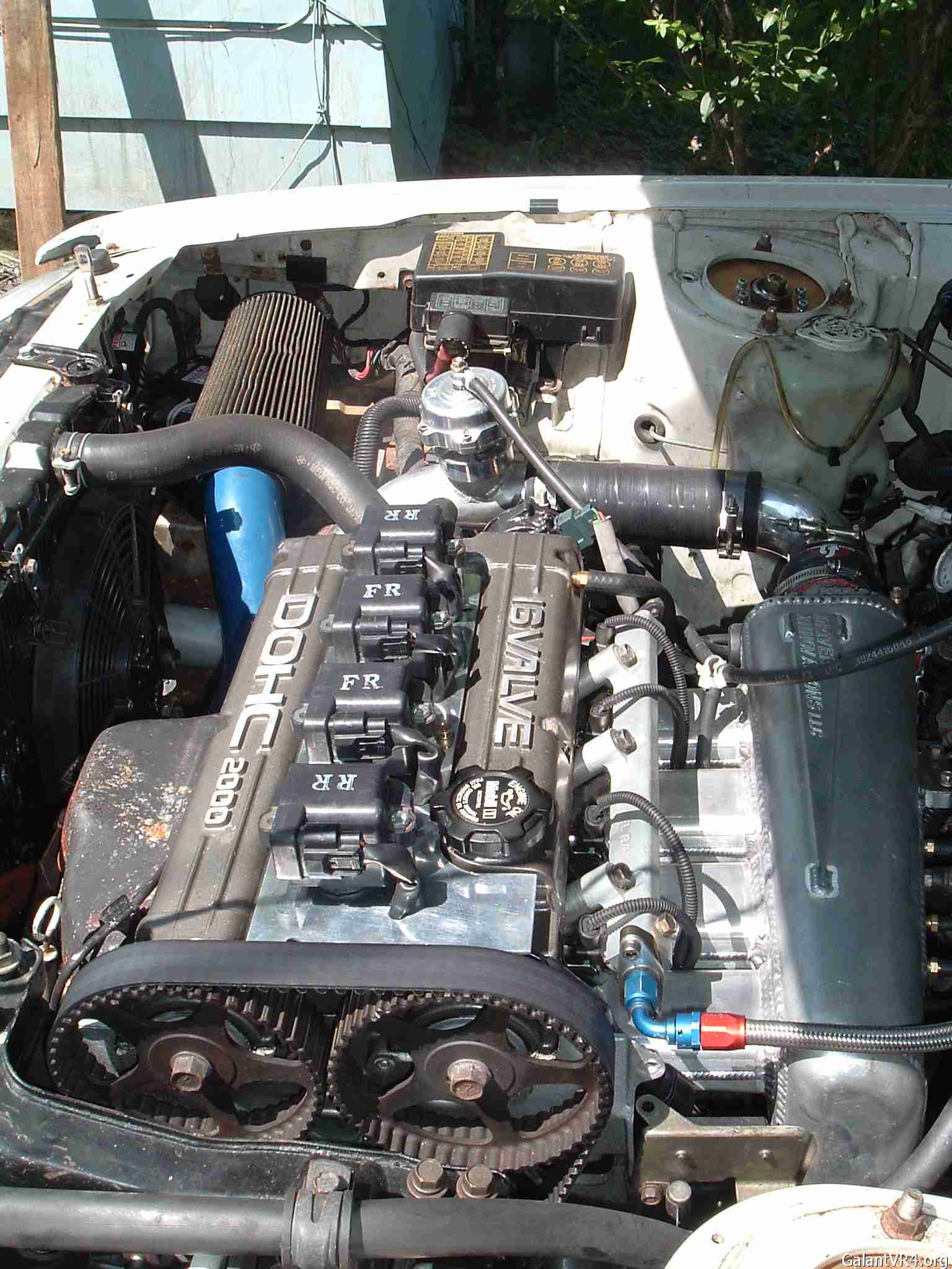

I finally got around to getting this done. I had it done once before but it would begin to break up under boost. The service manual had very poor pics showing which pin on the coil pack was what so I had a hard time figuring out which pin did what without a connector to read the wire colors from. A couple of weeks ago I was lucky enough that another tech at my dealer had to do an engine harness on a 2002 Acura RL and that has the same coils/connectors. I cut the coil pack connectors off the harness and re-wired the coils. Its now working well and the idle/part throttle driveability is definitely improved. I'm going to have a few sets of these coils for sale if anyone wants them please check the FS section over the next couple of days.
I know that they're kind of big and bulky but I trust the quality of the Acura/Honda part over anything that Chrysler offers. The plate I used is just a standard blank plate that I drilled my own holes in and tapped the ones that are used to bolt the coils down. I'll post some pics of the individual coils when I start the FS thread. BTW, all 1996-2004 3.5 RL's have these coils too so they'd be a lot easier to find than NSX coils since I doubt there are very many NSX's in the junkyards. /ubbthreads/images/graemlins/grin.gif I almost forgot to thank KingGalantVr4 for his help when I was first toying with this idea. His knowledge and expertise gave me the confidence to try it myself.

Do these coils have internal transistors? How are you firing them? Do you have a wiring schematic of how you hooked them up?
No internal transistors. I'm firing them with the stock igniter so they are still being run as a waste spark system but it seems to be an improvement over stock and now I don't have to buy wires anymore. I wired them just like the schematic in the how-to forum shows.

I don't see much sense in dynoing them, it costs too much money for dyno time to see if my COP that I have $5 invested in makes more power than stock. I think the biggest improvement with them is driveability and not max HP.
I think curtis might need to use the 1G igniter in order to make the Intrepid coils work on an Evo. I'm pretty sure that when Nate Crisman went to 1G wires/coils on his Evo he used a stock 1G igniter.

John I did use the 1st gen ignitor on the car. I think its something to do with charge time (4 coils instead of 2) and or amperes going to the coils. We're getting the volts and the resistance in each of the coils match perfect. The problem is my buddy gives up way to easy on stuff, he's abandoned the project way before we got started. I might be able to get him fired up to do it again but with him who knows.

I've been meaning to post back in here. It's great at part throttle but still has a high rpm/boost issue causing the car to break up and back fire. I'm done with it for now, I've wasted enough time and I ordered a set of NGK wires the other day.

Thats too bad to hear that. Do u have any idea why it is breaking up at the top? I am curious to know if the problem goes away when u get NGK back on.

It still does it a little at 25psi with the new plugs/wires but that is just the car leaning out do to the stock fuel lines (I guess). I don't have time to fool with it right now.
