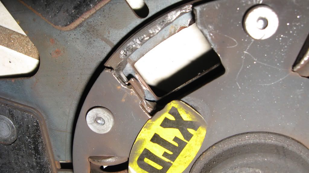

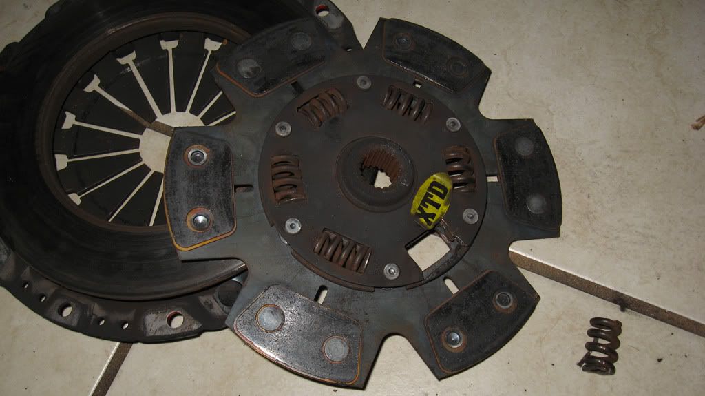

Well its been a few years since the clutch went out on the #1948...so finally this weekend I got motivated to replace the clutch. Me and Mikeyturbo tagged team on replacing the clutch this weekend.

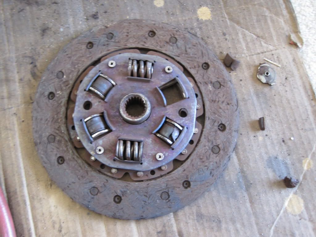

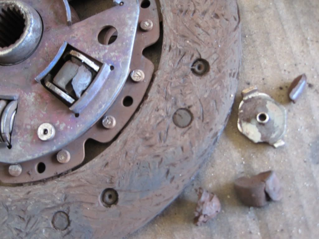

I never raced the car, clutch is a ACT 2600 kit..maybe a dozen hard launches, but 99% I drove the car like I babied it. One morning on the way to work at the entrance of my subdivision at a stop, went to put it in 1st gear and couldn't get into gear. Just replace the slave and master clutch cylinder and no leaks whatsoever. Suspected that the issue with ACT discs springs coming apart was my suspect.
Well today..it was confirmed, it was the culprit. Here are a few pics of the carnage.
We had one fall apart on a DD car that NEVER gets launched. They are such piles of sh*t. That was the second time it fell apart on that car too. I hate ACT disks so bad.

That's the newer design. The same as we had fail. I would use ACT but ONLY with an unsprung hub disk.

The springs on new discs hit the fingers of older pressure plates. At some point and time there was a revision to the disc with the springs being larger. Somehow ACT hasn't figured this issue out yet while the entire DSM community has. Shame.
