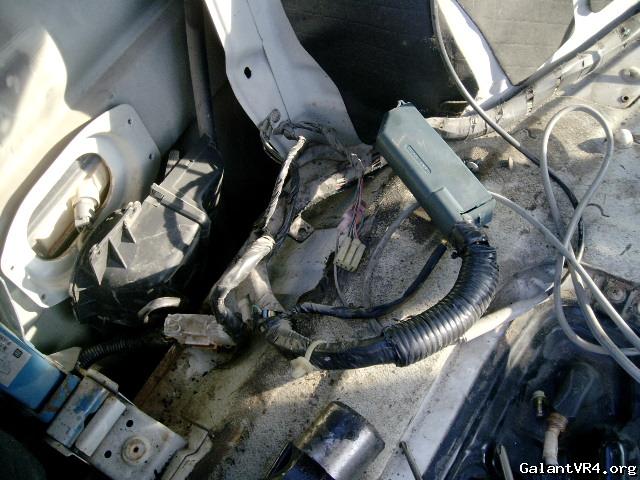

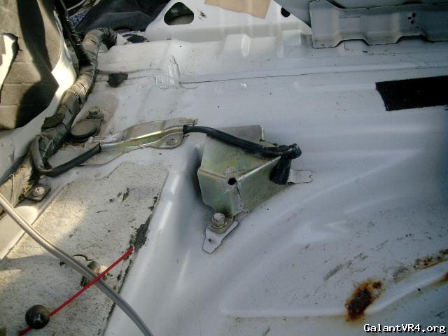

i am removing my ABS and there is alot of wiring running to the abs control unit in the trunk. Is there anything else in the wiring bundle seeing that it goes up under the rear seat and beyond. What all can be removed from it or does everyone just leave it go and tuck it behind the fender?
Also the G-sensor is only for the ABS correct and can be removed?

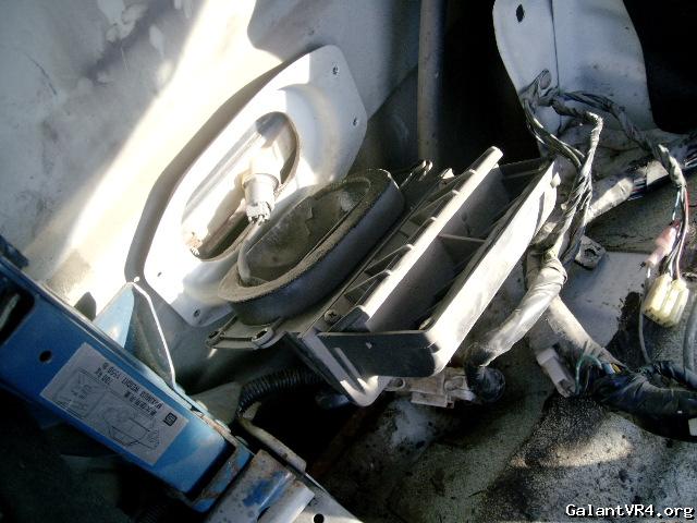

Not related to ABS, what is the purpose of this thing covering the rear side marker light?

The last thing pictured is just a vent. Lets cabin air out if you set your HVAC to fresh air.

how does it let air out? i see the vents in it any everything but there isnt anything there to move it or change it

There's another unit (maybe 2) immediately behind the gear leaver assembly, under the center console/arm rest. I'm pretty certain that's ABS related.
He's refering to a second g-sensor. It's right between the e-brake and shifter in the center counsel. There is a ton of wiring for the ABS. I personally just removed all of it recently. To pull all of it that runs from the trunk to the front, you'll have to pull the rear bench and driver's seat, along with the lower trim so that you can pull back the carpet. Then, just follow the loom all the way up. There is an ignition relay for it chilling in the driver side kick panel too.

well for right now i wanted to just remove the wiring in the trunk. im in the process of removing all the sound deadening in the back so ill the rear seating and trunk is all ripped apart. the harness that plugs into the control unit in the trunk, does all the wiring for that go up into the engine bay?
The wiring in the trunk all goes up to the engine bay, with the excepting of the g sensors and rear wheel speed sensors. There's a connector next to the fuse box under the dash where the rear harness attaches to the engine bay harness. The ABS is the only thing on that plug too, which makes it a little easier to sort through.
That said, if your only looking to remove whats in the trunk you can clip/tuck it at the rear seats. Just make sure that the fuses are pulled for it as well as the relay, especially if your cutting it. If your looking to remove the full chassis harness, its not that bad. I pulled it from the trunk, all the way to the fuse box in an afternoon after I got off work, including removing seats/trim. May as well just do it once, but its all a matter of how much you want to put into it.
