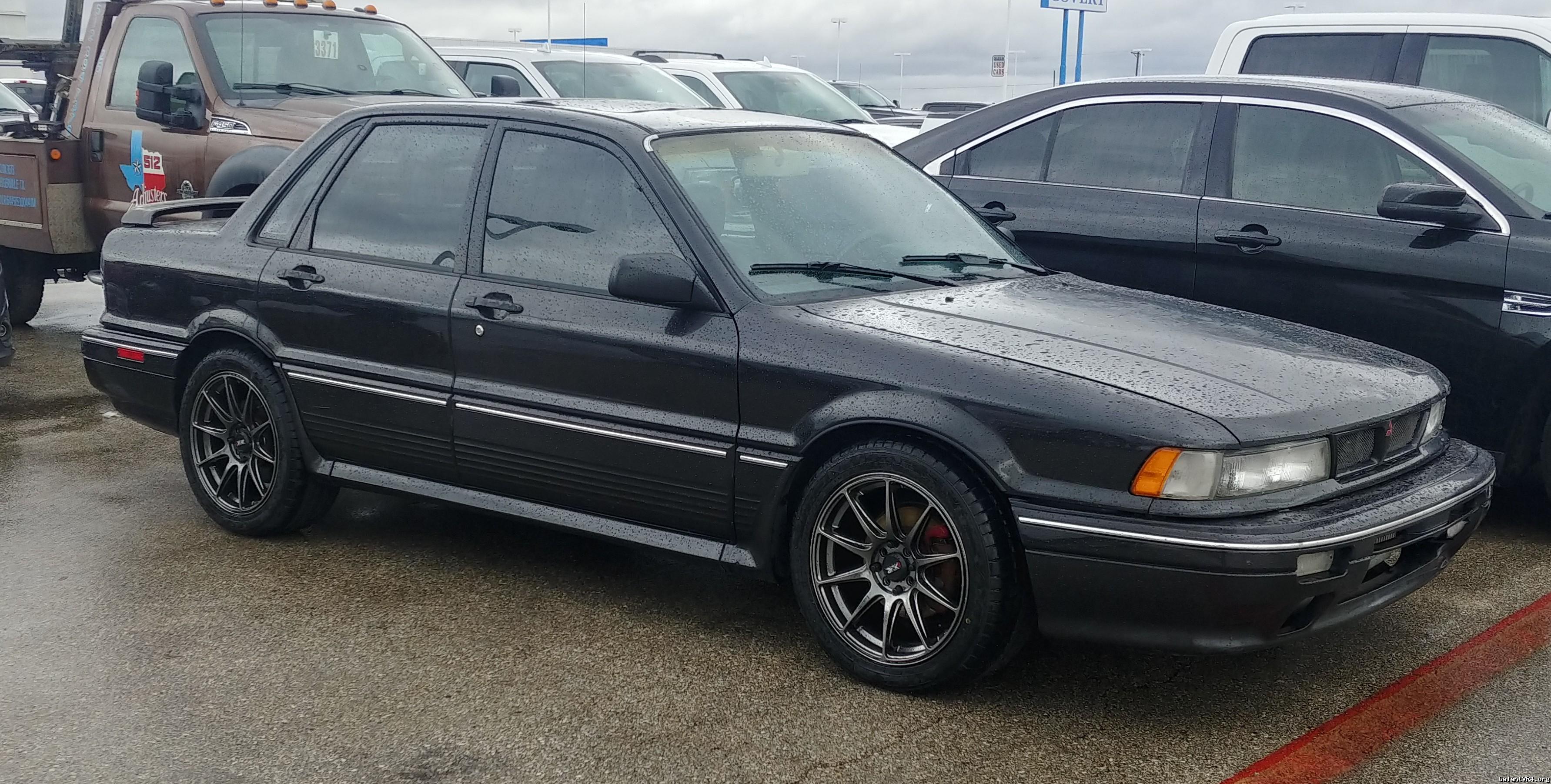

so i have a '91 galant vr4 lowered on h&r springs with kyb agx's. i am wanting to get the following wheels:
xxr 527 17x7.5 +40. These should fit just fine if im doing my math correct right? going to run 235/45/17's.
heres a link: click
heres the specs off the page:

cptncreme
Feb 28, 2018
7
Austin
They fit quite well, just need to get coilovers so I can adjust everything right where I want it

How is the spacing between the rim and trailing arm?

Do you have perfect roads where you are? 18's are asking for bent rims since you will have to be so thin on the rubber to fit. 17's present real well and allow enough rubber to protect.
