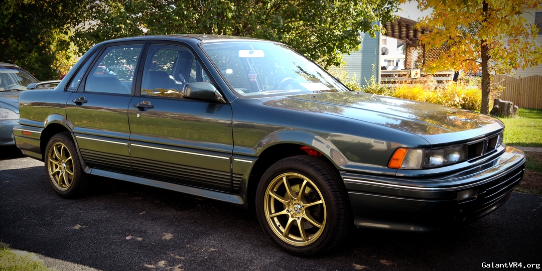

Now I'm down to one more problem to figure out. The waste gate isn't closing so it is leting exhaust exit though the dump which will draw all kinds of attention. I'm going to have to take the turbo back off and see whats up. I just thought I would shot a quick photo of her in the Sun. Which is not something I'm used to seeing. /ubbthreads/images/graemlins/dunno.gif

NICE 4x4!!!! /ubbthreads/images/graemlins/tongue.gif
