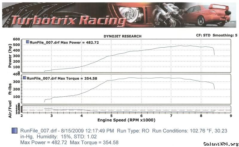

Now that's pretty good on 23 psi. It's a damn good power/torque line all the way to redline with more rpms left over if you want to go there. Now I have heard all the arguments about high rpm motors being 'pointless' because the head can't flow properly at such high rpms. But as I stated in the above thread I am looking at this from the point of view of speed. There seems to be a great deal of concern about power falling off at higher rpms but once you are moving and have momentum, far less power is required to maintain speed than is required to overcome inertia and accelerate. Since your crankshaft spins at a rate proportionate to that of your axles, as long as you are not slipping at the clutch or spinning tyres, the faster your engine revs in any given gear the faster you go. As long as you maintain 11,000 rpms you will maintain that speed, how much horsepower you are producing is irrelevant.

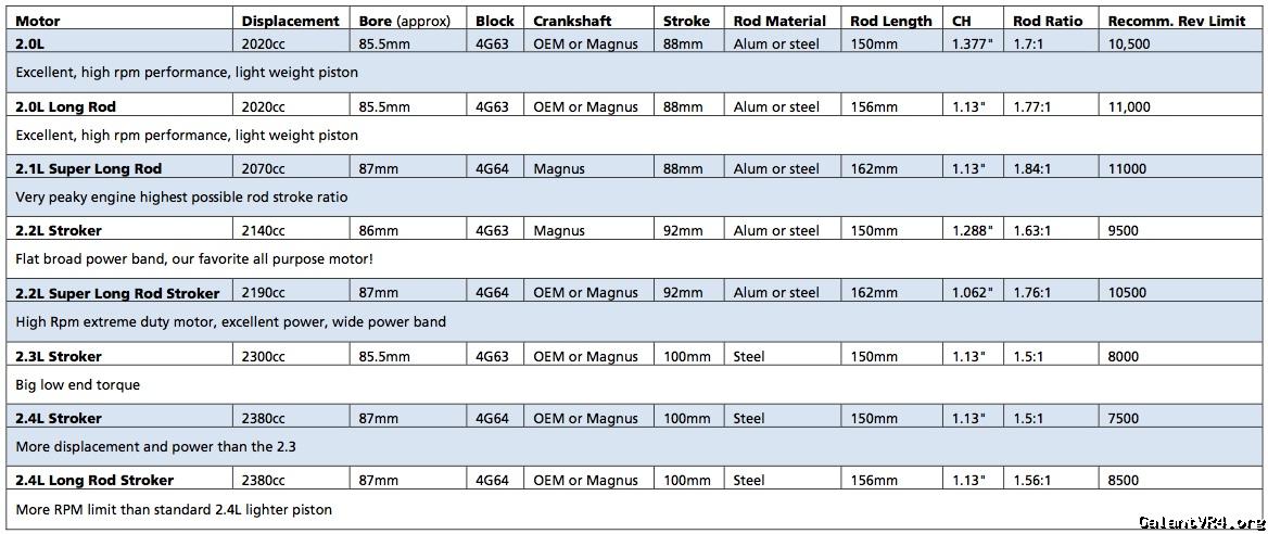

Right. Onto my final point for those of you still with me. These are the configurations for various different engines pulled shamelessly from Magnus' site.
The 2.1 litre has the best stroke/rod ratio at 1.84:1 but the 2.0 litre long rod comes close at 1.77:1 but uses only an 85 mm bore instead of the 4G64 87 mm bore (lighter pistons)

Car runs 22 psi on 93 pump and I have know idea how much power it makes but it is the fastest car I have ever owned. Including my 12.4@108 91 Talon. I would like to think it would be a solid high 11 second car and seriously think it could do low 12's on pump. It walks on my friends 12.7 LS1 Camaro.
I can't really comment on if the 2G head was a huge factor in the power my motor is making as I did everything at once but I can certainly tell you its not "choking" the motor in the slightest. The car makes GREAT power the second it comes on boost all the way to it's 7500rpm redline. Oh I also have my 22psi at 3k flat.
EDIT: Oh yeah since it seems to be coming up in the thread. Car runs on a stock head gasket and stock timing belt. I'm too busy beating the crap outta my car and actually enjoying it then "collecting parts" like most people I see.
