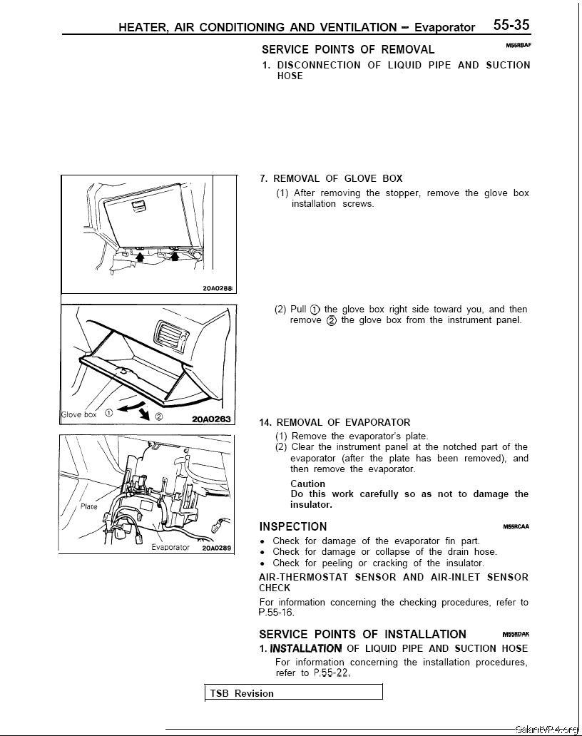

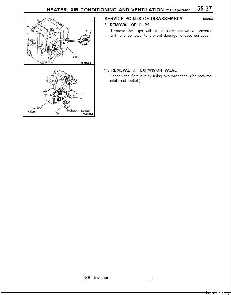

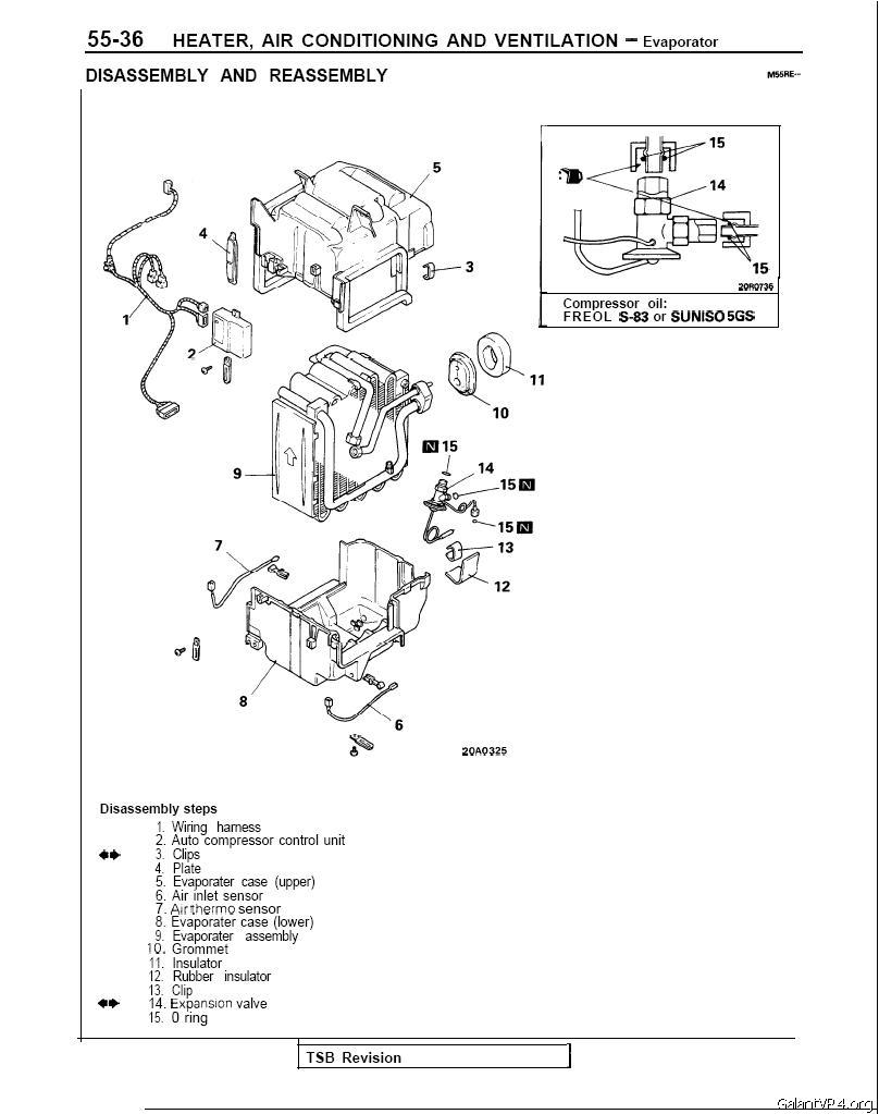

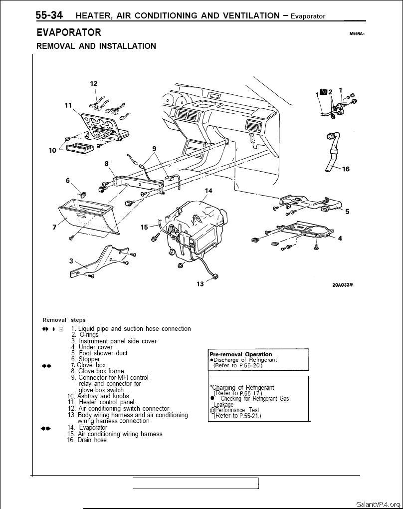

Some pages from the FSM that may help you out:

i pulled the evaporator. you can easily do it with the dash still in place. when i did the heater core, i had to pull the dash. you do have to pull the glovebox, then you access it from there. iirc, only 4 bolts/nuts hold it in place. i would never put a used evap in. think about it, any used one is gonna be 15 years old. if you like doing the job, go ahead. i only changed the expansion valve. you wont believe all the crap that gets in there.

Don't bother wasting money on a new part, just get one off the board in good condition. I would check that its not simply an O-ring at the firewall(2 O-rings) or expansion valve(3 O-rings). It's pretty rare for an aluminum evaporator to spring a leak. Not impossible, but far less likely than an O-ring. The O-rings on the other hand are rubber, they are the only thing keeping the refrigerant in the system. After 14 years they are the weakpoint in the system. I say pull the evaporator and inspect it before forking up money for a new one.
Replace the expansion valve (about $50) and drier (about $45) and all the O-rings in the system.
