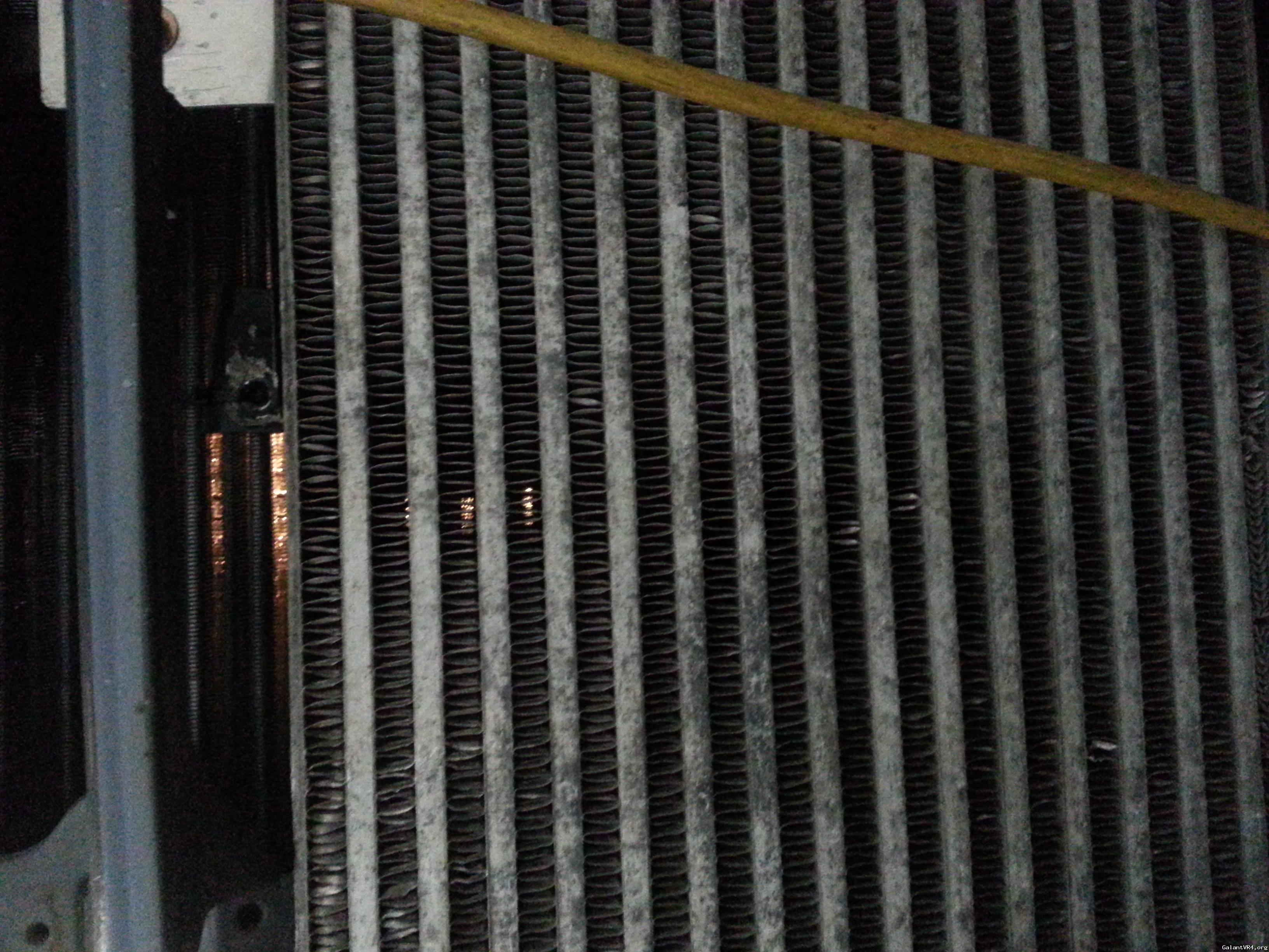

If you can see light through all 3 you should have good airflow.
Sideways pic FTL
