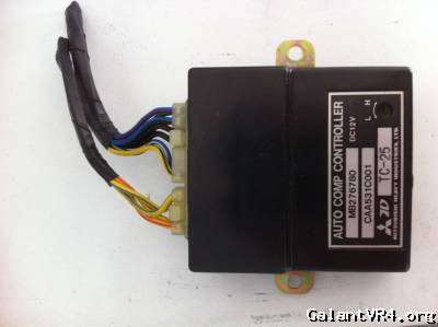

Swap out the air conditioning controller. ("Auto comp controller") Behind the glovebox, somewhere near the ECU, IIRC.
If the compressor is turning on, can this still be the problem? Judging from the circuit diagram, the comp contoller simply monitors a few sensors and either enables the voltage feeding the compressor clutch relay or disables it. Is there somthing else it does?
