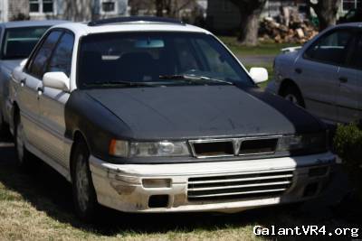

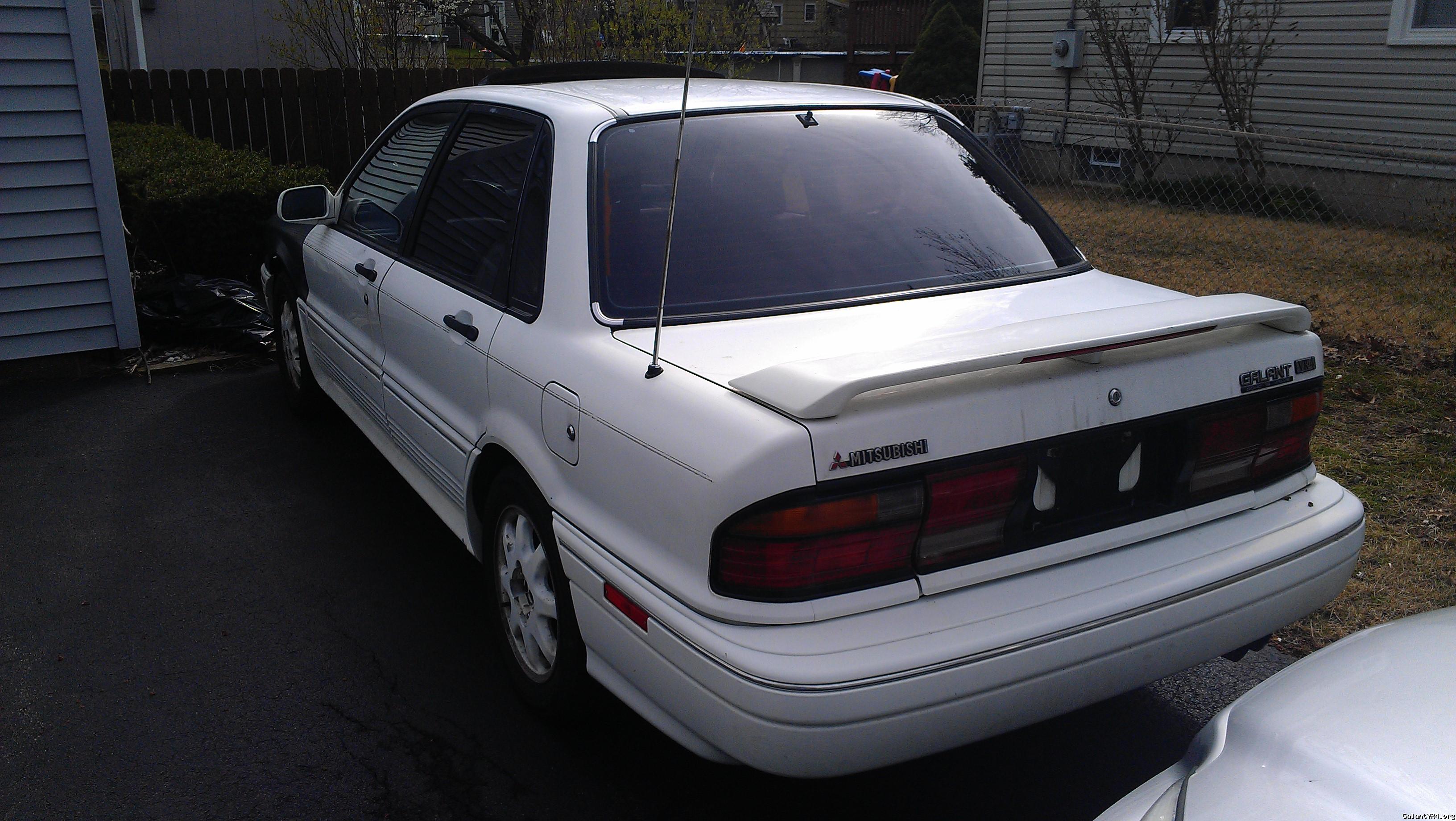

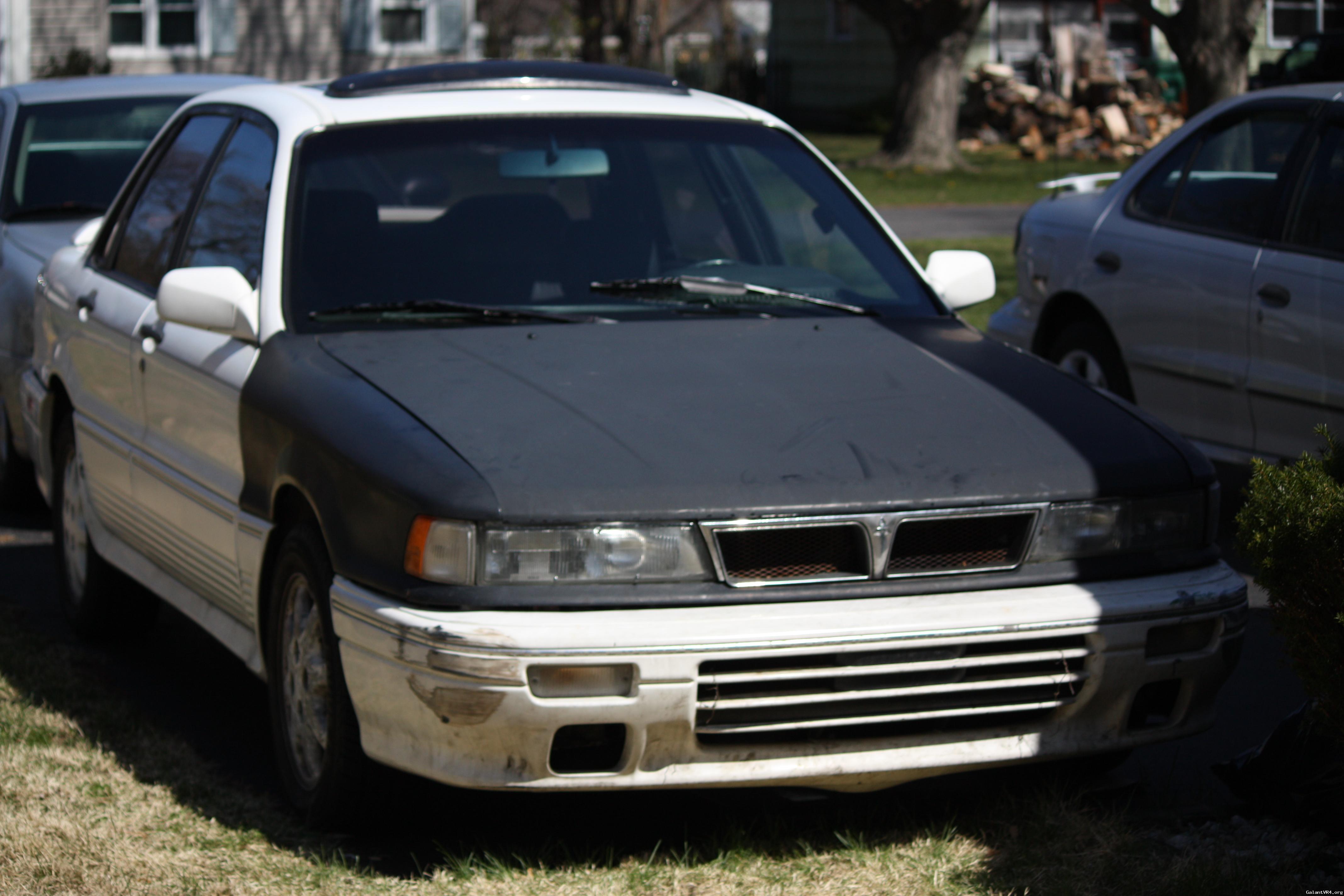

Just picked up this car. Has a bit of issues, no shocker. Needs some heart and soul put into her, then she'll be a great DD.
