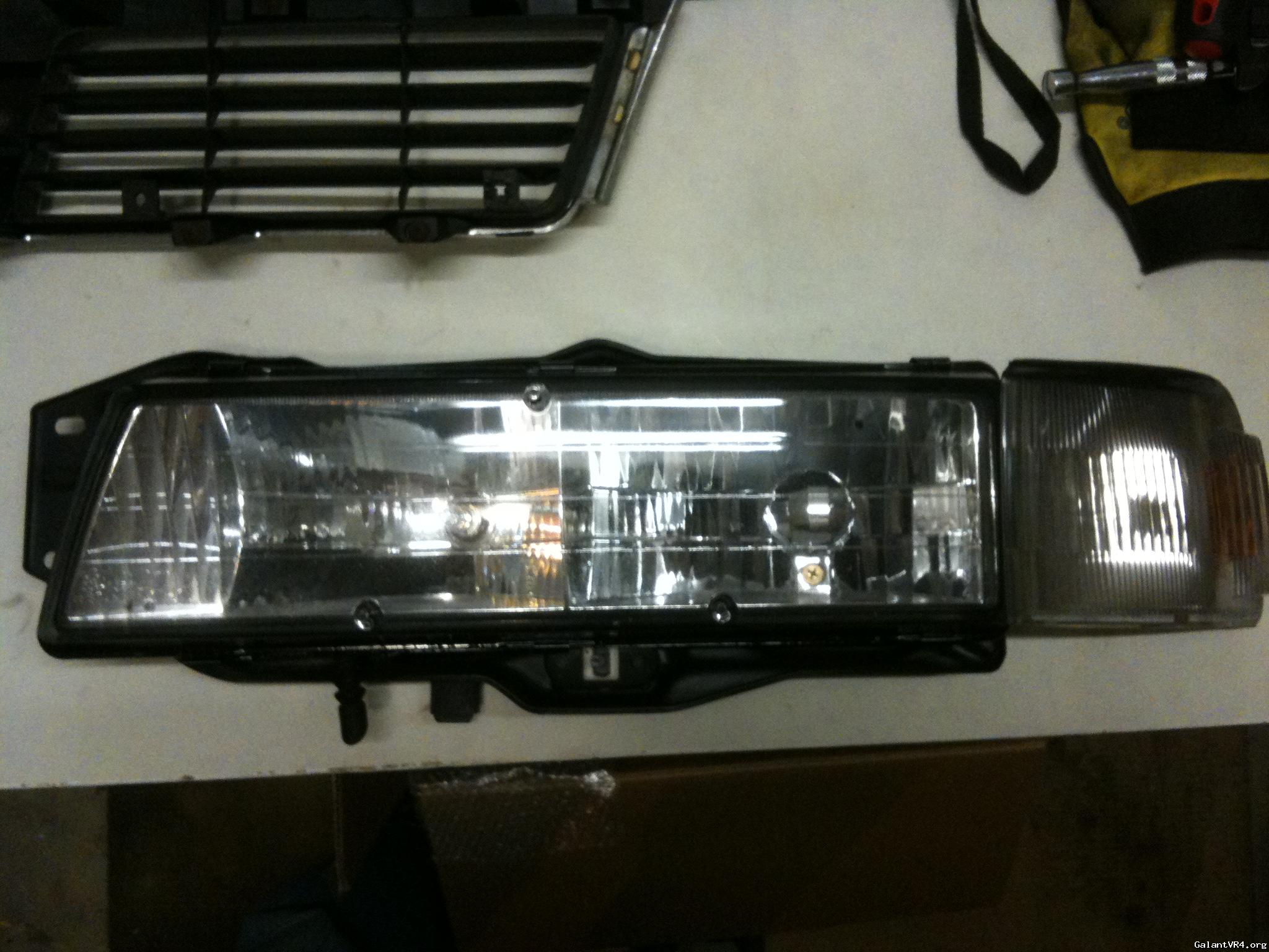

I just finished mine... I had reduced about 3 sets of lights down to 2 93s. Took the best adjusters, bolts, screws, vent tubes, baskets, etc.
I've never liked the asymmetrical look of just the painted top, so I paint mine all the way around.
Also been bugged by the corner lights appearing to taller than the headlights because of the black paint, so I painted eyelids on mine. We'll see in a couple weeks how it looks on a car.
Sorry about the cell phone at night pic.

Looks good, Hertz. Good idea on the corner light eyelid as well. I noticed they're taller than the headlights, but once on the car it's hard to see that unless you're really looking.
I should have taken pics of the '93 lights I got from Jepherz. Even though they were in good condition, I still redid the black on the glass as well as repainting all the bracketry, etc. Makes them way nicer redoing everything.
