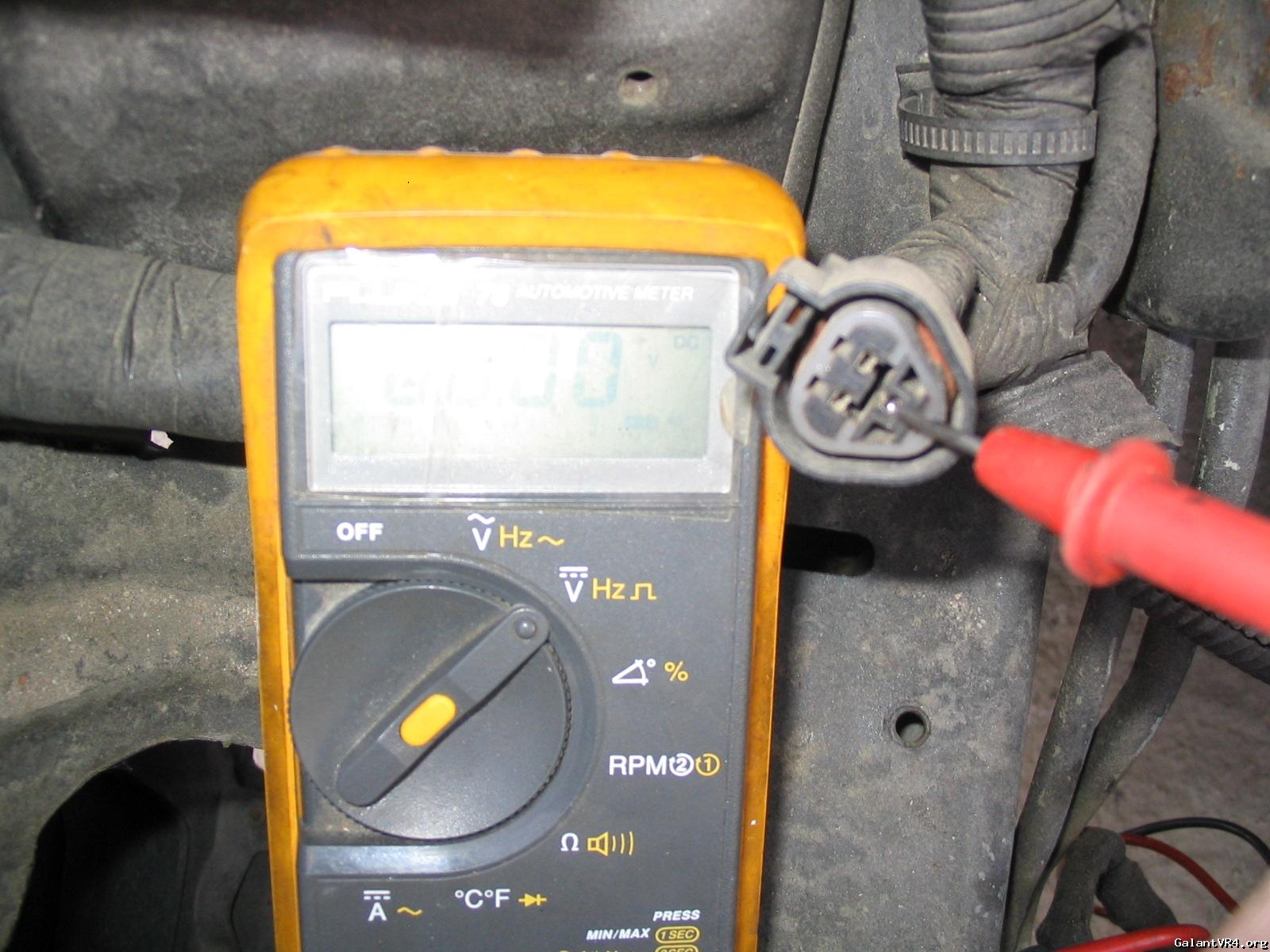

I would get out my multimeter and verify battery voltage and compair it to the starter trigger wire while having someone turning the key. If you see voltage at that wire matching your battery voltage or very close then you know you need a starter. If not, then you have either a bad battery, cable, or your alarm is the culprit. Try googleing the model number and Find an installation guide and see if you can bypass the wires for the anti start feature.

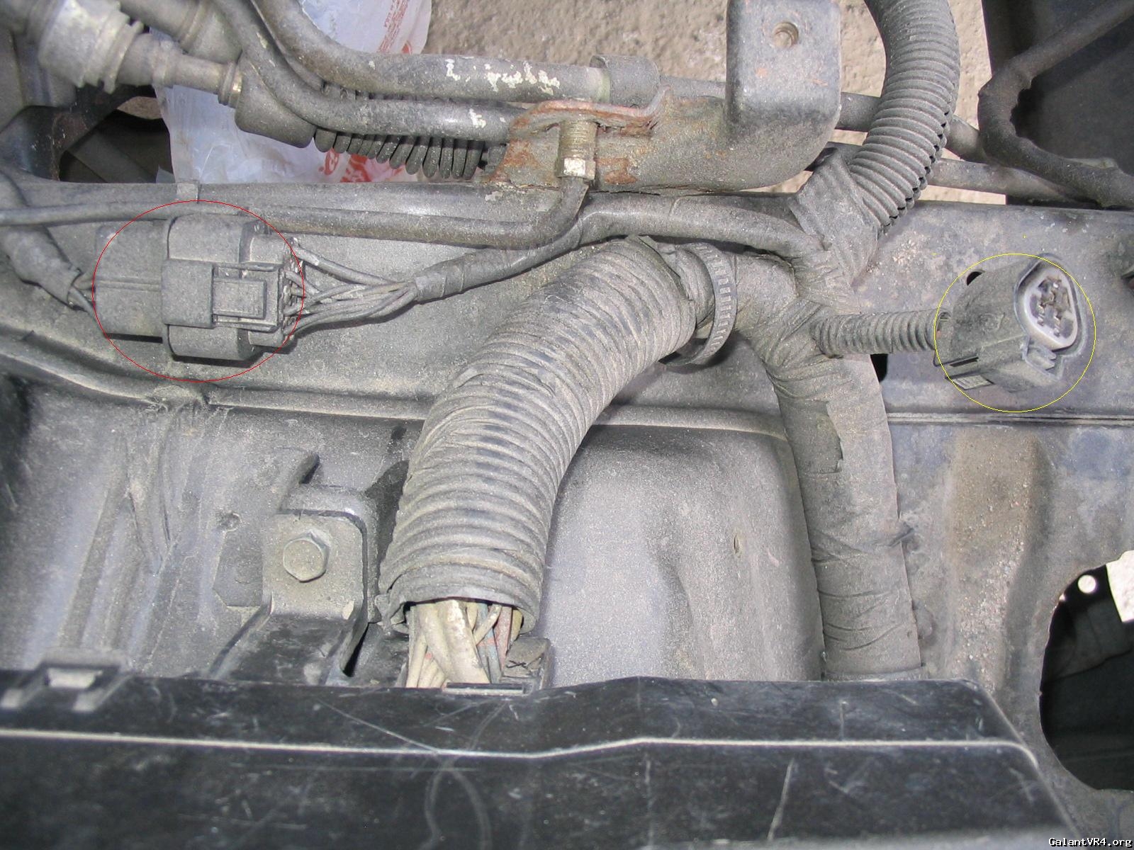

On the passenger side unibody section in front of the strut are a few mission critical harness connectors. They are somewhat hidden by the airflow meter and other stuff, so they're hard to see.
Circled in red, the rectangular connector is the power distribution connector for the car.
Circled in yellow, the triangular connector is the connection down to the starter solenoid.
If they are both plugged in, and the car won't crank, (as in rotate when you have the key in the start position) unplug the starter harness and check for power at the car side of the harness while the key is in the start postion. (you're checking the black with yellow stripe wire)
If there's nobody home on the car side of the starter solenoid harness, unplug the clutch down switch and try again. The switches go bad, and the little yellow plastic button that depresses it also gets broken. This will prevent the starter from operating. Unplugging the switch opens the interlock circuit, and will allow the starter to operate any time the key is in the start position.

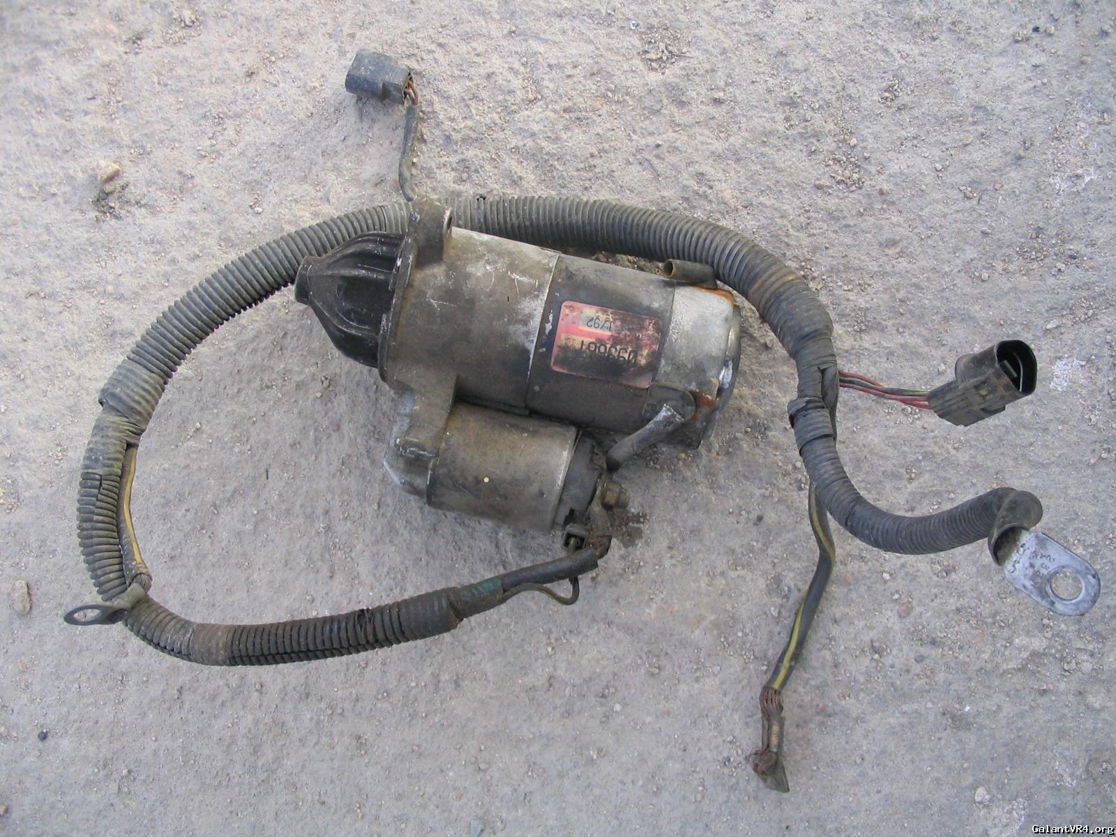

Here's a pic of the whole starter sub-harness to give you an idea of what you're working with.
