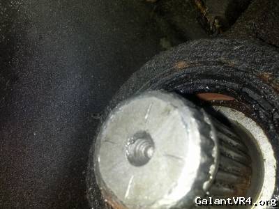

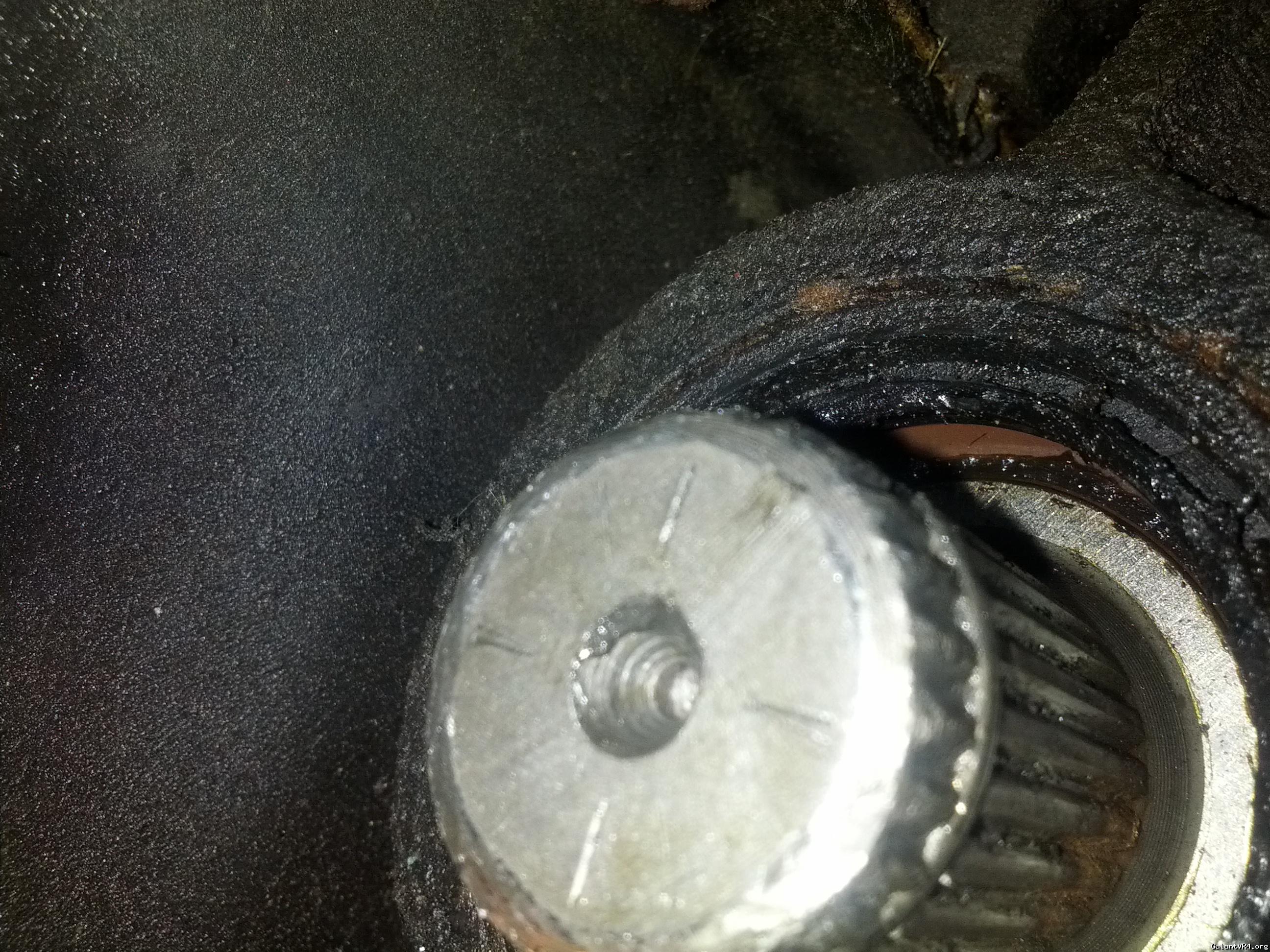

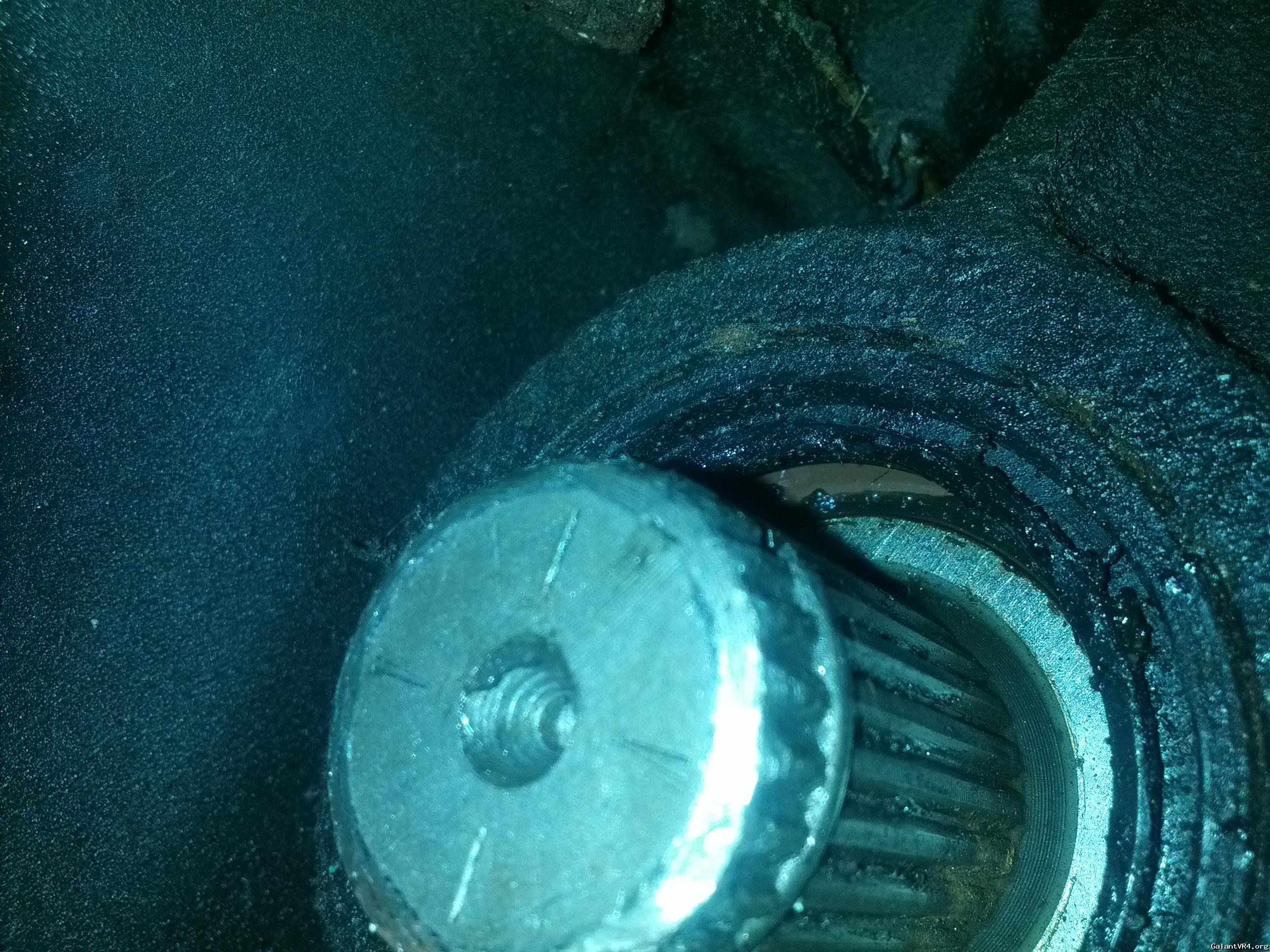

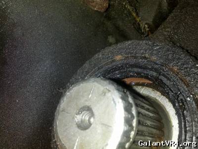

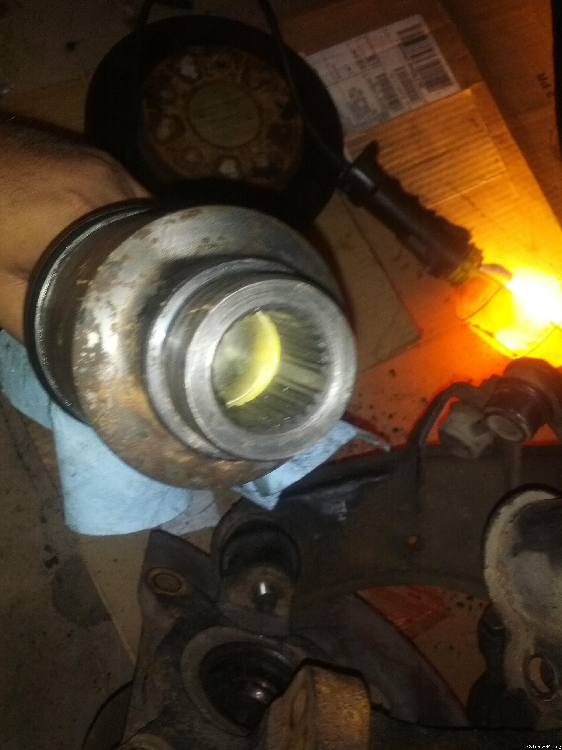

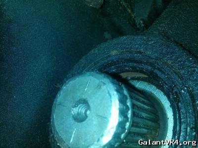

The driver side half shaft poped out and now it will not go back on. When I look at the tranny shaft splines they are crooked and do no line up how is this possible ? And why is there a notch inside the half shaft? Any help would be gtreat

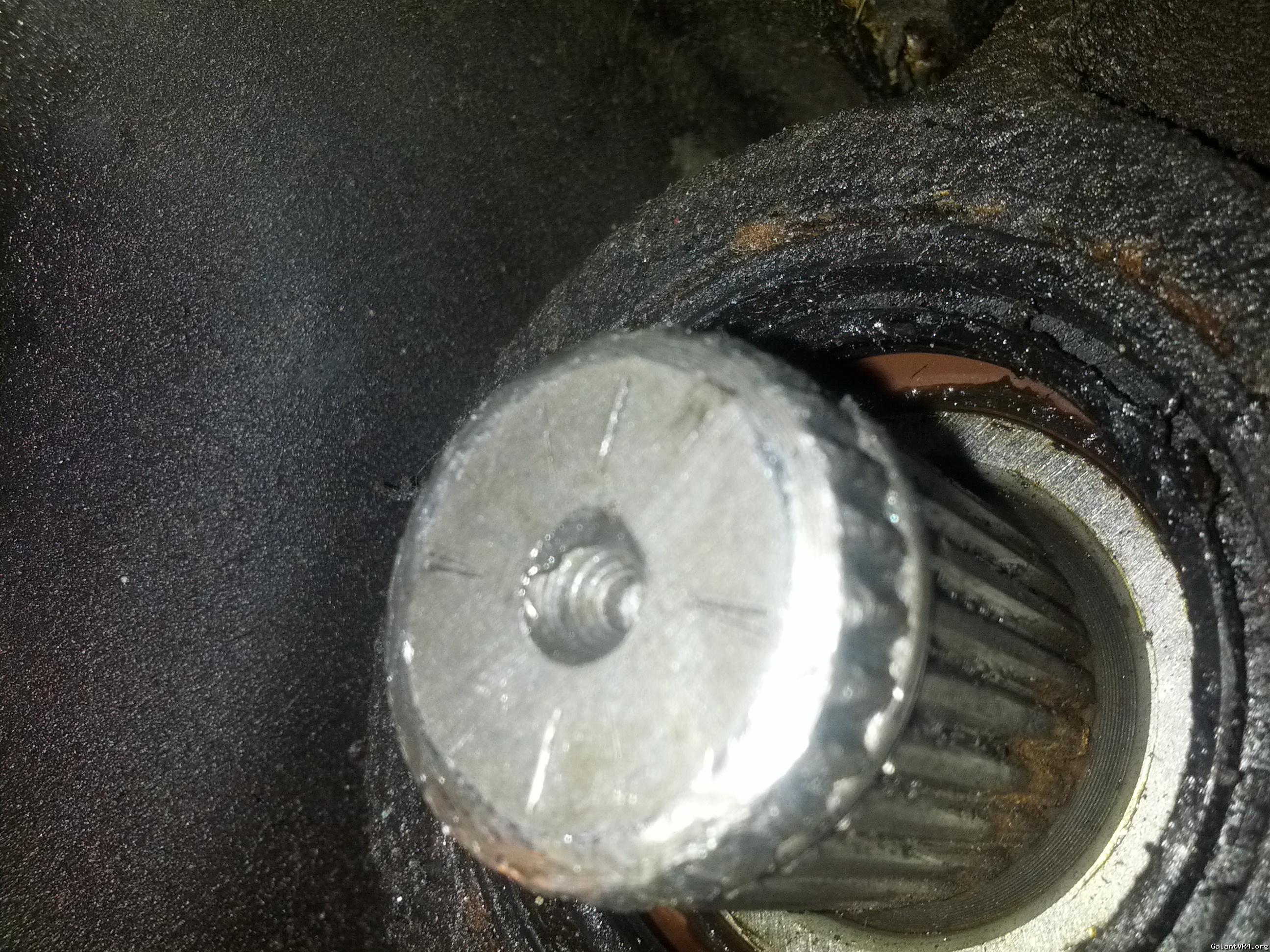

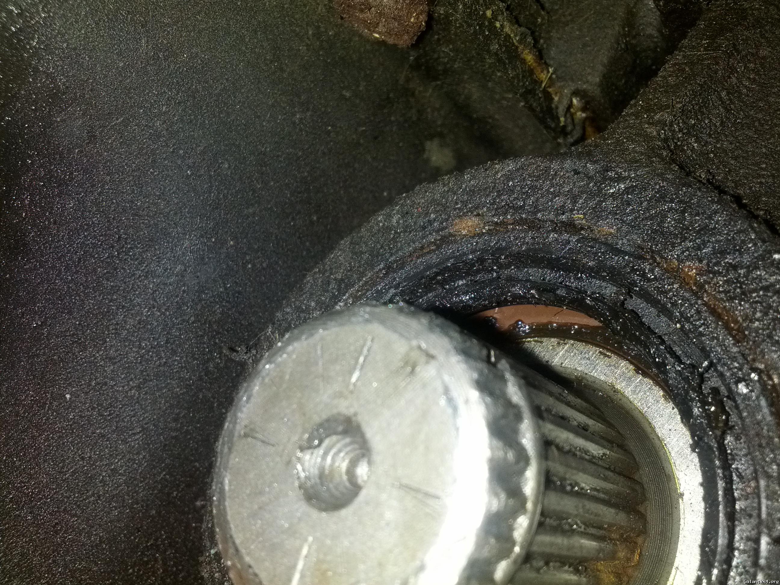

Looks like the lat IoM it was apart,it was not seated fully and it was drove on. The only part of the splines that were driving the wheel was the part before the clip.
Time for a new half shaft. No fixing that.

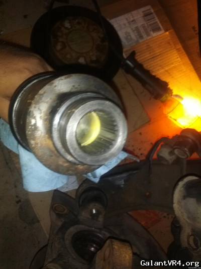

The male spline part is toast. If the female socket or clean, it should be just fine to reused.
Look carefully at the spline high and lows and make sure there is no wearing. They should be straight and have defined grooves that are not worn to sharp points.

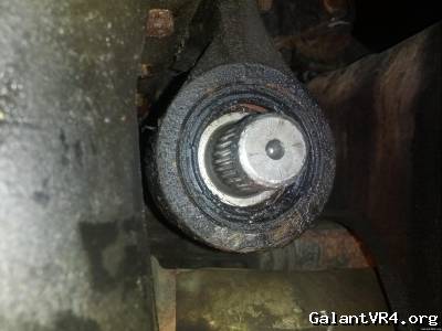

One last thing are there any online guids that show how to remove the tranny shaft . do i have to replace the 2 seals/bearings for the tranny and the support bracket seen just behind the tranny shaft in my pics thanks again

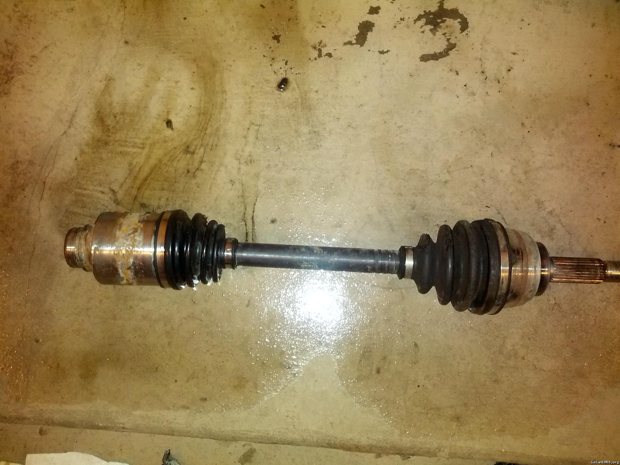

Not even close to the same. AWD has equal length CV shafts, and the first thing you posted pic of is basically an equalizer. FWD vehicles do not have this, unless someone upgraded it to equal length halfshafts to help alleviate torque steer. So, the likelihood you'd find this on a FWD in a junkyard is pretty much zero.
Check the partout threads, and check with Nate for spares. He might have something lying around from a partout he can ship/sell you. I could be wrong, but it LOOKS like you should just be able to put that back together and run it, so long as the circlip will still hold the halfshaft properly. Maybe you can clean it up and stick it back together.
EDIT: nevermind, i just saw the last pic and enlarged it. You need a new inner halfshaft. (the equalizer part)
