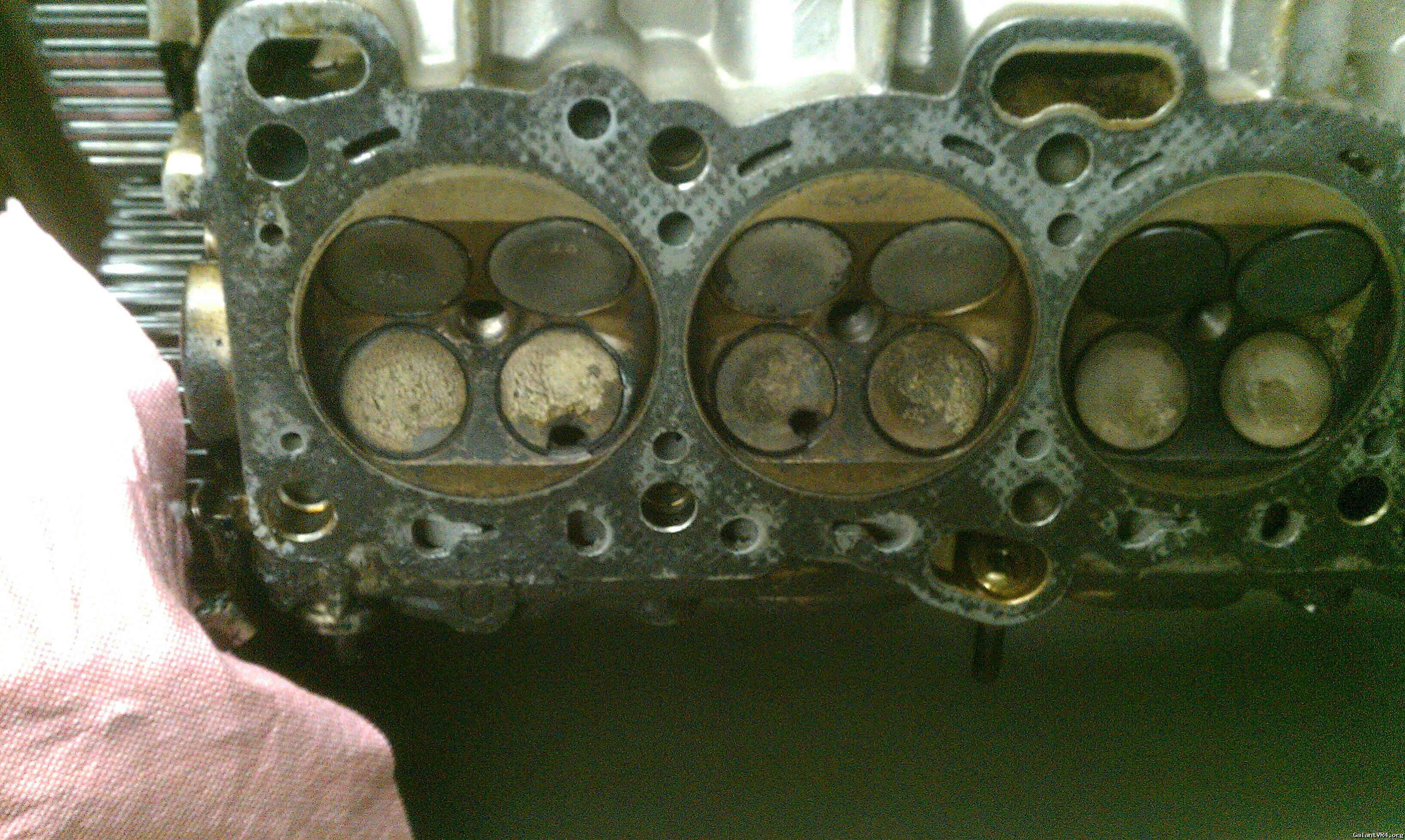

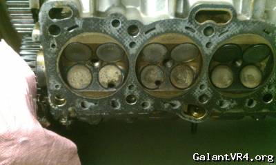

UPDATE: I took my head off yesterday and found my problem, Two valves where burnt. What could cause this to happen, just from old age? knock? anyway im getting a valve job done to it, hopefully get it runing by the weekend.
Any help on why this happend would be appreciated thanks.

might be the incorrect timing, P/O might of been messing with the timing to componsate for the bad idle. /ubbthreads/images/graemlins/dunno.gif

is interesting they both went at the same time! unless one got burnt and the low compression on one cylinder wasn't enough to notice until the other went bad.
