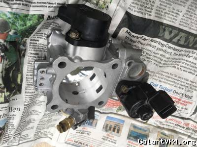

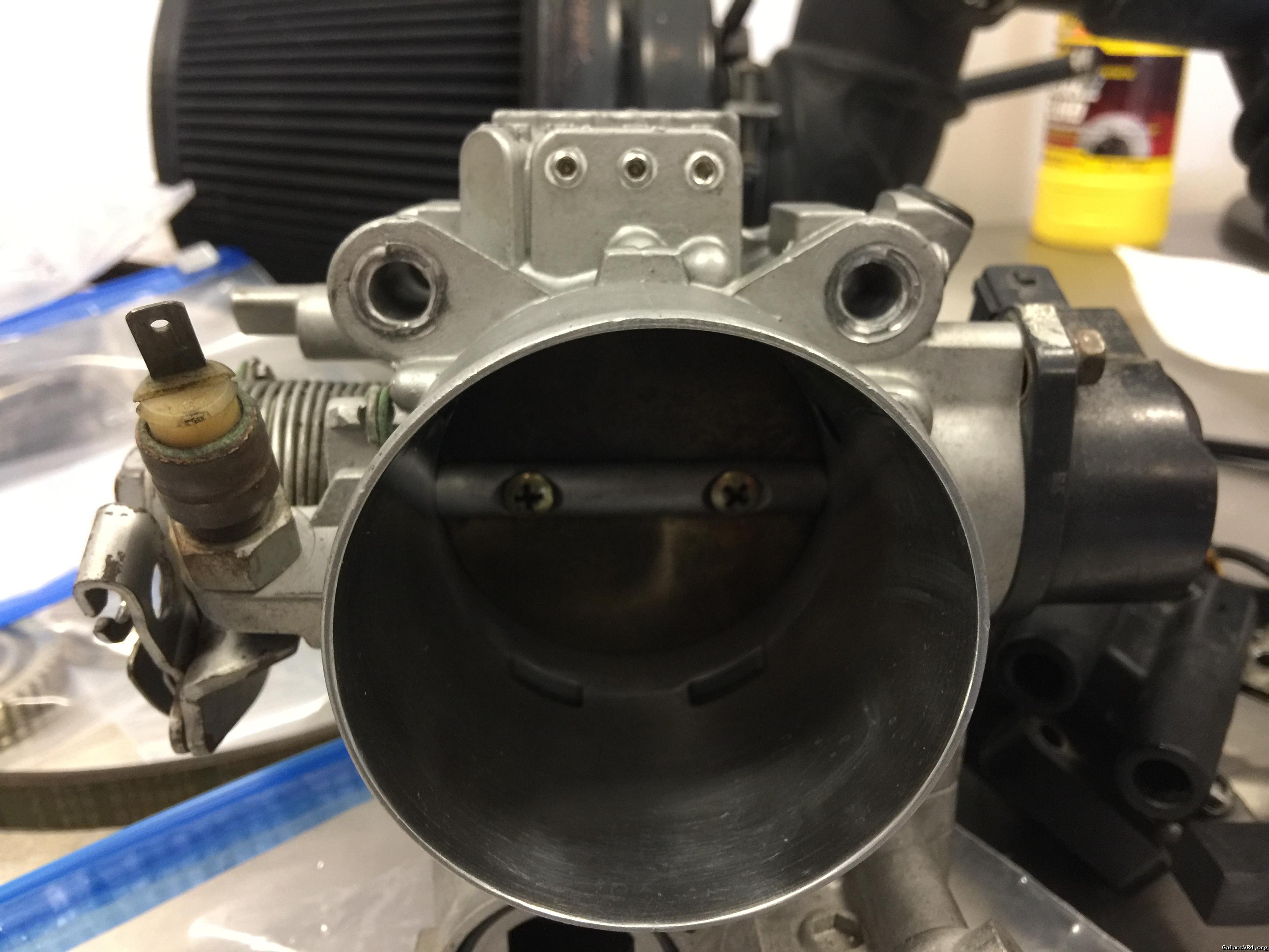

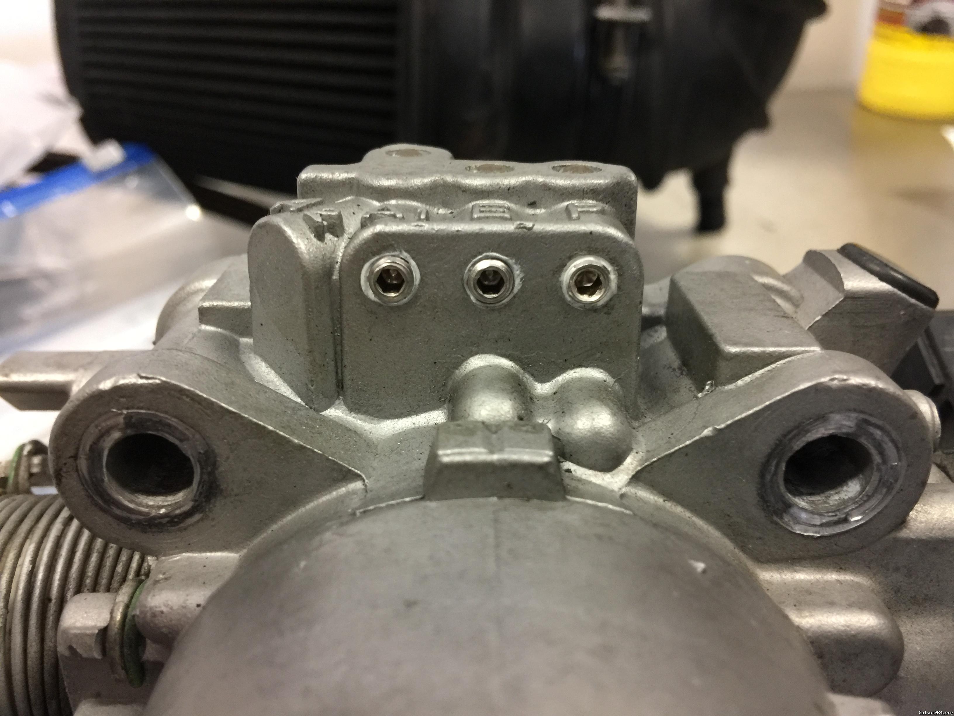

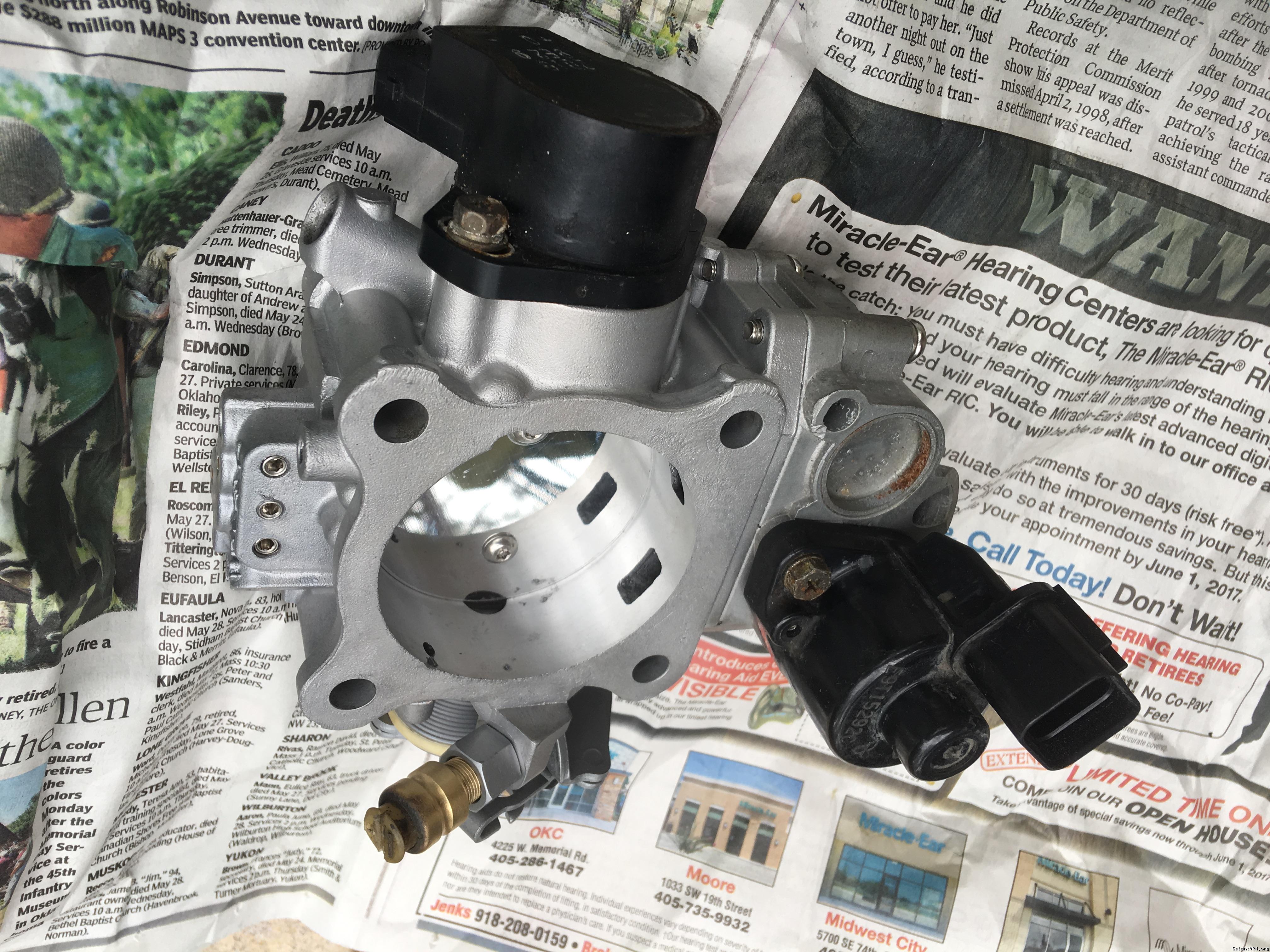

This short post took some time to put together but I'd like to publicly thank Chris a la 89Mirageman for his professionalism, eye for detail, and for helping a fellow forum member out.
At the time and still to this day, I have yet to make the leap to Speed Density so all those pesky vacuum ports are still running rubber vacuum caps to include the three on my throttlebody. One day I had noticed a post Chris had made where he decided to modify his throttle body by removing his vacuum ports and sealing them off with set screws. It was such a clean and professional looking install I decided one day I'd follow suit. Chris being the gentleman that he is, was kind enough to explain the process via PM and on the horn. I didn't feel comfortable with performing this modification on my throttlebodys.com throttlebody so once again, I phoned up Chris and sure enough he offered to square me away.
In less than 3 days I received the following:
I was pretty pleased and couldn't have been happier with the outcome. Thank you Chris!

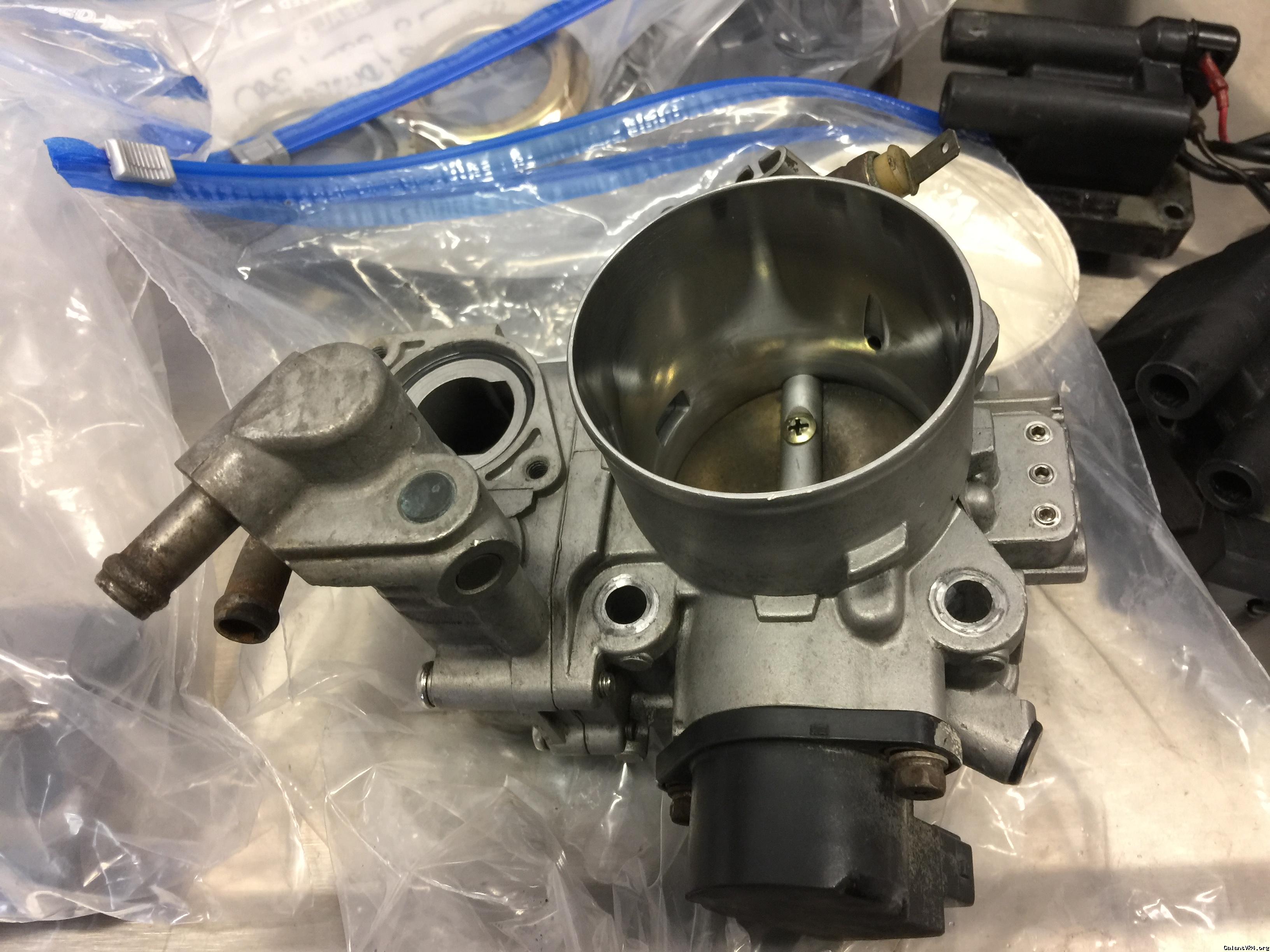

Since I like to keep a functioning ISC, I've also been machining off the water lines to the FIAV and then capping the area off with a freeze plug. Cleans it up the tb nicely while keeping all the function I need.

It is internally blocked off. My other TB's were blocked off inside with JB Weld long before I started machining the lines off for simplicity and esthetics. Same thing as using one of the block off plates that allows you to retain the ISC.

On another note for people looking to keep functionality with respect to the use of the nipples (that wouldn't or don't want to use silicone caps on the nipples), one could solder the nipples shut and keep spares in case they wish to sell the throttle body as fully stock functional and not being reversible where the plugs get tapped into the base material. You can twist in new nipples or drill out the solder!
It looks really good and professional when it's done like Chris has shown us. Takes a steady hand a bit of nerve to want to do this mod, and not just once for his own stuff, but for others too.

So I would still need to use the JB Weld or a block-off plate even if I remove the water line housing and tap in a freeze plug? The smaller holes that are still left open right beside the plug, do they actually go to anything or do they need to be blocked too? How did you go about removing that? Just cut it off and sanded it smooth?

Yes, the passages still need to be internally blocked off or use a plate just like you would normally do to delete the FIAV. The machining of the lines is just cosmetic. No need to plug the holes where the water lines were, but you could thread them and add a couple set screws if you like. I may try that with my next one. We used a band saw to remove the main bulk and then used a mill to machine the rest flat. Freeze plug from the parts store to seal it up.
