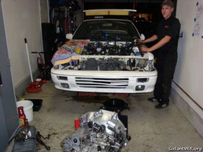

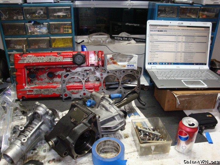

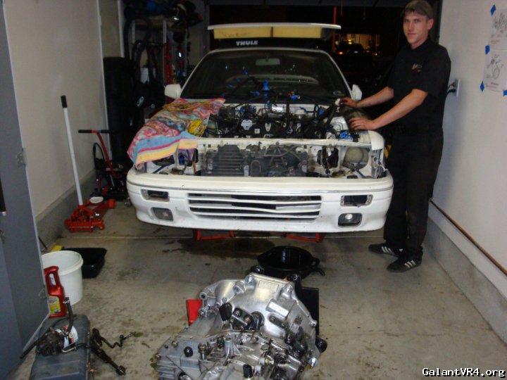

Welp, I need to have the car back together in a month so I can drive it back to Michigan. I have been working vigorously for the past couple of weeks now, and am almost to the reassembly point. This should be a very clean car, and I would like to keep it that way. From my experience with Michigan cars, I am tempted to keep this thing sheltered for the winter, b/c it is 100% rust free. I am fairly new to VR4's so any advise is nice. For now here is my pride and joy...

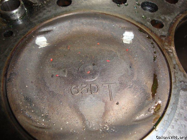

Wiseco 8.5c/r HD Pistons .020 over

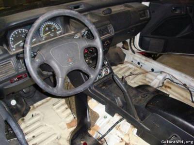

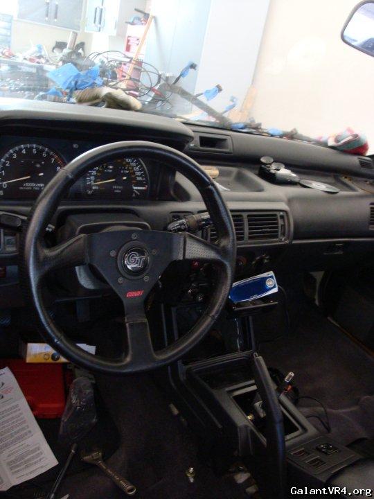

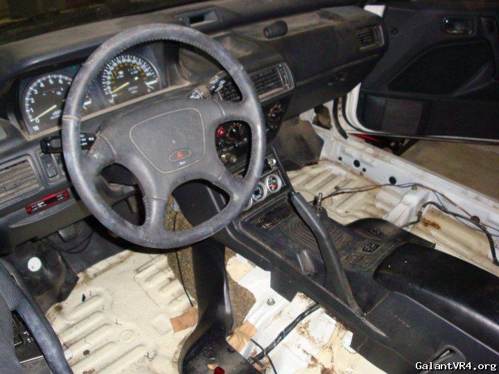

completely stripped and cleaned interior/reinstalled
replace EVERY gasket/seal

Bore/honed .020 over

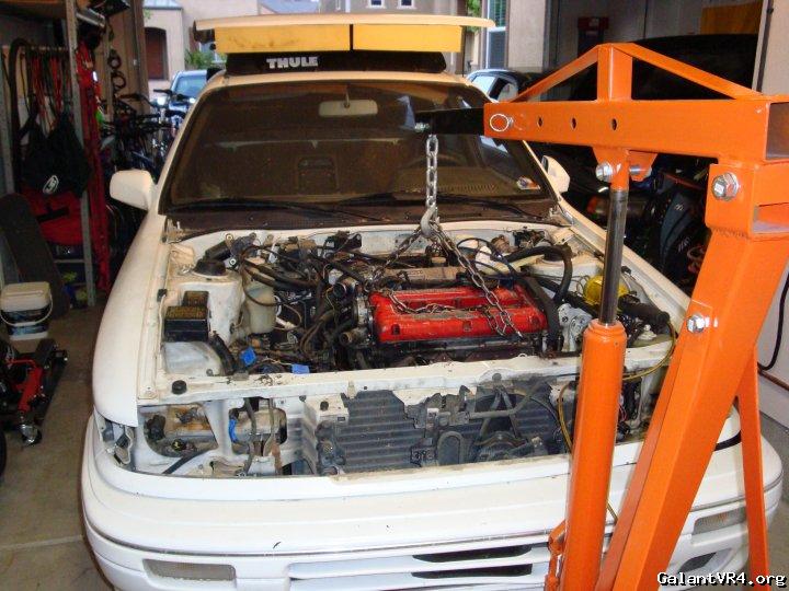

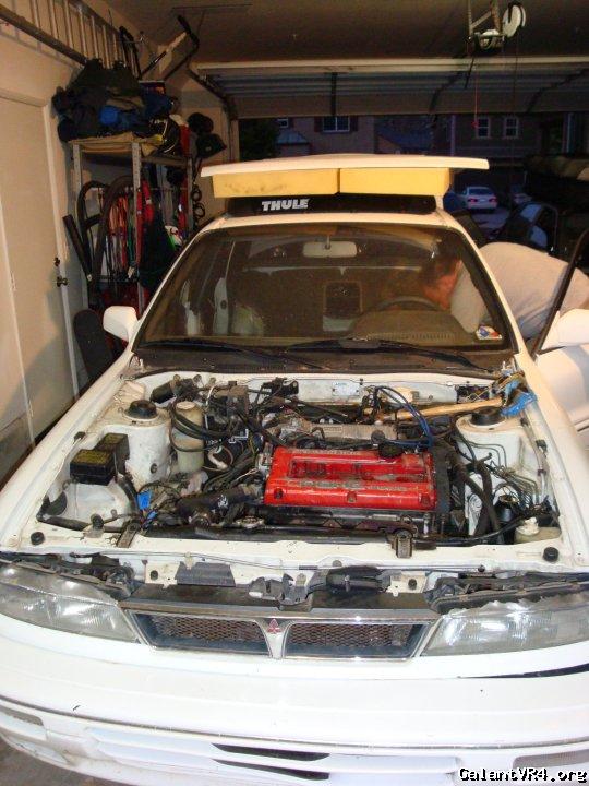

Here are just a few pics

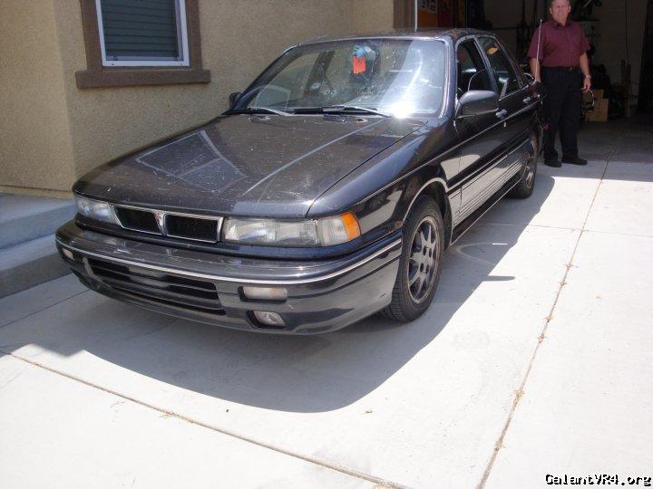

poor old girl (Michigan car = rusty) recently sold

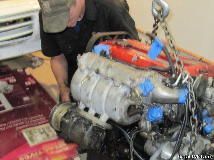

Getting some help from the experts...
