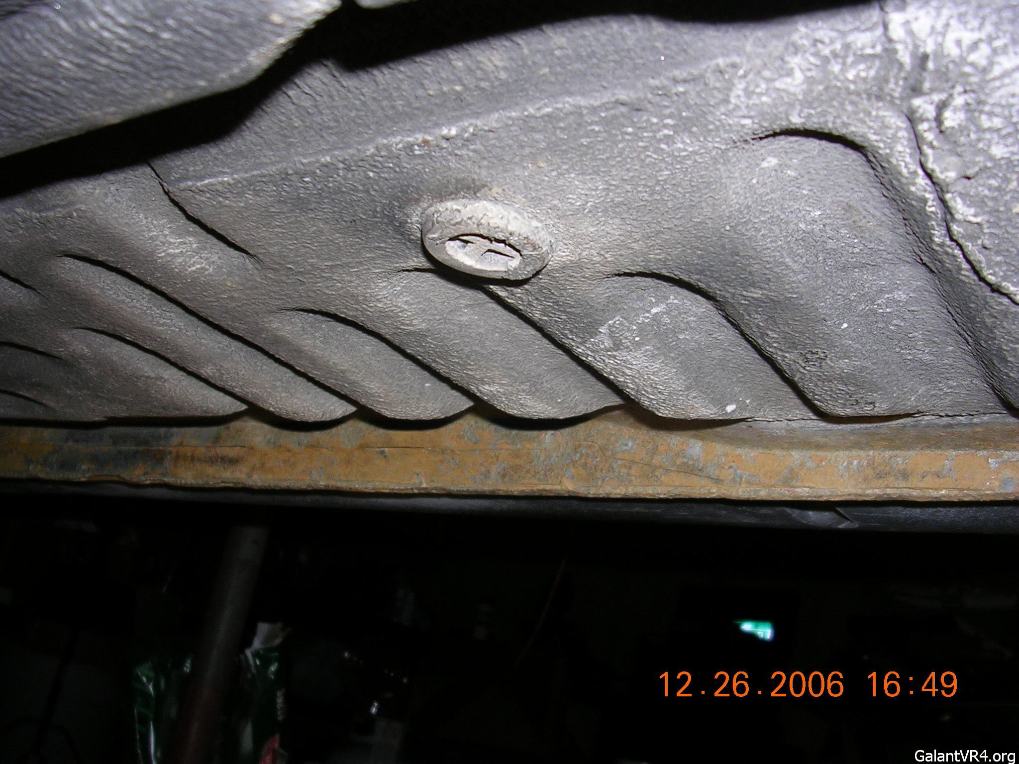

Stripping undercoat is a complete bitch. Instead of stripping all of it, I may strip around the edges and where there are holes from the factory. I have noticed that there tends to be surface rust UNDER the undercoat around the edges where there are holes from the factory. I fortunately have not found any new holes from body rot. In general, the shape of the car is pretty good. I was surprised how good of shape it was. There are definitely some areas that will be focused on, but overall, I shouldn't have anymore than 50 or so hours under the car stripping and undercoating.

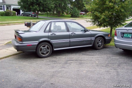

When I first Got it...

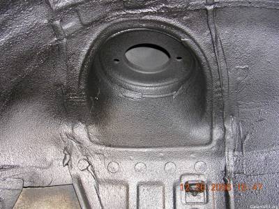

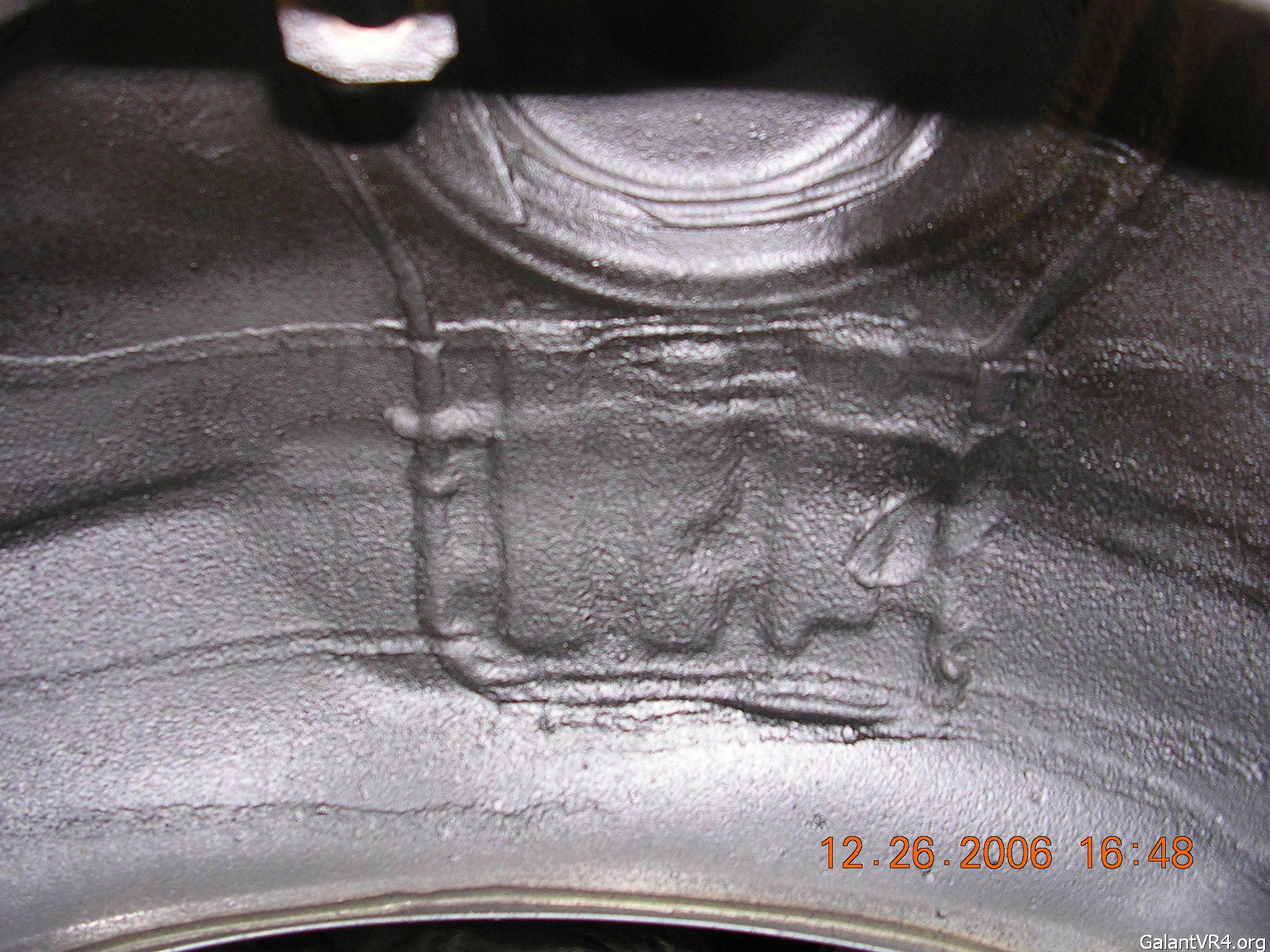

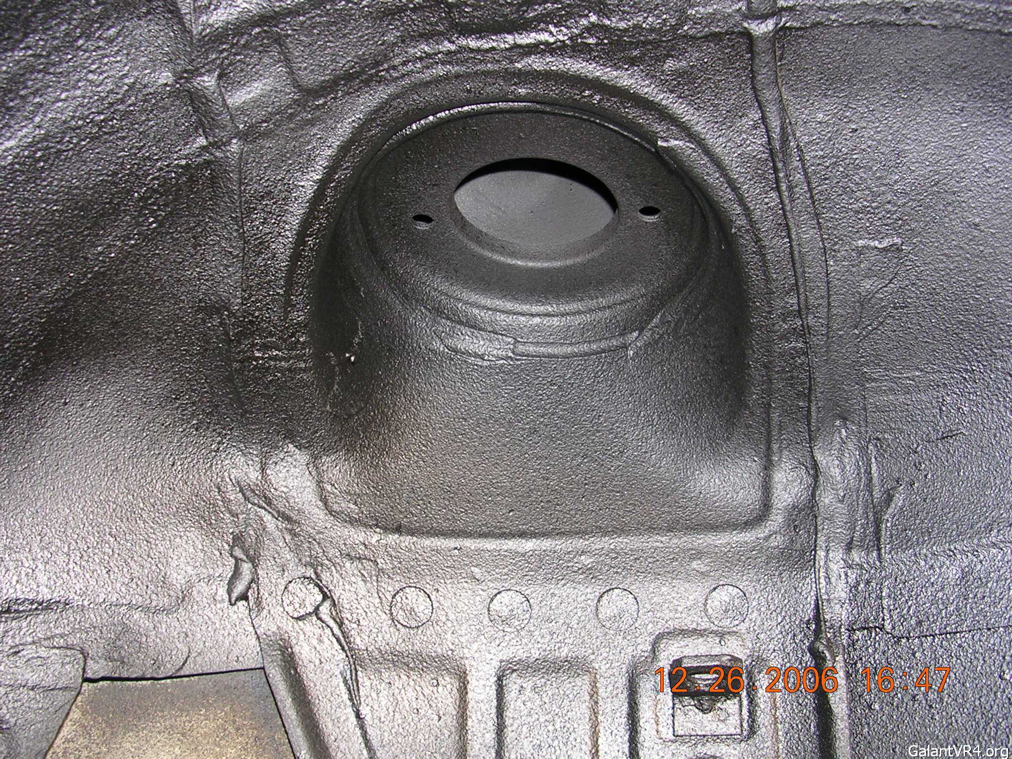

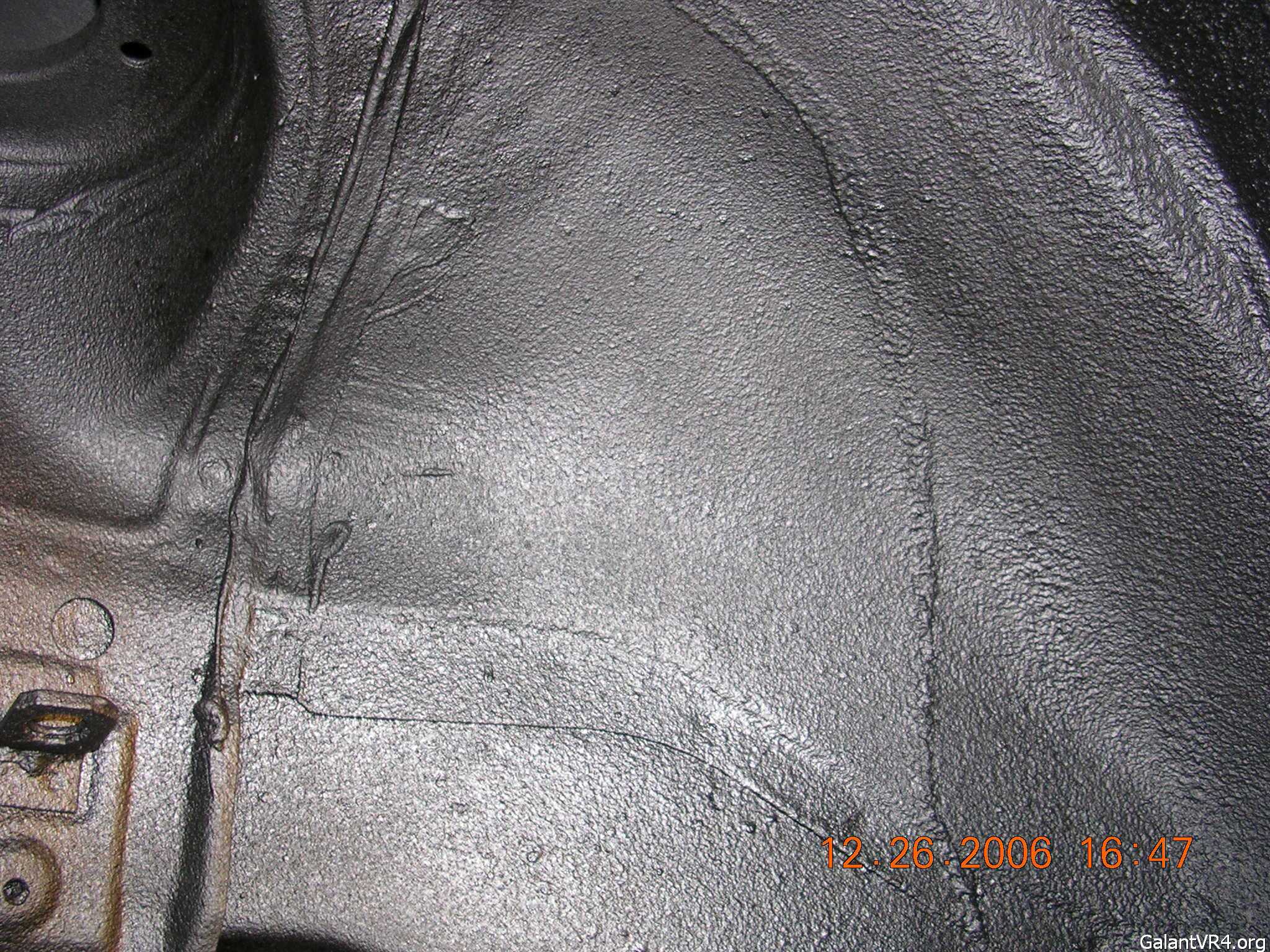

Like I mentioned, I started to do some work on the underside of the car. Here are some pictures of the finished rear passenger wheel well cleaned up and freshly re-undercoated...

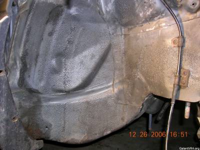

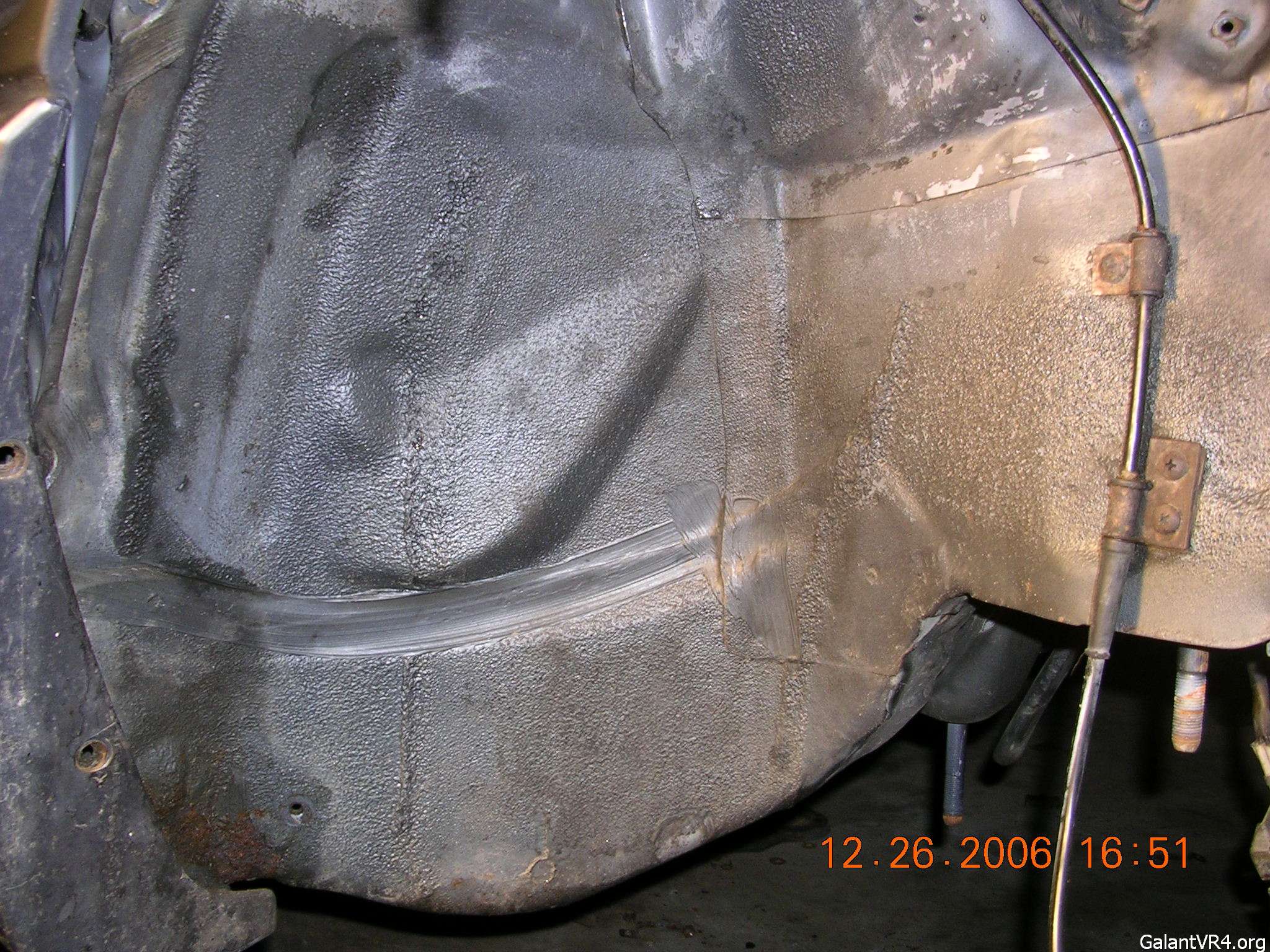

I also started working on the front passenger's side wheel well. I didn't finish it tonight, but I got a pretty good start. Pretty clean, eh?

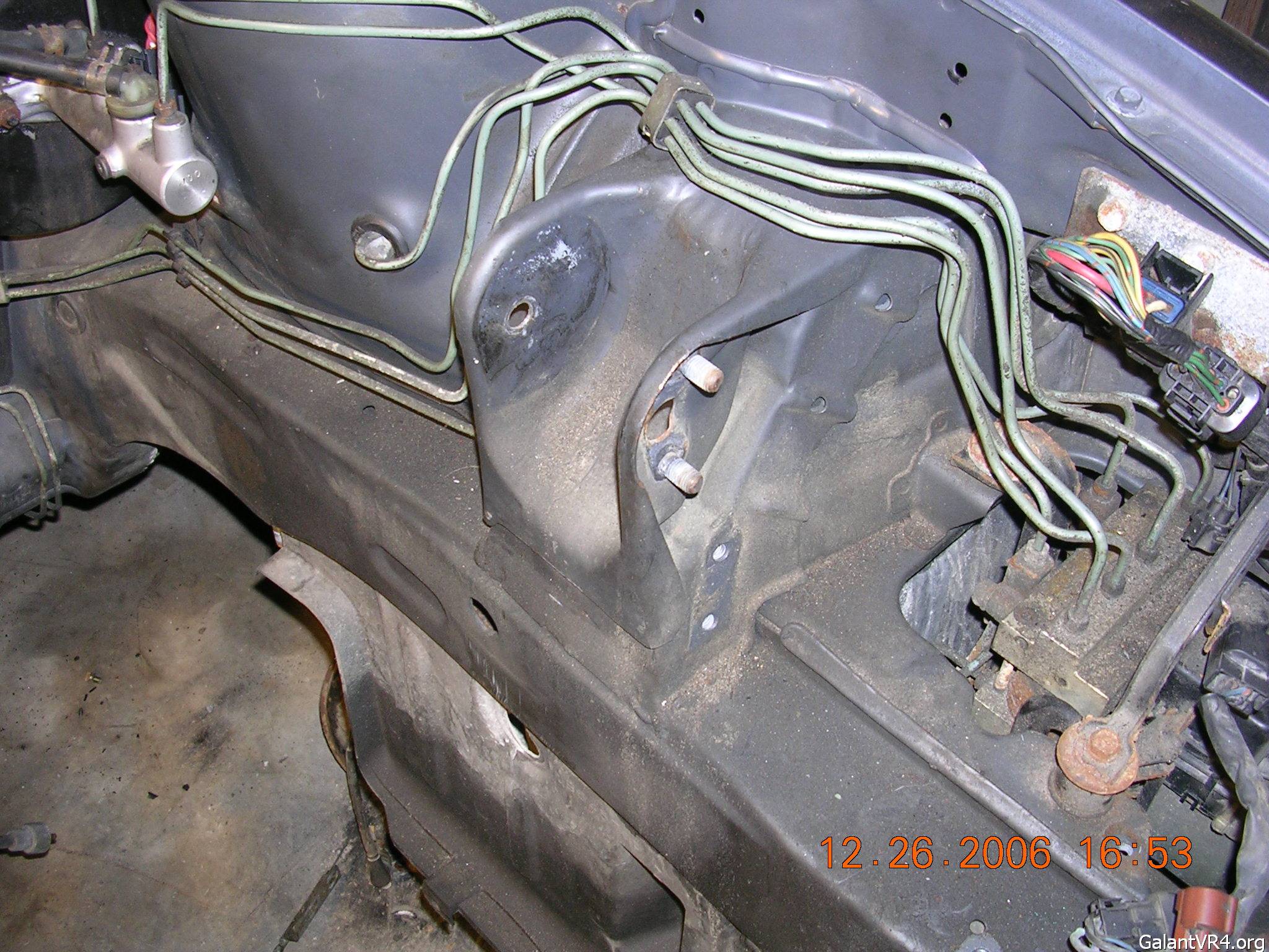

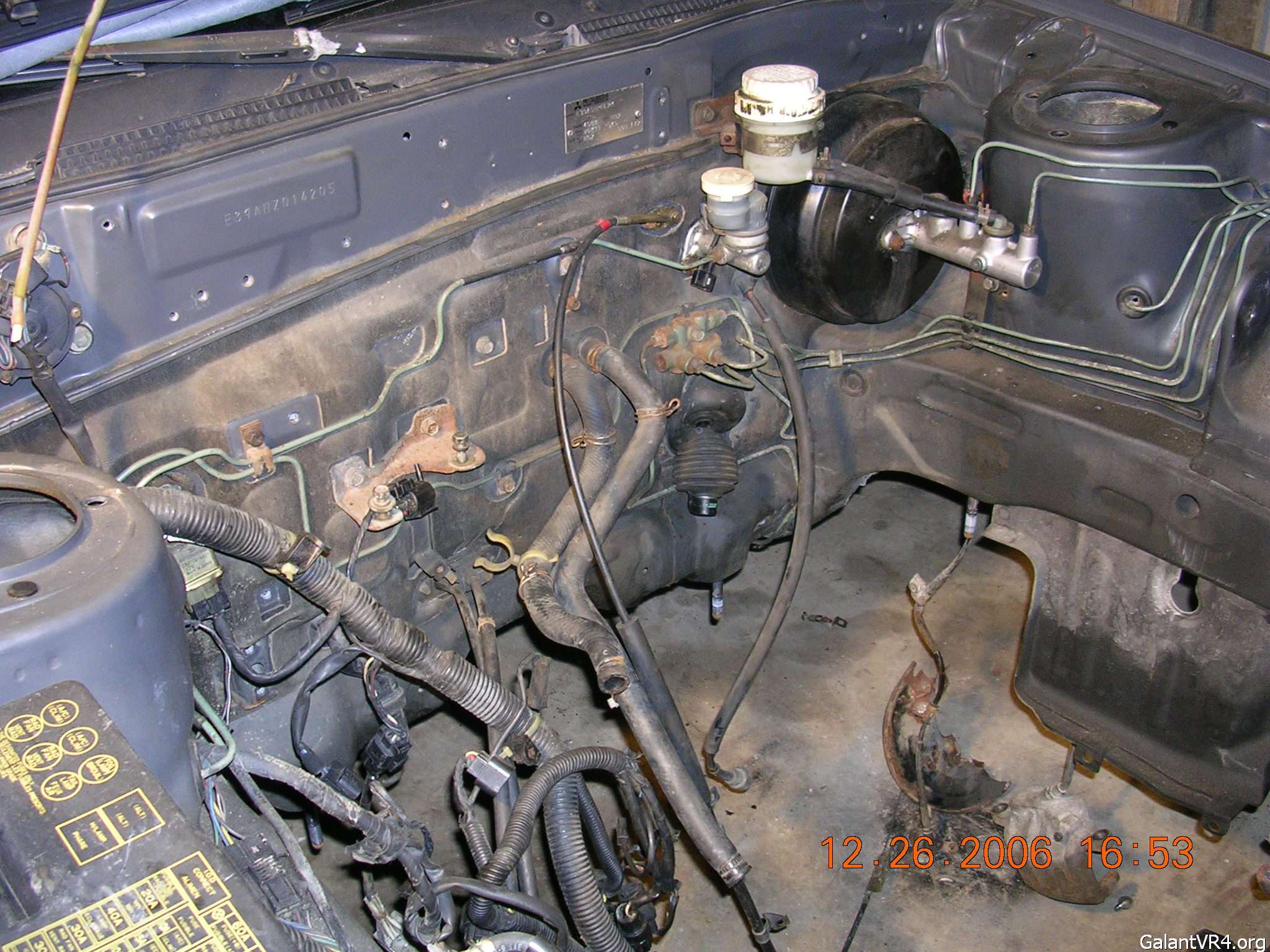

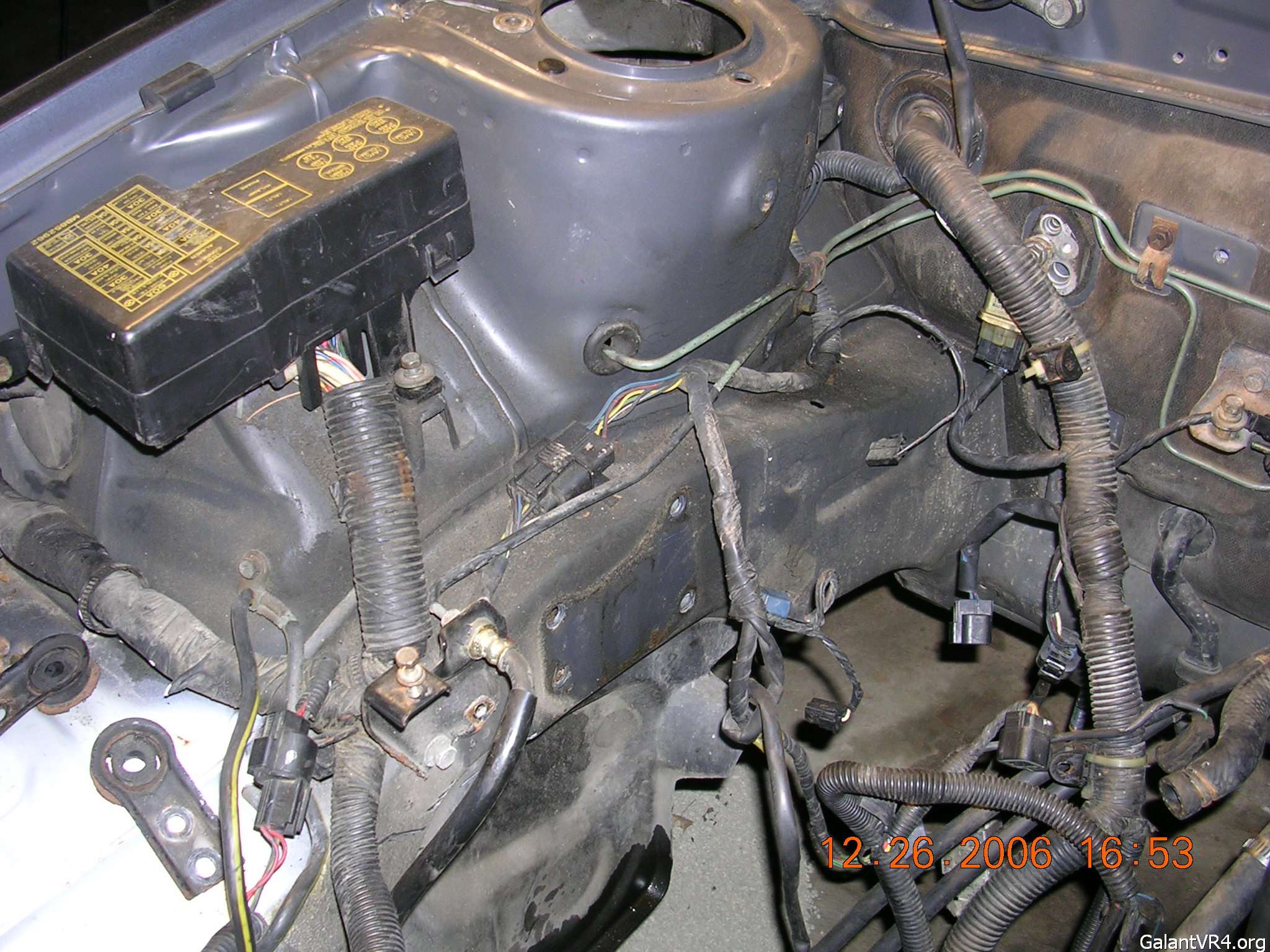

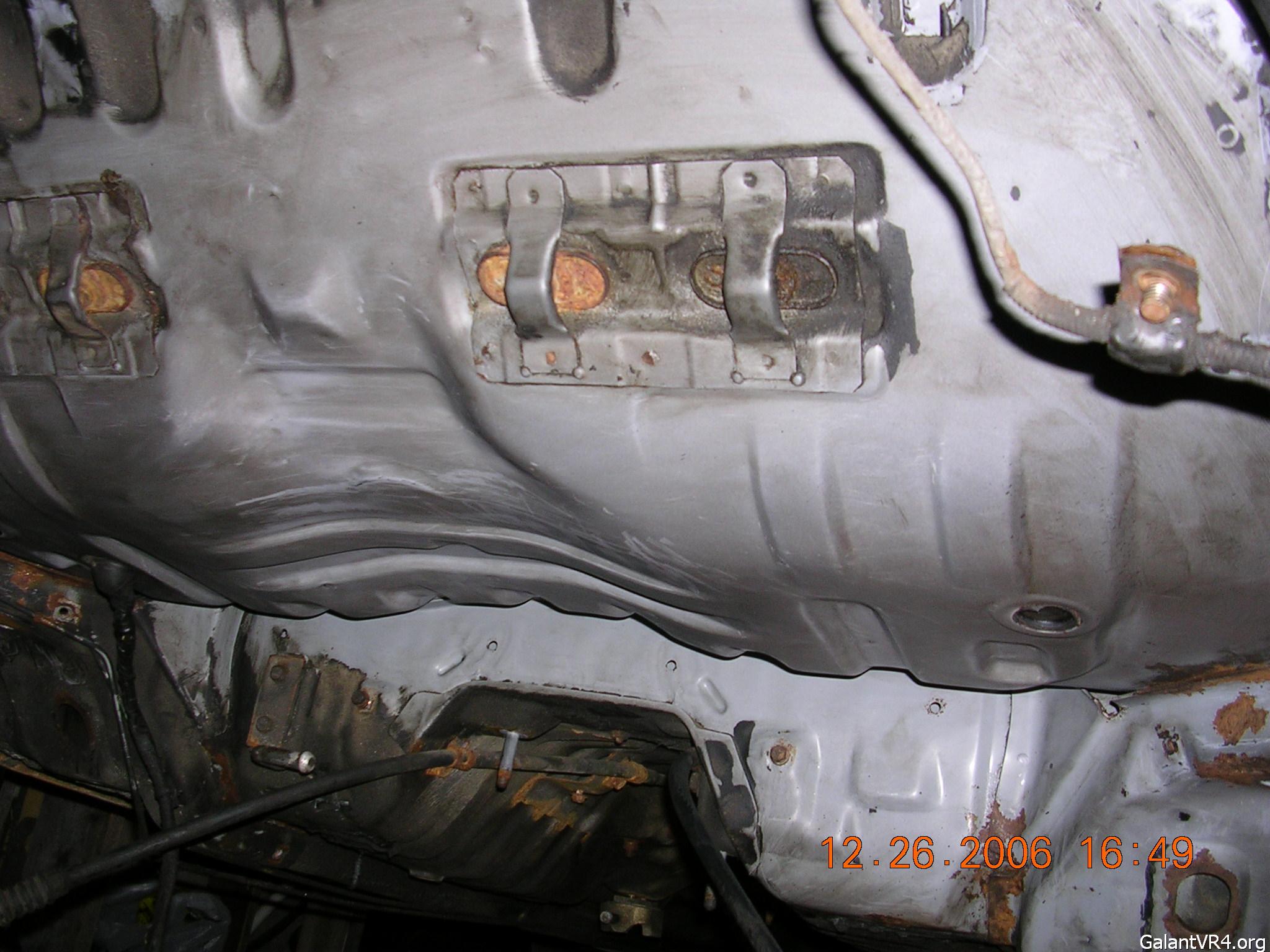

Empty engine bay pictures... Reminder: this car has been a Vermont car it's entire life; the original owner of the car is/was a Middlebury College Professor.

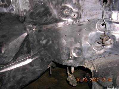

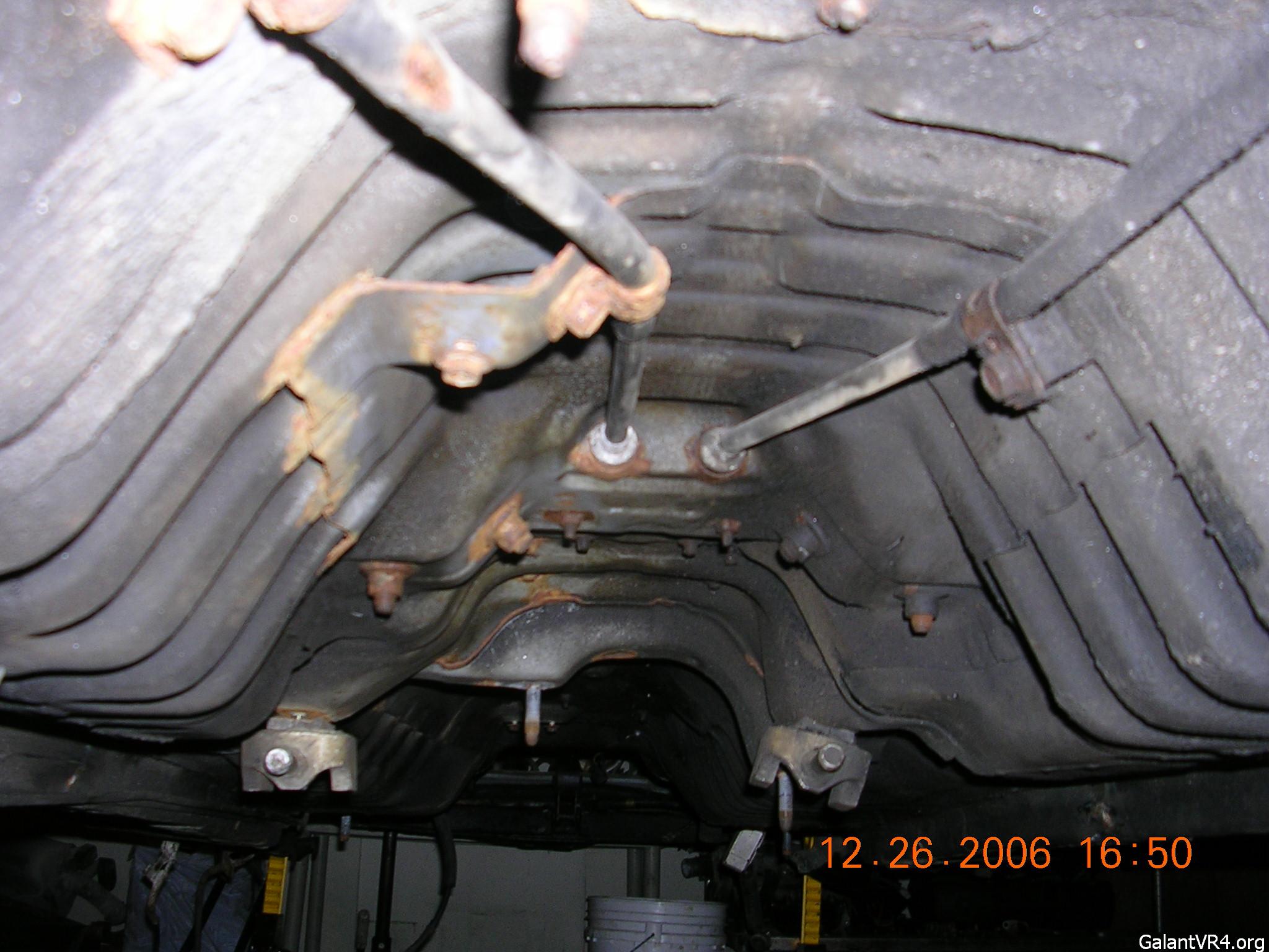

General under car pictures...

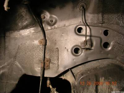

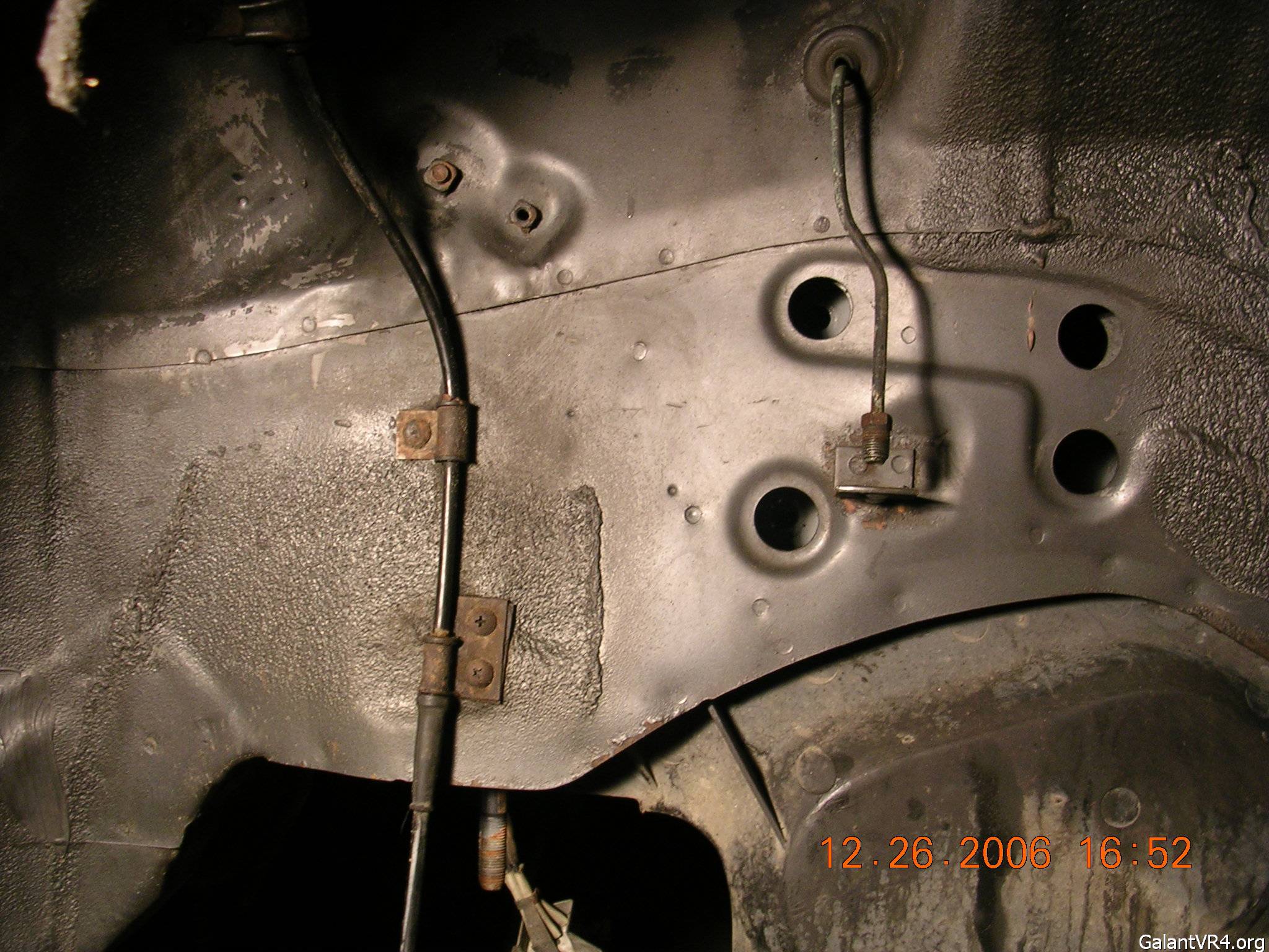

Passenger's side frame rail...

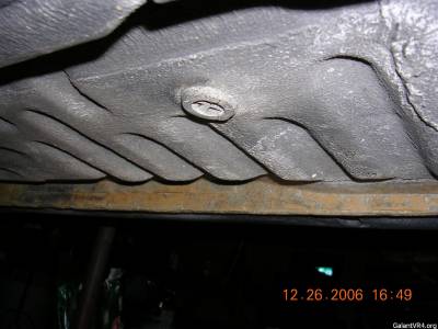

Tunnel of love...

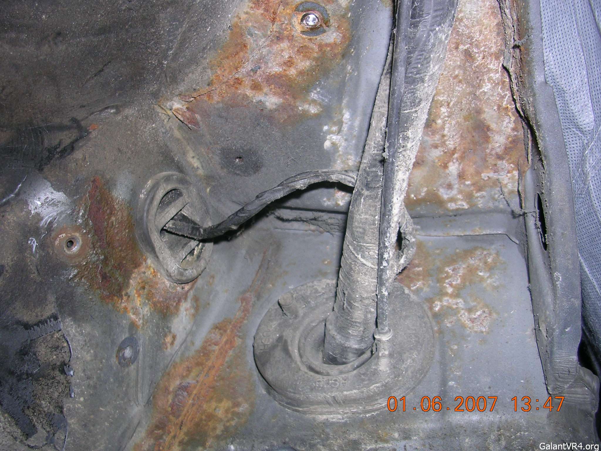

The worst of the rust... It looks bad, but that is untouched. I haven't done any brushing, scraping, drilling, grinding, etc. yet. I have this 3M "rust remover" pad that rips surface rust right off and I also picked up this stuff that is supposed to have some kind of chemical reaction with rust /ubbthreads/images/graemlins/rolleyes.gif f***

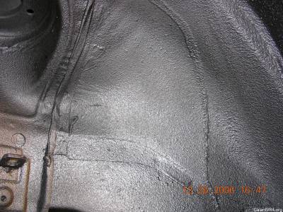

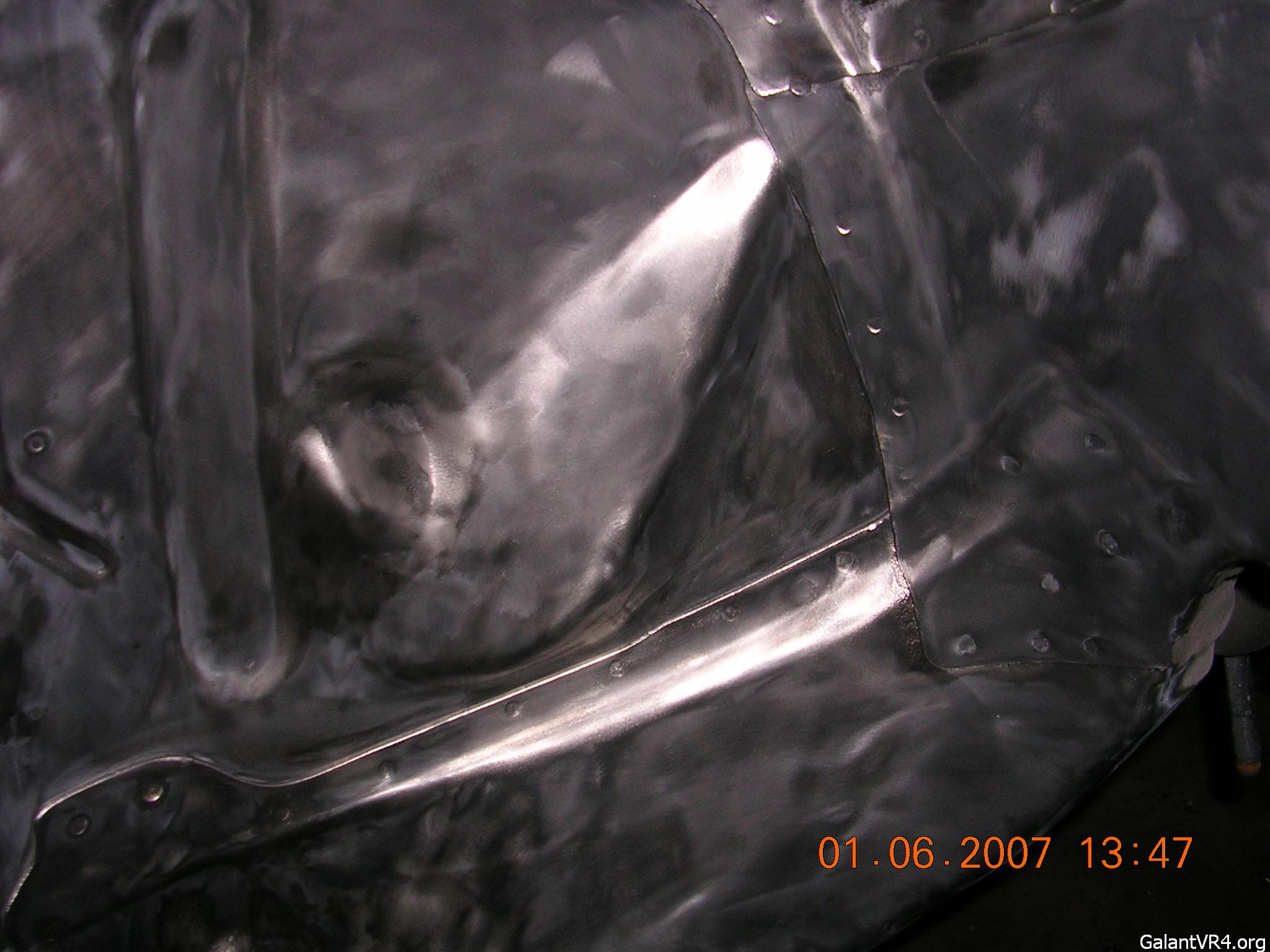

Had a few hours today. Boy I hate undercoat!
Ready for seam sealer and undercoat!

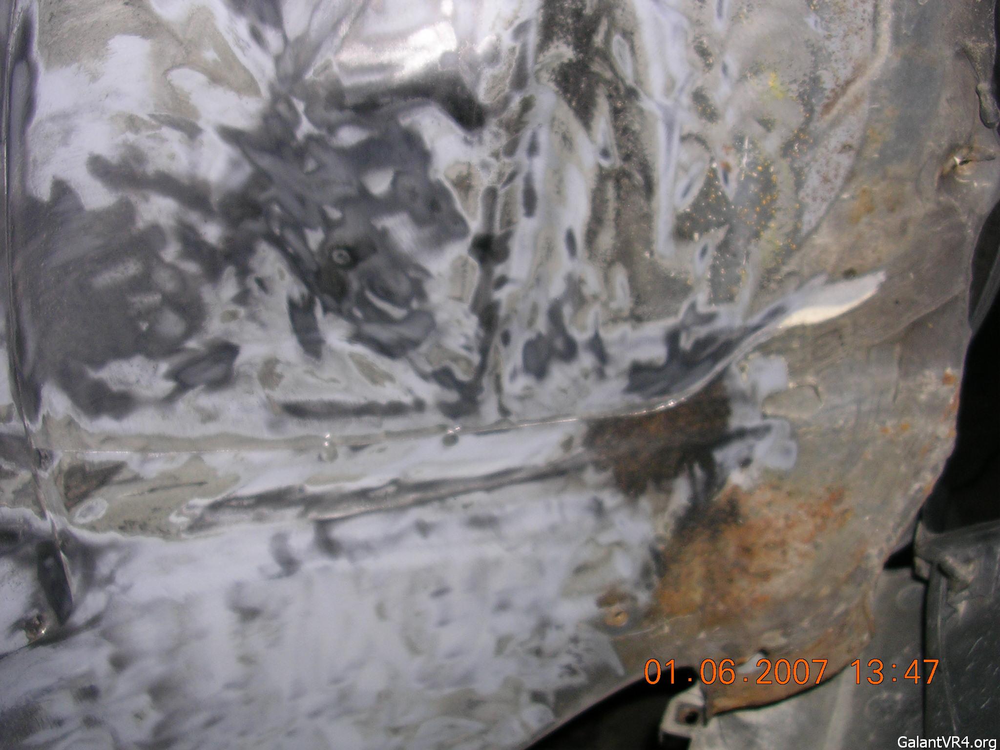

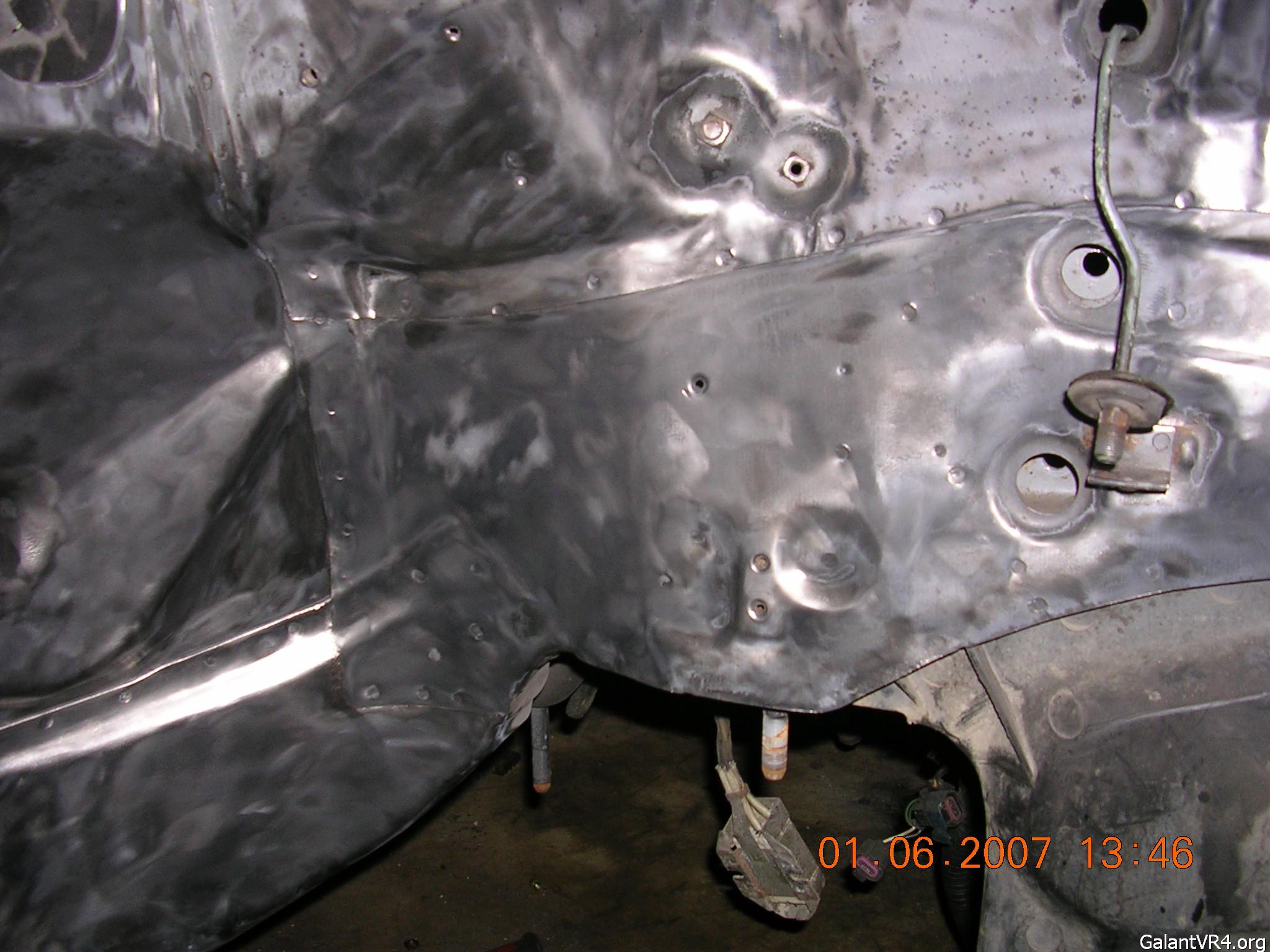

The driver's side wheel well certainly needs some work! I finally found the worst of the rust on the car...
Started ripping some of it off... If anyone is tacking this job, I would highly recommend a angle grinder with a knoted wire attachment.

looking nice! are you planning to paint the engine bay with paint or all undercoating?
later.
Just going to clean it up and possibly paint it depending on how clean it comes out.
