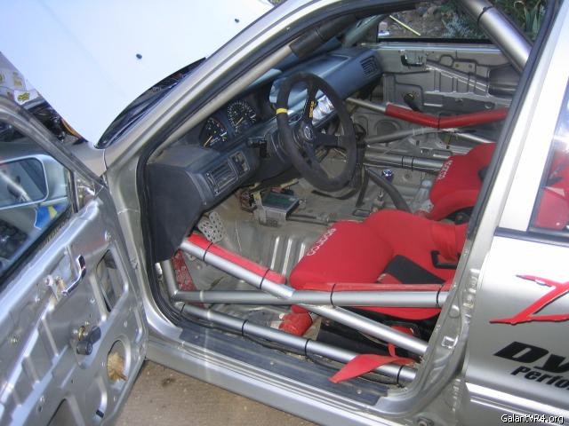

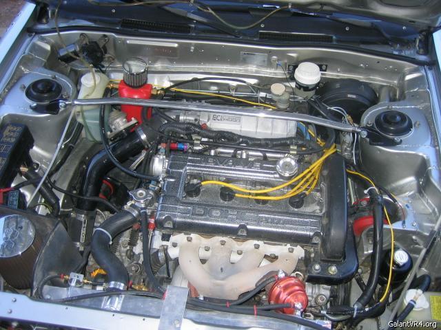

I've owned this car for 3+ years now and have been dealing with the neglect from past owners without really fixing anything. The car has sat in my shop for the past year, mostly untouched as I traded off my street bike for a 98 Trans am to daily. I finally decided to sell the trans am and put my race 1g and the galant back on the front burner. She's got 190k on her, and the owner before the guy I bought it from rallyx'd the car (hence the rally armours) and definitely put this old girl through her tests. It's had a stock exhaust with it's fair share of swiss cheese looking rotted holes in it since I bought it and it's annoyed the living hell out of me since. The stock radiator was slowly starting to die off and seep at the crimps, the suspension was original and after a few seasons of rallyx and 160k+ it was well past due for replacement. So I took the money I got from the trans am and started modding an, otherwise stock, 736/2000. I've since installed a mishimoto X-line from a 1g, modified the stock brackets and crammed a factory 1g fan in. The waterpump, t-stat, and every single hose that has coolant through it was replaced at the same time. Timing belt was replaced along with rebuilding the oil pump, and valve seals were replaced with Viton GSC's as they've been leaking since at least 140k (that I found out from a previous owners post on here). Of course the 14b was never good enough for this heavy ass pig, so an MHI B16g was fitted and I mutilated my old school buschur turbo back from my 1g to rid the nasty raspy stock exhaust. With the new found airflow I needed a way to safely turn up the wick, so I built an evo 8 ecu patch harness, threw in some 1200cc PTE's and a wally 255. Of course power is useless without being able to put it down, so I picked up a set of evo 9 bilsteins and some swift spec R springs to keep the car planted, and powerstop Z26 pads with centric rotors all around to stop. I'll be upgrading the wheels/tires as Arizona begins it's HPDE and autox season in a month.

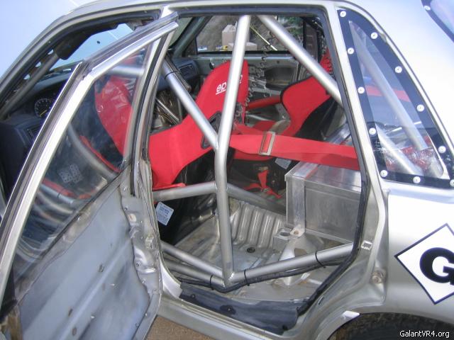

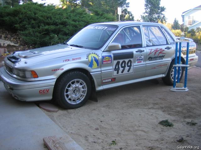

Took a few random pictures from these past couple weekends at my shop as I finished up most of the maintenance/mods.
