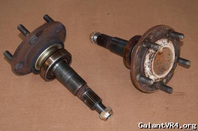

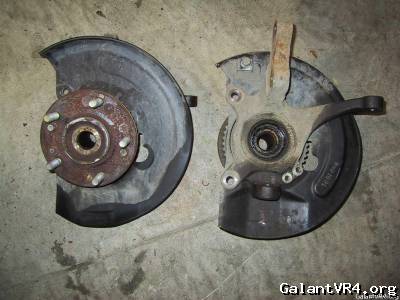

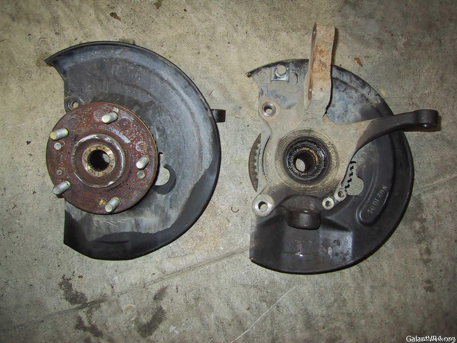

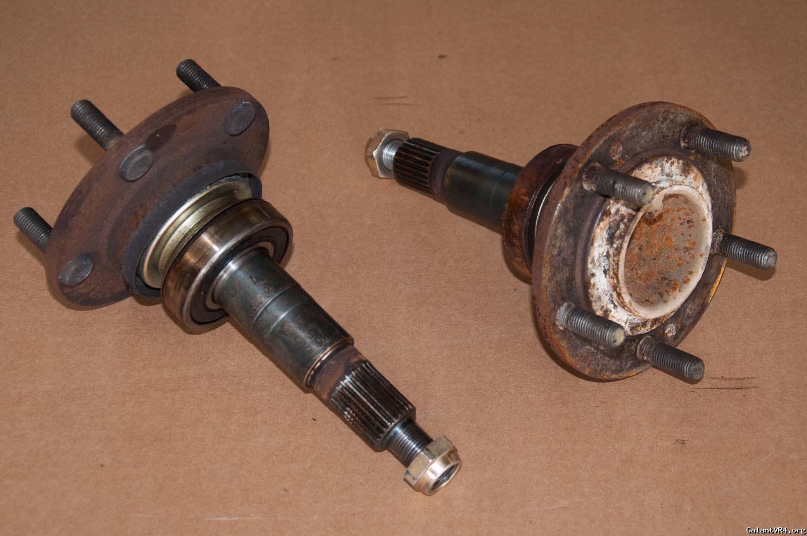

The spring/shock combo have no effect on switching to 5 lug hubs. Here is all you need to do the swap
Front
Rear
