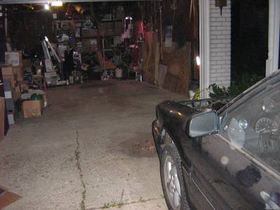

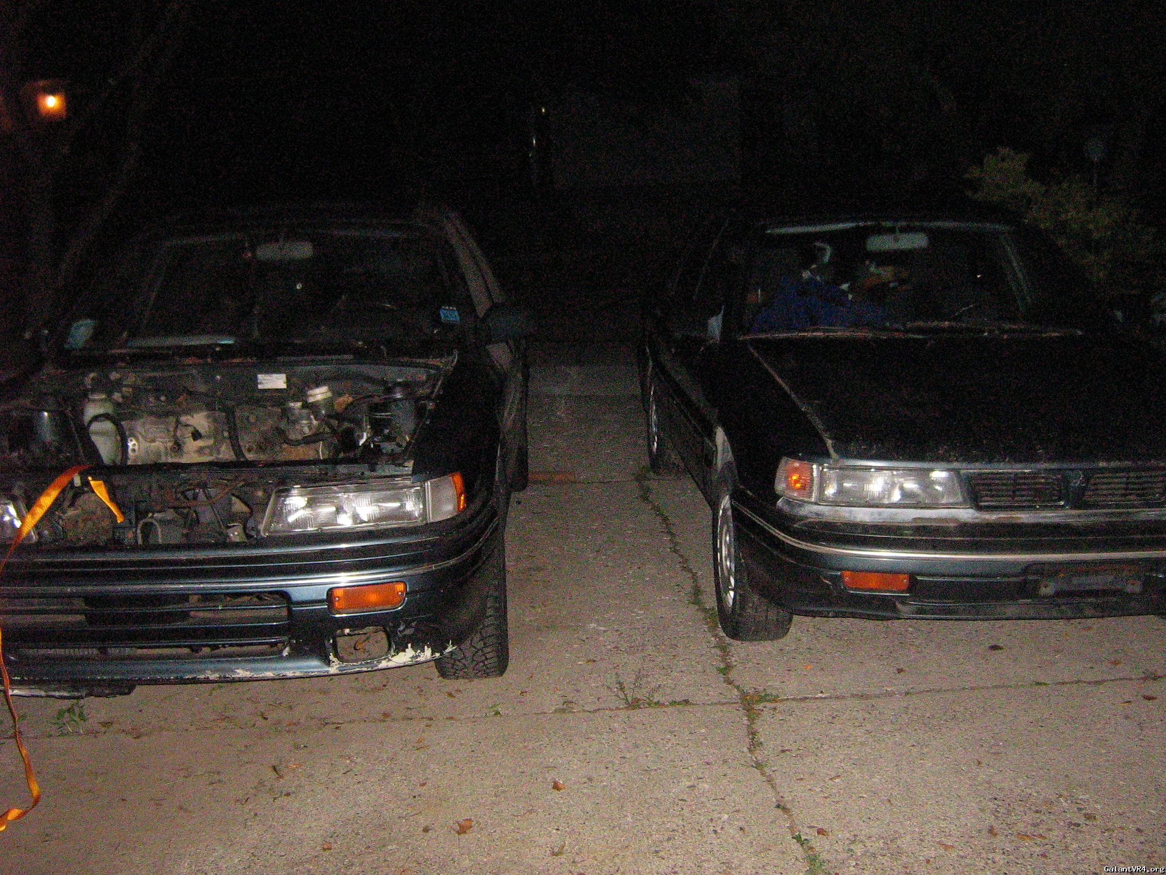

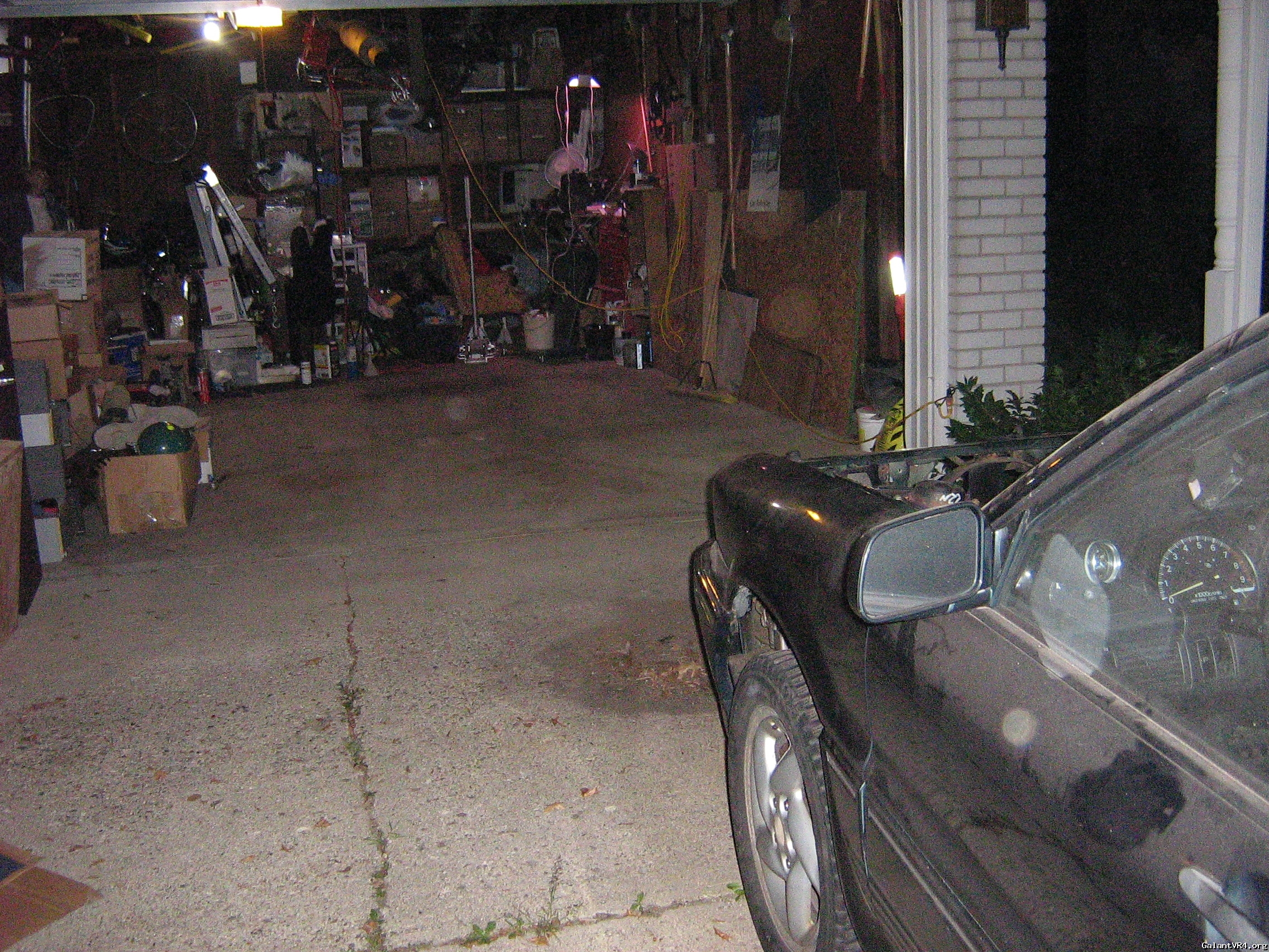

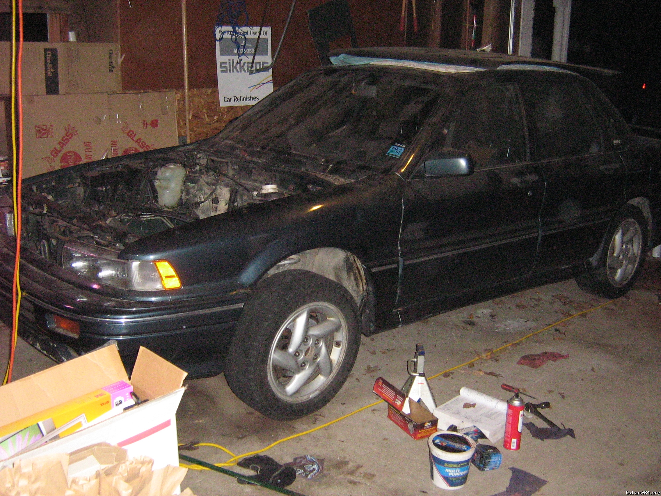

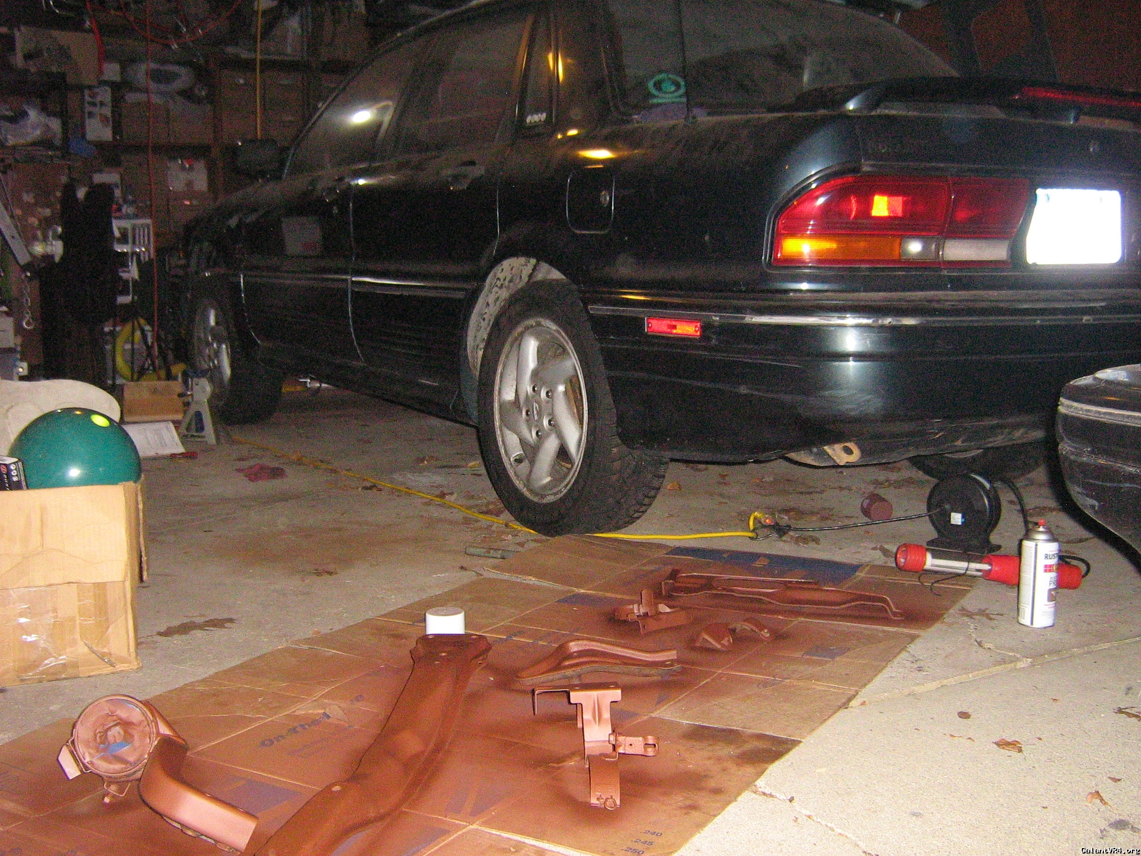

Holy sh*t it has been a hell of a slow moving process, but 582 is off jackstands and out of my garage! I'm finishing up miscellaneous tasks; painting brackets and such, then tomorrow it is off to Thompson Racing Fabrication where I will drop the motor in this week! /ubbthreads/images/graemlins/worthy.gif All I can say is it will be so good to drive her again! I have many picture of the year+ build, but never had the time to posts them, and now they seem a little irrelevant, but I will have photos of the engine going in, and now just to celebrate a few from jackstands to driveway /ubbthreads/images/graemlins/grin.gif
~Brian
P.s. don't hold how much random sh*t is in my poor shop, I am still in the process of finding homes for all my sh*t after movinin out of the ex-lady's spot /ubbthreads/images/graemlins/dunno.gif

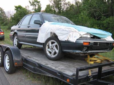

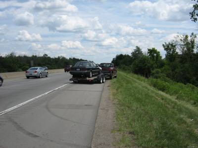

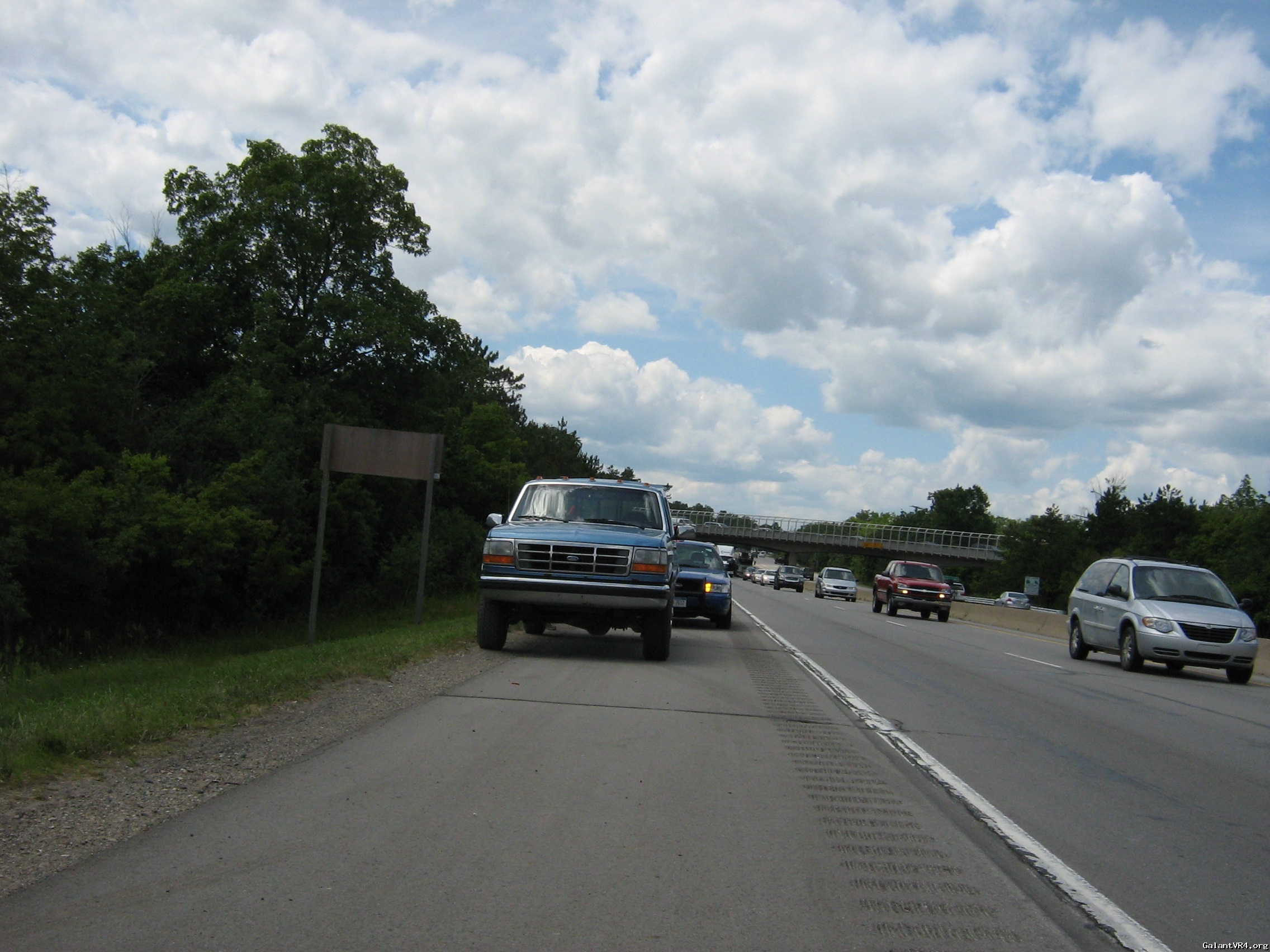

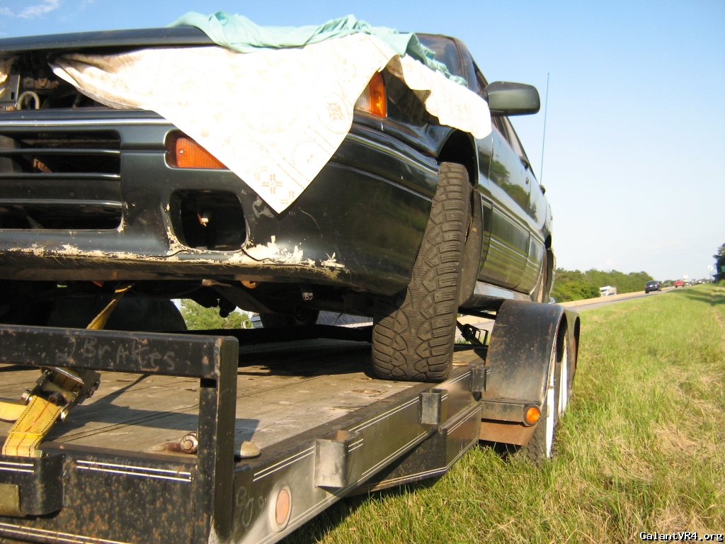

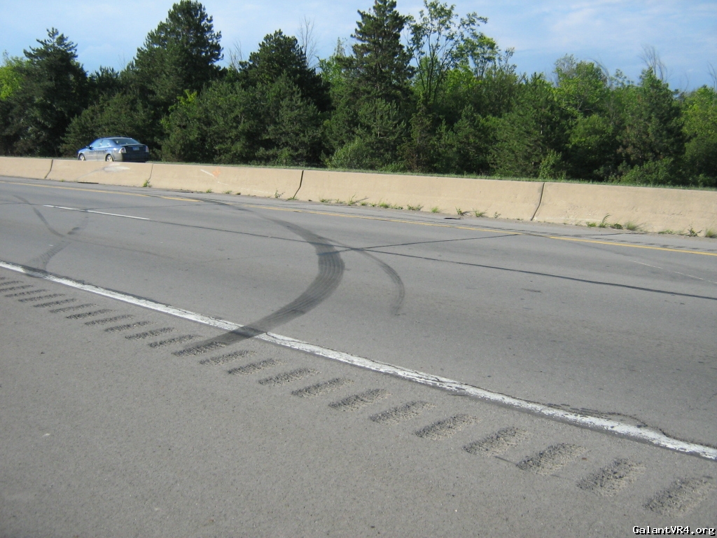

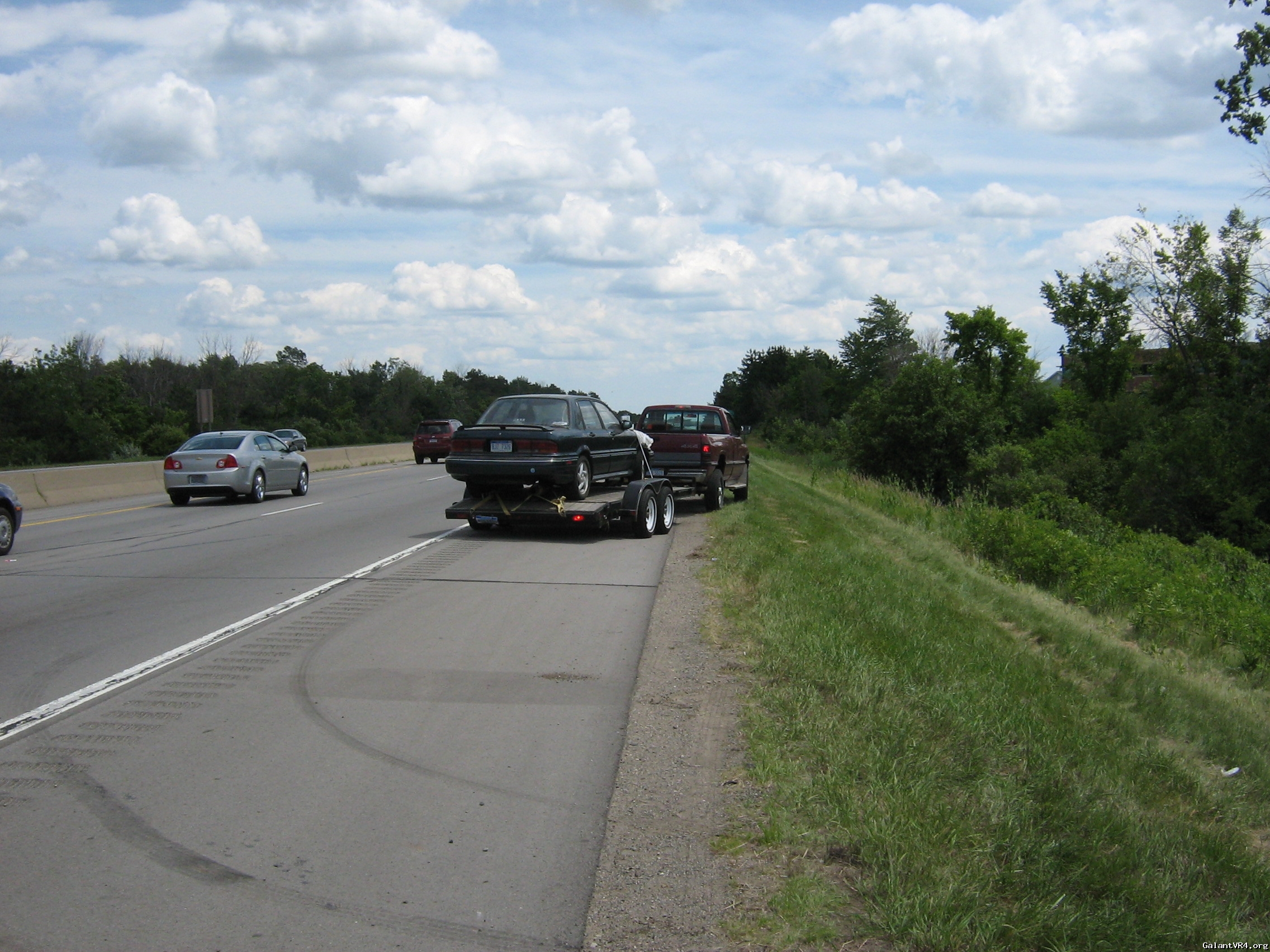

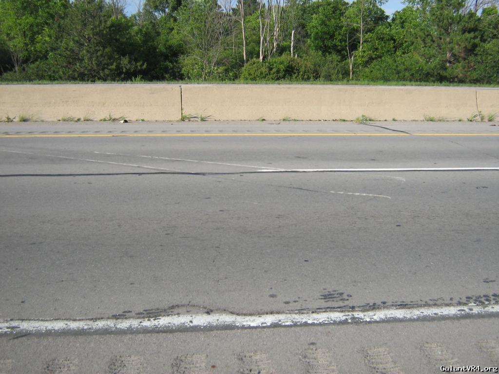

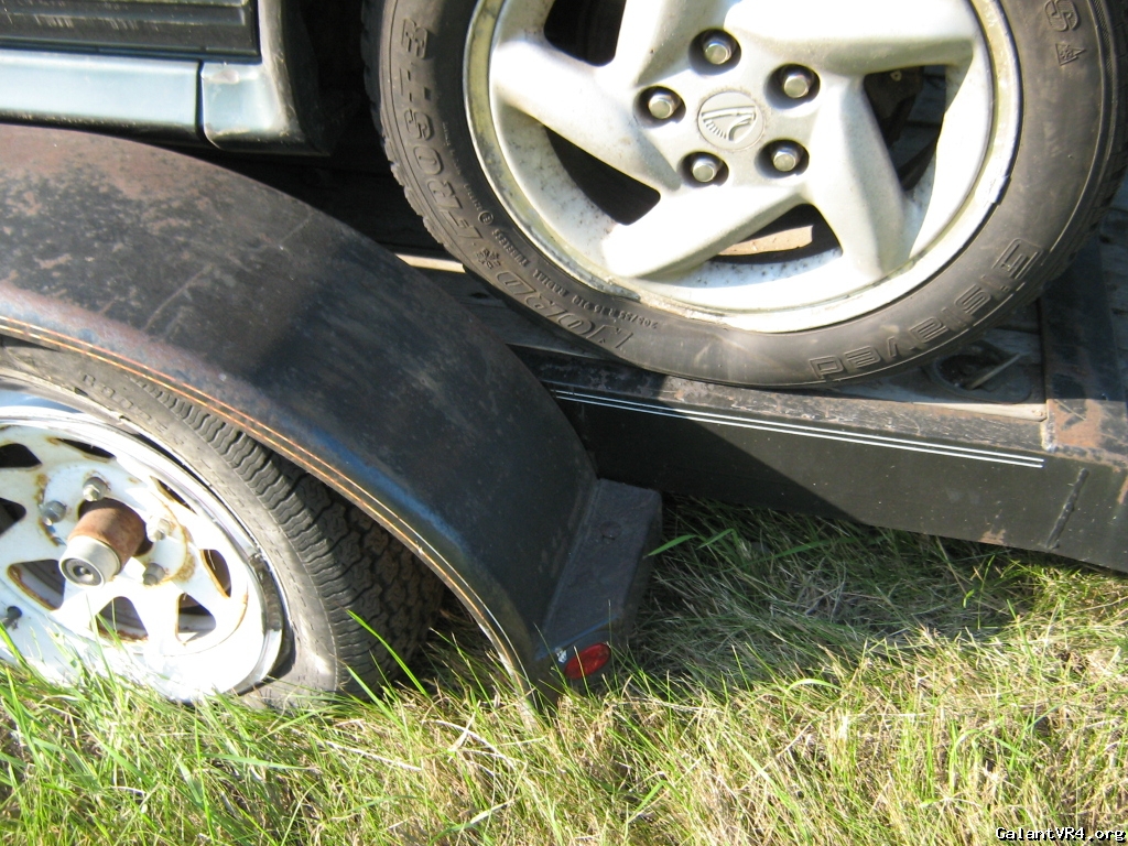

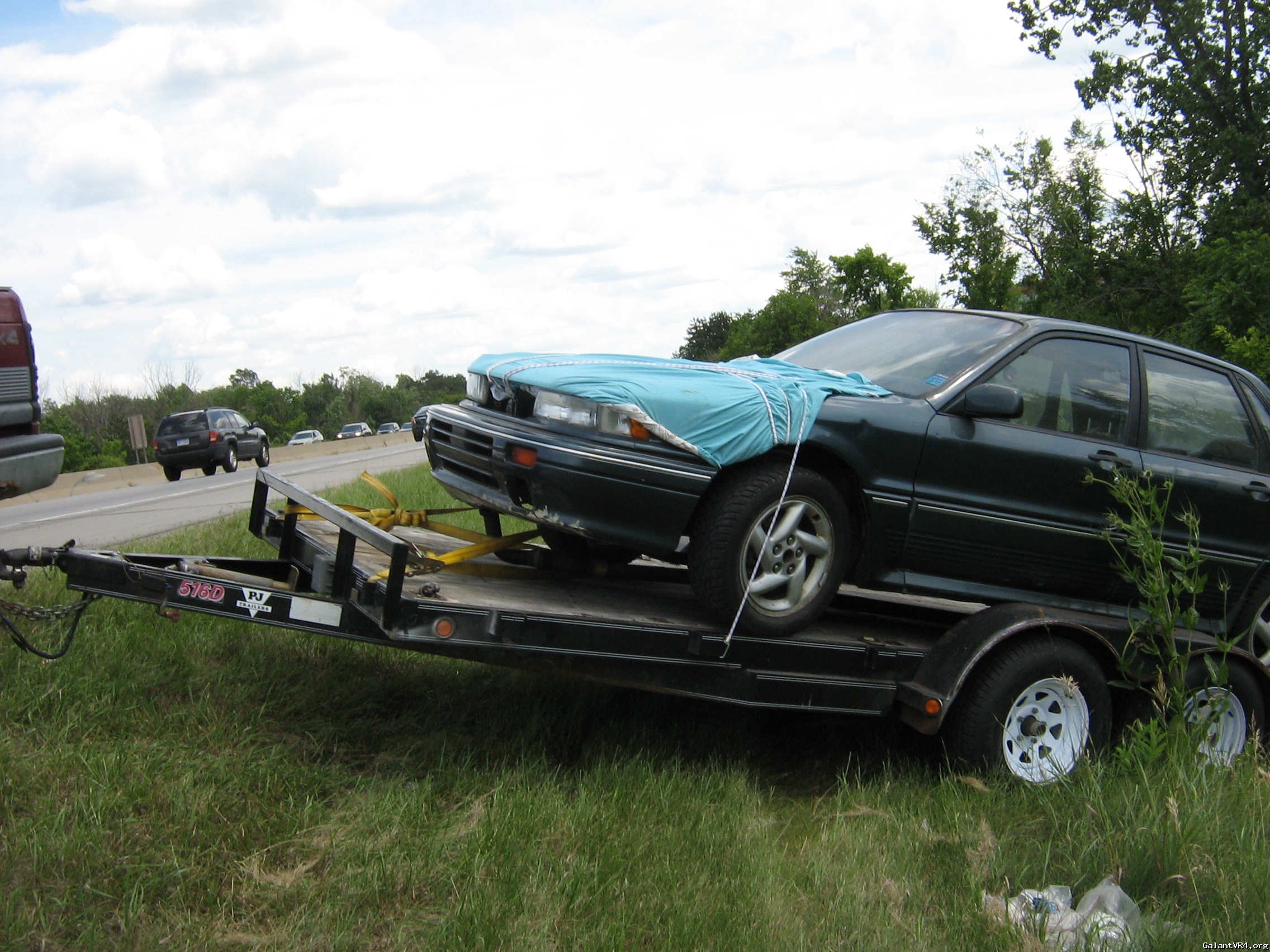

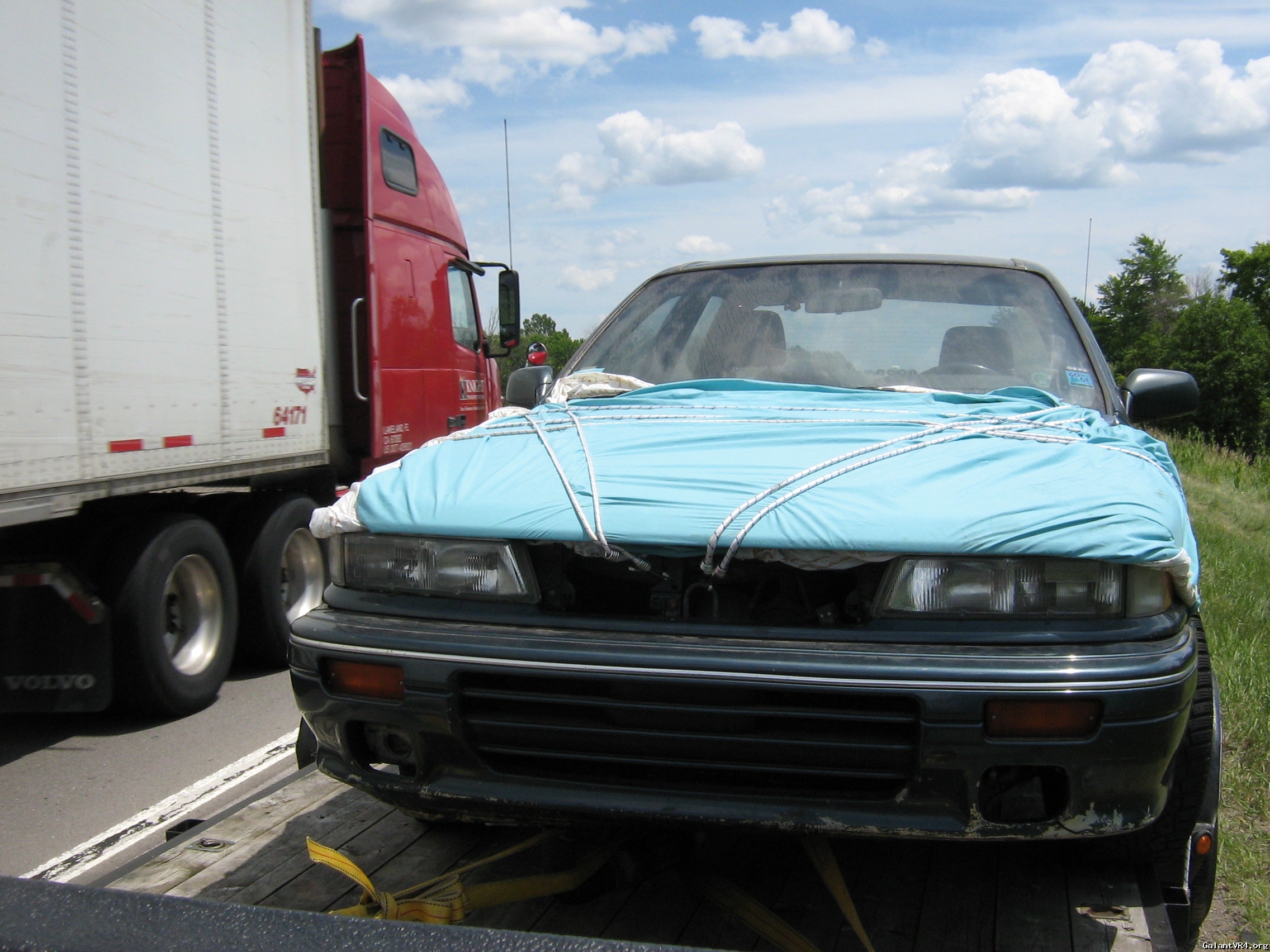

Wow so today has been quite a day. After finally getting her loaded up with everything ready to go(hours or work alone) I start out on the freeway, and not two miles into my trip the trailer starts to sway hard on me. /ubbthreads/images/graemlins/uhh.gif I tried to slow down and the trailer brakes lock up. /ubbthreads/images/graemlins/banghead.gif The trailer swings hard right then left hitting the concrete median and turning the truck 180* and leaving me facing oncoming traffic /ubbthreads/images/graemlins/ooo.gif I maniged to get them off to the side to inspect the damage: two wheels on the drivers side of the trailer are toast, little road rash on the leading and tail corners on the drivers side of the trailer, one wheel on 528 is toast, and finally the passengers side rear quarter panel of the truck kissed the trailer on one of its swerves. /ubbthreads/images/graemlins/banghead.gif All things considered I'm damn lucky, and 582 is out of my garage, just on the side of the road till tomorrow. /ubbthreads/images/graemlins/bawling.gif Now for a little bit of random luck, a fellow in a Mercedes blew a tire about 100yds back from where the truck was sitting, so being the helpful person I run over and help him change his wheel, he gives me $50! So long ass day, but a lot to be thankful for. Here are some pictures.
~Brian
a2vr4
Aug 13, 2005
1,551
Ann Arbor MI

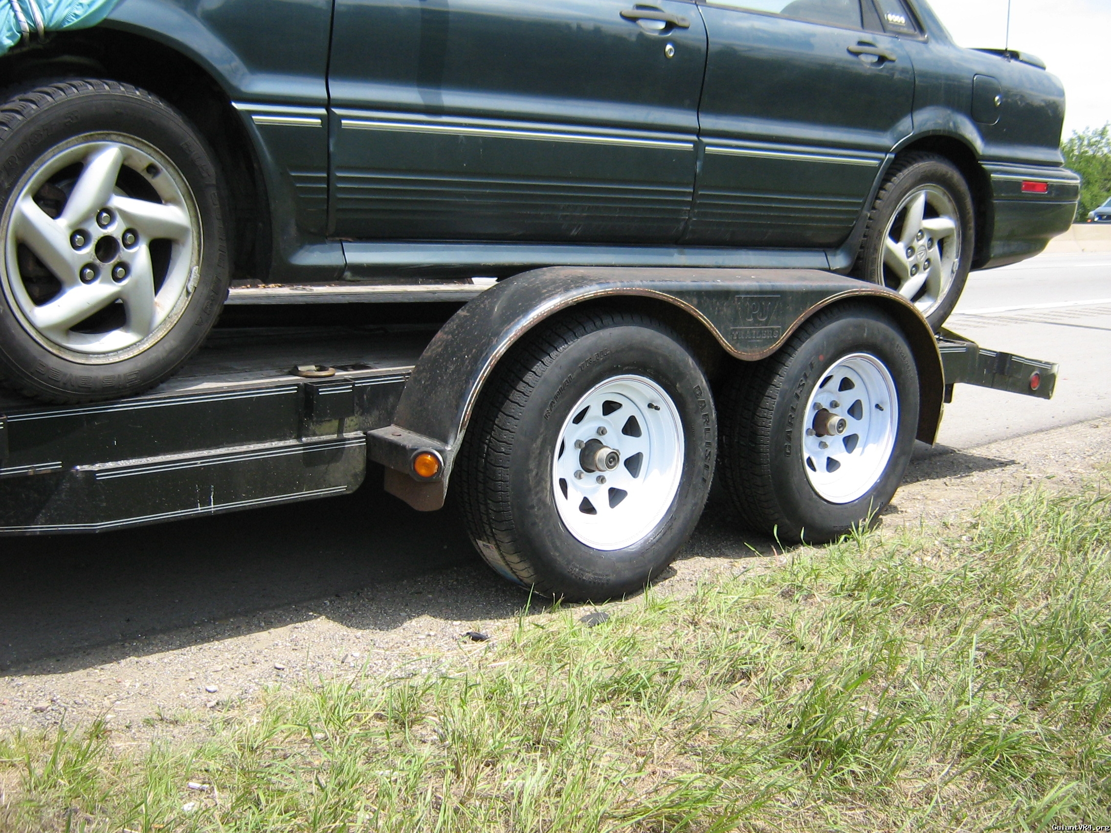

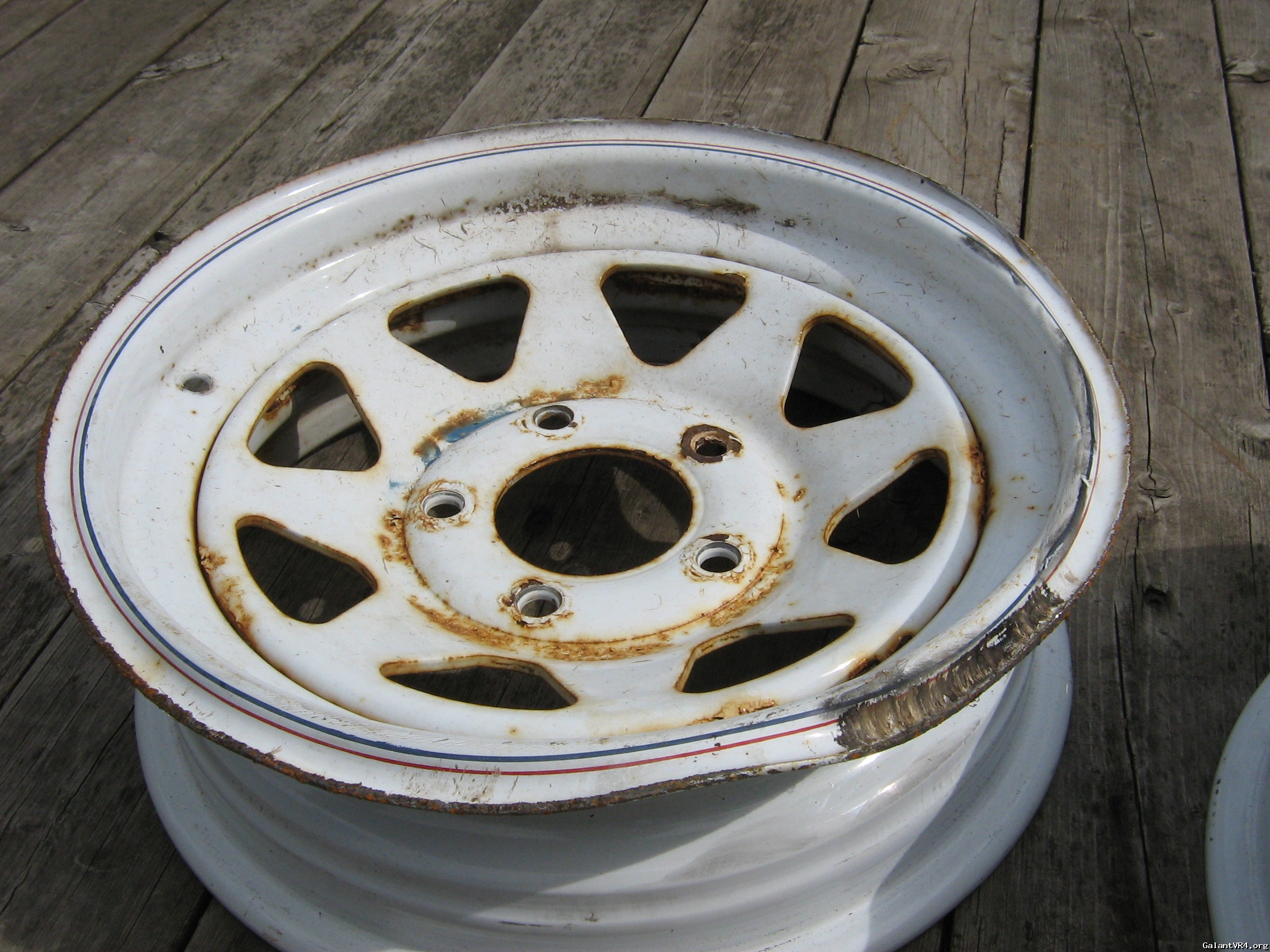

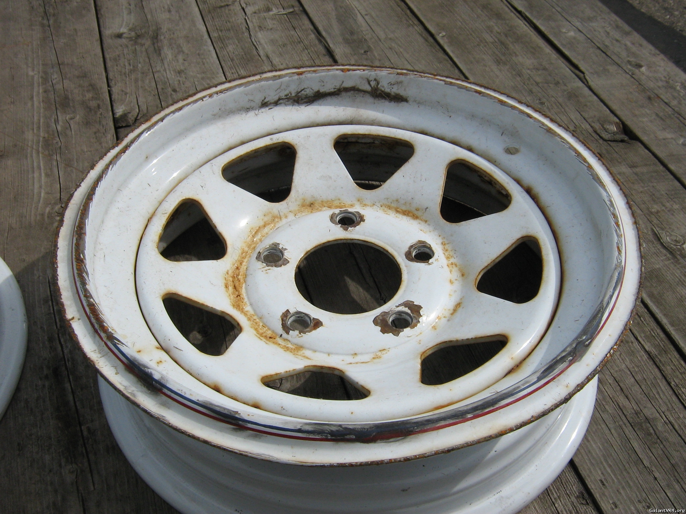

Thanks Ice, I really can't believe it myself! Monday: After removing the trailer wheels, I found the culprit: for some unknown-ungodly reason my grandfather (who owns the truck/trailer) had passenger tires NOT trailer tires on the trailer, and the rear drivers side tire blew, which in turn caused the swerving /ubbthreads/images/graemlins/banghead.gif Once I got the wheels off I went to discount tire to get a new set, they found what i needed right away, and I was in and out in less then 1.5 hrs! Call up the state boys and inform them that I will be needing their assistance to get my truck/trailer turned around and head back to the freeway, only to find that the wheels are the wrong lug pattern /ubbthreads/images/graemlins/bawling.gif so I call off the state boys, and head back to discount tire to see if they have what I need. Once I get there we conclude that the hubs are 5-5, not the common 5-4.5, and that they only have one wheel in stock, I just about lost it. But after an hour or so more searching and calling they found another one! so back to the freeway to get the trailer fixed up and wait for the state boys. He gets there looks at the situation with us closes one lane, after some ballsy and well done maneuvering into then out of the ditch I'm rolling again! But I smell burning rubber, so I stop in a parking lot to look things over and find something I had missed on the side of the freeway: the leaf spring mounts on the trailer have bent .5-1in. causing the new tires to rub on the fenders, two ratchet straps later I'm back on the road, got the trailer back with car to my uncles house then is a mad rush to get to work on time. Tuesday: Picked up the truck/trailer/car and deliver the car to Thompson Racing Fabrication, taking the back way this time, goes relatively smoothly, then off to work again. Now that the car is at it's intended destination, I can worry about getting the truck and trailer fixed up /ubbthreads/images/graemlins/banghead.gif Got to pull the rear quarter on the truck, get the leaf spring mounts back to square, and get the other two tires replaced with trailer tires. It seems the saga has found its way back to the path, but there's still a lot of work to be done.

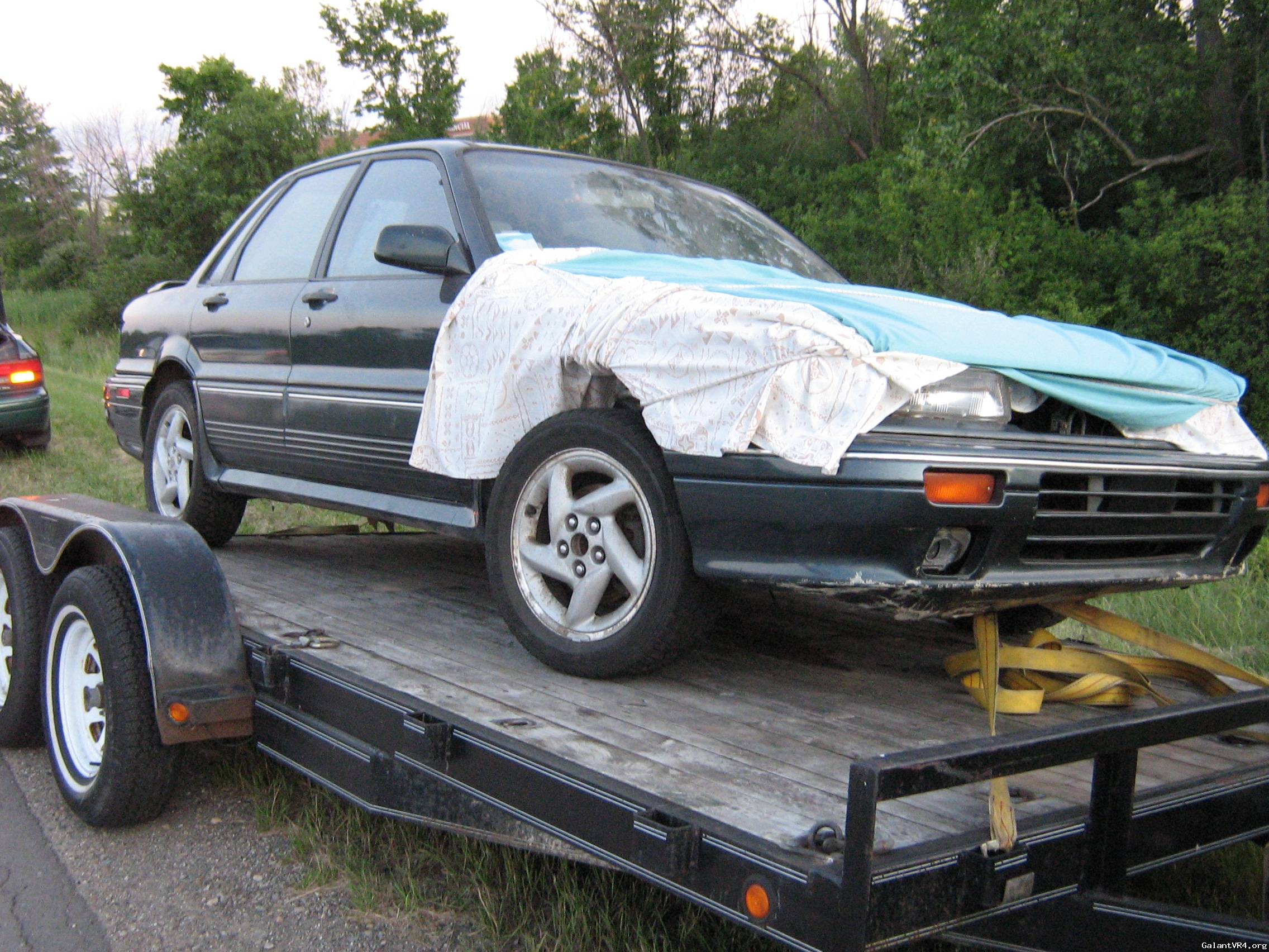

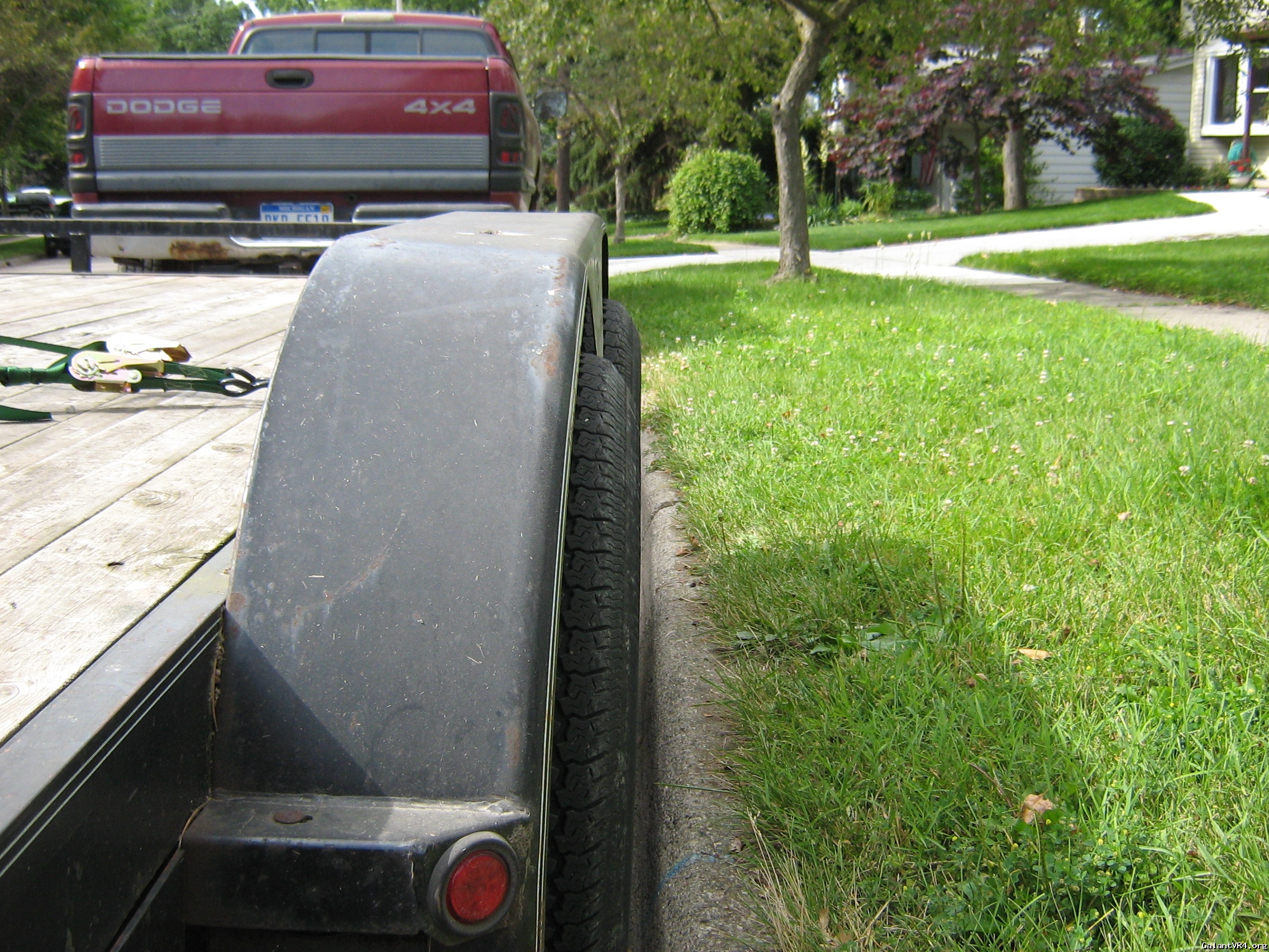

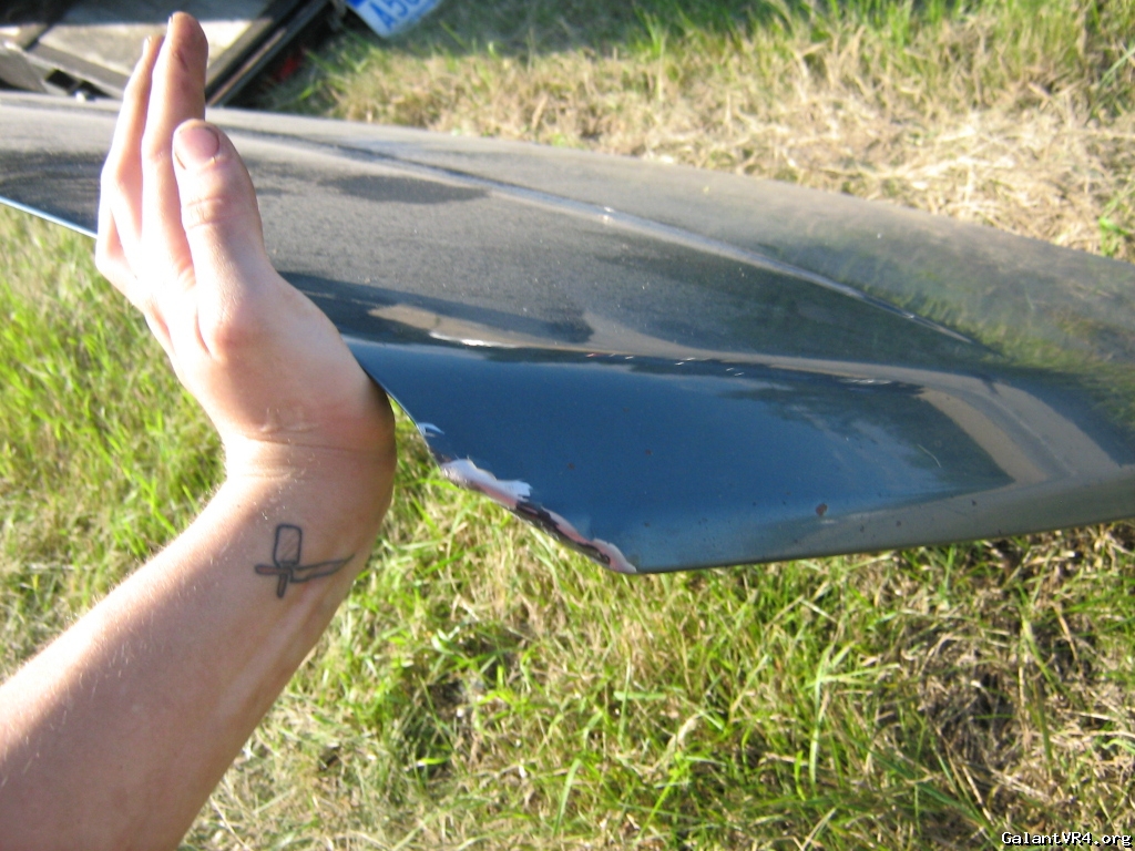

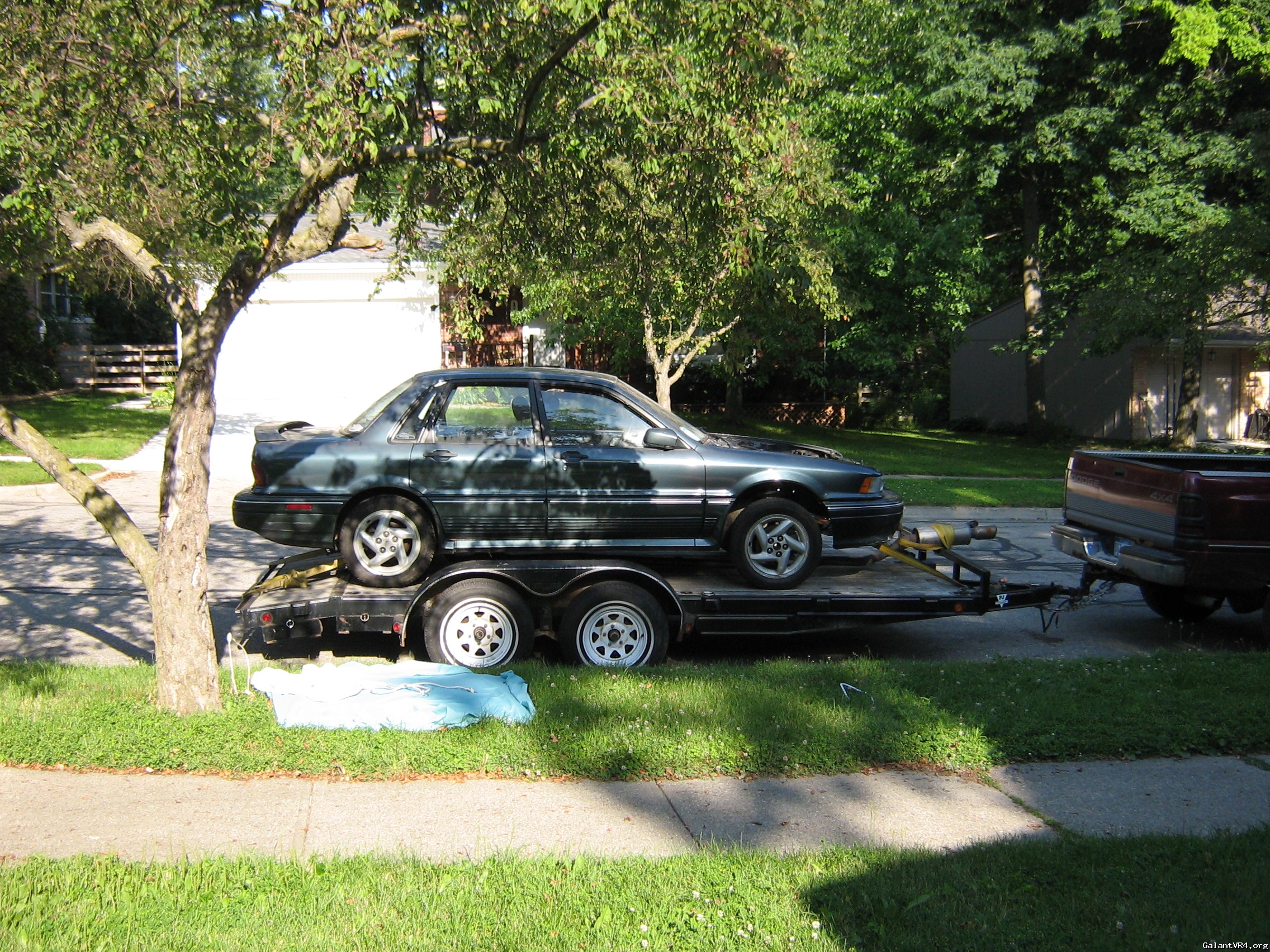

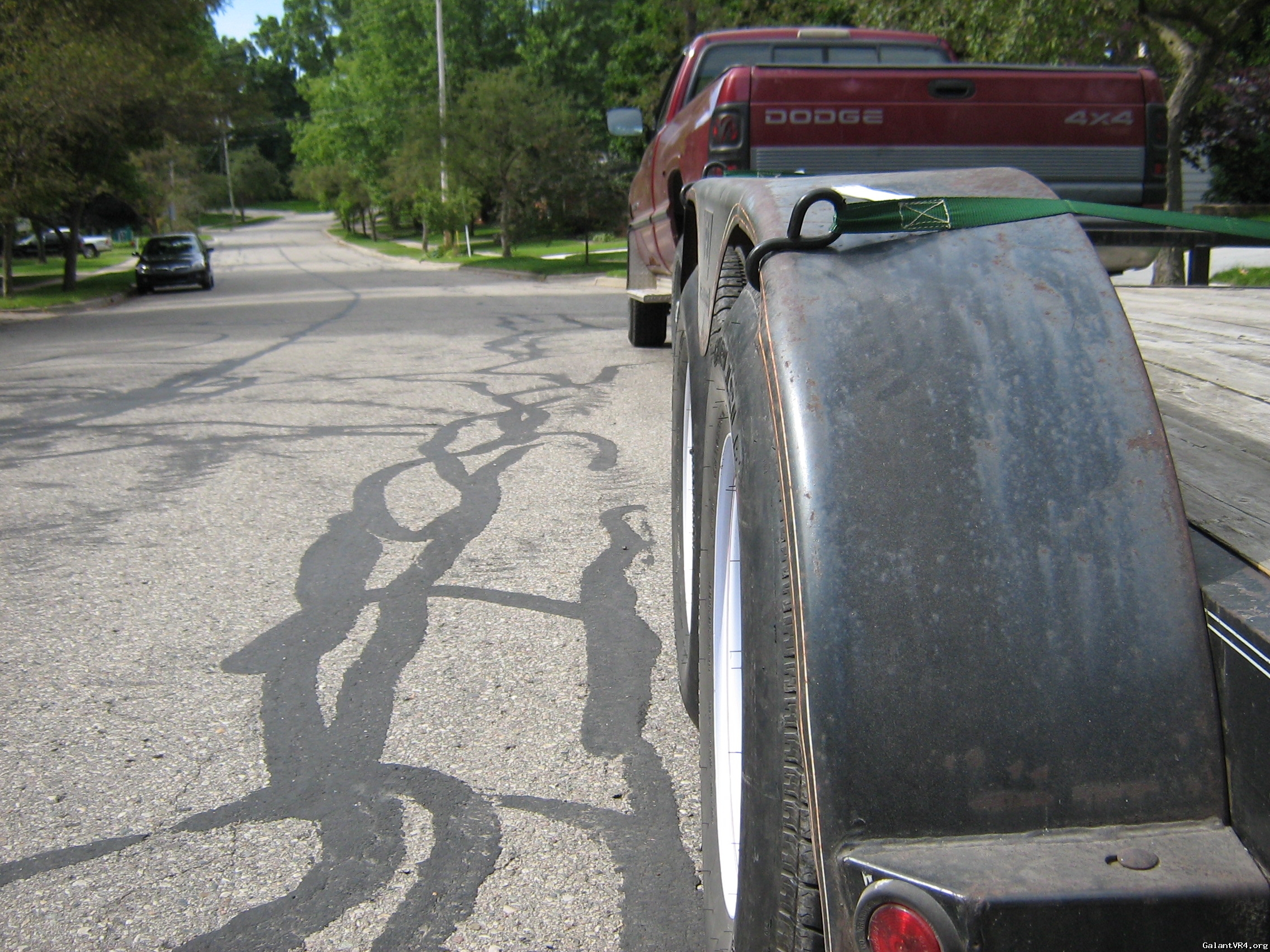

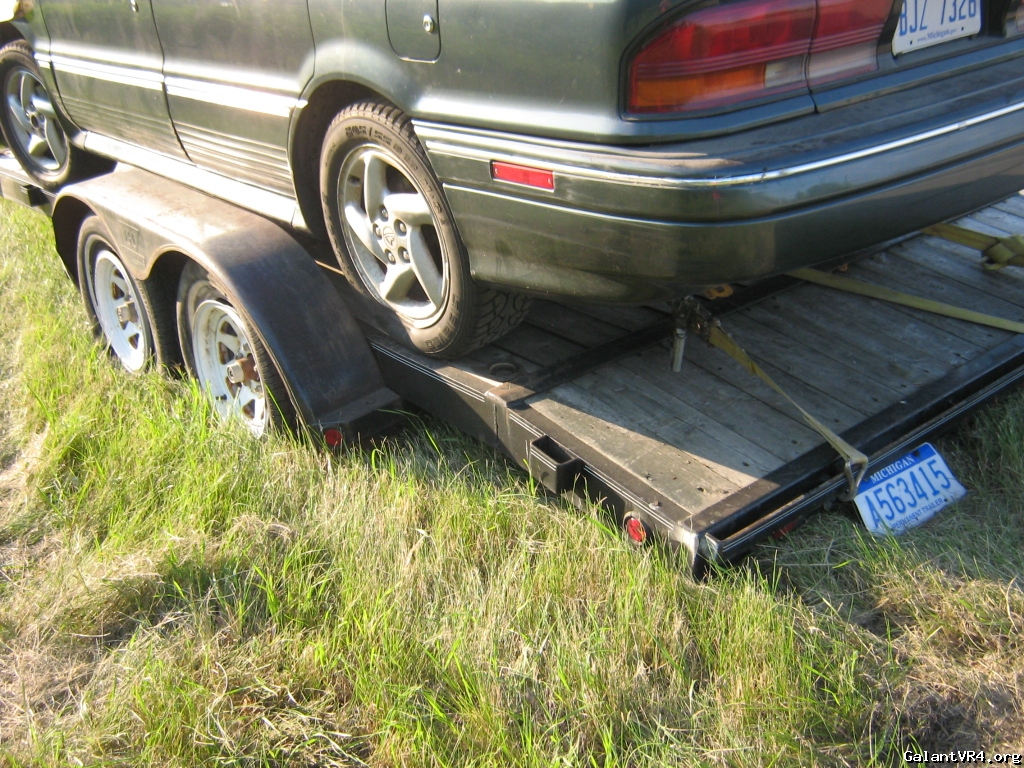

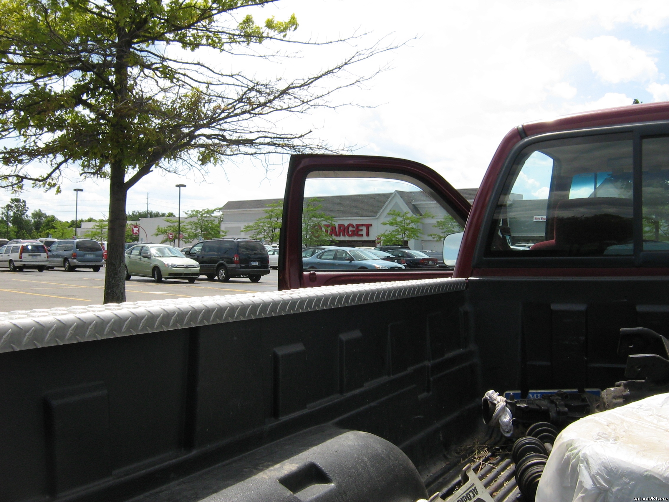

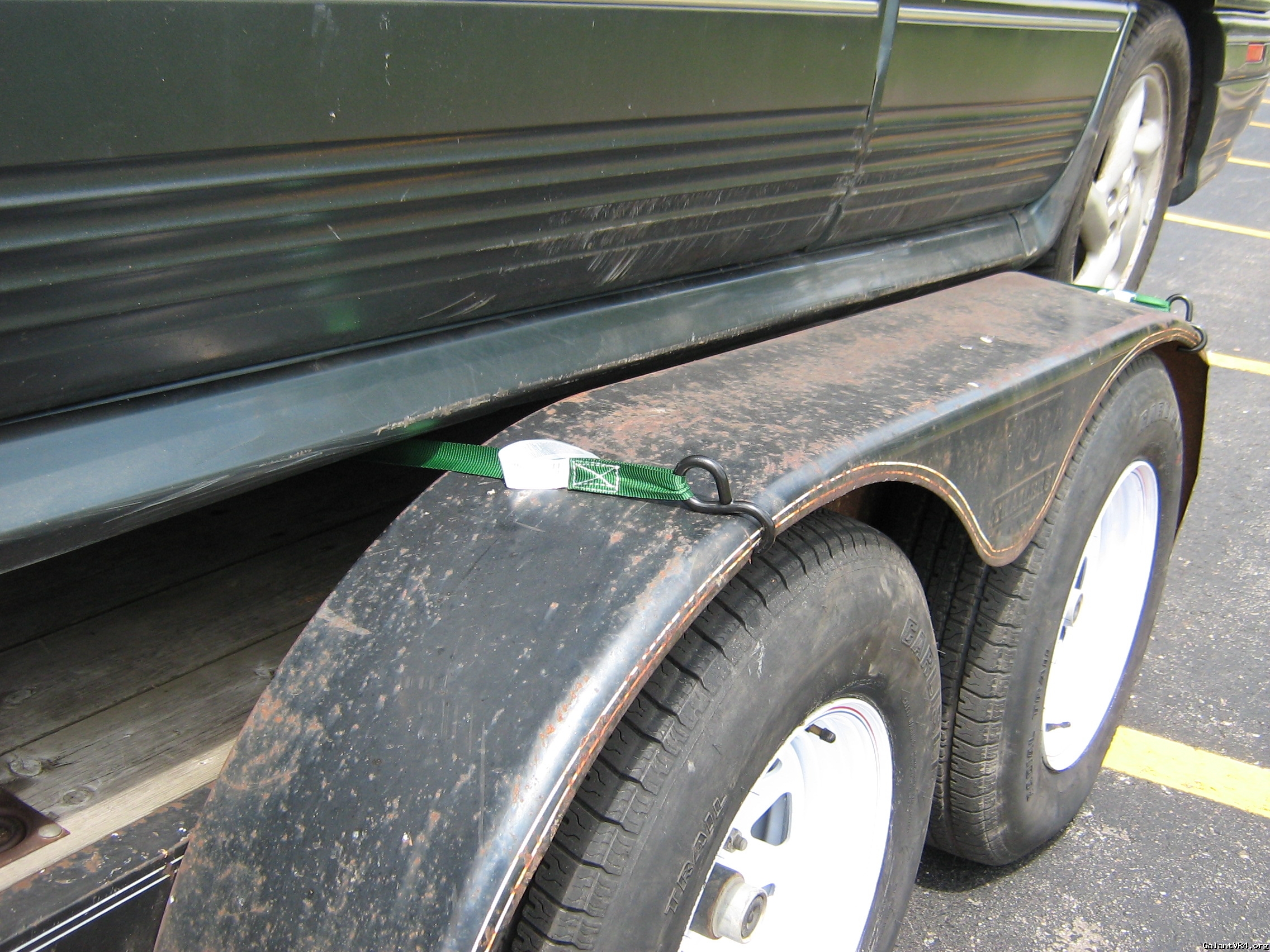

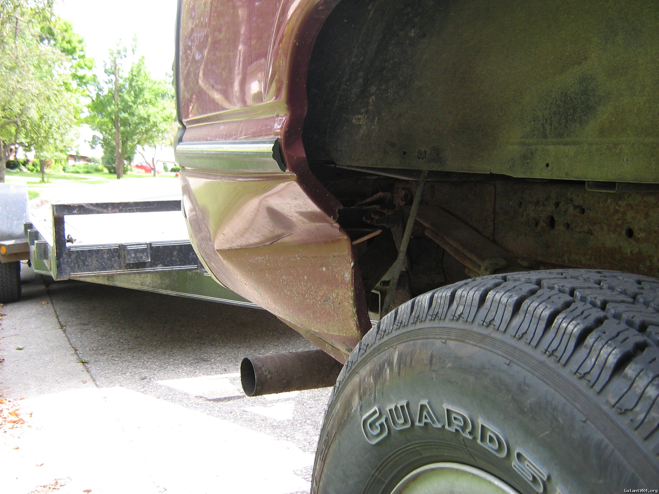

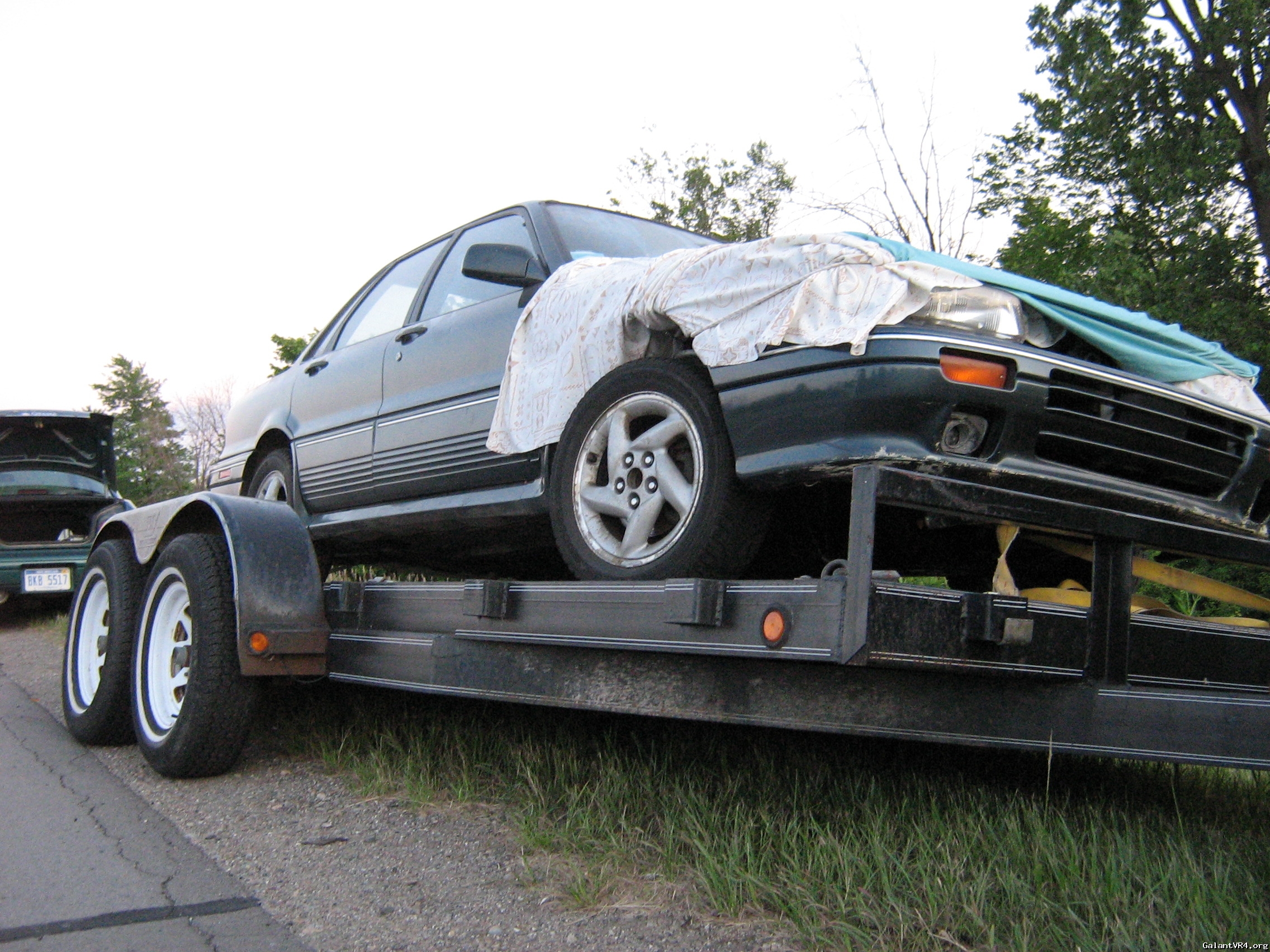

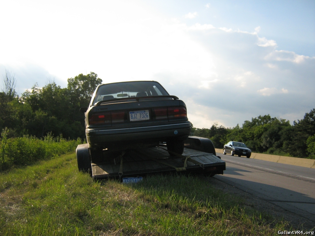

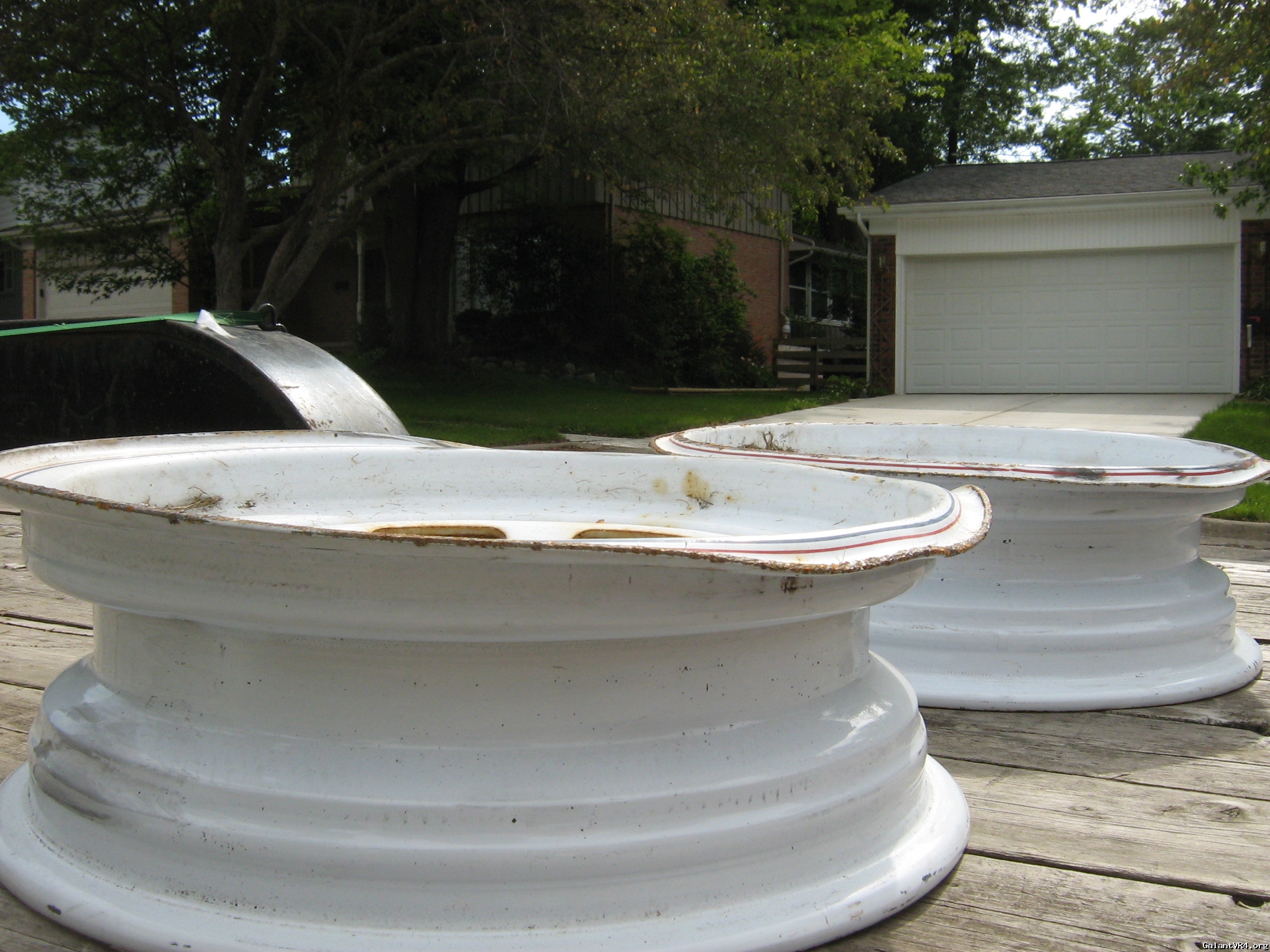

Here are some more pictures for y'all:
New Wheels/tires
Nice perspective shot
I wish I would have gotten a better shot of this, but you can see the truck is level, the trailer is at a relatively extreme pitch /ubbthreads/images/graemlins/ooo.gif
Uncles truck with state boy cruiser behind
Target: home of ratchet straps and limeaid /ubbthreads/images/graemlins/smile.gif
582 safely at TRF
Rear quarter damage
Passenger side
Drivers side(concrete median impact side)
Wheel carnage

Could of been much worse but it wasn't and that is good to see and glad you are alright. I couldn't imagine what you were thinking when all that went down. I am a bit surprised the GVR4 managed to stay on the trailer after all that happened....that Galant was hanging on for dear life not wanting to go out like that. /ubbthreads/images/graemlins/cool.gif
a2vr4
Aug 13, 2005
1,551
Ann Arbor MI
Yeah as you can see in the pictures she slid as far as the fender would let her, but I'm glad the straps held strong /ubbthreads/images/graemlins/worthy.gif I ordered the rest of the parts to get the motor in the car today, flywheel is being refinished. All that is left to buy is oil cooler lines/hardware, intercooler pipe material, wheels and tires! Hope to have her going by my birthday(next week) /ubbthreads/images/graemlins/grin.gif Tomorrow I will be taking the axles off the trailer and trying to straighten the spring mounts, any one have a method to recommend? Thanks for reading y'all, and I'll keep updating as i go.

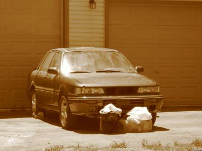

Well it has been a few months, plenty of mishaps and hold ups, but remarkably 582 is on the ground! No longer officially JSB, but now of course she wont start, and I can't find my palm interface software /ubbthreads/images/graemlins/banghead.gif (Palm100's loose everything when the battery's die or get bumped) So it looks like she wont drive on Christmas /ubbthreads/images/graemlins/frown.gif but the next few days should she her on the road. Recap on new parts: fresh stock rebuild engine(entire longblock), miscellaneous new engine bay bits, fresh brakes all round, Ingalls adjustable rear control arms, fresh ball-joints, fresh endlinks, and coming soon 18g, and custom fmic, then when summer rolls around '91 3si vr4 17"s wrapped in to-be purchased rubber. /ubbthreads/images/graemlins/grin.gif Holyrun-onsentence! Anyway, just wanted to catch y'all up!
