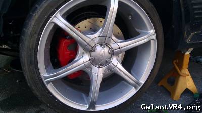

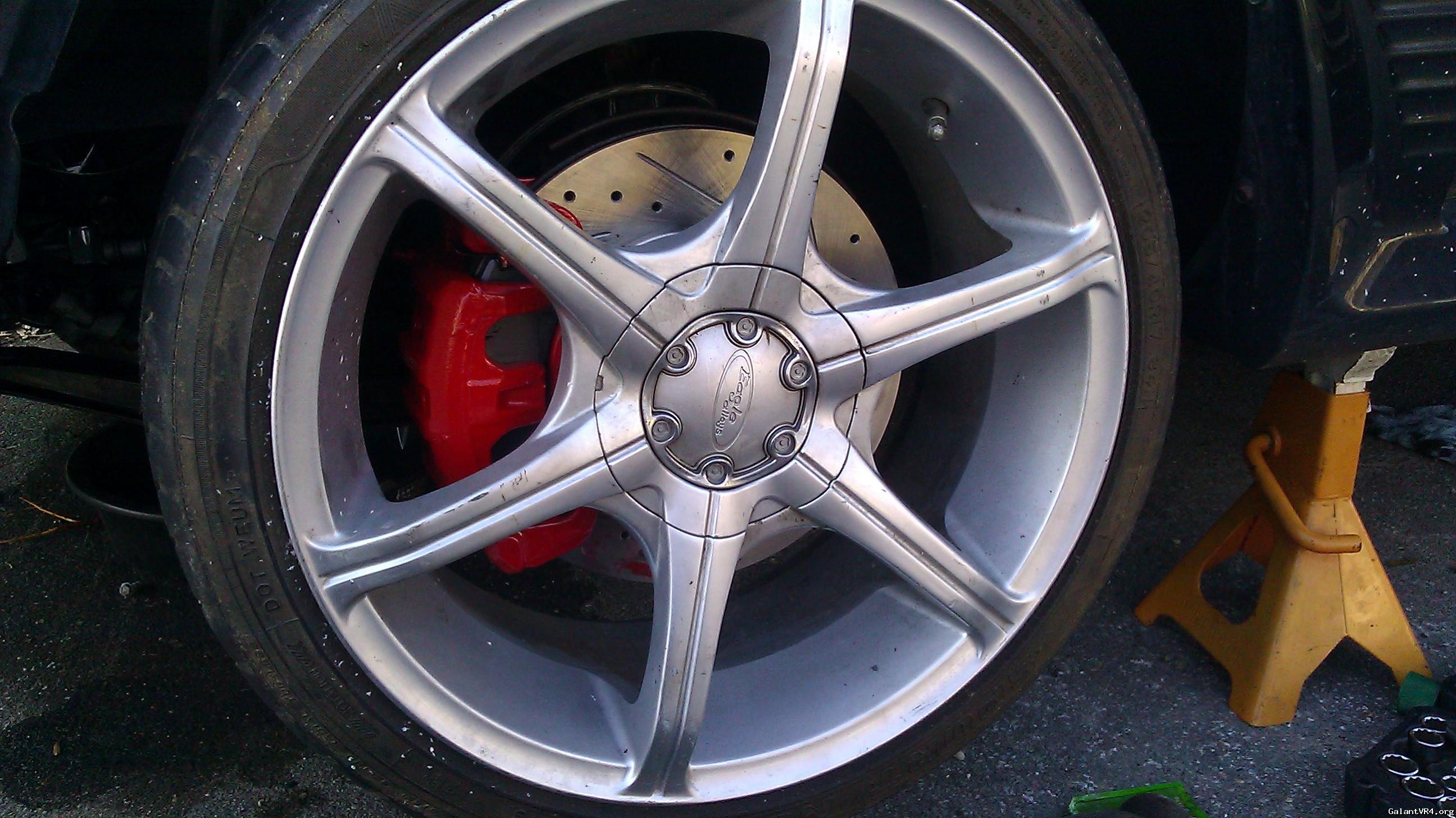

i got 3kgt base/sl drilled and slotted with stoptech pads for the front and 93dsms for the rear. the 3kgt base/sl have the exact same setup as the 5lug swaped gvr4 and they shouldnt cost a too much.
