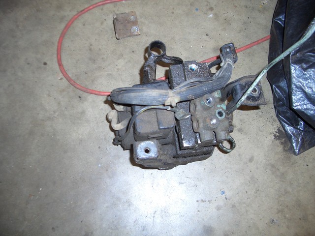

do yourself a favor, don't worry about the abs, in fact, tear that crap out while you're in there. /ubbthreads/images/graemlins/smile.gif
Armitage
Oct 16, 2003
715
Herndon, VA
+1 on scrapping the ABS. It barely works anyway. Removal of the ABS pump saves a surprising amount of weight as the thing is HEAVY.
