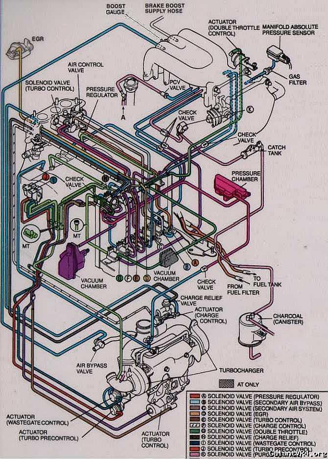

Have you seen the fd's "rats nest"? If you don't call that crazy, what is? lol..
I cried day&night trouble shooting that darn thing. /ubbthreads/images/graemlins/banghead.gif
