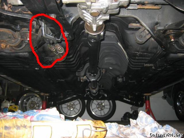

what part number does these 2 lines have and where can i get them online?
the once on the GSX? no turbo 4wd/4ws 2.0 i drive was hit and start leaking
i want to keep the the 4ws never driven anything so great
i have these part number but witch 2 is it?

If you are asking about the two hard lines that join to the rubber hoses, those are these two:
MB564866
MB564867

the reason we have come up with since they started leaking is we hit a alot of pot holes the other day
and the Rack had moved witch caused one of the pipes to leak because the rack was not tighten down with also explanies why the steering wheels has moved like 45 degrease to the right /ubbthreads/images/graemlins/shocked.gif
10,992
Doesn't really affect you gmt^2. That means only one piece of the MBxxx867 part number is available in the US parts system.
