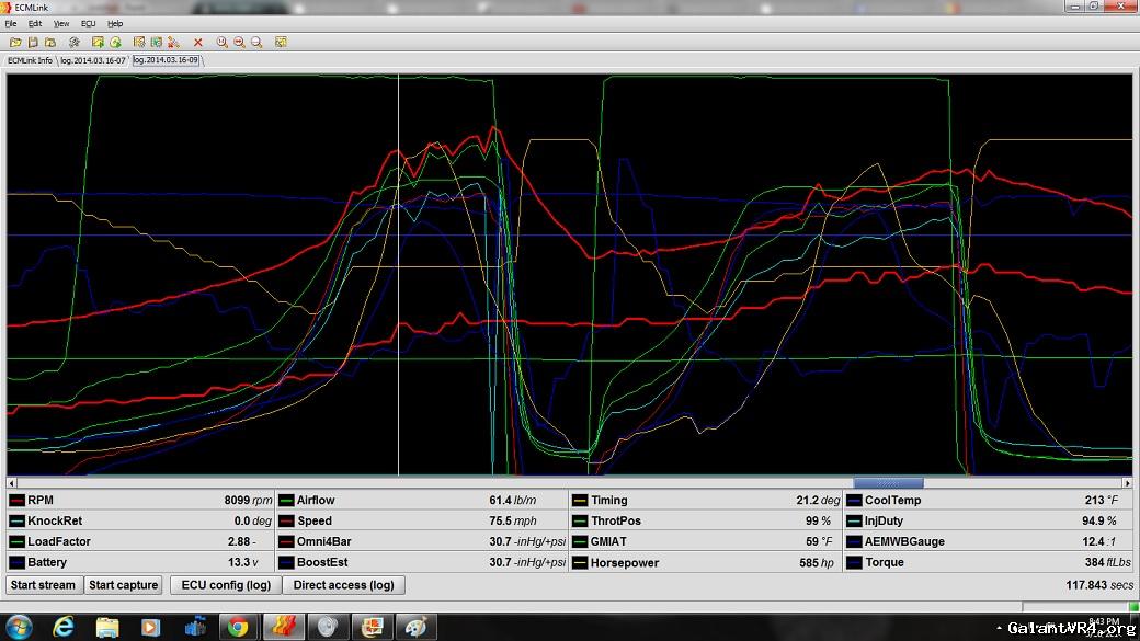

You're on E85 I assume? What's your current fuel pressure? Also, stock return?
diambo4life
Jul 7, 2013
323
Edmond, Oklahoma
Yes sir...stock BFP. E85...maybe E65 /ubbthreads/images/graemlins/rofl.gif & stock return.
Top bold red line is rpm. The bottom bold red line is speed. Wheel spin. I need tires. /ubbthreads/images/graemlins/tongue.gif

I have enough fuel now (for now) but my charging system is not keeping up with the amp draw uptop it seems. As per my latest log, I'm seeing 78-80% IDC uptop with 11.8-12.0 AFR on 31-32psi boost. That was with rather "warm" 83 degF AIT. 1600cc's at 50psi BFP. /ubbthreads/images/graemlins/dunno.gif The car is very strong...however. /ubbthreads/images/graemlins/cool.gif If I wasn't such a b!tch and scared of breaking it at the track, I would run it next weekend at this power level.
