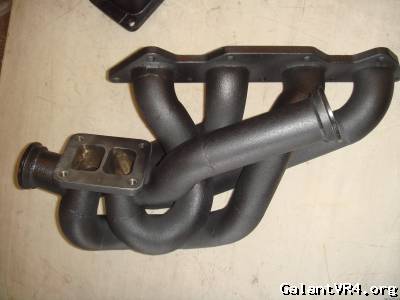

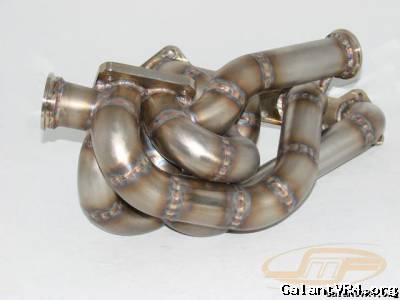

They did a lot to my car I decided to do a little more then the first guy was going to do... I had them build me a T4 top mount divided exhaust manifold specifically for the Galant VR4 engine bay with dual 44mm Tial waste gates. It retains AC and power steering /ubbthreads/images/graemlins/smile.gif I also had them do a 3" down pipe all vband that opens up to 3 1/2" under the car with two straight threw race mufflers and one straight threw big muffler at the end with two 2 1/2" tips so it looks stock from behind. I changed all the intercooler piping to stainless steel shortened the routing and cleaned it up. Small PC680 battery kit where stock battery use to be and a 4" intake pipe. Breather / catch can -10an bungs. I also bought the drag intake manifold and installed a 63mm rebuilt throttle body. Its a 35RHTA .84 T4 twin scroll turbo.

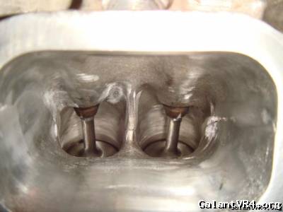

Now from here I started working on my valve cover put some -10an bungs and fittings in it made a new smaller baffle for in the valve cover. I installed a Kigglys oil pressure mod in the head while it was apart. I retorqued the head down removed the BC 272's and replaced them with some Kelford 272's. Surprisingly they were almost dead on they were only 1 degree off. Installed a forward facing oil filter housing and -8an fittings to prep for oil cooler. Changed oil and filter Primed the motor put new HKS timing belt on installed clear timing cover.
