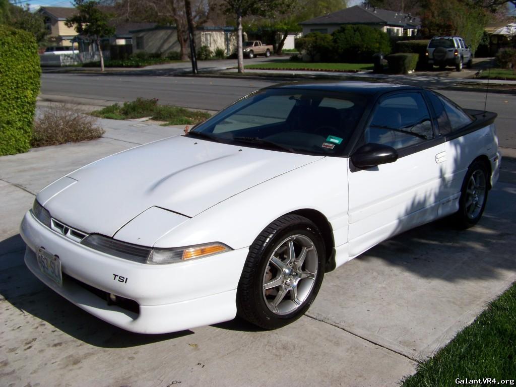

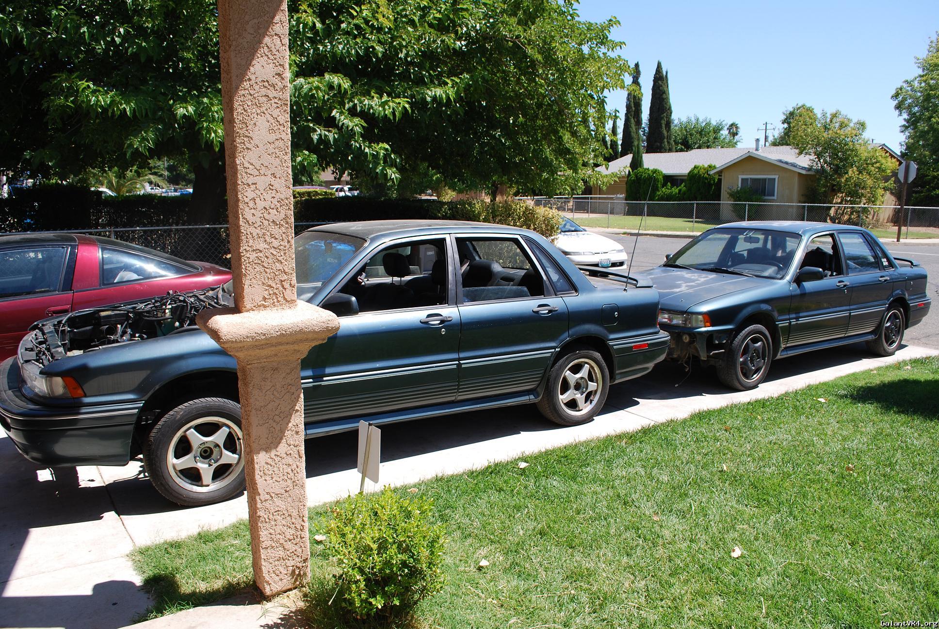

I decided to just go ahead and start a build thread for my first Galant VR4 #435. I am pretty new the board but I am trying to weasel my way in and get to meet some people. I was a big honda lover but crossed over to Mitsubishi about 2 years ago after buying a original 89 Colt GT. I picked the VR4 up almost 2 months ago from a the second owner of the car . The car suddenly quit running one day and the owner decided to store it for 6 years? /ubbthreads/images/graemlins/dunno.gif Owner said he though it was electrical related but I didn't really care being the car was only $900. Car has a clean title pretty good body besides some front end dents and clearcoat issues. It even came with the original matching key ring badge and key. I found the original Dealership window tag with the fuel ratings and price tag in the glove box with ful maintainance records. When I got the car home I pulled the timing belt cover off to find a snapped timing belt... So I pulled the motor within a few days to start a rebuild.

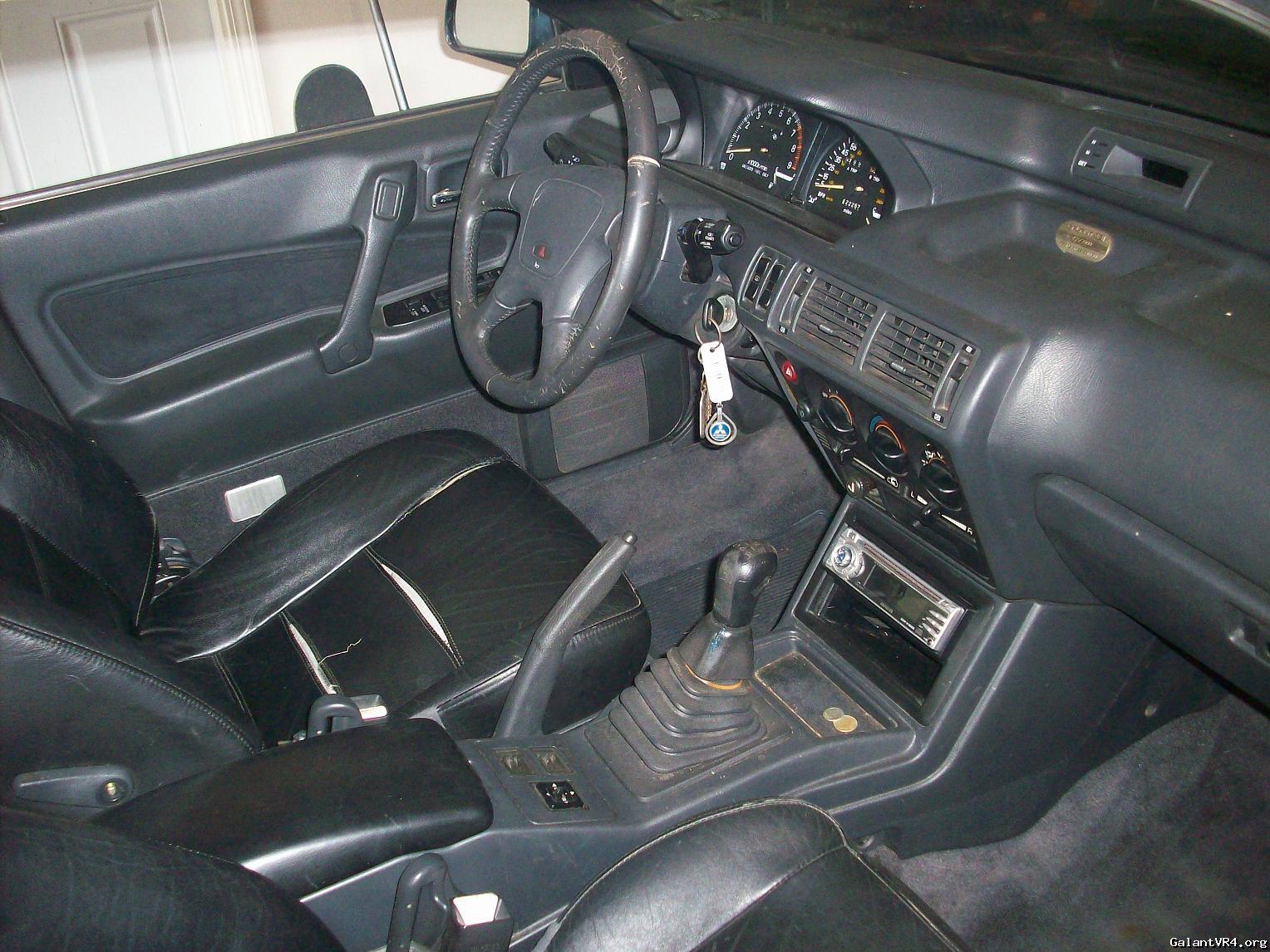

Interior shot

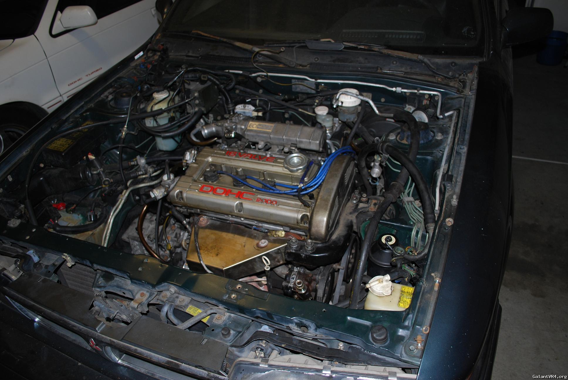

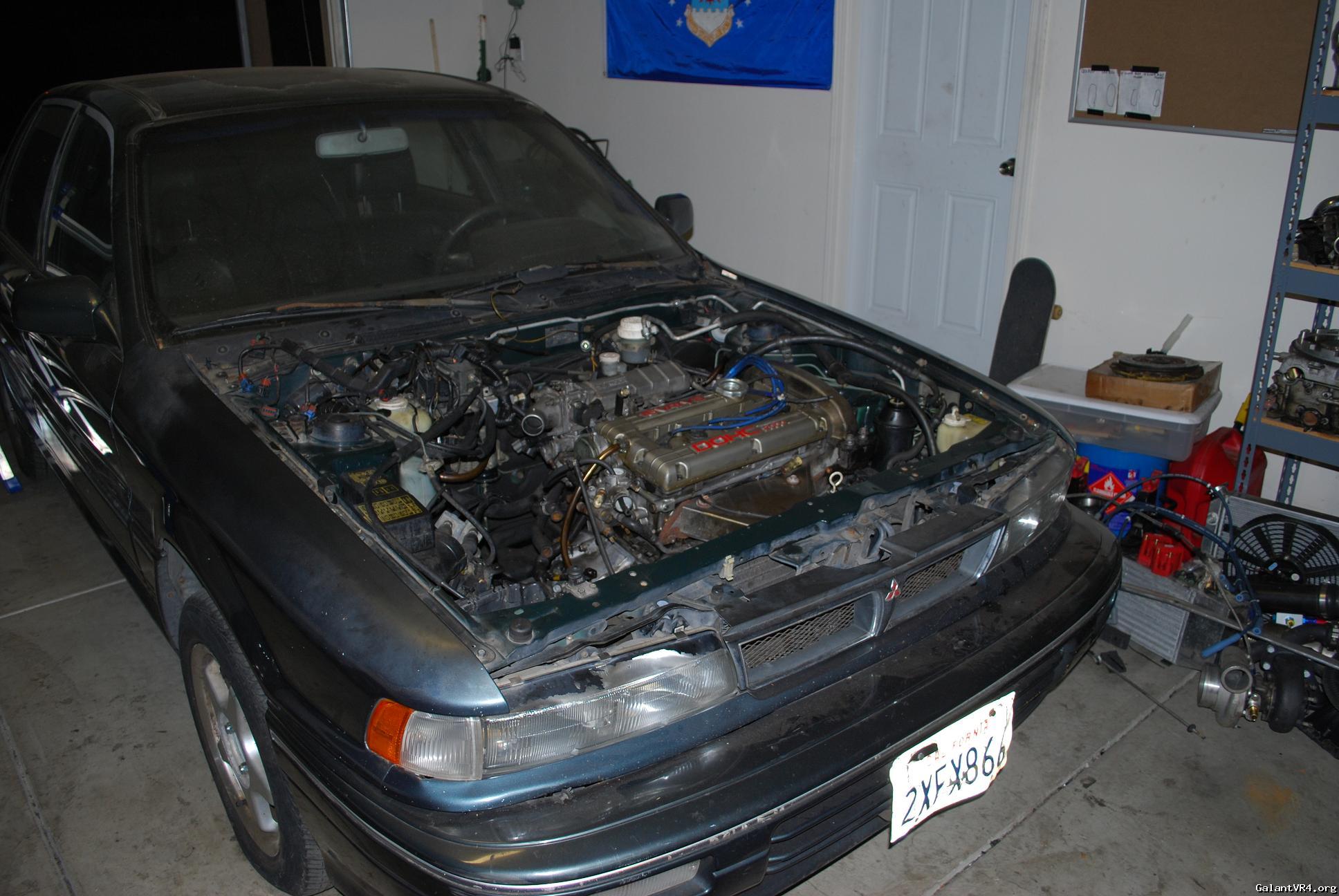

Orignal Engine out

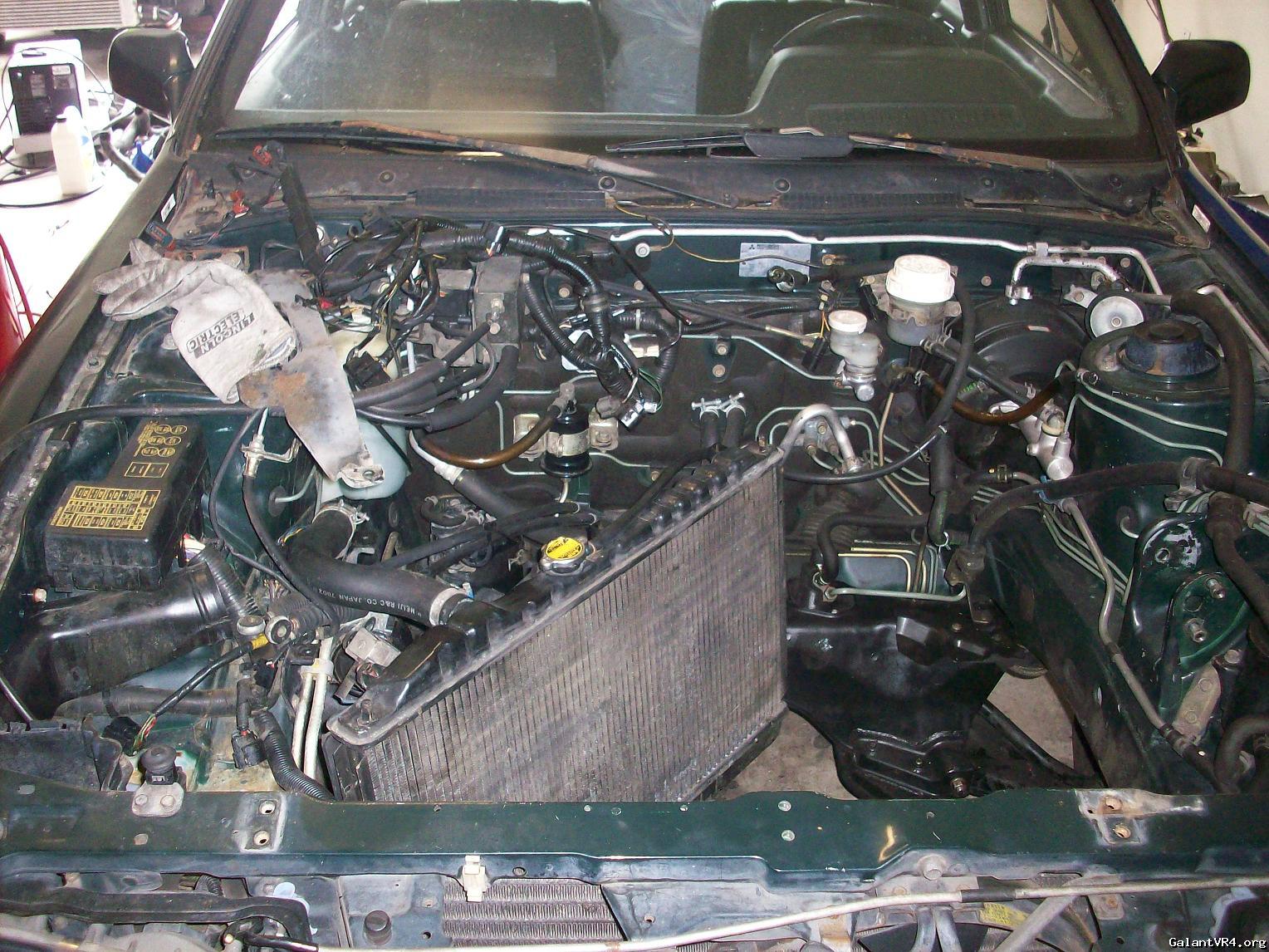

Some pressure washing of the engine bay cleaned up pretty nice

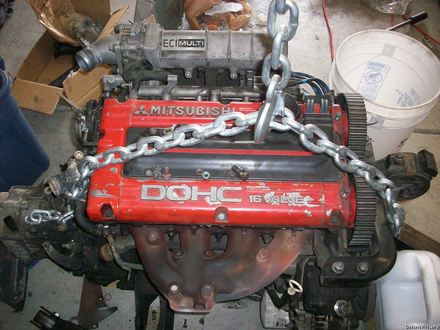

I started tearing the motor apart for a rebuild. I found a few bent valves after pulling the head off but bottom end looked good. I cam across a 1G FWD DSM on craiglist for $1500 with rebuilt motor with 50,000 on it and 3,000 on timing job so I decided to pick it up. I needed the tranny for my colt build so I decided I might as well get the car.

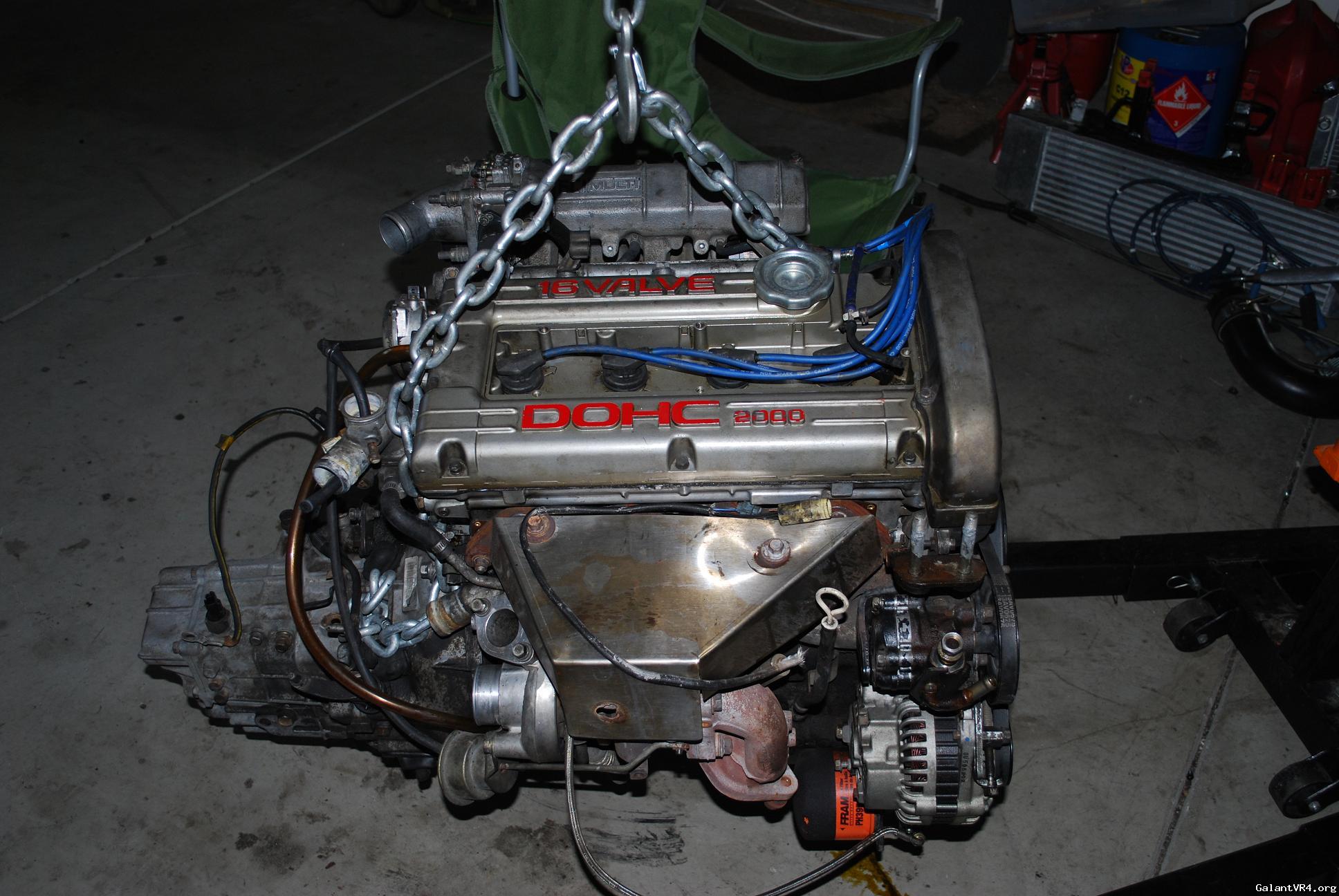

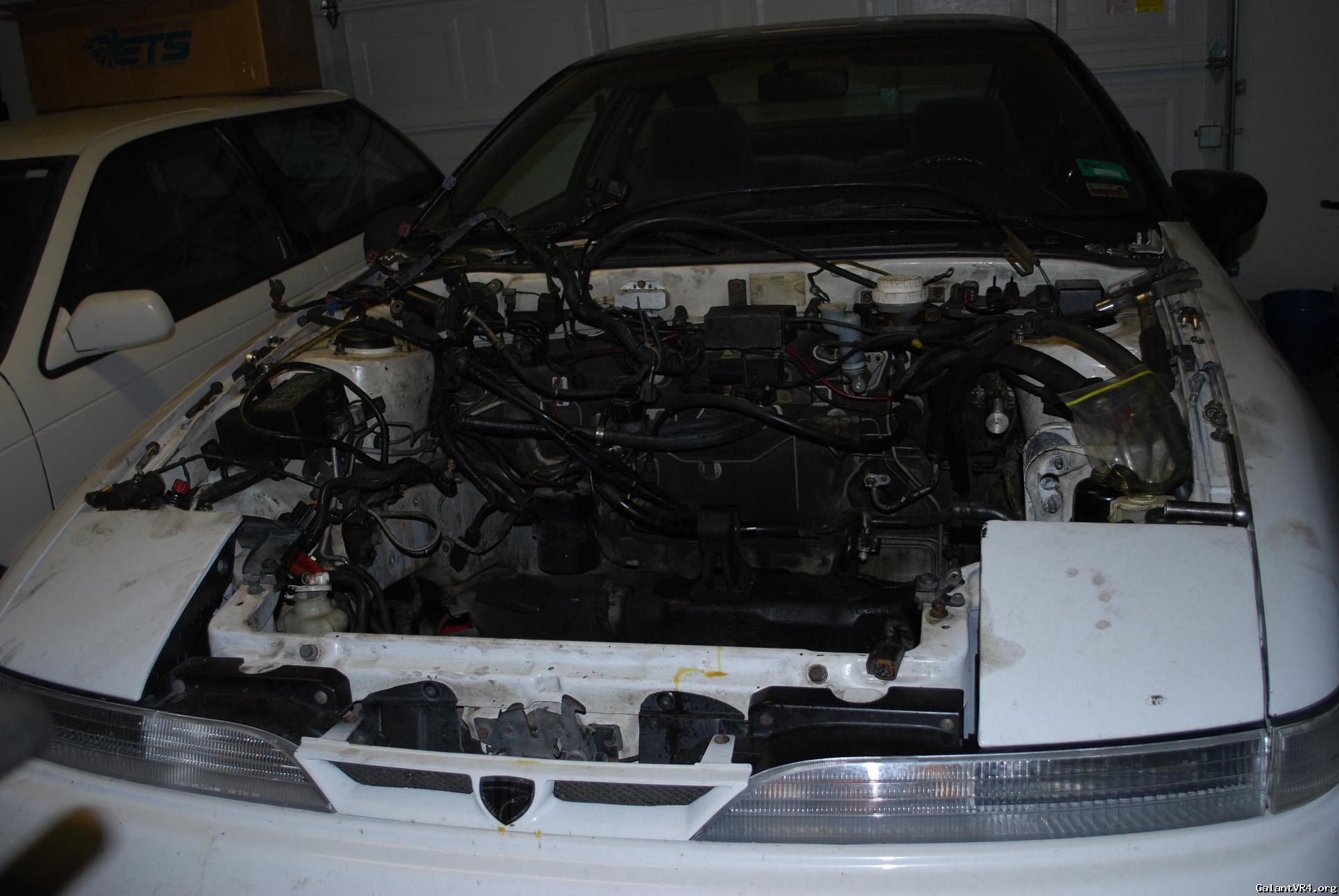

Started the engine pull 2 days ago..

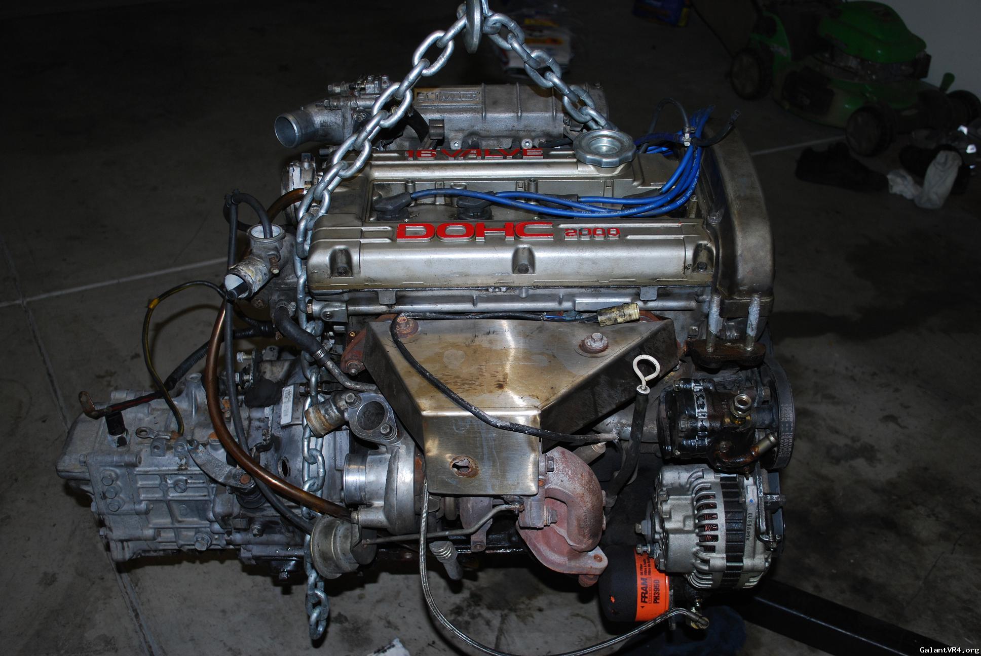

Engine out of the car in that night after lots of Captain Morgan and pizza. Not so white anymore...
Here is the engine out of the car. Gott apull the tranny off it and put the GVR4 tranny back on and do some engine cleaning
Some picstures of my DSM family. I have a car buying problem craigslist is very addicting when you find good deals
My twins...#435 & #1302

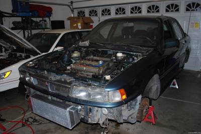

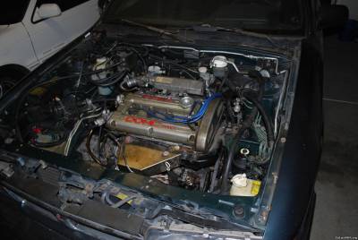

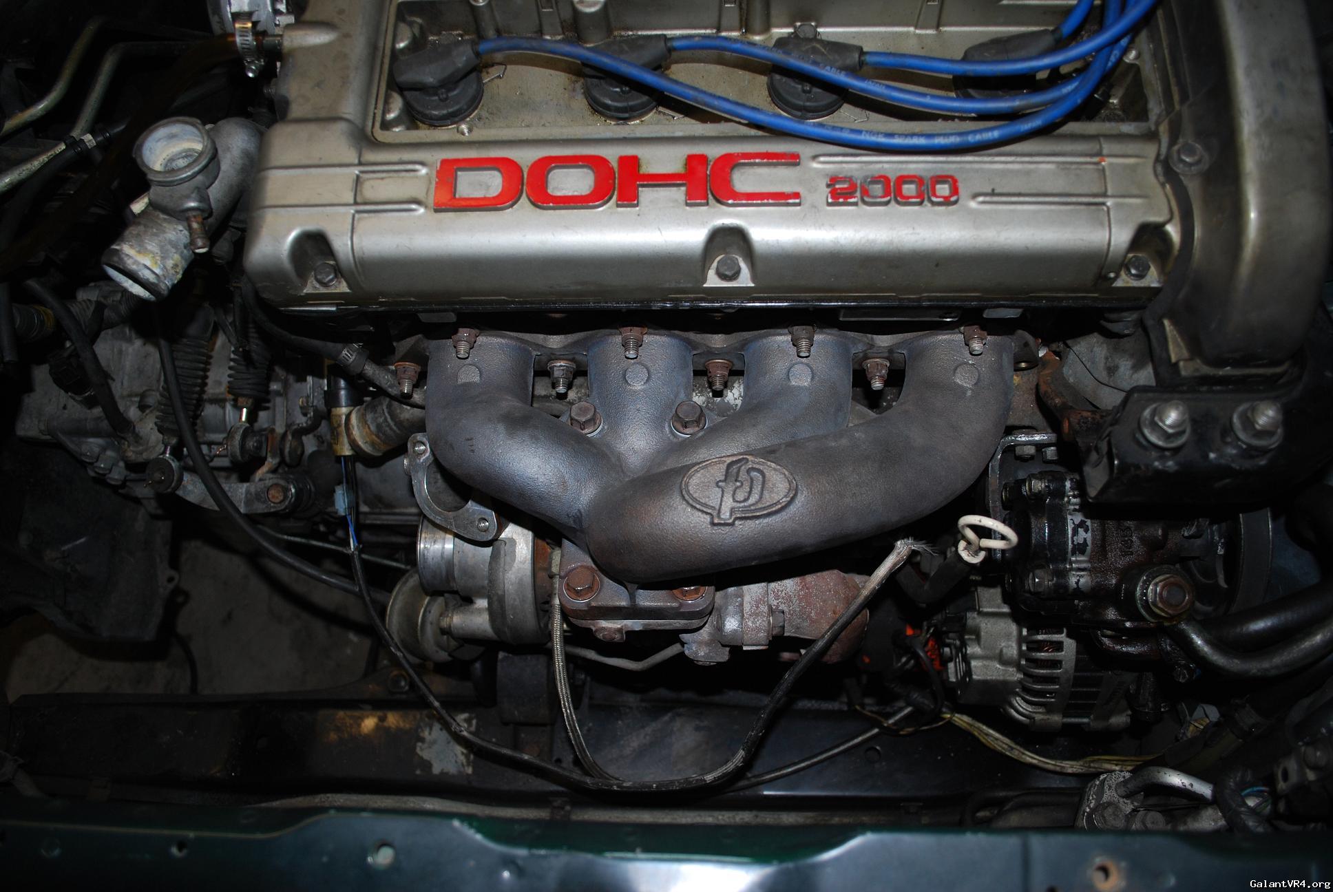

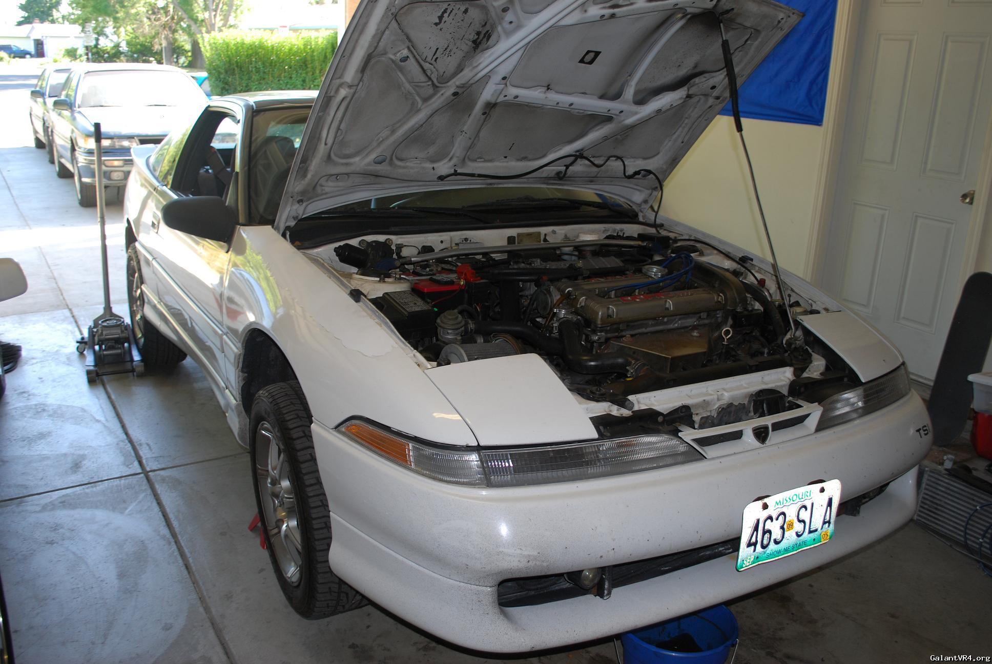

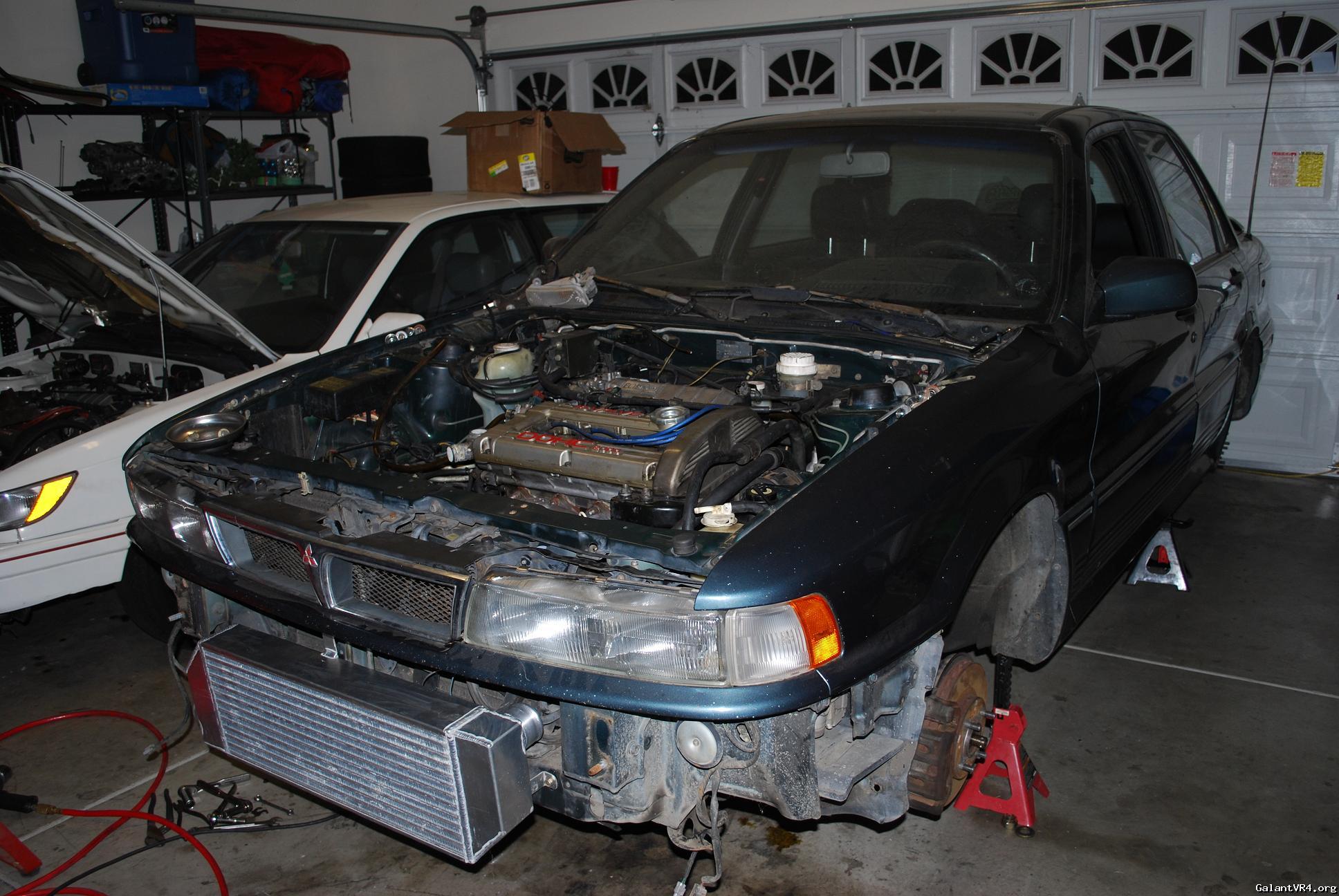

So been working on her for the last couple of days off and on. I got everything hooked up and started right up. Also dropped it on the ground temporarily to make sure everything was good drivetrain related. I pulled the FP manifold off my colt an bolted it on. Also got the ETS FMIC mounted. I was going to start anymore projects but I decided to go ahead and do the 5 lug swap, abs delete, and 4ws removal. I have all the stuff laying around and also new 3000gt brakes. I should have quite a bit done by the end of the weekend.
Fp manifold installed
ETS FMIC mounted and ready for the all the suspension, hubs, and rear end to be pulled out.

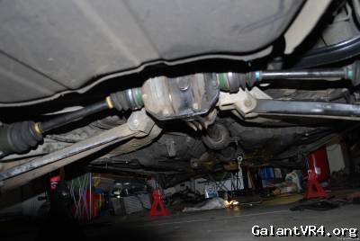

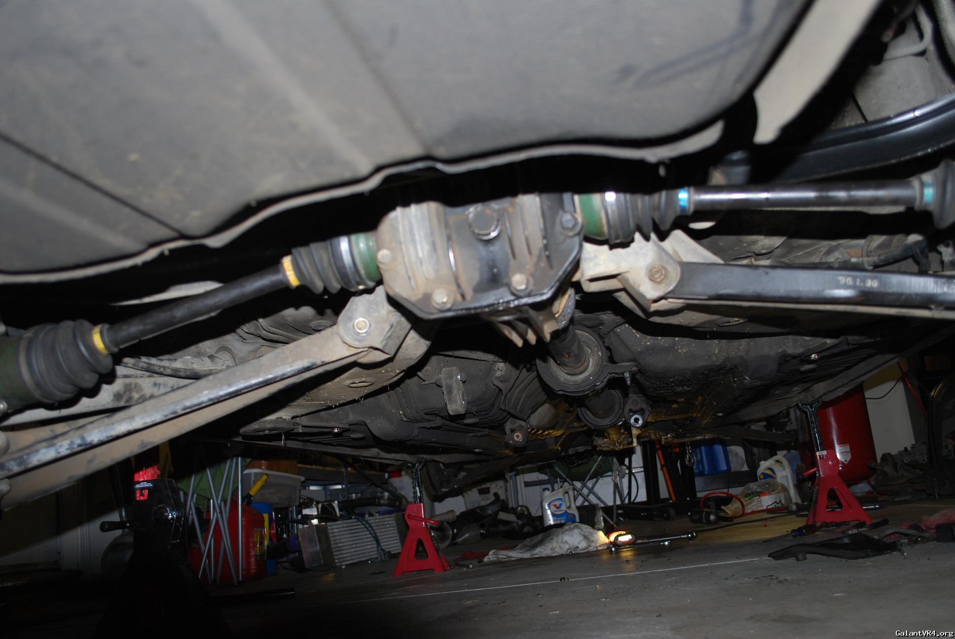

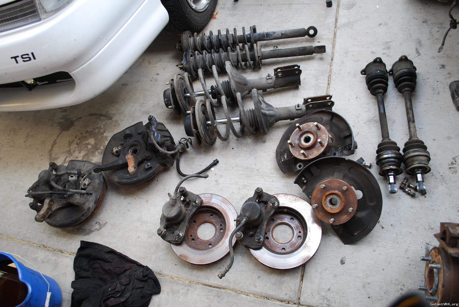

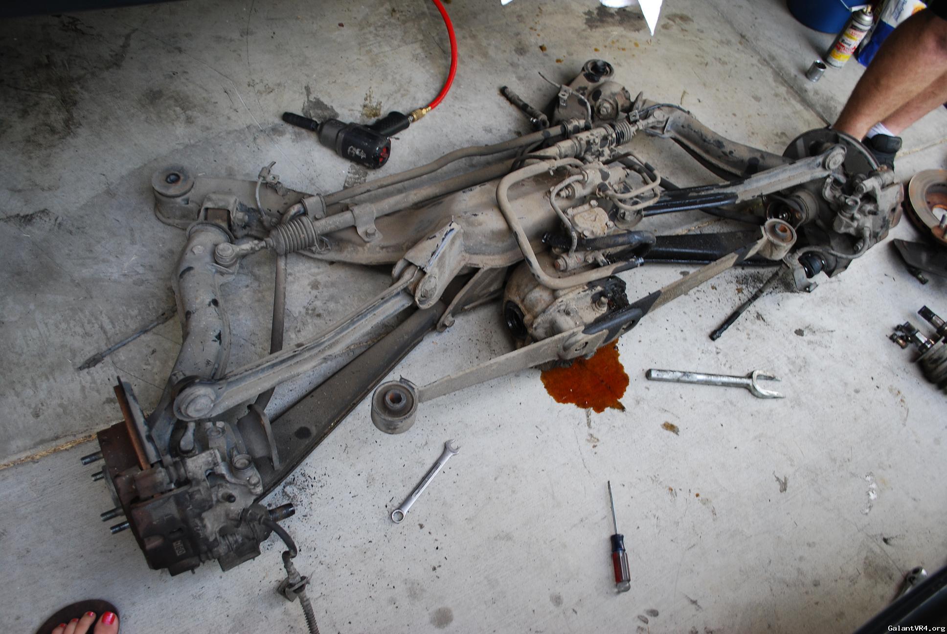

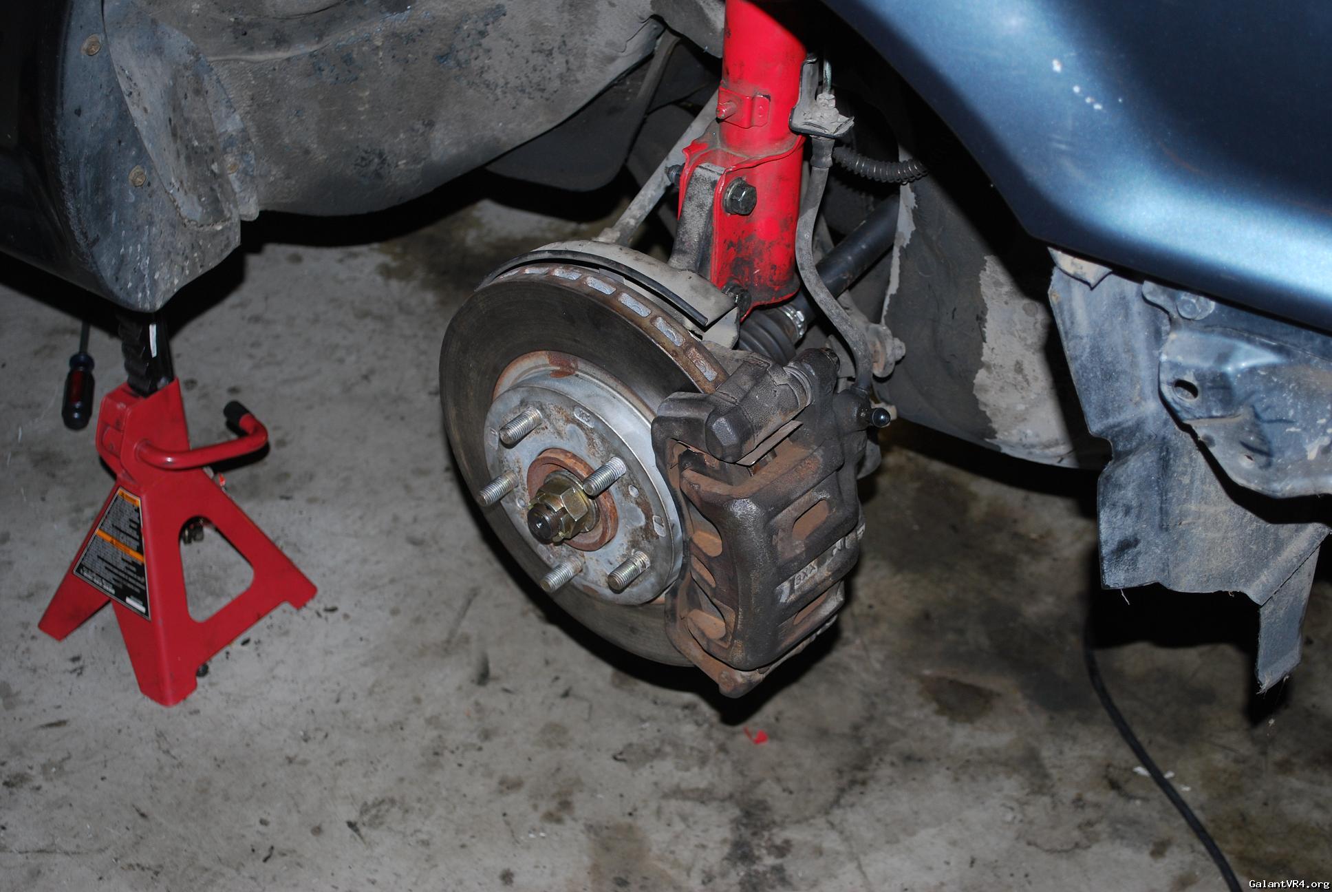

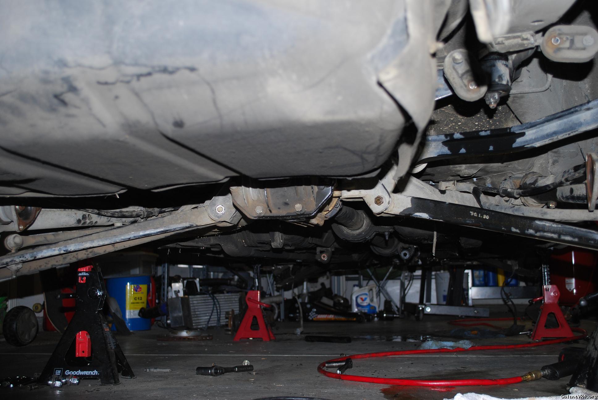

Got a lot accomplished today. I pulled the front hubs off and the whole rear end out. I also pulled off all the suspension. This was going to be my stopping point but for some reason I got ambitious and continued on... So I went and dragged my donor 90 DSM 3 Bolt LSD rear end out of my neighbors shed and hauled it over to my house. I also pulled the wheels and 3000gt brakes off the donor car. I starting pulling the 4ws and ABS out (what a nightmare). Lastly got the new rear end mounted and the driveshaft connected back up. I am going to try and knock out the front hubs, suspension, and hooking back everything, and finish removing 4WS and ABS over the weekend.
Removed the front hubs and suspension.
Old rear end pulled out
New rear end pulled out of the shed ready to put on and a real homo pic of me.
Removed some of the 4WS lines what a disaster my DSM is bleeding everywhere.
Rear end installed my stopping point for the night

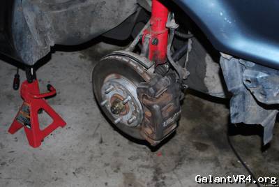

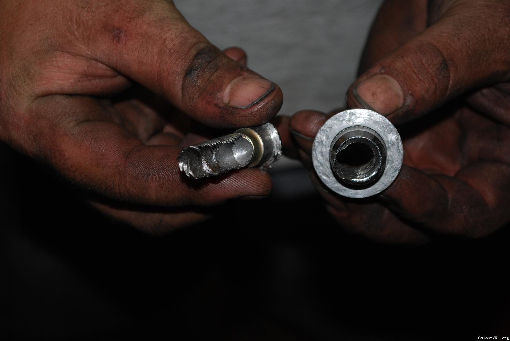

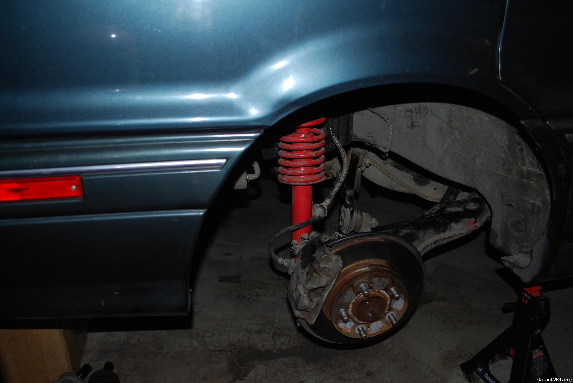

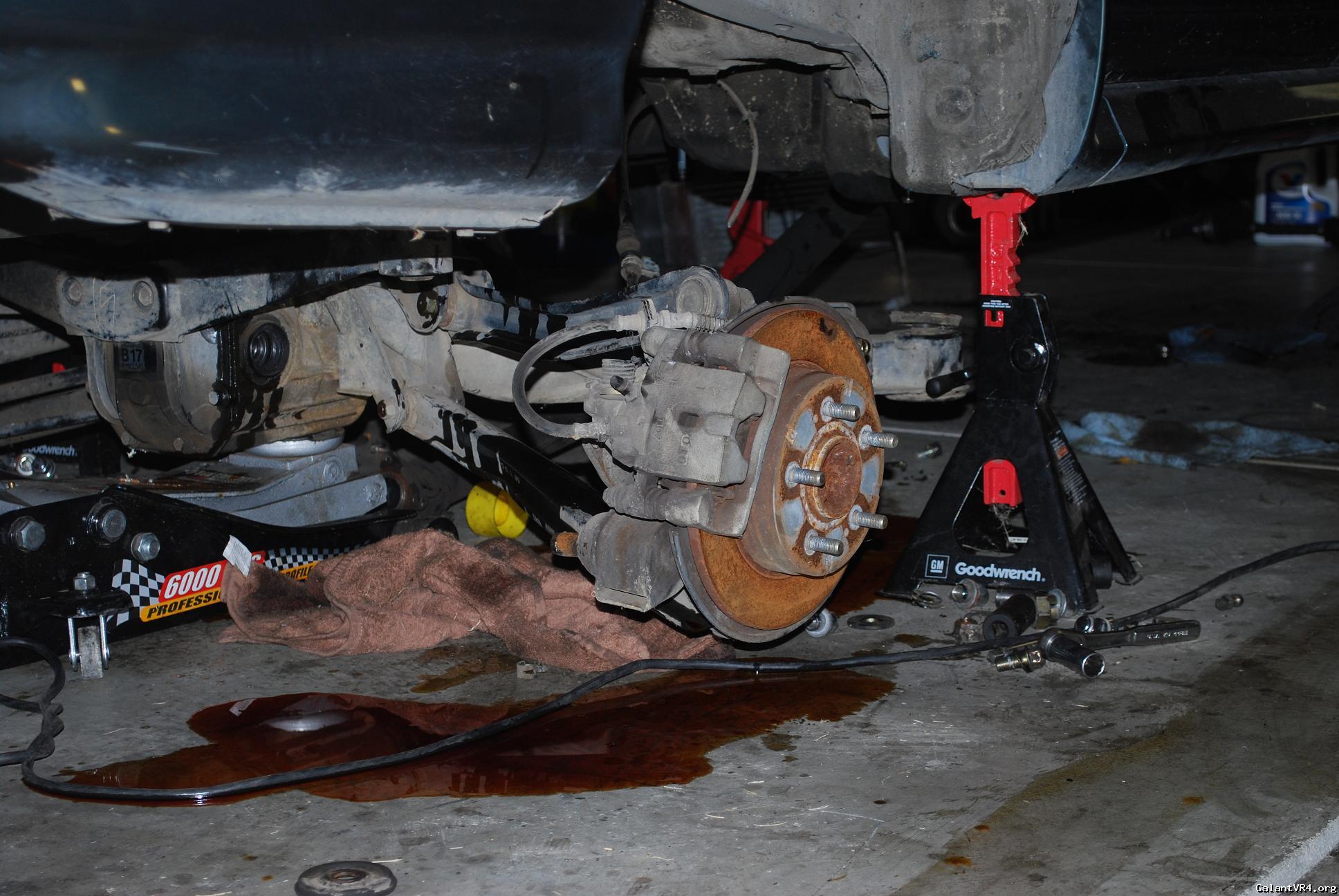

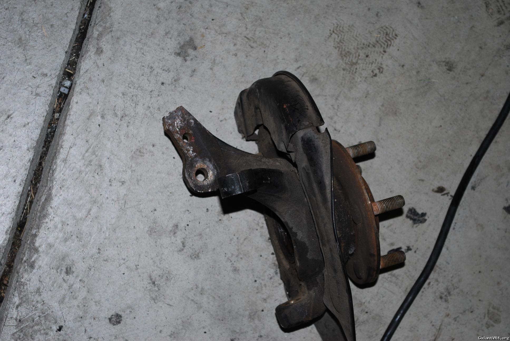

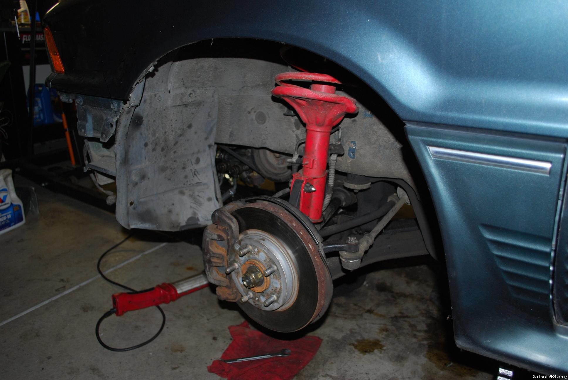

Today was a PITA! I ran into some dumb problems and didn't get as much accomplished as I wanted. I pulled out the rest of the 4WS crap, just need to plug the rack. I pulled my other donor car in the driveway and pulled the Suspension and rear rotors off it. This is where I ran into my big problem... On my last wheel on the passenger side rear I could only get 4 of the 5 lugnuts off. One of the studs had popped inward out of the hub with the lugnut still on....After fighting it for over an hour decided to try another route and drill it out. Fought it for another hour and finally broke the wheel loose! Then I put the suspension on the galant (AGX's with lowering springs) and swapped the rear rotors out. I stopped for the night because I realized my last donor front hub had a broken tab on it where the strut bolts up on it. So tommorrow I will take another 5 lug hub off another one of my DSM's. I have alot more little things I want to do but my main concern is finding 3 bolt LSD axles....nighty night
This was the solution the nightmare that set me back all night
Front hub and suspension installed
Rear hubs and rotors swapped out
My stopping point for the night FAIL!
I just woke up got the pics fixed. I am going to go get another front hub for the car and search for some axles..

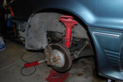

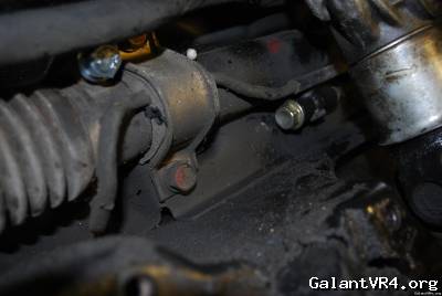

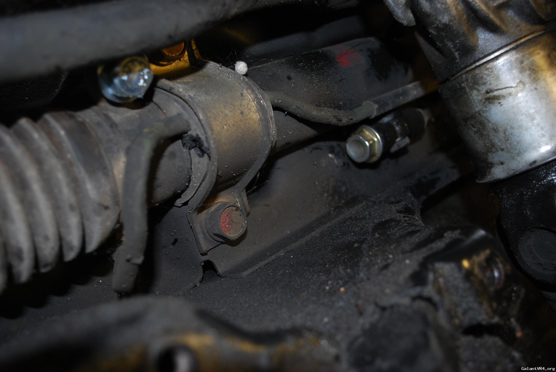

So I had a nightmare day at pick n pull long story but I found a Front spindle and got it installed today. I hooked up all the brake lines back up and got it bleeded. I also got some axles from my buddy installed to use until my other axles get here so I can get this thing on the road. I went ahead and filled the rear end with fluid also. I worked on the power steering some more and got the two spots on the rack plugged. Just to warn anyone that plans on doing the 4WS removal be prepared to make a mess, cuss alot, and get power steering fluid and gunk all over you. I have 2 hardlines that go through the front subframe and over the tranny that I am still fighting to get out. Anyways so I am near completion to get this on the road. My plans over the next day or two are; Get the oil cooler hooked up, change the oil and filter, install the ETS FMIC piping, EVO MAS, an EVO injectors. I still have alot more to do just want to finish all the stuff to get in driving down the road.
Rear axles installed
Front Spindle installed and all the brake lines hooked back up
4WS on the rack plugged (2 oil pan bolts with copper crush washers) BTW the lines that run to the rack are kind of pain to loosen up and pull out.
