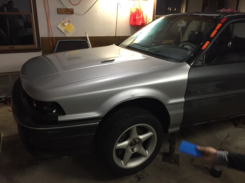

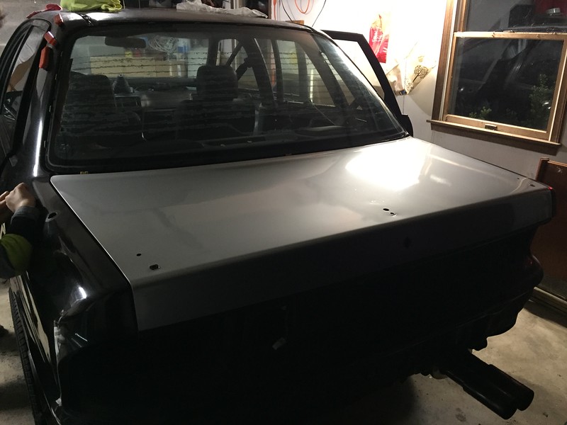

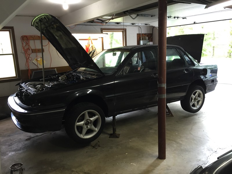

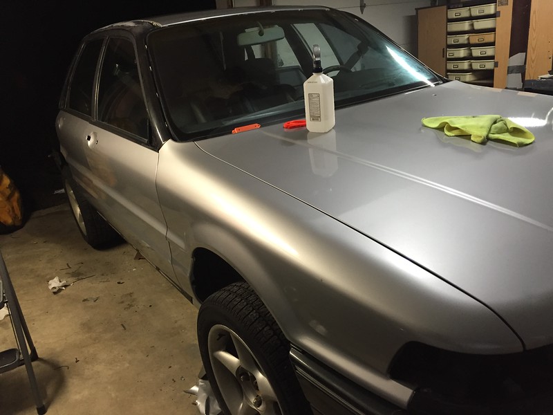

Progress for Thursday night:
Entire car gets wiped down with Alky once, then each panel again as you apply vinyl

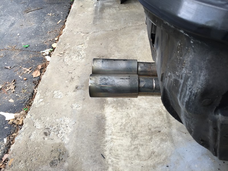

Going to need to shorten the exhaust a bit with the JDM-YO bumps
Up in the air...ready to wrap
That's where I'm at for tonight

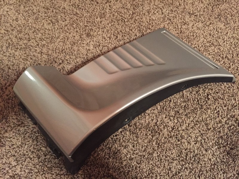

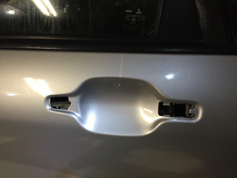

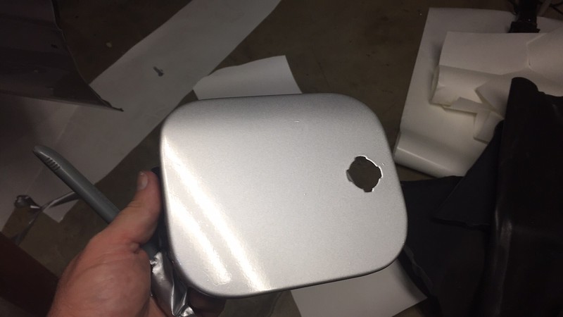

I made a stupid rookie mistake and poked a hole in the sheet for the rear drivers door....so I decided to try and not waste material, and gave it a go at trying to wrap some small complex pieces.:
Overall my quality level is abysmal. There are little wrinkles in the corners, and relief cuts that didn't cover 100%. Ill likely end up having to re-do the doglegs on the "inner wheel well" surface. but that area probably should be black anyway, not silver. And I don't have a technique to get the vinyl to settle into the "chrome strip" channel and stick there with sharp edges, so I cut that out on the front fender molding. But man I hate those stupid chrome strips, so Im going to have mike figure that out if it's possible to wrap all the door moldings and such in one piece without the chrome cut out.

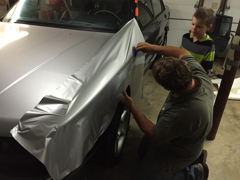

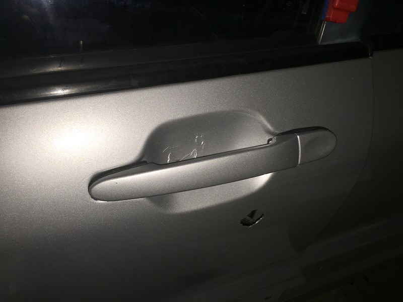

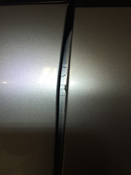

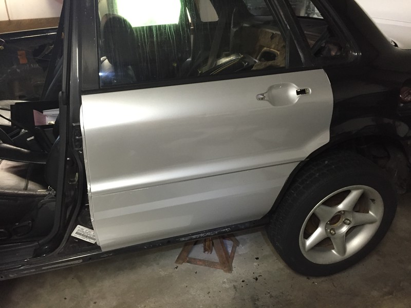

knocked out a rear door this afternoon before kids get home from school. Did much better in the door handle pocket this time, although I did have to make an overlap above it when I came up with too much stretched material. ehhh...by the time I get to the 5th door, Ill be good enough.
I have some wrinkles inside the door jab between the doors (where you'll never look, but whatever). That's after trying to make 2 sharp 90* angles on a countered edge. I don't think this is possible in one single sheet anyway. to do it spotless wrinkle free.

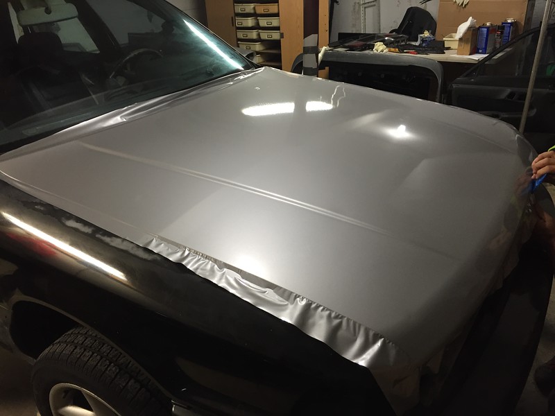

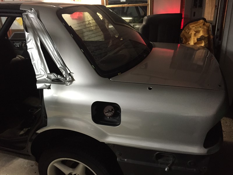

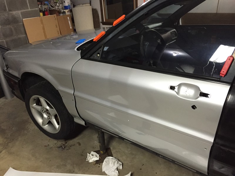

Some more pics of the process:
Door handles are going to be wrapped silver. (this one is just done temporary to see how it looks..theses need sealant glue under to keep it from peeling with use)
Drivers' 1/4 is done

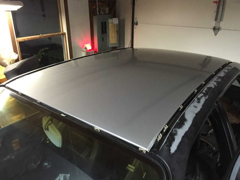

Roof is done with no wrinkles, bubbles, or blemishes.
Pass side needs the rear 1/4 done..BUT!!!! big butt......I was finally able to do my 4th door MINT...no blemishes! woooot (BIL went back and fixed my fuckups on prior doors for me..he rules)
So....moving along.

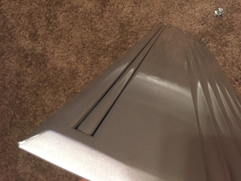

Mike basically said those chrome strips because of the deep recess....have to be cut out and done with a second piece. so...,now that I know the procedure...Sunday Im going to make the attempt on all 4 door covers, the remaining front fender molding, and the two long ground effects. Granted..Mother's Day...I have lots of cooking to do, so might not have that much time.

Thanks. The chrome strip can be covered with silver wrap...that's not a problem...it just can't be done in one continuous piece for the whole panel. I have to wrap the panel..then "cut out a window" for the chrome strip, then tuck the "window edges" under the chrome edges. Then cut out a little strip of scrap and cover the chrome strip..maybe using some edge sealer since it's so small and the chrome is kinda "slippery".

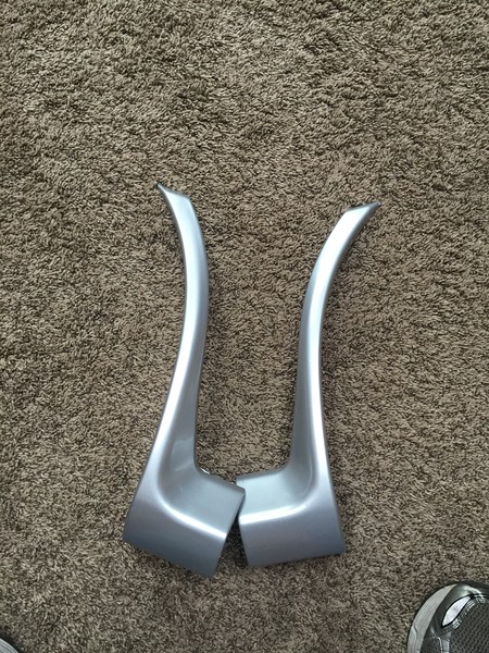

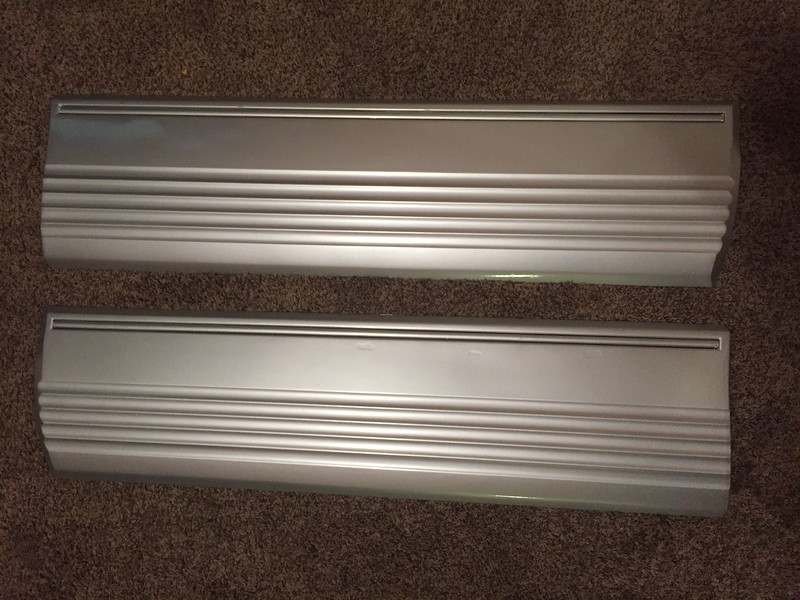

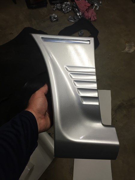

Well...I did get the two larger front door moldings done tonight while watching a movie with the kiddies:
They came out pretty much perfect /ubbthreads/images/graemlins/devil.gif
