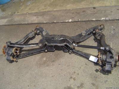

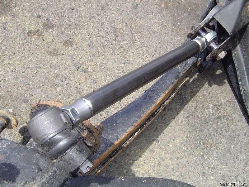

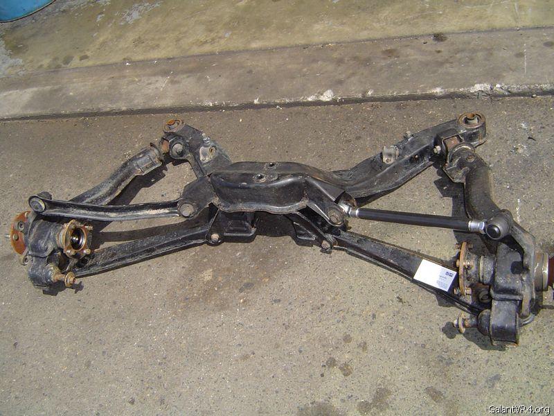

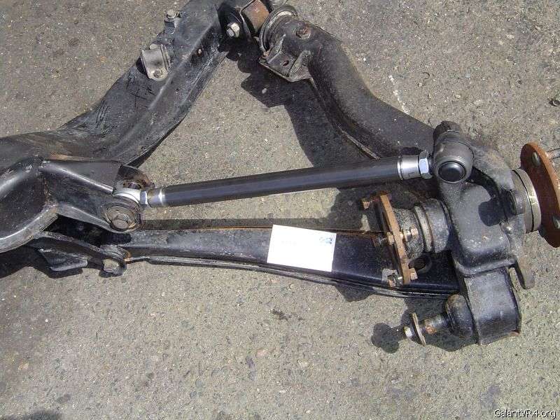

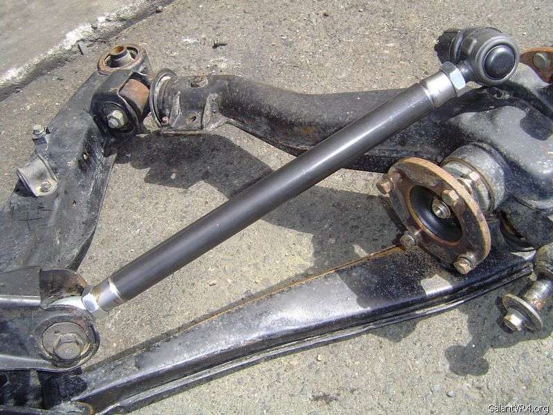

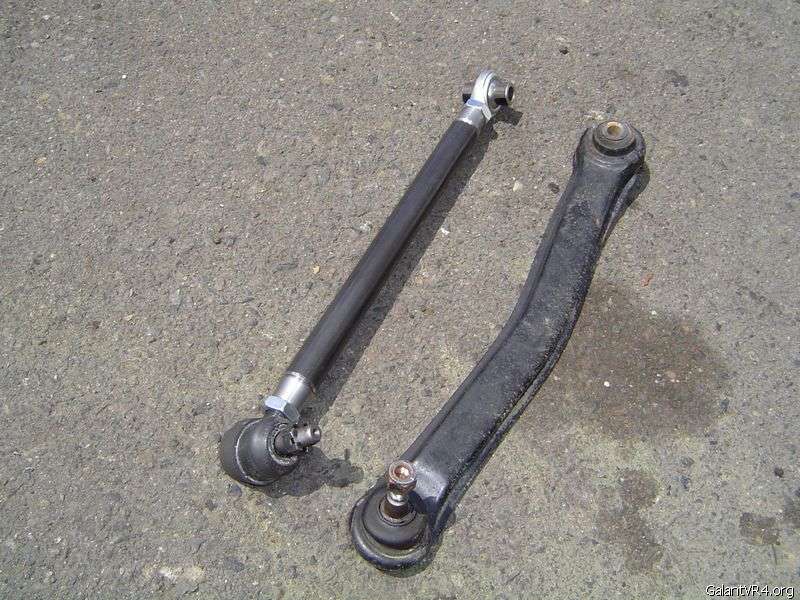

Latest cool thing I build.
4130 chromoly rear camber arm. Teflon lined rod end bearing. Regreaseable (zerk fitting) balljoint end. No mickey mouse material. No mickey mouse heim ends, washers, 1/2" bolt etc to deal with. I machine a special metal bushings so the tie rod end just bolt onto the subframe with your original 14mm eccentric bolt. You use the camber arm to set your "rough" camber at home and then go get a real alignment and still be able to use the factory eccentric camber bolt to fine tune your camber number at the alignment shop.

Looks hot. Depending on the price, I would be interested. One thing to think of is that some people would not want to use their stock bolt because of the shape it's in.
Keep in mind that the recipe for these is out there, be it with different parts. So pricing will determine if these will sell or not. Look really good though.

The recipe for the one out there is with the use the wrong size bolt. 1/2" bolt and washers is mickey mouse. Why would you want to downsize from the factory 14mm camber bolt to a 1/2" hardware? This one install with the original camber bolt for dual camber adjustment capability via the arm (rough) and the camber bolt (fine) itself. Or you can weld the camber washer for the camber bolt permanently to the subframe and have that bolt be permanently situated and do all your camber adjustment via the arm. Up to you.
The AFCO swaged tube used on the one out there is only made from regular mild steel. These are chromoly. Maybe you didnt understand what chromoly is. Like I said, serious product for serious racer. No mickey mouse parts. I hate mickey mouse parts.
As usual, everytime I make something that is nice and high quality and not bargain basement cheap, I will have some hater, but its ok. I expect that and will be able to deal with the hater better this time around. However, this is serious parts for serious guys only, if the chromoly arm ever bent, it will be the last of your problem. You'd lose your whole rear end to the wall or something crazy like that before this one will give you a problem.

I have only one comment. As I do alignments for a living, the eccentric bolt should be thrown out. It does not give you fine adjustment but rather crude adjustment compared to the metric threads on the arms. It is way easier to adjust it that way than fight with the factory eccentric bolts.

Yeah you did a good thing. The eccentric bolts are a pain in the ass to get an accurate adjustment out of them sometimes. The damn thing change all the time when you tighten the other side of the bolt to lock it in place. /ubbthreads/images/graemlins/banghead.gif
Nice piece none the less. I've made my own arms with a combination of suspension parts from other cars. Nice having access to a lot of old inner and outer tie rods, control arms and sh*t. /ubbthreads/images/graemlins/applause.gif
