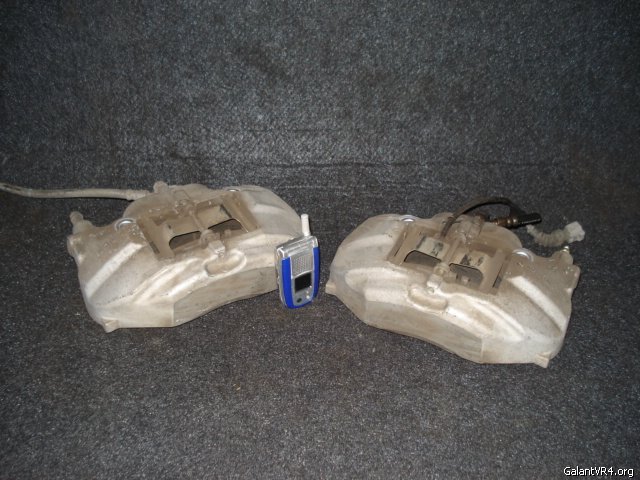

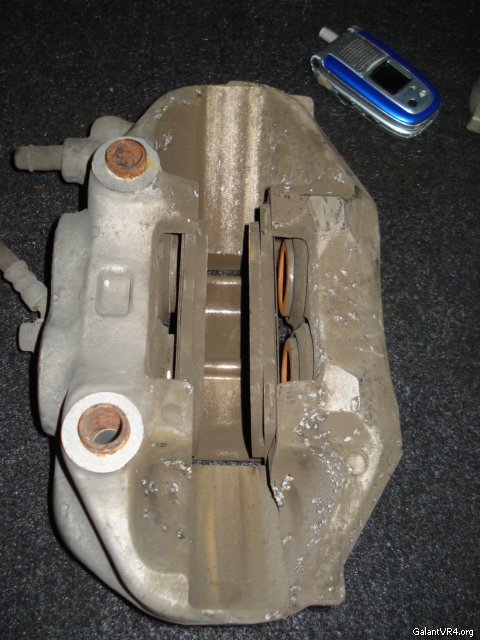

And what about these monsters? Who knows what they will do?
4 piston aluminum. Custom brackets will be neccesary, and I'm not telling you what they're from yet. It's a secret. /ubbthreads/images/graemlins/grin.gif
there was as set of those on ebay a few weeks ago. i thought about getting them but didn't really want to mess with making brackets

yeah, I say those are from a toyo truck. I always wondered what those calipers would look like on the vr4. Just to try and clear things up, the OP is talking about 3000 gt VR4 calipers vs the camaro ones, not the base sl model calipers which are identical to ours.

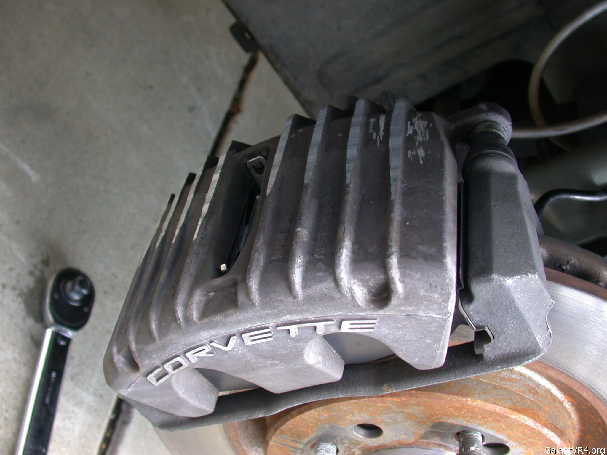

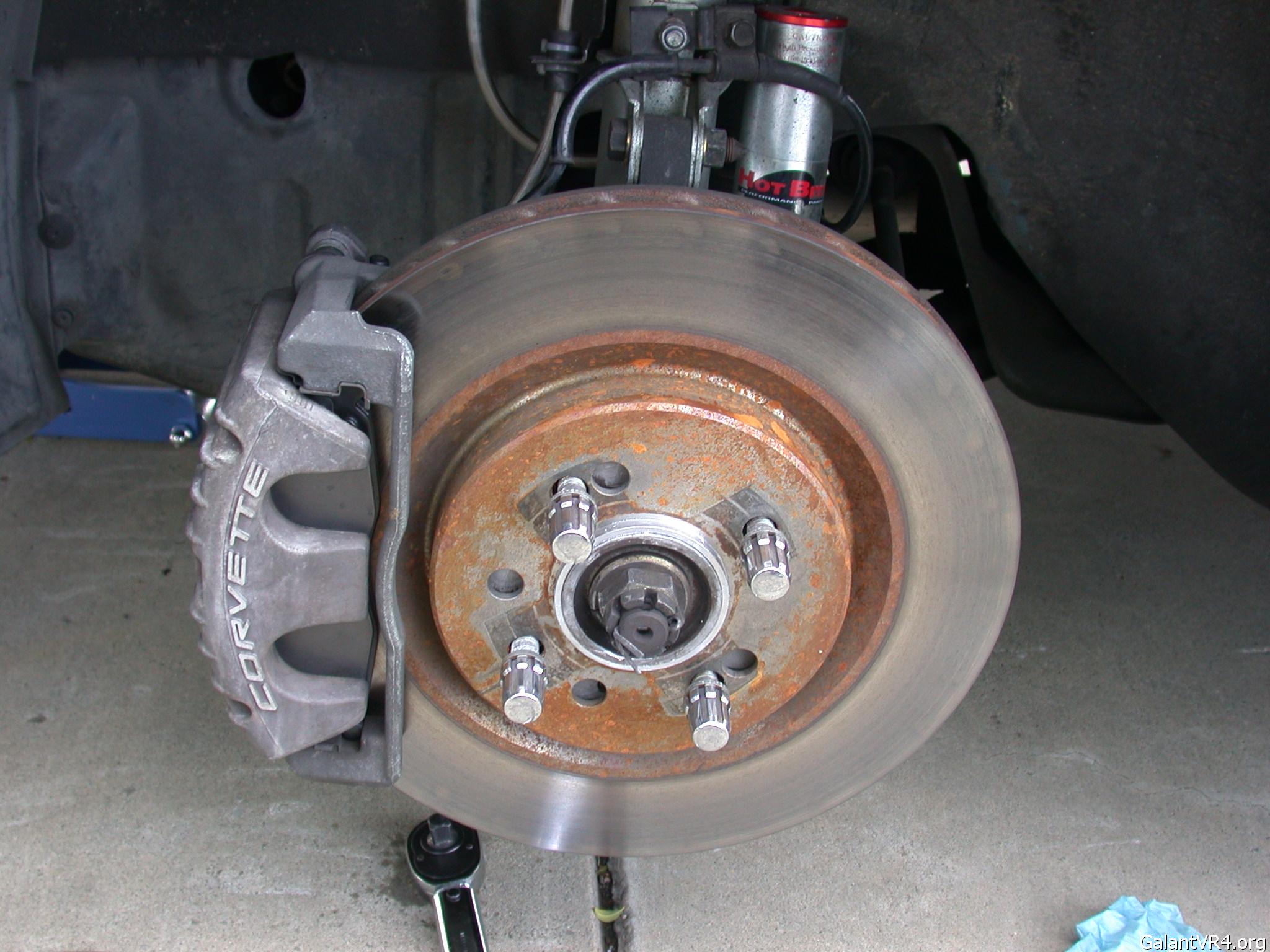

FYI, if you like the camaro calipers setup, you should try swapping the camaro calipers with Corvette C5 calipers.
This will give you even better pedal feel, plus the front-to-rear brake balance will be closer to stock.
Stock pistons size is 41.3mm
Camaro caliper piston size is 45mm
Corvette caliper piston size is 38mm
Basically, if you do the calculation, the amount of front brake force is equal to the rotor "effective" diameter times the total piston area.
Therefore, it follows that when you have increased the rotor diameter ( 10.9 to 13.1 inch ), you should reduce the caliper piston size from the stock 41.3mm to get the same brake balance.

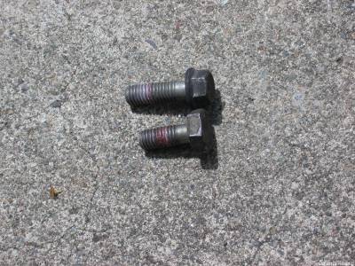

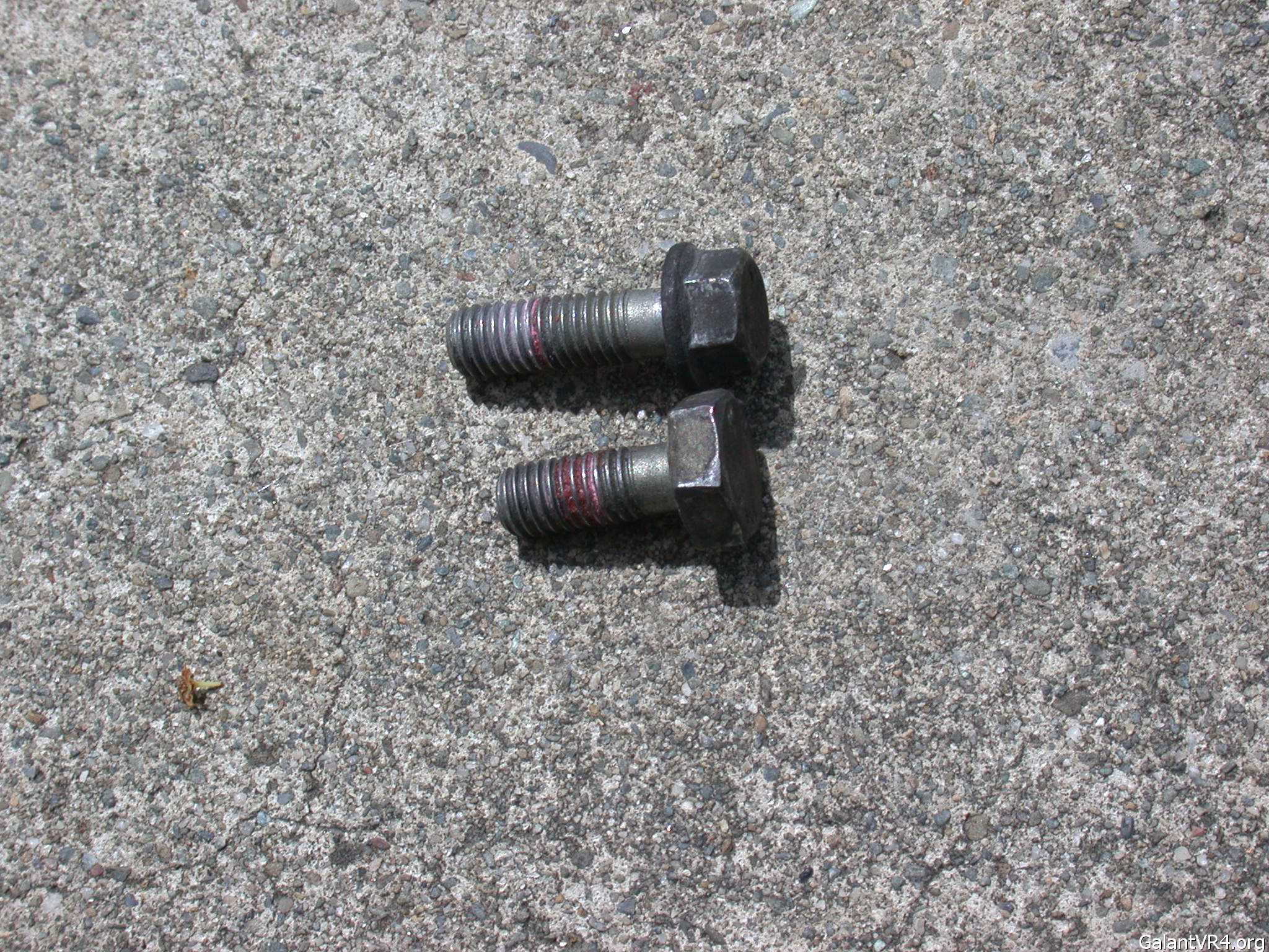

To do this, you will need the following from a C5: calipers, the anti-rattle clips that goes across the calipers, and shorter bolts for the sliding pins. You will be required to keep the LS1 "pad abutment brackets" ( which is GM term for the caliper brackets ), LS1 brake pads, and the LS1 brake pad shims.
I just did this swap on my setup, and it's significantly better than using the LS1 calipers.
I'll take a pic later..

Not exactly, but close. The tundra ones are similar, but different.

Yes, they're both cast aluminium construction.
Camaro caliper is gravity cast, while corvette caliper is pressure cast.
The corvette caliper is supposedly stiffer because of that..
