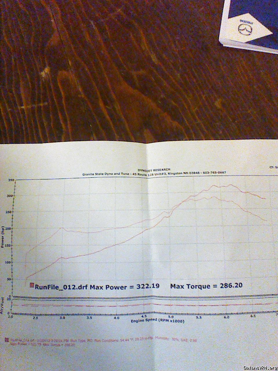

Mine made 322hp on a Dyno jet
E316g ported at FP, completely stock long block with ARP studs and a MLS head gasket.Ets front mount RRE downpipe homemade exhaust 3". Jackal speed density, 720cc injectors, walbro 255 blah blah fp race turbo manifold. This was before the external wastegate and it was boost creeping like crazy I'm pretty sure this was around 27psi.

Quoting CutlassJim:
Something was VERY wrong with that set up. No way the torque curve should look like that.
Yea this was my first time learning to tune and since it was a Dyno jet you can't steady state tune I need to get it on a mustang Dyno or some other loading type.
