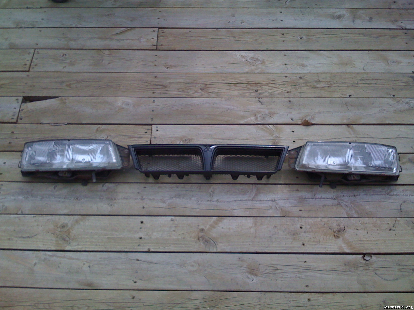

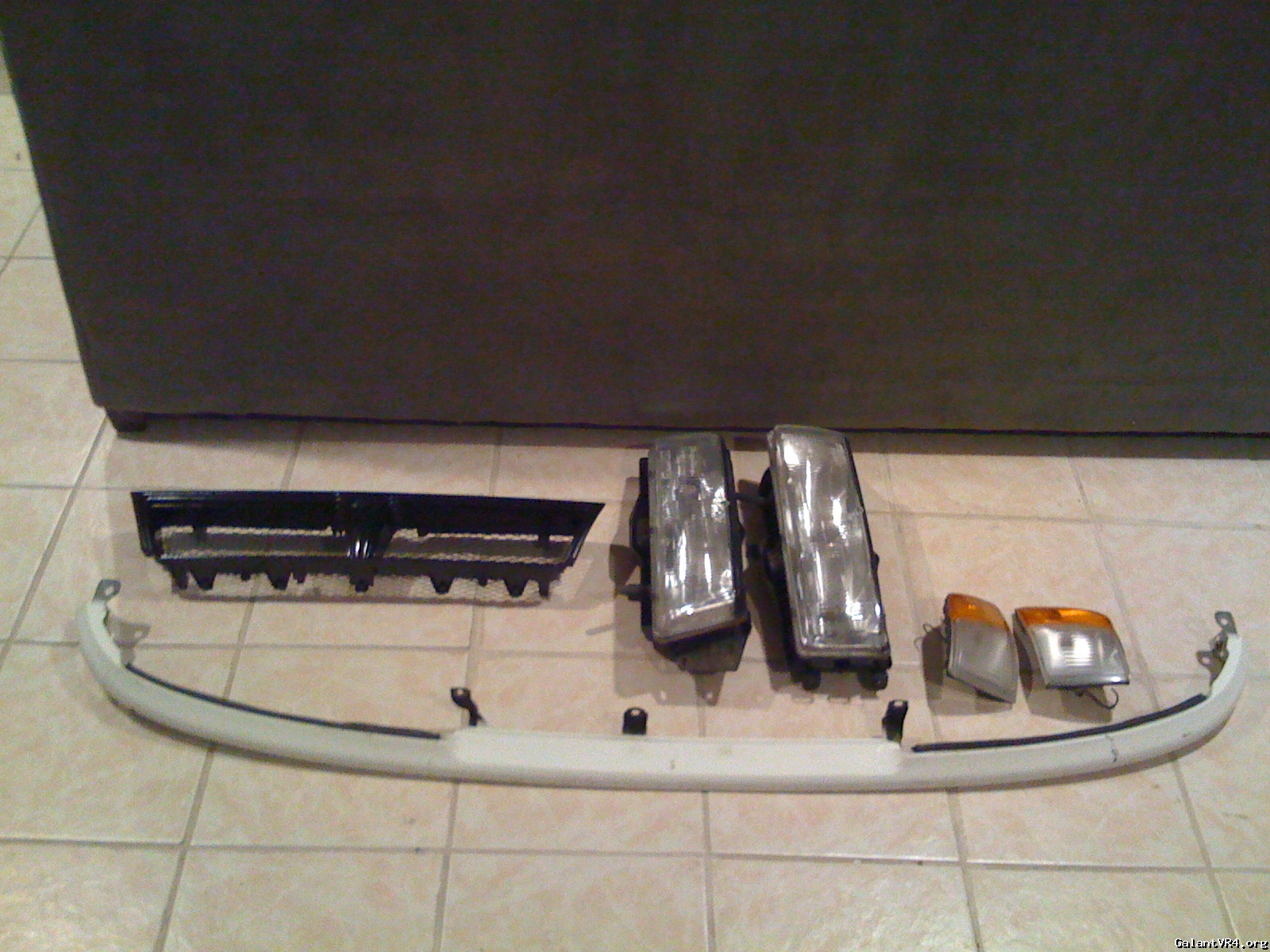

Went to the junkyard and found some nice condition 89' headlights to replace the ones damaged in the accident, picked up a pair of corner lights as well, and the piece that goes directly above the bumper.

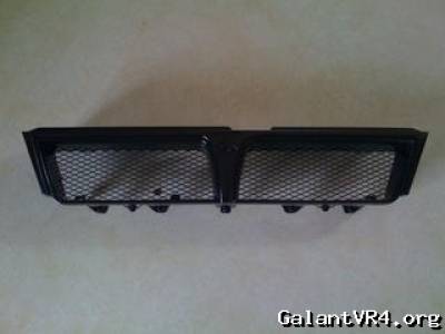

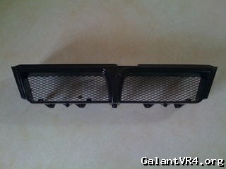

The water pump broke and the accessory belt snapped. I have to have the water pump replaced in order to drive it. Painted a USDM grille from the garage to replace the broken grille currently on the car. Painted it by prepping it with 1000 grit sandpaper and denatured alcohol and then 2 coats of Duplicolor Primer Sealer, 3 coats Duplicolor gloss black enamel, and 1 coat Duplicolor clear coat.
