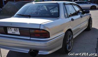

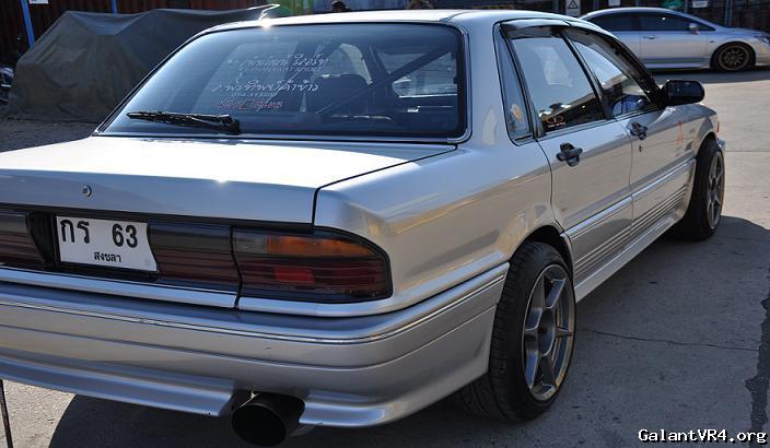

Quoting H05TYL:
3kgt rear axles are longer than gvr4 ones, about 35mm each iirc.
A bit of negative camber and some flares will sort that out ... or you could just go hella flush!
/ubbthreads/images/graemlins/rofl.gif /ubbthreads/images/graemlins/rofl.gif /ubbthreads/images/graemlins/rofl.gif

Er no.
If you use GTO trailing arms like RedTwo did you still use the vr4 axles. The trailing arm mounts on the GTO subframe must be further apart than on the vr4 one.
You could of course fit the whole GTO subframe (with some difficulty?).
Those wheels don't look too dissimilar in size to what I've got on mine, I'd guess 9" or 9.5" +12 to +20ish, narrower tyres than I'm running though.
Once you lowered that the camber gain would have them pretty close to fitting, a slight roll and some trimming under the rear bumper and they'd be fine.
