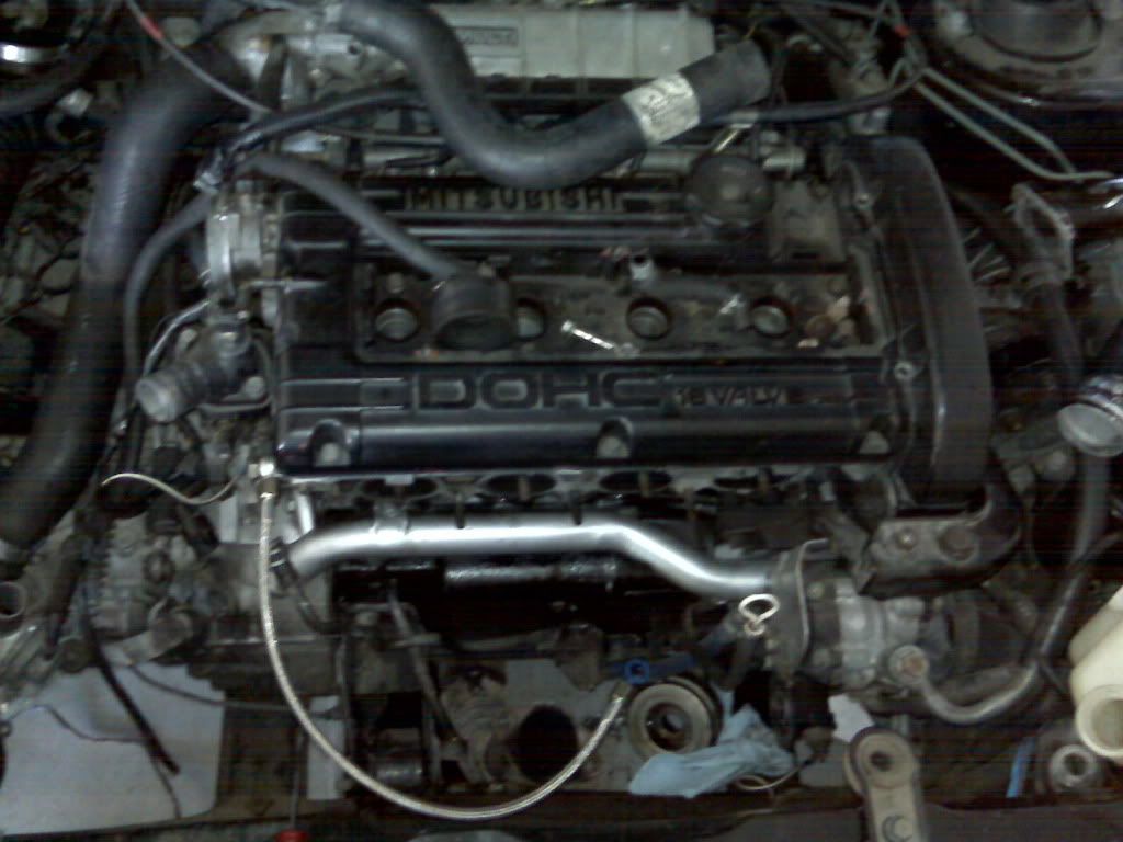

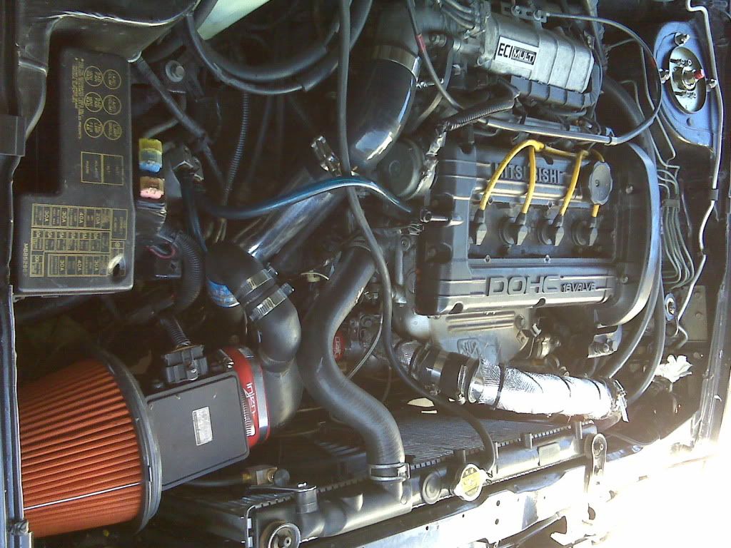

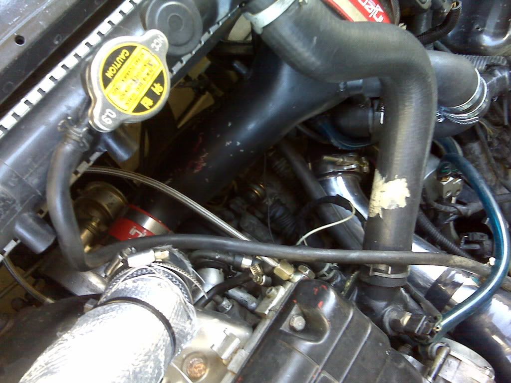

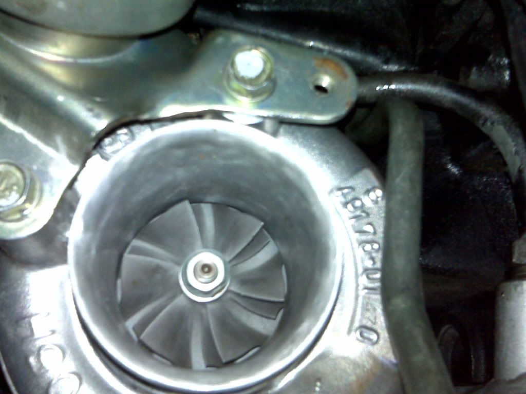

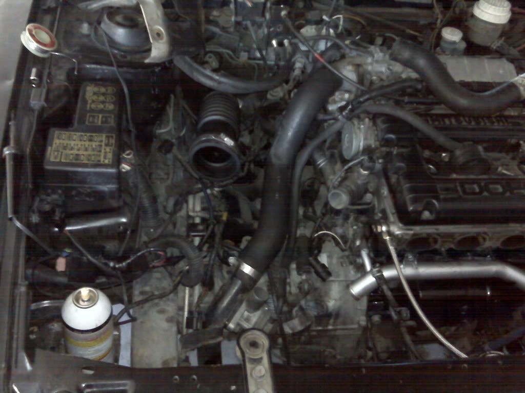

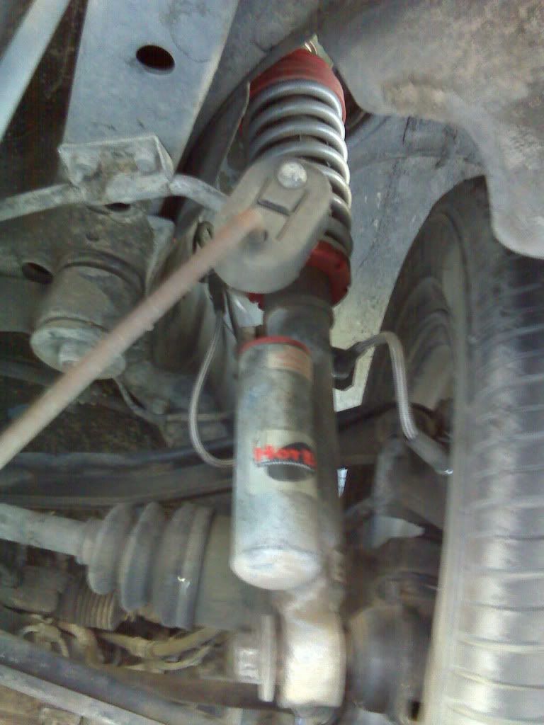

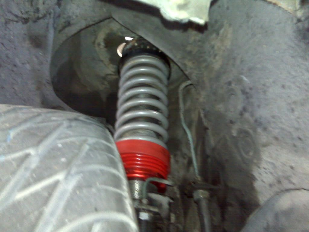

So its been a while since ive updated on #975, but it basically fully done now. this is what ive done so far.
Ported Evo 3 16g, ported 2g manifold, 2g exhaust housing, 560cc evo injectors, 190lph, dsmlink v3, custom hard piping, JDM RS fmic, BC 272 cams, new radiator with 2x Pro form fans, all new A/C equipment, plugs, wires, rear wheel bearing, Hot Bits coilovers, dejon mbc, 2g maf, shifter bushings, now i love it. The cars drive wonderful and was built by somone very nicely, after my second compression check it is still at 180 across minus a couple psi on cyl 2. Anyways ill post some befores and afters. The car came with a few goodies im still using like the 3" turbo back, and the motor was built with arp's, mls gasket and im thinking 2g pistons. Ill try to get some vids of it too.

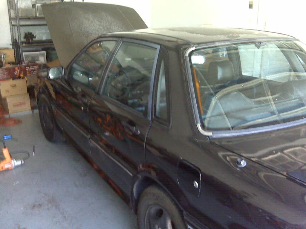

Pics when i got it...
And some recent pics
