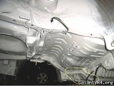

thnks gus,the most dificul here now is a mod mouting axle.axle mouting have 4 point right?.below i attach some pic e39 casis for my question.the yellow circle area can be take out & weld to my mod car,can/not?or anybody have better idea .

You will need to cut out everything you see in that picture, and weld it into your car, the whole lot is very different, not just the mount circled in yellow.
