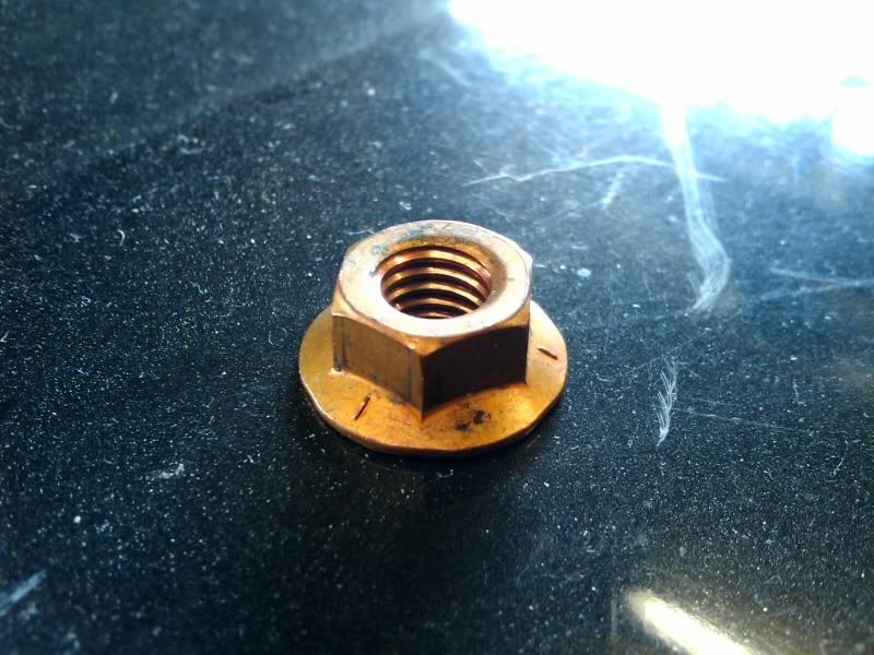

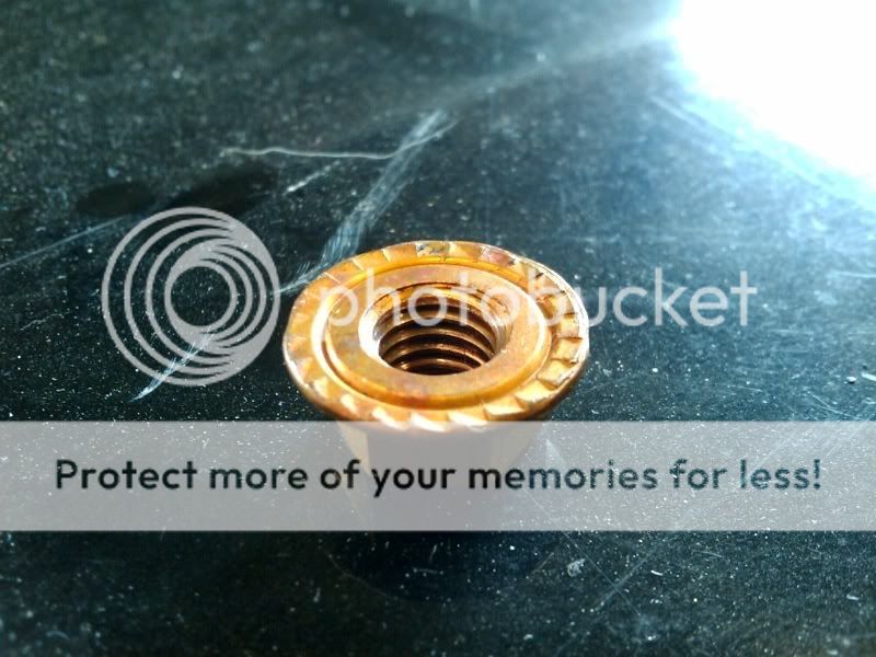

This is the self locking nut I'm looking for: (I will upload the pictures later)

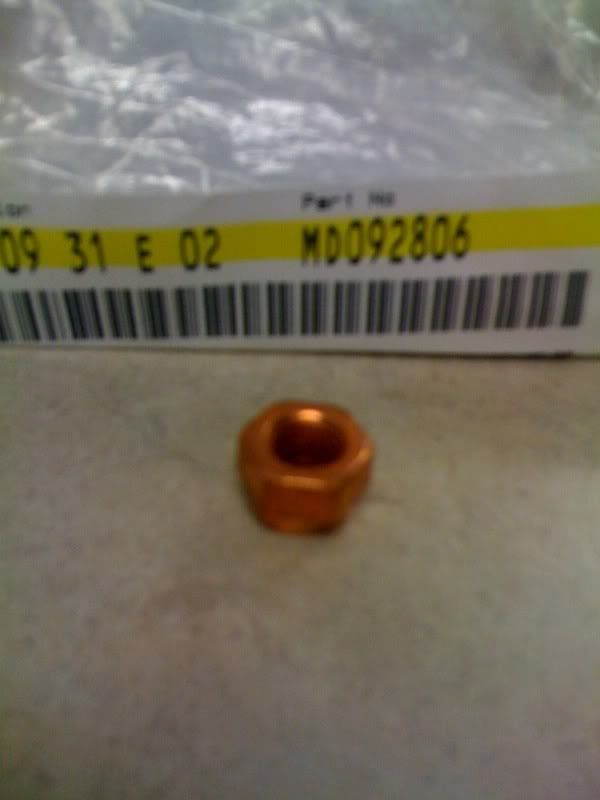

This is what they keep sending me.
I am starting to question as to whether this part even exist oem. I do know one thing these guys at this dealership have no clue as to what a self locking nut is.

Bmw # 18 10 7 523 805. Or you can run the Nissan self locking ones. Have to dig up the part #. The copper ones from that sstud company are only copper coated & are not self locking. Your better off using a good locking nut with copper or nickel anti seize like the bmw or the nissan units. Below are the bmw nuts, as you can see they stake the threads top & bottom instead of the ridges used on the mits unit. Actually the entire nut seems to be copper & has a timesert/ insert installed. I have 6 leftover if anyone wants them. M8 x 1.25. The ss unit next to these is a arp.

Is there any place that sells the exact nut that I have in the first picture, which has those sharp locking "things" on the back of the nut.

Call JNZ and ask them if they sell the nuts with the serrated back (the first nut you posted). I HIGHLY recommend these simply due to the fact that they are unlikely to end up pulling out a manifold stud from head. The serrated nuts rely on gripping the surface under them (the exhaust manifold flange) to keep from backing off. Where as other nuts, like the stock nuts or the nuts that G posted, grip the stud itself. Stock nuts, or nuts with pinched threads or features of that nature should still probably have washers under them. Serrated nuts, probably not. EDIT: The BMW nuts that G posted don't need washers. I thought they were small like the stock nuts.
