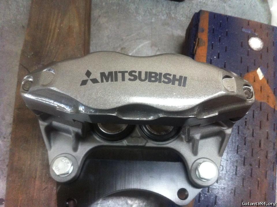

So i'm trying to figure out if these are the 2g or 1g I just got in. They are supposed to be 2g. If so, what do I need to make them work? Same adapter as the 1g?

I am doing this right now. They look just like mine. Which are 1G. Brackets would be different between the 1g and 2g.

they look like the 1g 3000gt vr4 front calipers. that is exactly what you will want. the 2g mounting are close to 3/4" longer due to the 2g vr4 having bigger rotors. RTM sells the brackets for the calipers and you can use the cobra rotors for that kit.

RTM's like he said. You can bolt the 2G calipers to the same brackets made for a 1G but then you would need like 13.5" rotors for everything to match up. Your calipers look like 1G's though.
