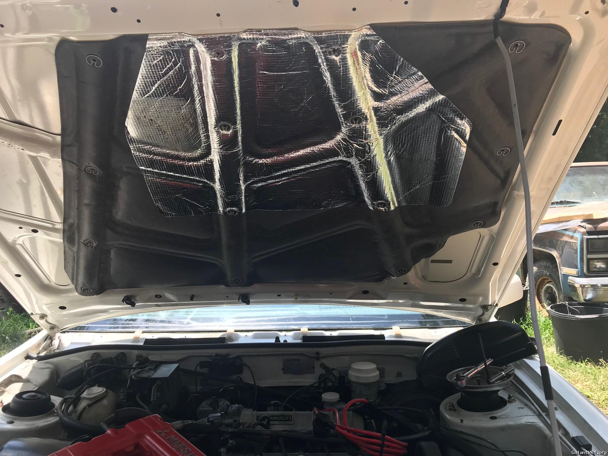

I have driven the car about 200 miles now and I always like to go back and re torque the head studs.(the oil on the valve cover is when I spilt some when topping her off) I also installed the new the hood heat shield.

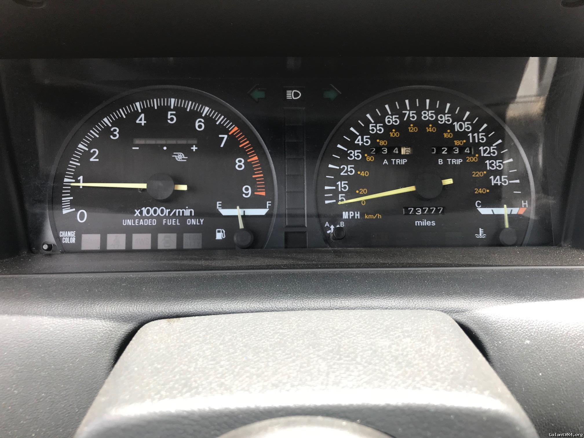

Waiting for my Wife in the grocery store for about 15 minutes in 98 degree Houston heat with the AC on and the temp stays right in the middle.

On every 6G Galant I've had the temp gauge always reads just a fraction under half at operating temp. I believe the gauge is wired that way so the needle doesn't fluctuate so much, and that it gives the illusion that it warms up quick and is stable. Ie, let's say at 190-220F it's going to read the exact same on the stock temp gauge.

My gauge always stays in the middle no matter what temperature it is outside. Also the fan dose not come on until the temp gauge starts moving past the middle. It could be that have the temp senor on the thermostat housing instead of the radiator...

Mine and my two sons are also located on the Thermostat housing. None of ours ever hit the middle until the temps start getting to high. It could be that the needle is a little off on that gauge
