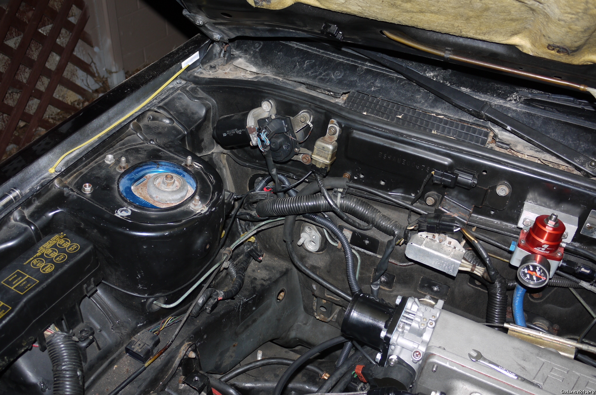

Thermo housing and CAS roughed-in

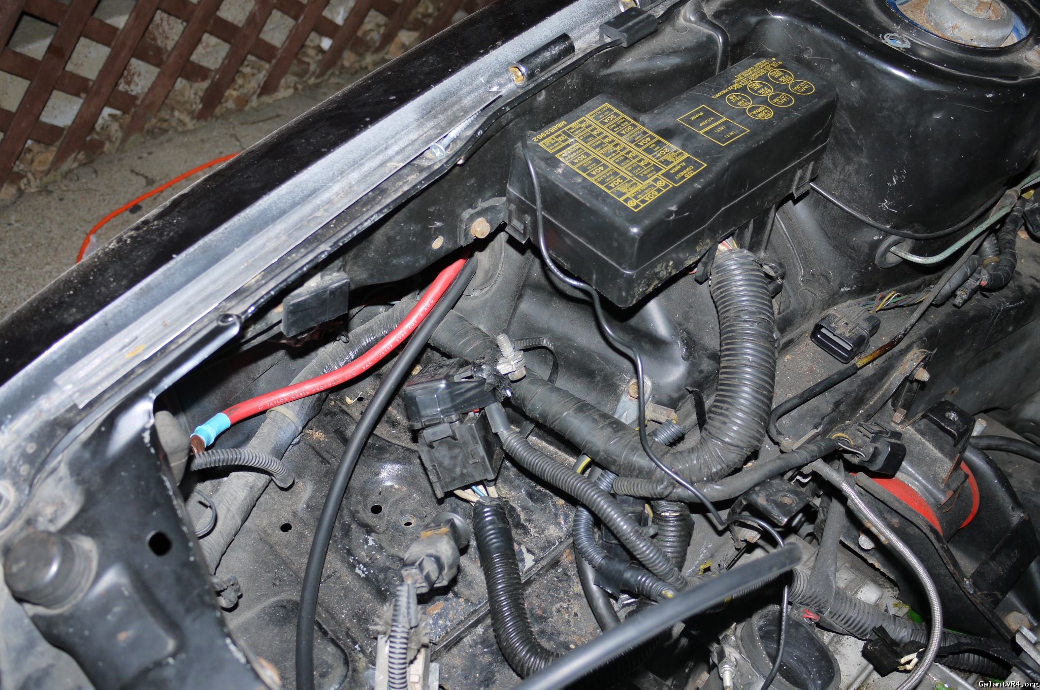

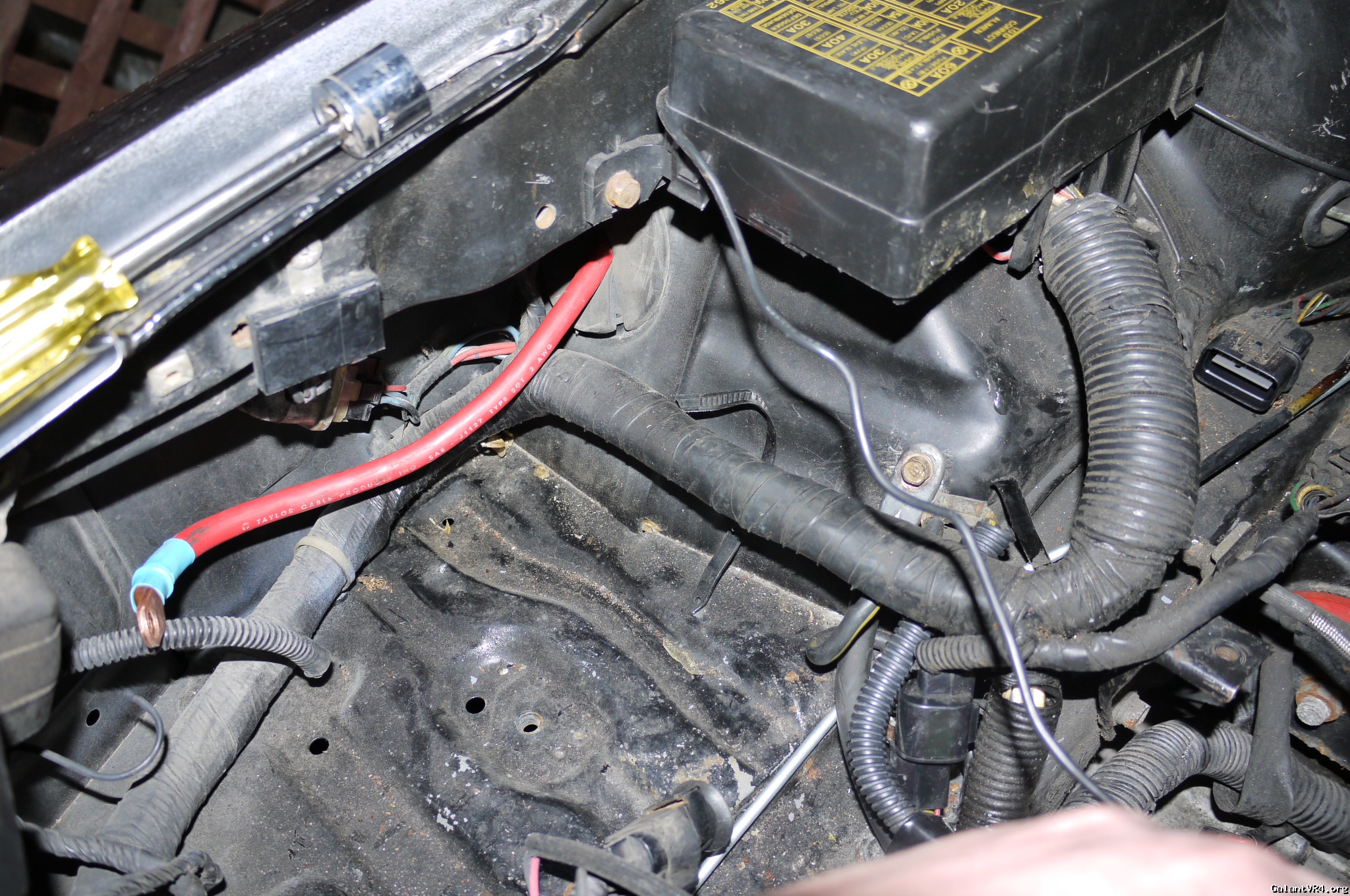

Power wire new location, run through inner fender.

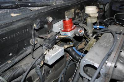

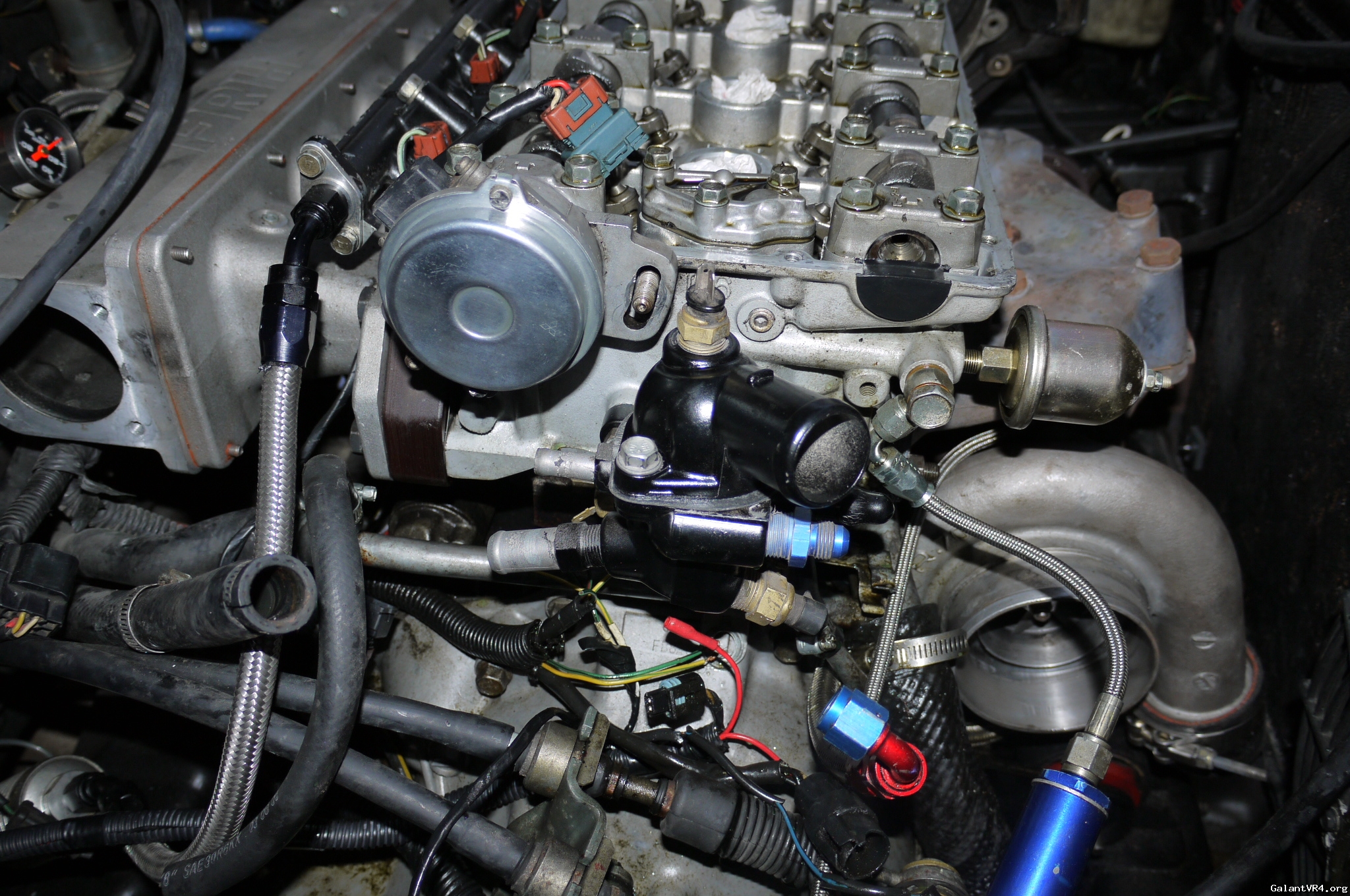

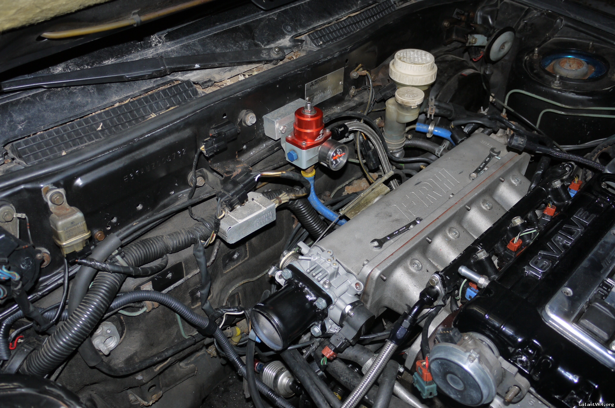

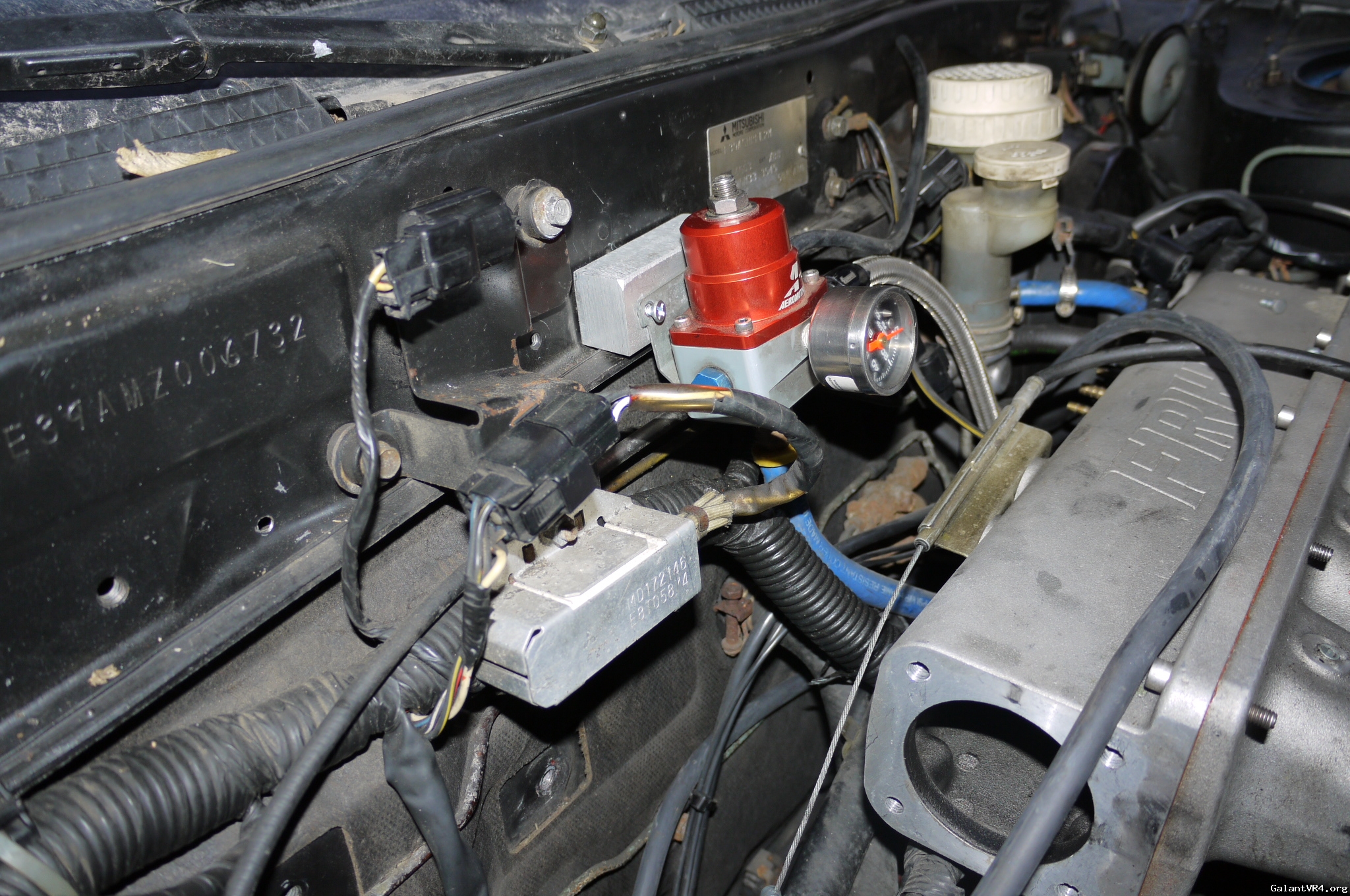

A rough shot of what I am going for with the FPR mount. Did not have time to finish today, but you get the idea.

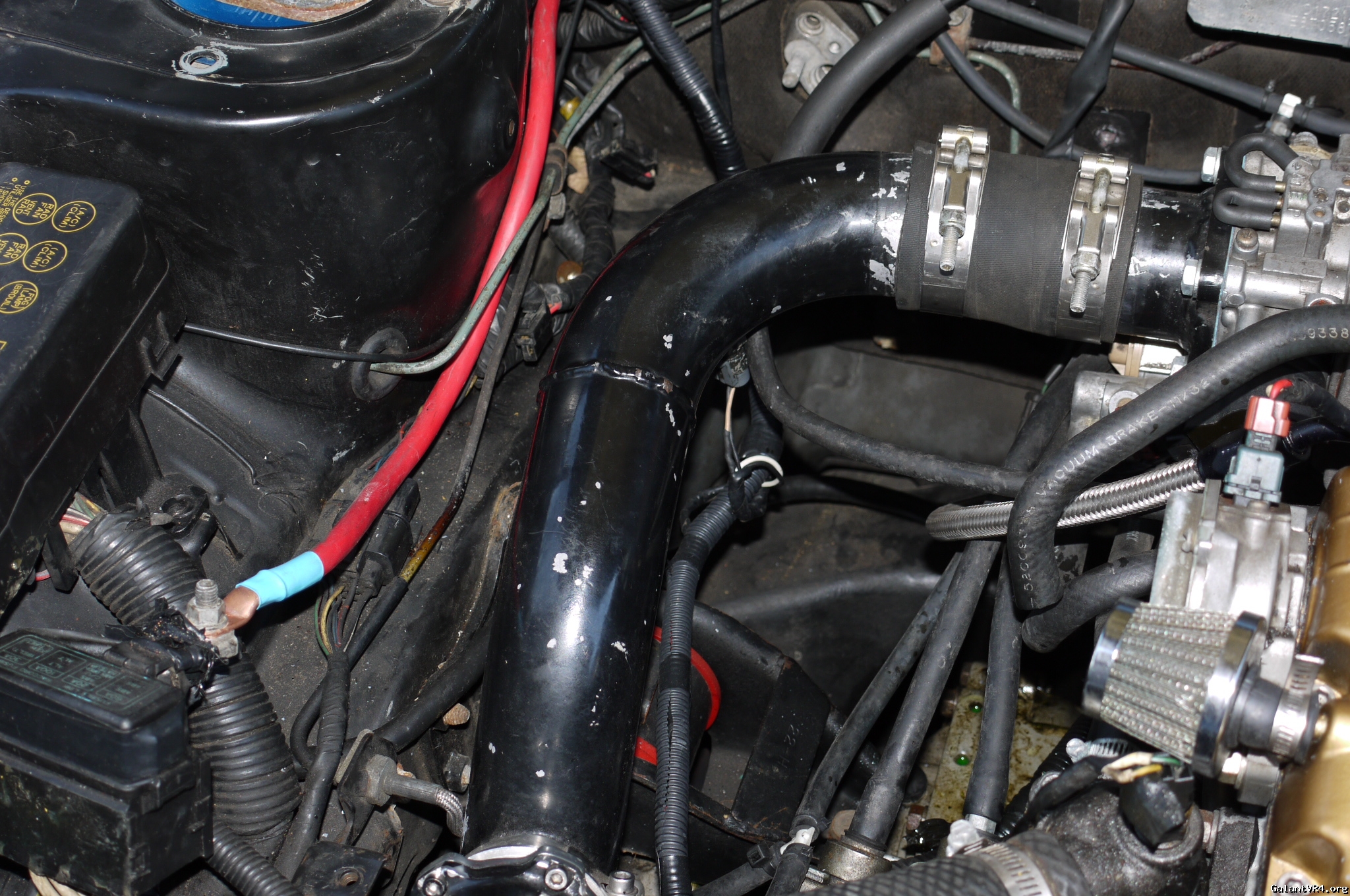

The progress looks good. I like the VC with the new toys. I'm sorta trying to do all of this, however I'm putting the car back together instead, a bit easier so we'll see how it goes. What type of paint did you use on the VC and the ICP's?
i/c pipes was high temp spray cans (1 coat of primer, 3 coats of color)
v/c was single stage enamel out of a HVLP gun over primer.

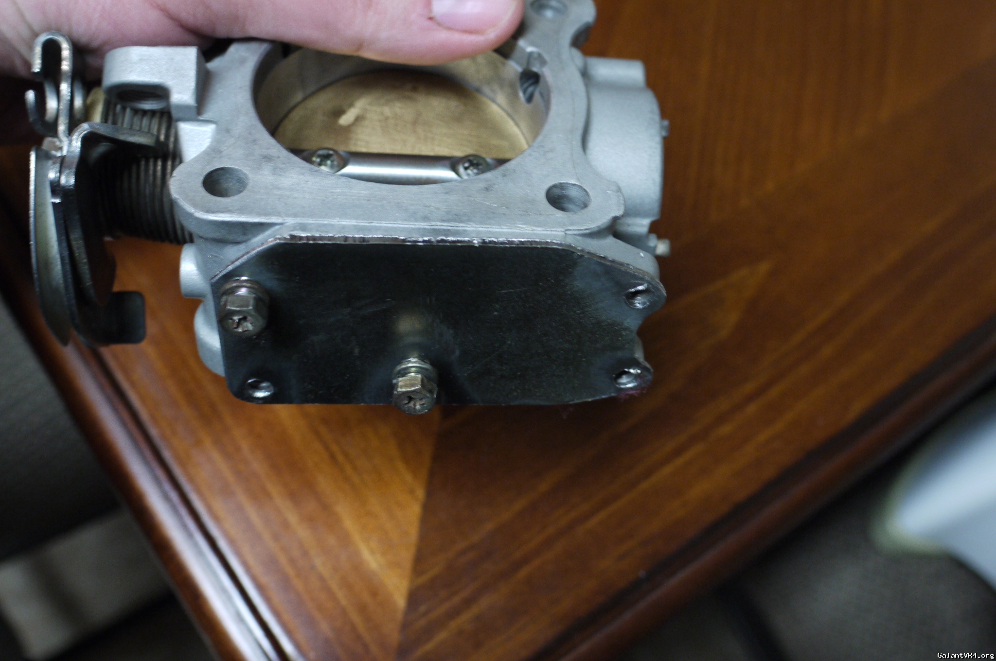

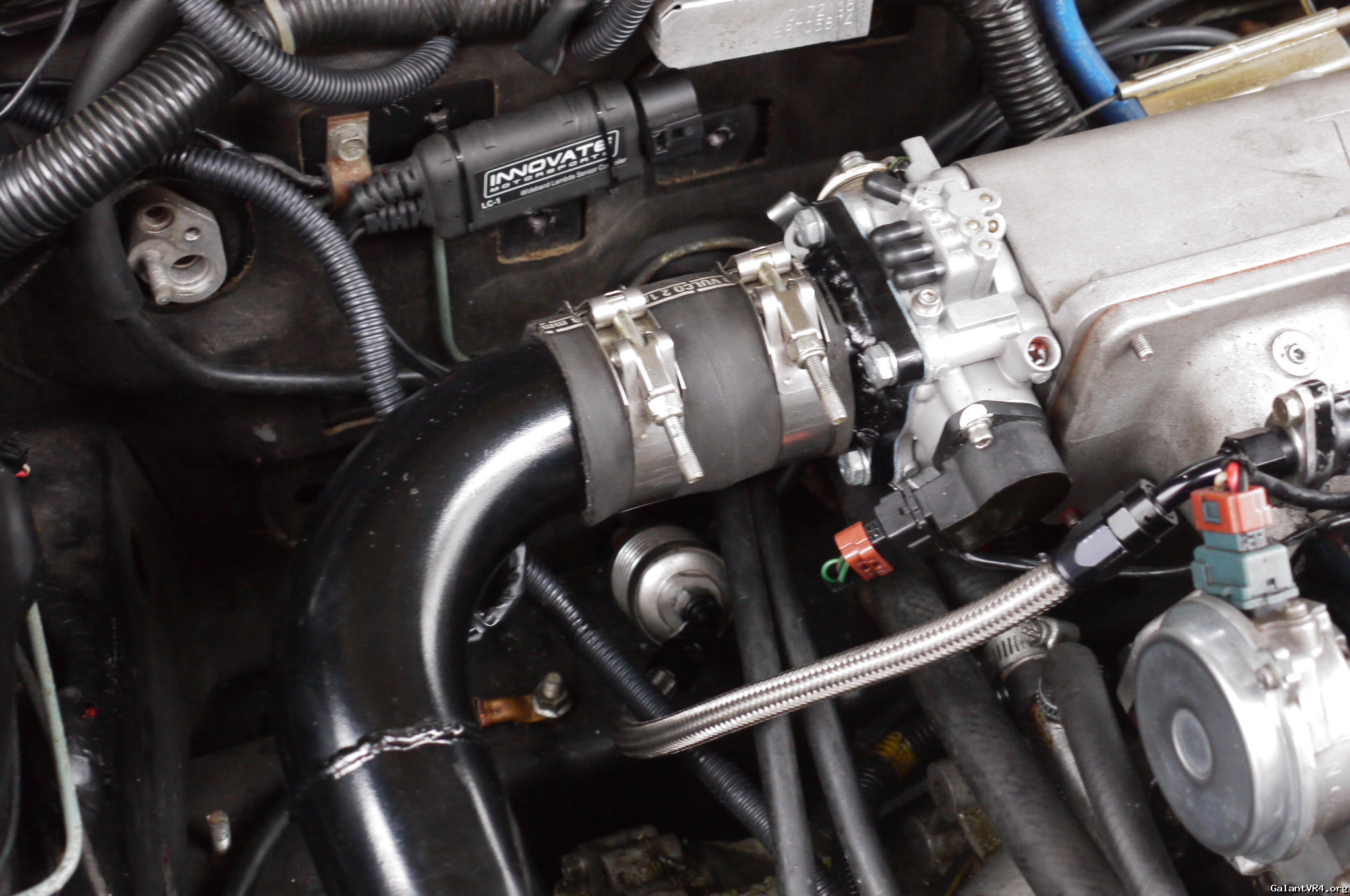

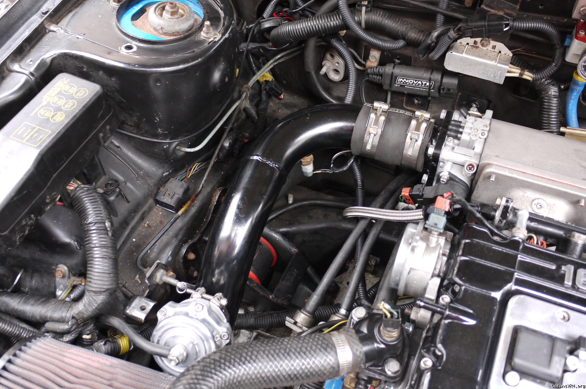

Here is a pic of the throttle body coming along. I still have to reassemble the rest. It also shows a pic of the block off plate to eliminate the IAC motor and coolant manifold.

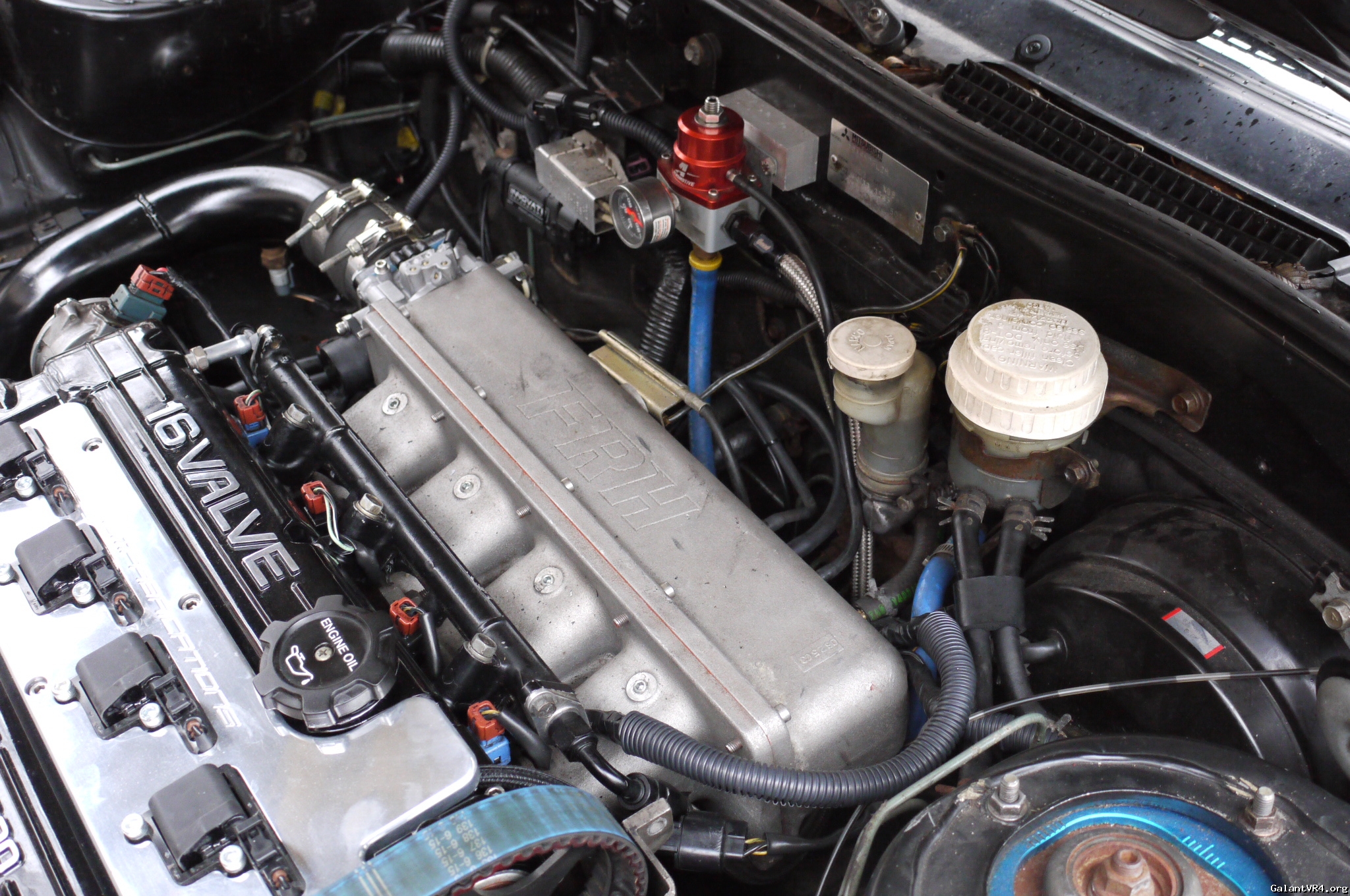

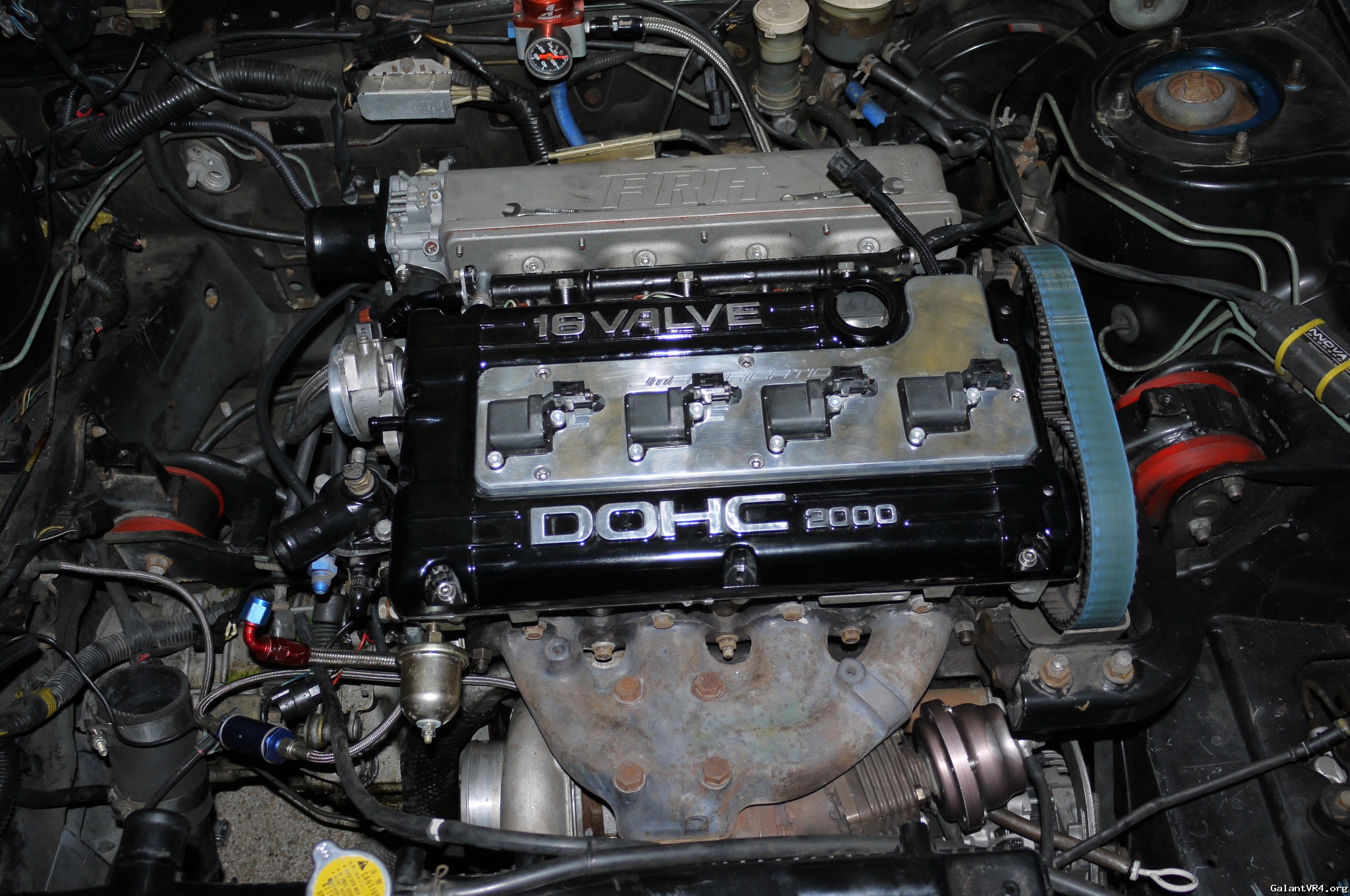

some more updates... v/cover back on, TB and FPR mounted as well as all vacuum lines hidden. Still need to do a lot, but its coming along.
V/C and COP setup
FPR mounted on aluminum block.
Better look at Throttle body.
Wheelwell grommet with power line and vacuum line for BOV, boost controller and W/G.
Firewall passthrough with a little less crap going through it.

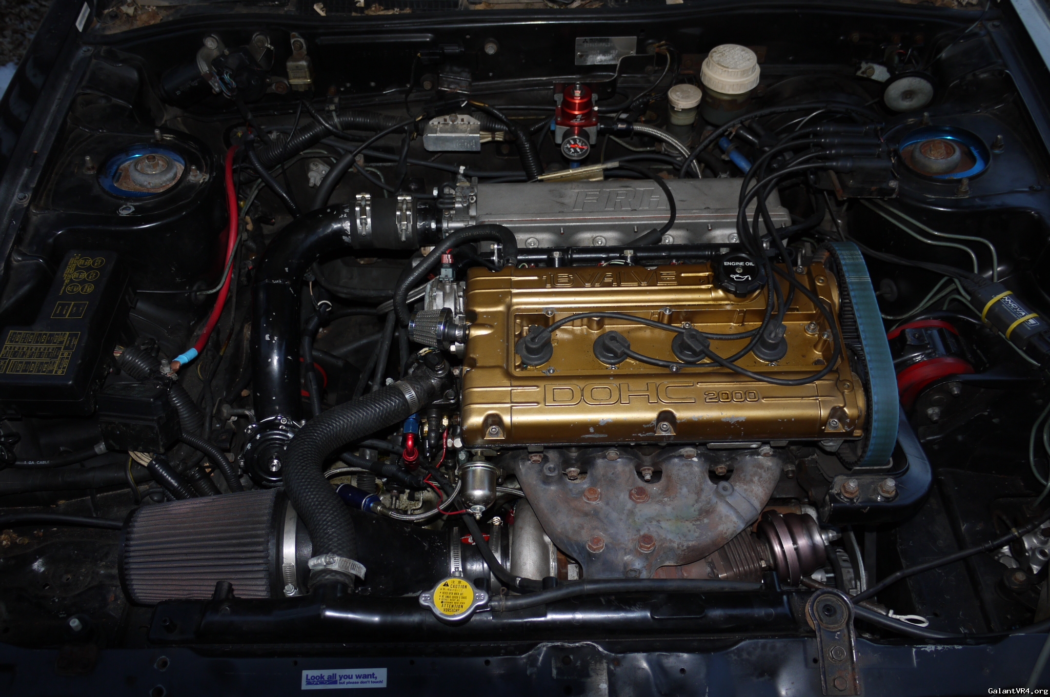

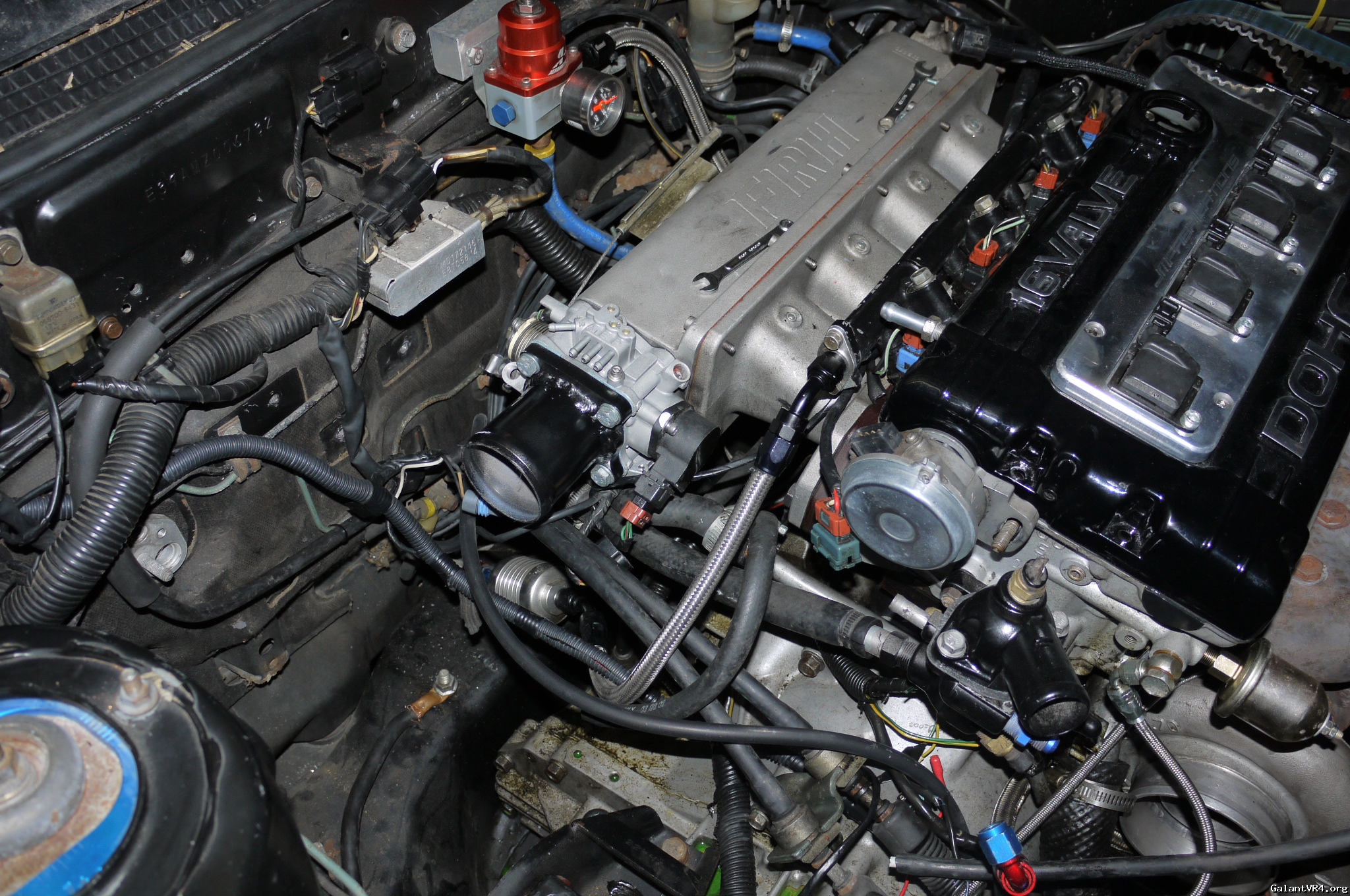

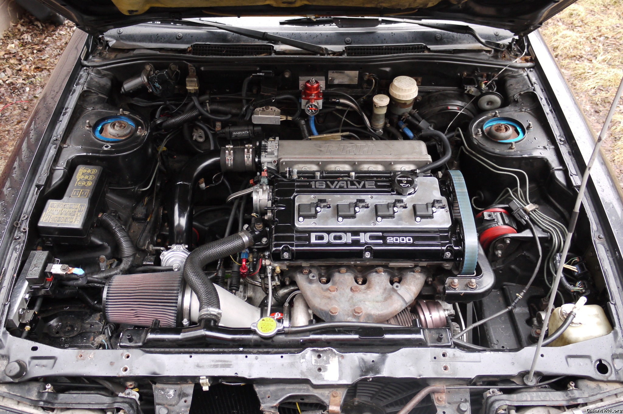

Ok, for all practical purposes, she's done. I have a few little things like to move the wideband (thats why its unplugged in the pics), and do a little button up wiring, but this is pretty much it. I wish I would have pulled the motor and cleaned everything, but its starting to get decent weather around here. Since I have owned the car a year and a half and have only put 380 miles on it, I think I am going to drive and enjoy it this year.
overhead shot.
a look at the FPR area

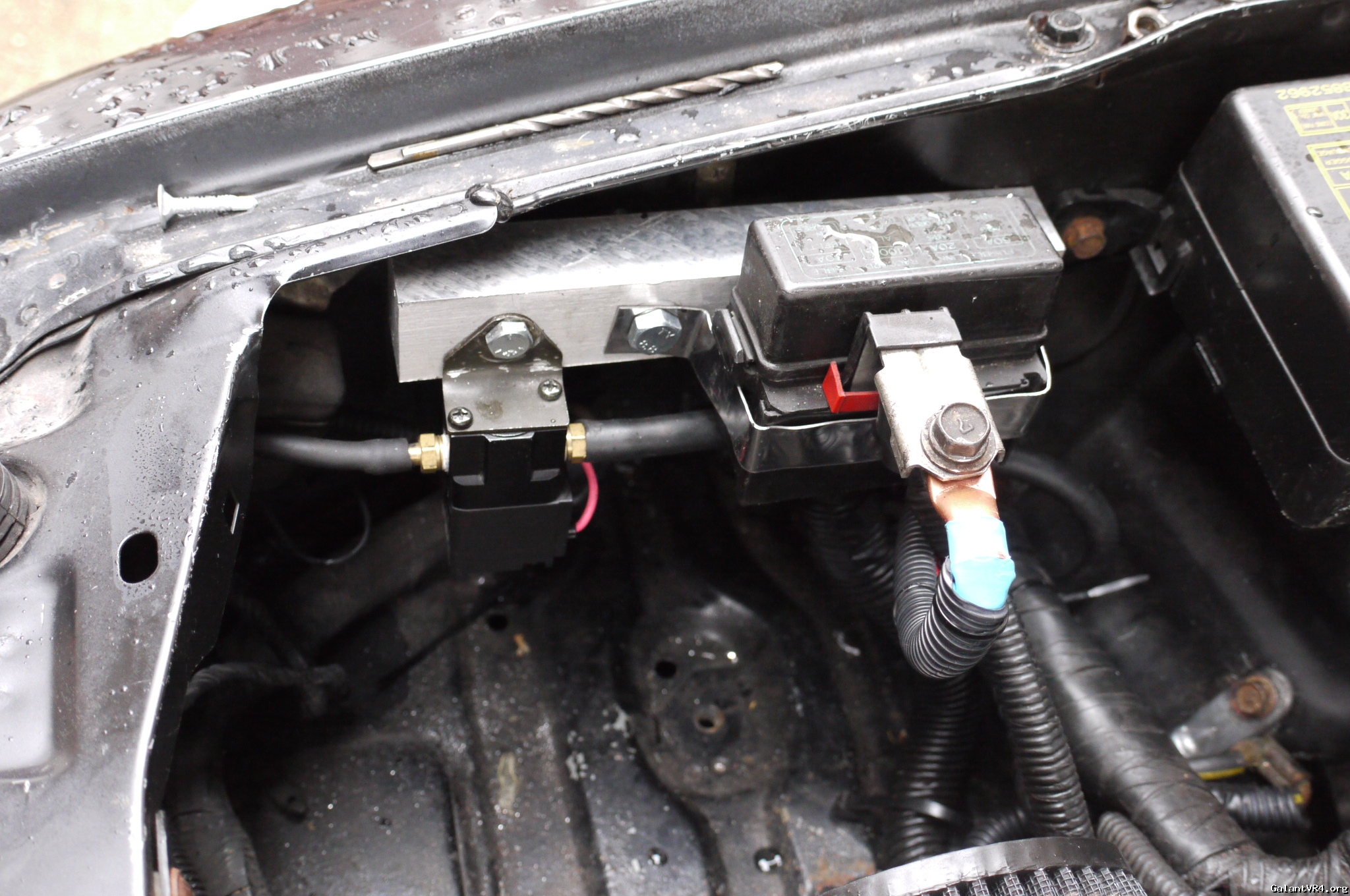

A mount I made for a fusebox that was just laying loose, and the Profec-B solenoid

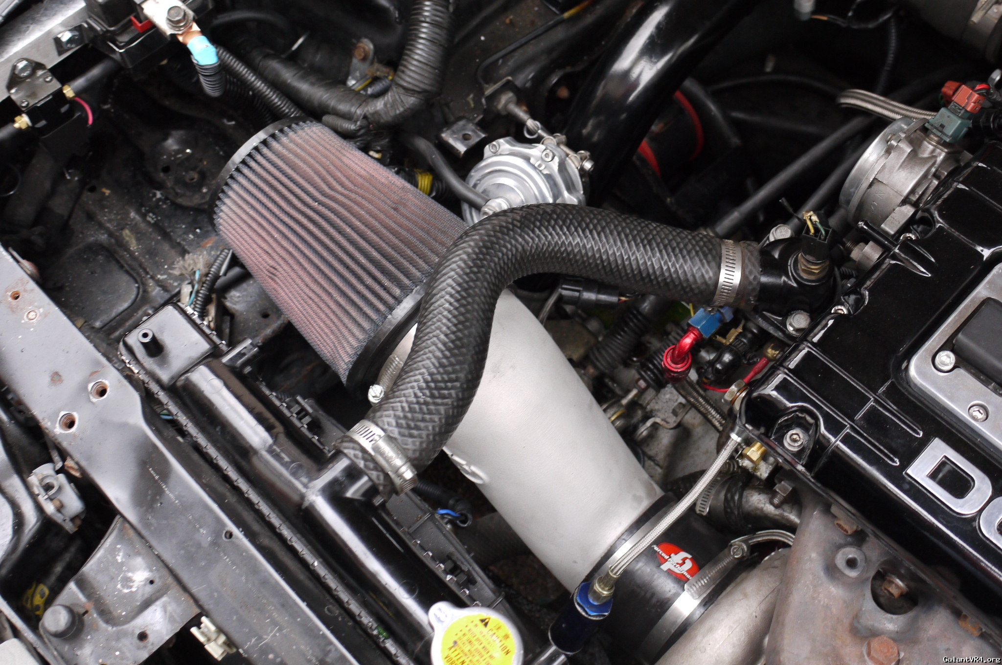

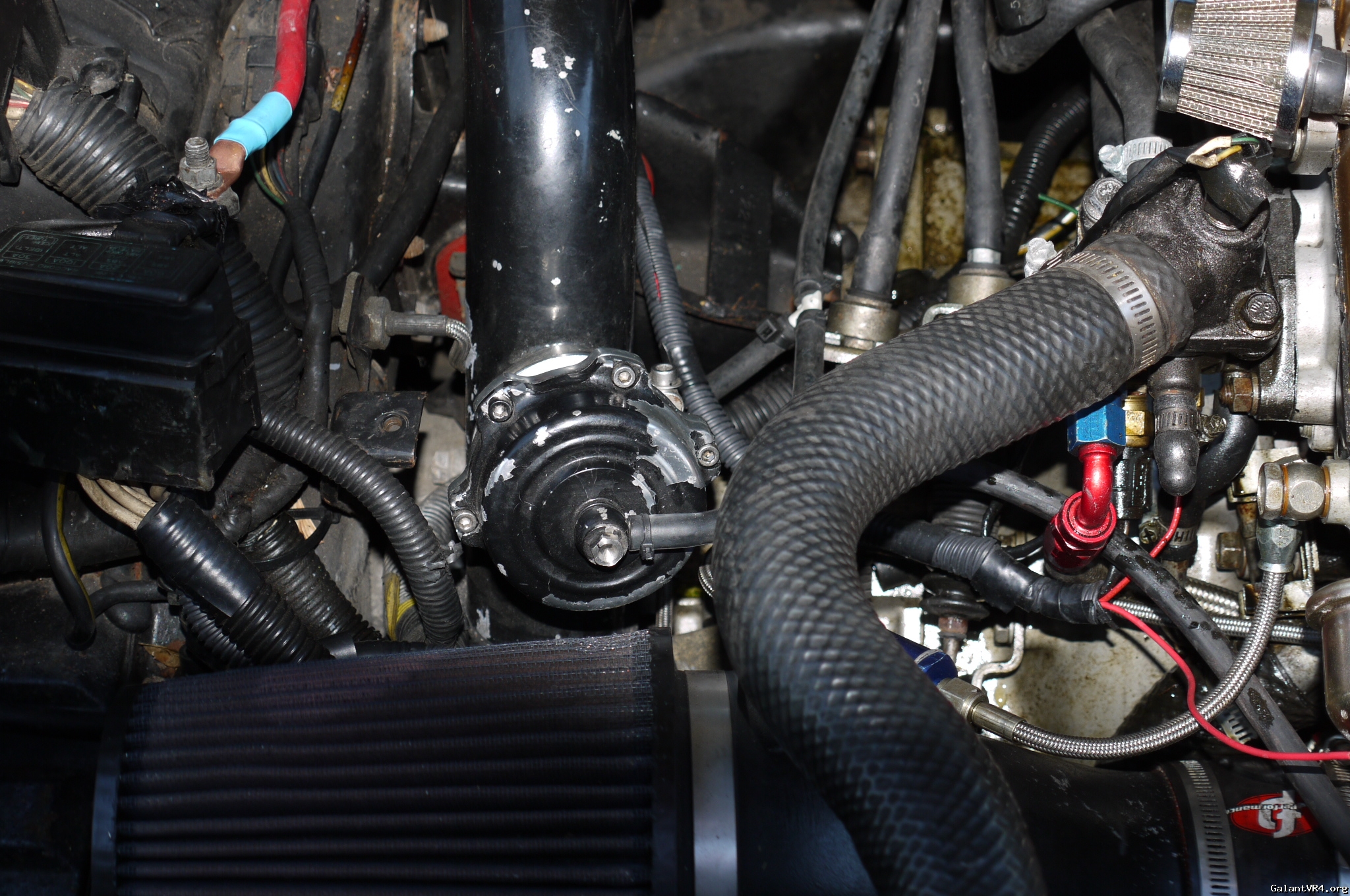

Intake area (note short Vaccuum hoses to BOV)
TB area, note no vaccuum line or coolant hose mess...
