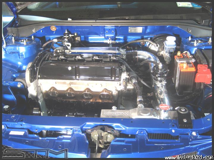

Just got my fittings today, they are gigantic. /ubbthreads/images/graemlins/ooo.gif Probably could have gone with AN18 or AN16 and been fine.
Tell me these are AN20, this is STM's EVO. Looks smaller than AN20. Is he restricting flow or did I go way overkill? These are non refundable. /ubbthreads/images/graemlins/rofl.gif /ubbthreads/images/graemlins/banghead.gif
TylerAdamson
Dec 26, 2007
1,034
Iowa City, Iowa
The fittings on the STM Evo look like they are -16 which is smaller in diameter than the stock hose and wouldn't go with anything smaller than that. The STM Evo is also a purpose built drag car and doubt its driven on the street much.
