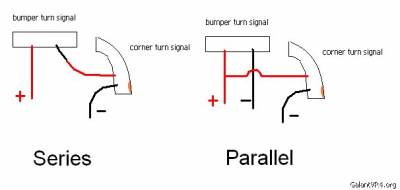

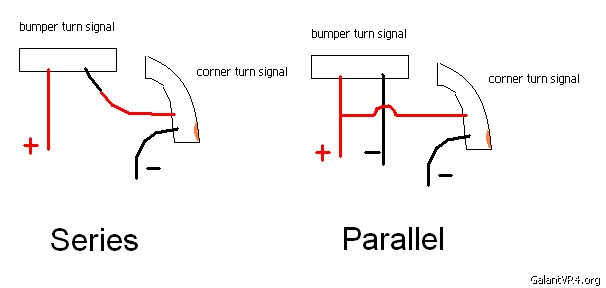

1. Can I pull the wiring harness our of the plug and put it in the JDM on (individual wires)?
2. To avoid ricer "speed blinkers", how should I wire the turn signals (series or parallel)?
Sorry, I guess I should clarify the drawing and make sure I have it right.
The corner parking lights and corner turn signals have a common ground, correct? Looking at the connector, I can figure out which positive goes to the parking lights, and which goes to the signals.
The drawing just uses the + and - for the turn signals. I ignored the parking light.

Yes common ground. /ubbthreads/images/graemlins/smile.gif I don't think that serial/parallel will make any difference in the blink rate. The blinker just "senses" the load and I believe either way the load will be the same.

All blinkers are parallel, THe front and rear bulb have to be hooked like that otherwise whan youblow a bulb you'd loose them. The Wattage (load) is what is wrong. You'll have to hook your original front blinker in parallel with the rear bulb on the jdm 2 bulb corner. the front bulb on the corner is just a sidelight.
