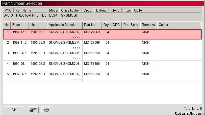

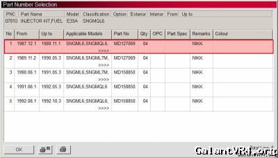

Quoting G:
Available from mits? Send me the part #.
MD127069 - 88~90
MD158850 - 90~92
for the E33A Galant [SNGML chassis code] and the D22 Eclipse [MNHML4M/9M chassis code]
hth

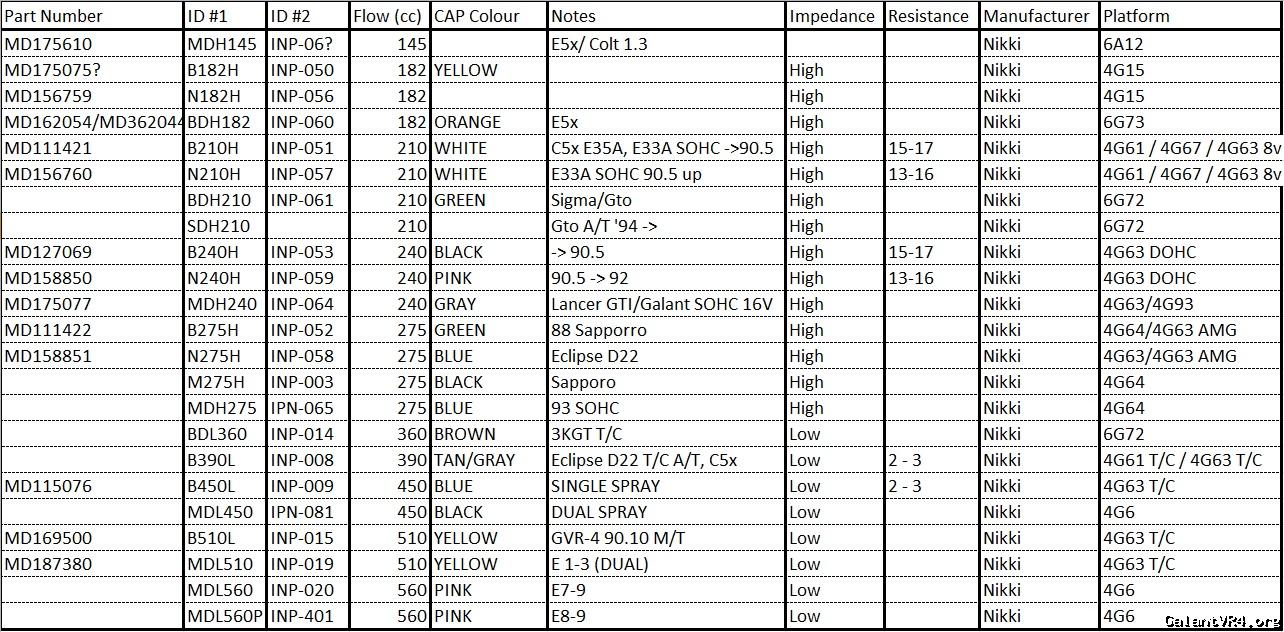

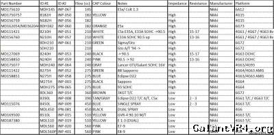

Hi Paul,
Here is the injector data I have collated from around the place (still some gaps) But should help source out some newer ones.
There are basically three generations of each injector (I guess nikki have improved/cost benefited each design over the years.) the basic frame size is interchangable on the series too. so you could source out a later set to the same spec as yours.
Yours is an '88/89 so I guess it'll have the early (first gen) injectors.
Two basic failure modes for the injectors.
1/coil goes open loop/short. (breakdown due to age of insulation. Dupont kapton is usually used as coil insulation, it's now pretty much banned in aircraft use as its not good with heat and time (not a good combination in A/C hydraulics...) Anyway back on topic...
2/ Nozzle shield breaks down (comes apart). i saw this on a Philippine GTI I was working on about 6 months ago.
Hope the list helps you out.
Rich
